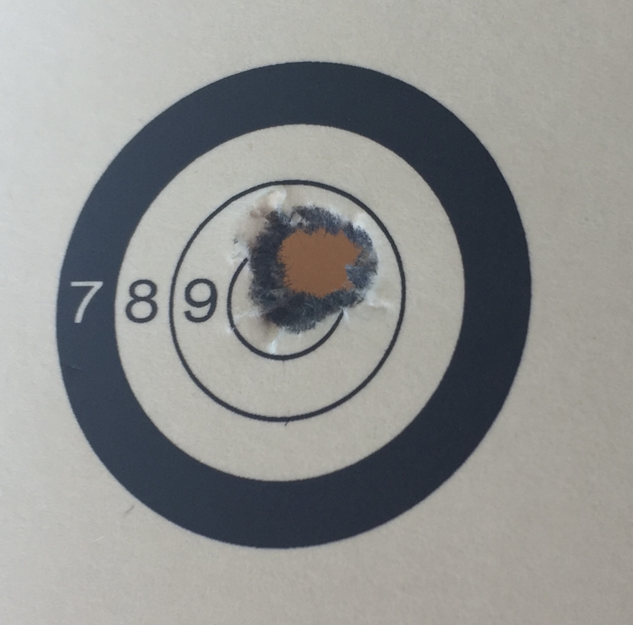

All the same lot. It was shot off the VUDOO fixture and the second round was a flier that was removed from the group
Thank you for sharing, these are fantastic groups! . what barrel do you have on your vudoo?
just curious if you shot that again and what was the size of the 2nd group from the same lot, as they normally would shoot a good lot twice at least.

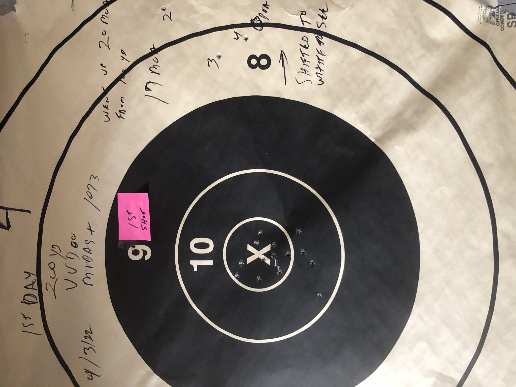

I still have to get the tuner set and torque tuned but for a windy day I’m happy 😃
