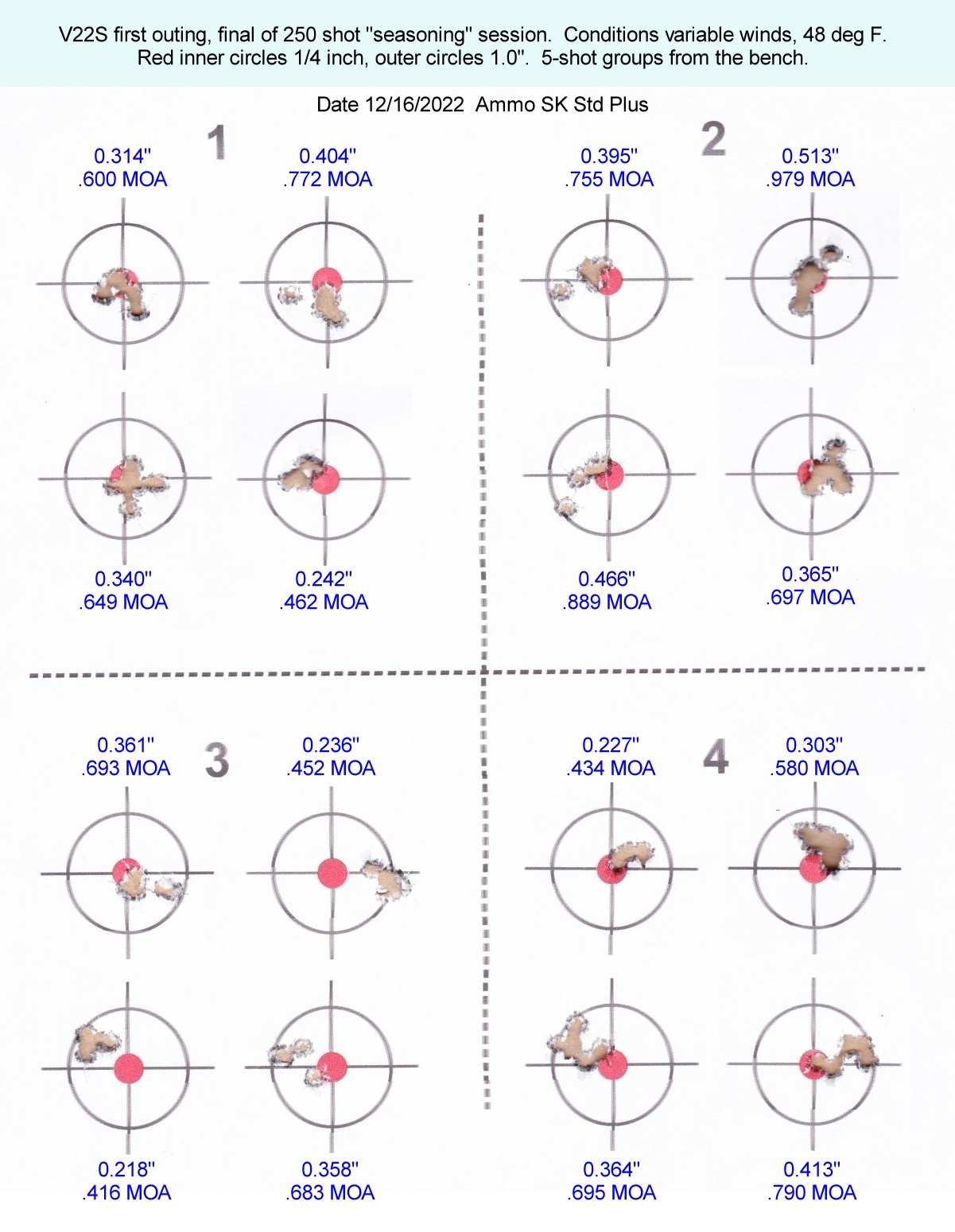

Setting up, breaking in and testing the rifle from Reload10 (post #2805) that we got for a happy customer. We put on a Vortex Golden Eagle scope, and did a 250-round "seasoning" with SK Standard Plus ammo at 50 yards. We took a borescope out with us and soaked/scrubbed just the chamber every 50 rounds along the way. Chamber soaking was with BoreTech C4 for about 5 minutes, then chamber scrubbing with a nylon brush, then ran a single dry patch down the barrel using a PatchWorm. Here are the last 80 rounds from that 250-round session. We tried to pay attention to the wind so that each 5-shot group was consistent within itself. Next step will be to test with several lots of SK Rifle Match and Lapua Center-X we have sitting around here. We will probably put on a tuner, but it may not make that much difference since there's not much vertical spread most of the time. We're pleased with the performance at this point -- it's in the accuracy range we've come to expect from Vudoo. Measurements for group size were done using OnTarget TDS.

MOA on a picatinny rail refers to an amount of "pre-adjustment" of elevation tilt for your scope.
MOA as I'm referring to it on the target sheet is the amount of center-to-center bullet hit spread at the distance of the target. So with my target at 50 yards, if there is a 1 Minute of Angle center-to-center hit spread, that would be 1/2-inch at the 50 yards distance. Likewise, a 1 MOA spread at 100 yards would be 1 inch. And a 1 MOA spread at 200 yards would be 2 inches. It's a way of "normalizing" spread for distance.
Actually, what I just quoted are close approximations that we commonly use to make it easy. One Minute of Angle spread at 100 yards isn't actually an exact 1.0 inches, it is 1.047 inches. Likewise at 50 yards, a 1 MOA spread isn't exactly 1/2 inch, it's 0.5235 inches. But those "exact" numbers are used in what's shown on my target.
If I mis-understood your question, let me know! :) MIKE

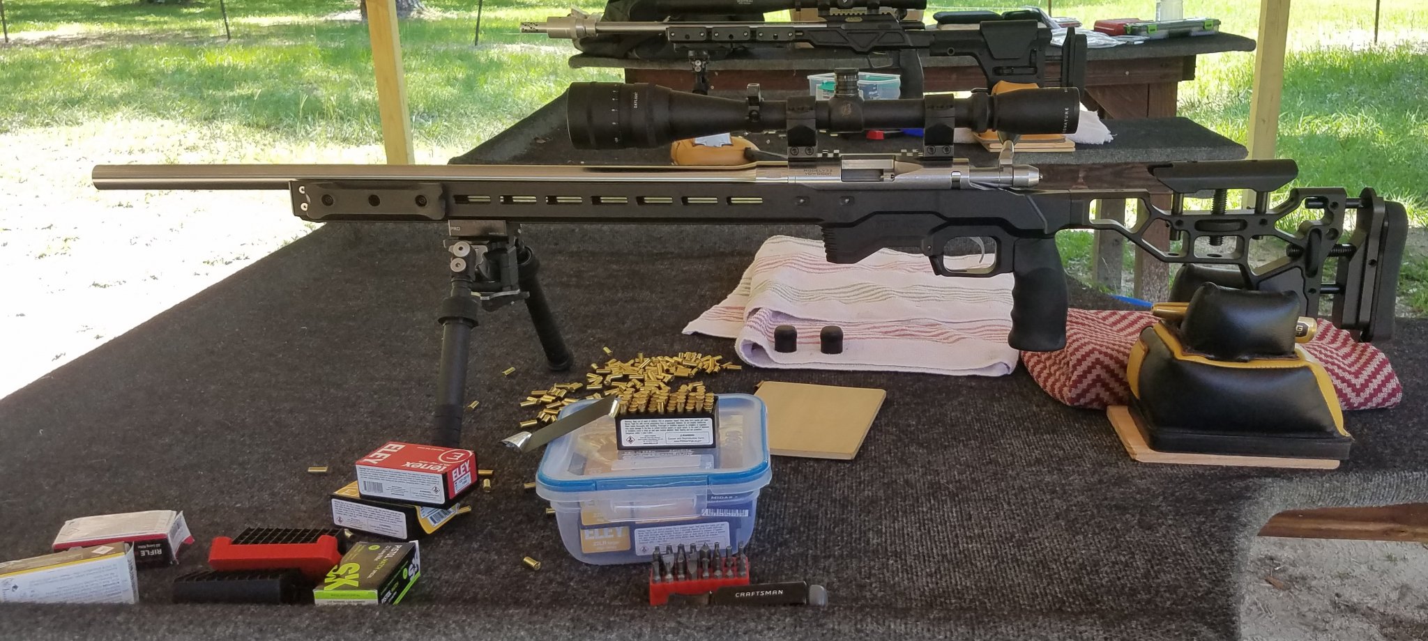

My old fingers have trouble getting the cartridges out of the Lapua or SK boxes one-by-one to load into magazines or to take out and put in a bench tray for single shot feed. Since the lube can be messy, I don't like to just dump them out, so I've made a simple fixture that you put the 50-round tray in right out of the box, and it raises the shells up -- with the rows in alternating heights -- to make them easy to grab without having to pry them up with my fingernails. Not a big deal, but takes care of a small annoyance. The staggered rows are tall enough so that you can use it for single-shot direct loading if you don't have another bench block you like to use. They're available in Classifieds with my other Vudoo items, HERE.
I got 2 different trays,bolt tool, and 3 pens. Two yellow pens broke within 15 minutes. Sent email, 4 pens were in the mail that day. Mike figured it bad plastic?, but very fast service. The rest looked real good, no complaints.

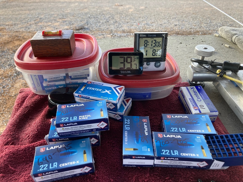

my most recent CX purchase a lot speed I have never shot before a 323 shot this target in 39-degree temperatures. I consider it pretty good for something not lot tested. something you should be doing if you are not checking and that is OAL of the live round. this last case I bought is the most consistent from a brick 7 boxes measured within 0.005 of each round 2 boxes were within 0.010 of the 7 boxes and 1 having a mixture range of 0.015-0.025. and looking at the scores being shot in ARA tells me Lapua in general has been putting out very good lots. if look closely at the one of the pictures you can see the number of 700-705 on the boxes that was the measurements, I got notice the Lapua PK has the same numbers.
also, since we are in the BR thread are you using a tuner might be the setting is not what the barrel wants.

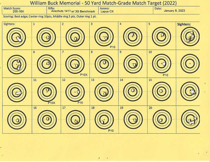

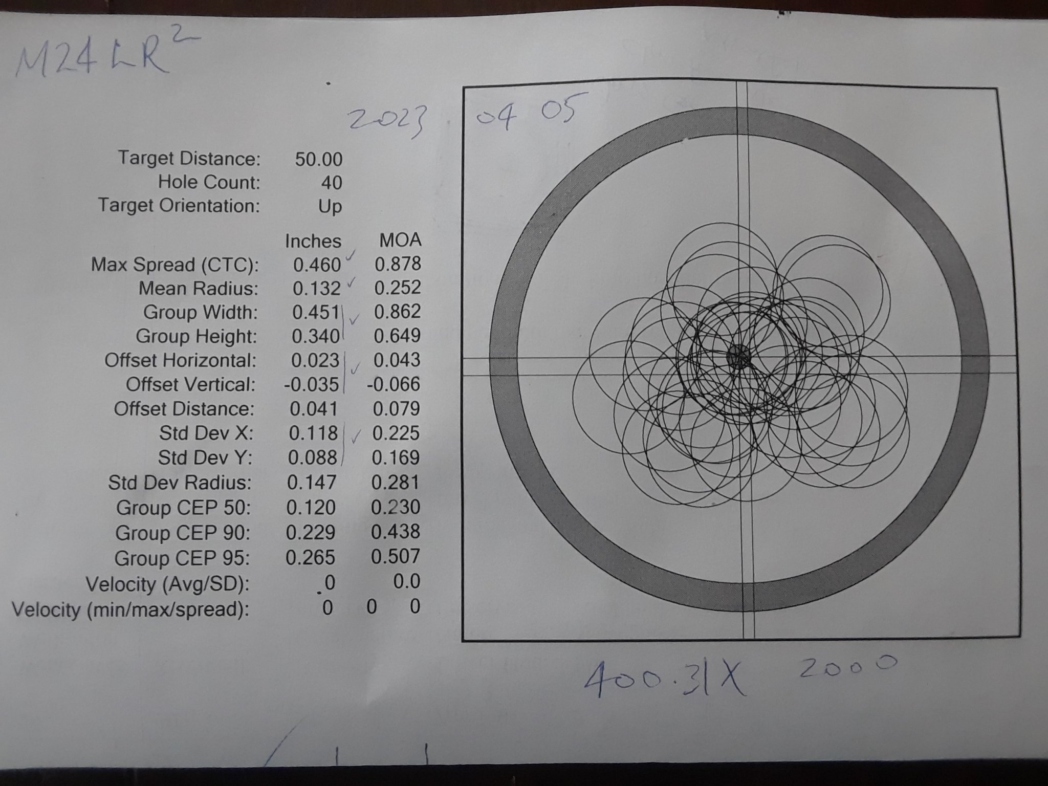

This result is from yesterday. 40 rounds into 8 bulls, F Class 50 yards, bipod rear bag prone. 32F with medium switching winds. I judge the efficacy of my tune on multiple 40 composite groups. This day the group is .111 inches wider than is is high. I feel this is due to the tune doing a pretty good job of positive compensation for the velocitys in this lot of SK LRM.

This result is from yesterday. 40 rounds into 8 bulls, F Class 50 yards, bipod rear bag prone. 32F with medium switching winds. I judge the efficacy of my tune on multiple 40 composite groups. This day the group is .111 inches wider than is is high. I feel this is due to the tune doing a pretty good job of positive compensation for the velocitys in this lot of SK LRM.View attachment 8114192
