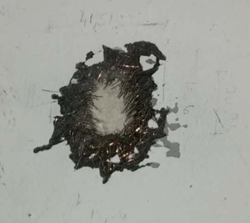

I've poured a bunch of heavy industrial floors for manufacturing, and if you want it to be stronger than concrete the steel fiber is the way to go, but it won't be lighter. Reinforced concrete weighs more per cubic foot than plain high portland concrete. There are plenty of light concretes, but they're not anywhere near as strong. That said, you can make it thinner with more abrasion resistance so possibly lighter on that note alone. I have no idea what the equivalents are, but any tier one concrete company will have multiple options.

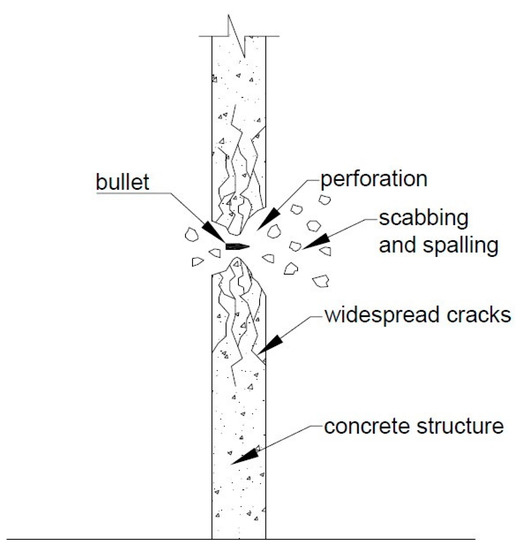

A good absorption layer(s) is what you need. Something to absorb the energy so that the impact on the concrete is minimal. Like almost everything, the strength is in the sum of the parts.
Layering be yer frind agin.
Concrete, rubber, wood, ceramic plates, kevlar, dirt and rocks, sand (especially wet). Also, keeping a small separation between layers helps prevent shock being transferred to the next layer.
