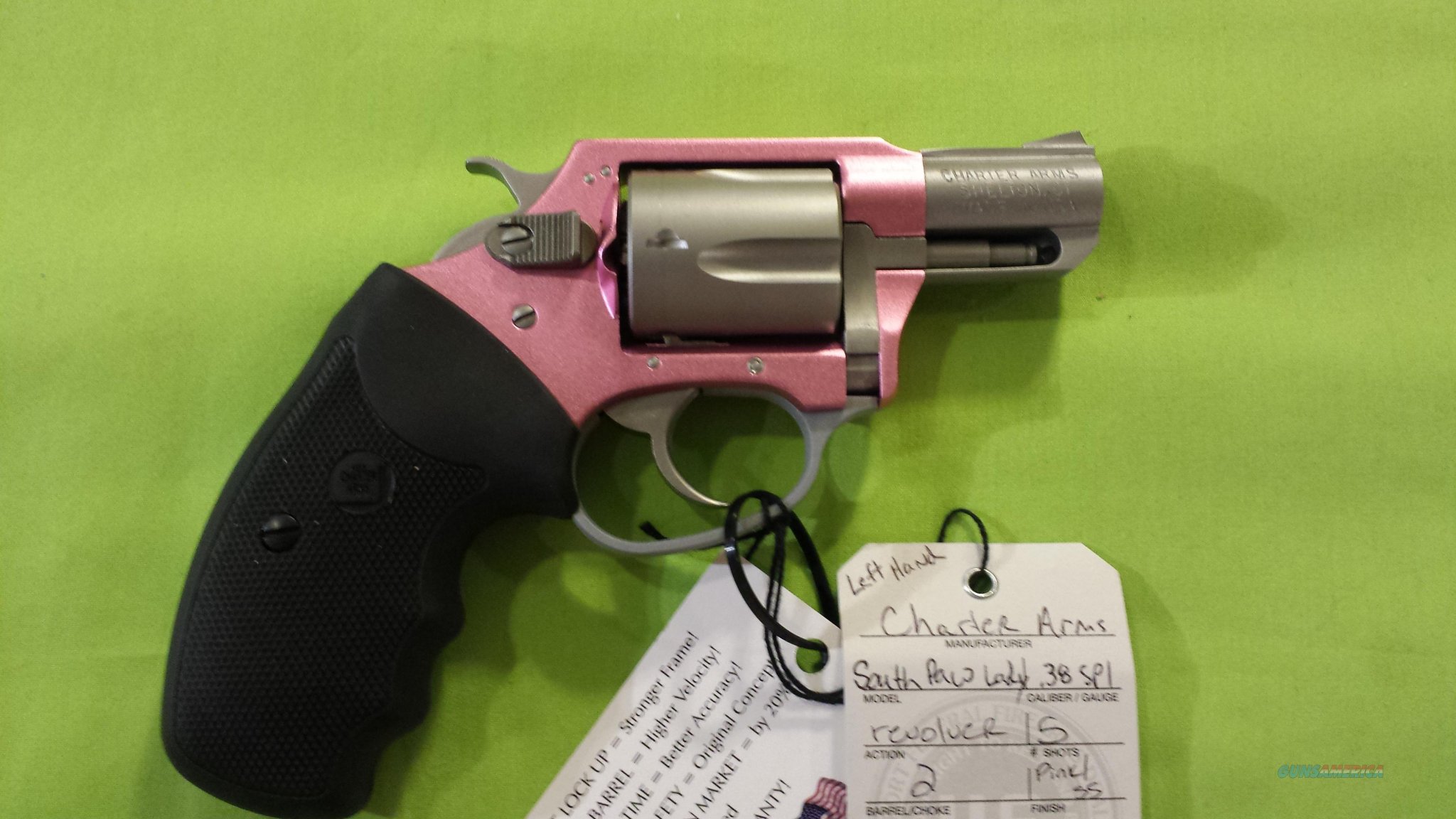

I got asked if we sold left handed revolvers...
Yes, they are manufactured.

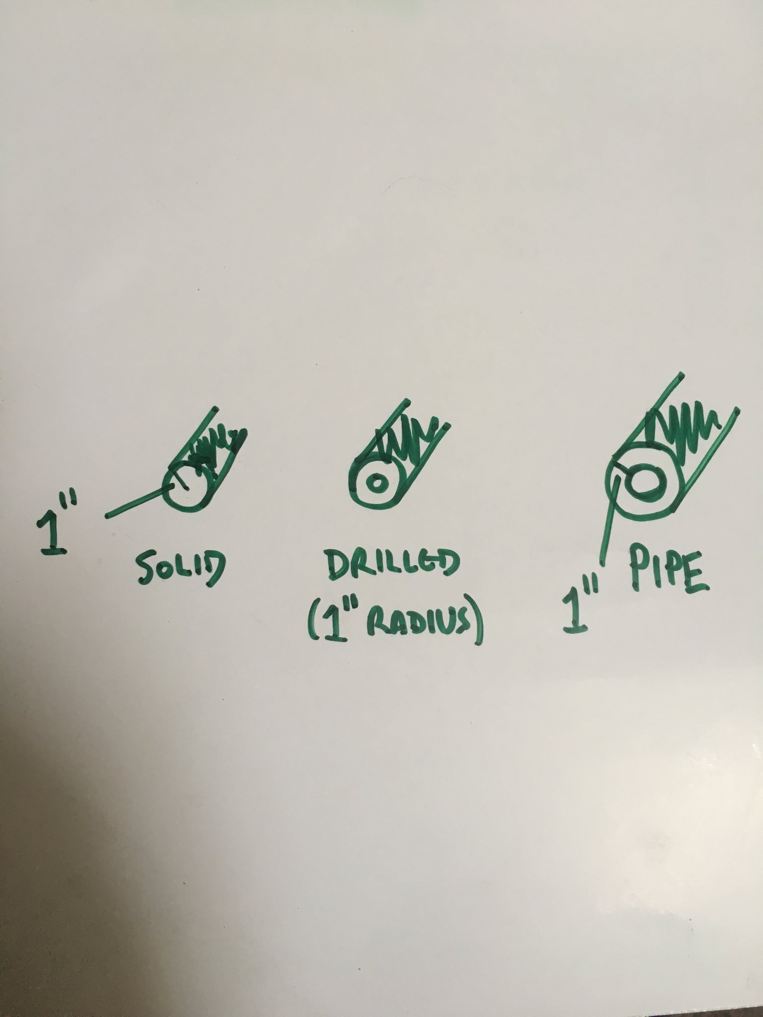

To Milo, as an extreme example, take a piece of 1in pipe vs a piece of 1in round stock, and it's easier to see why one with a hole through it is easier to bend. But I agree, when just picturing it in my head, a drilled blank seems like it would be harder to bend.
^^the above post explains it nicely. An I-beam 12 inches high and 8 inches wide is no way stronger than a solid beam 12 inches high and 8 inches wide. But the solid beam would also likely weigh about 3x as much as the i-beam. However, if you liquified that same solid beam and molded or forged it into an I-beam shape of same length, then it would indeed be stronger.
