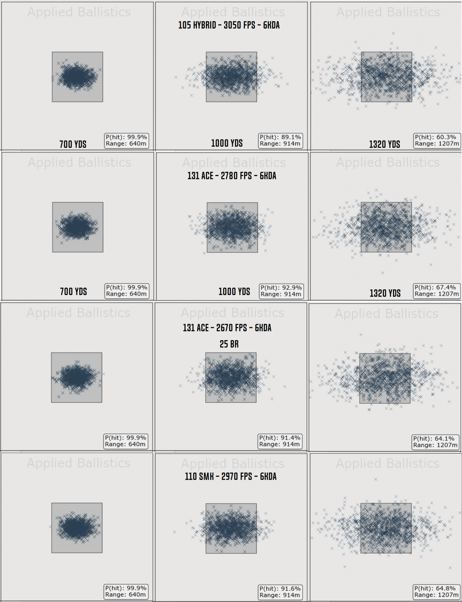

I can factually state that the 131 ACE is more efficient than Hornady, Berger, and most Sierra's in the right circles, but due to the attitudes in this thread it's not the place to be doing so, despite the facts of performance and form factor.
Matches have gotten shorter over time as the 6 grew in popularity and hits were not being scored or seen at long ranges and 6mm is generally the king for how matches are shot now, but we didn't design and execute this business to beat 6mm at short to medium range trajectory. I have a few killer 6mm designs we will eventually make if other MFGs do not, but that is for another day.
The high performance 25 cal bullets that exist and will exist in the future will blend the barrel life of large diameter calibers and available BC with the speed of a lighter bullet.
Considering performance out of a short action vs recoil, 25 cal is and will be in the Goldie Locks Zone for hit probability and increased energy at longer ranges to 1500-1700 yds and a great low recoil high performance for low recoil medium game hunting to ethical ranges. These statements are simply based on performance #'s.
Define balanced performance however you want.
For me, 0.345 G7 at 3050 fps in 2.880" magazine using standard boltface cases with 10 lbs of recoil and higher kinetic energy than any 6.5 standard bolt face short action - that is quite indicative of balanced performance or a Sweet Spot.

If you scaled up our 131 ACE it would be 142 gr 0.264 and carry 0.350 G7, which does not suck. Scale down to 0.243 it would be a 0.326 G7 and 111 grains, which does not suck. The 6mm print we have is not 111 grains, but we won't get to it for a couple of years.

How is it bogus BC numbers when you have a ton of customers proving that they had to actually use a higher BC value to get their dope to line up? Black Jack advertised a lower BC than what reality is showing. That is contrary to what Nosler and the likes have done in the past. What is your actual beef? If its b/c you think he's fabricating the BC of the bullet, there are other threads with plenty of people shooting that bullet that will tell you otherwise. You are very combative in your statements. You sound hurt.

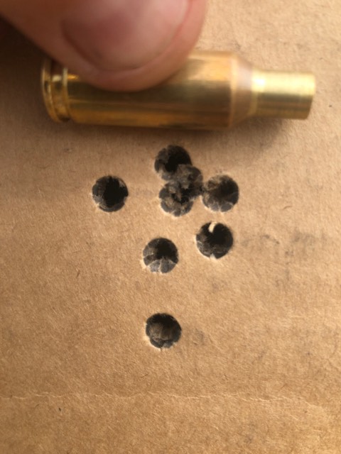

Respectfully, I was a skeptic. I thought my buddy was full of shit because he had been talking a bout a .25 high BC bullet being needed for years. I looked at data and quickly changed my mind. I can argue about marketing bull shit and grandstanding but I can’t argue with data. Some say the manufacturer is skewing the data because he is in control however there are several independent reports verifying this data. Unless there is a conspiracy theory in which shooters are saying the bullet performs better then it does, I choose to believe the data. Let’s look at how we as a group react to items related to shooting that don’t impress us. We tear them apart and start threads complaining and warning others. If I paid $700 for a barrel to shoot ONE bullet, 500 Peterson brass, and 2000 blackjack bullets and this fucking round sucks I will be bitching trust me.
Plug this bullet into whatever calculator you want and compare it. Look at DATA. Put emotions aside.

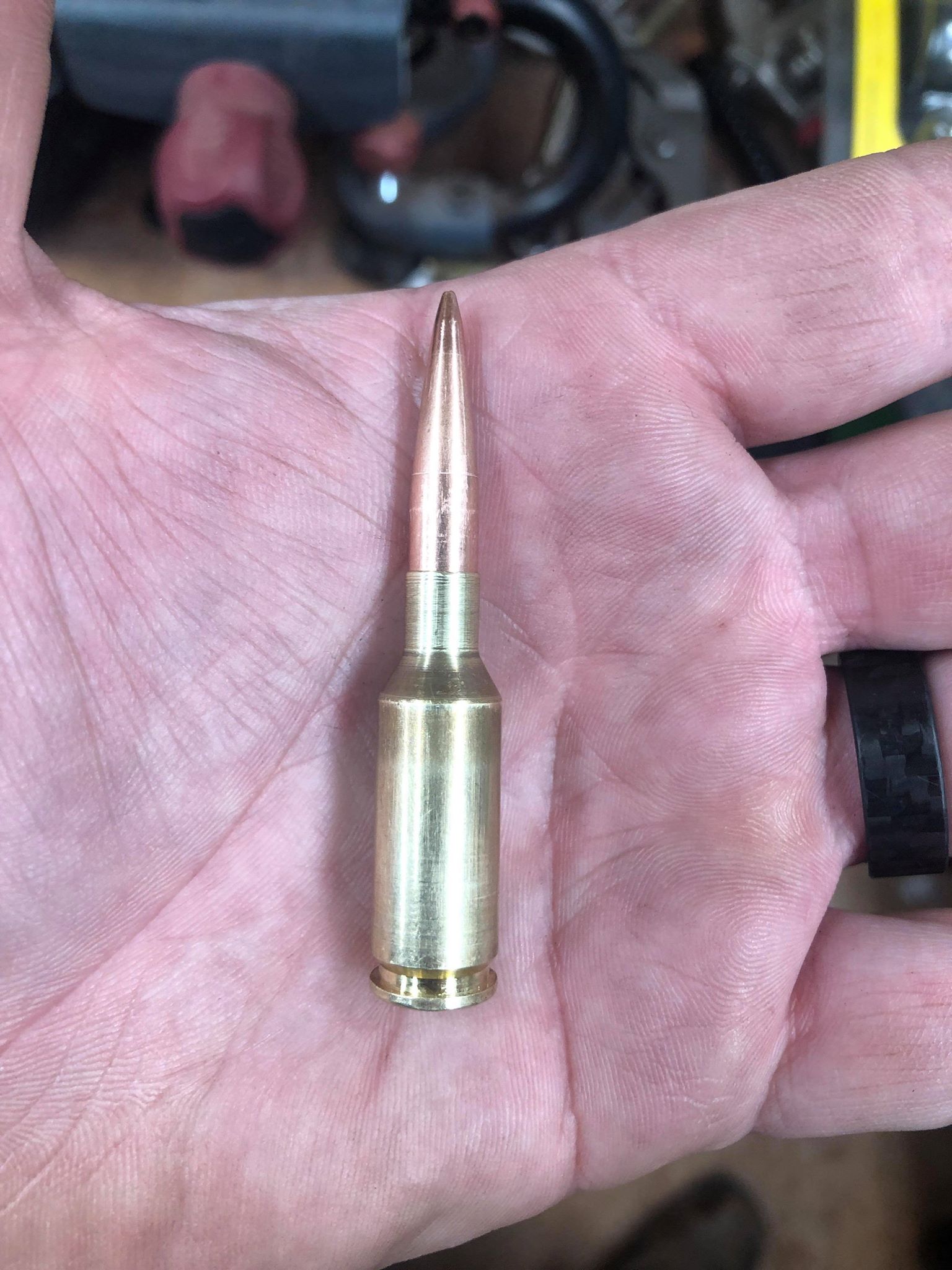

Just got these pics in from an excited shooter. 400 yards from a 25 BR, lol. This little guy is only running 2670 fps for accuracy (2745 showed a little pressure), but seeing a guy thrilled and excited to try stuff out makes my day. Makes all the energy, time, and $$$ worth every minute and red cent.
Ha, that actually looks like a fun little round. Ballistics for wind drift are right in there with a Dasher DTAC, touch more recoil and a touch more energy on target. Big bullet going so slow it would be super easy to watch trace. Bet it's got forever barrel life too.
I could see running something like that in PRS.
This is from a brand new Lilja 3 Groove. Shooter builds a lot of guns. He expects it to speed up a bit but he's quite happy.
His intention was to make an easy brass prep, easy loading, and very low recoiling rifle with great barrel life. For his purposes this little 25 BR will fit the bill.
I need a little more speed lol but different strokes for different folks.
We do have some cats that are spinning up 25 Dashers soon too. I don't have the time for a 25 dasher but i'm glad there's guys out there willing to check it out.

Here's a quick look at the results of my initial validation out to 900 yds with both predicted and validated drops

Here is a small snapshot of an updated Overbore Index with 25x47L, 25 Creed, 25-260 or 25 SLR, and you can clearly see 25-06 and 25x284 are HOT! Fun but HOT!
Figured I would drop this here so SH folks might have it at their disposal.
