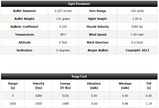

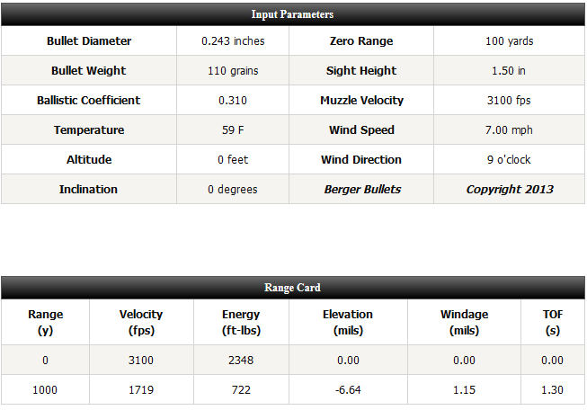

I think the 2 below should have a fairly comparably short barrel life, but dam fun while they last.
6 Creed @ 3100 with 110smk (not posative about G7 best guess)
25SST from a 25" Bartlain 7.5T @ 2.860 COAL
