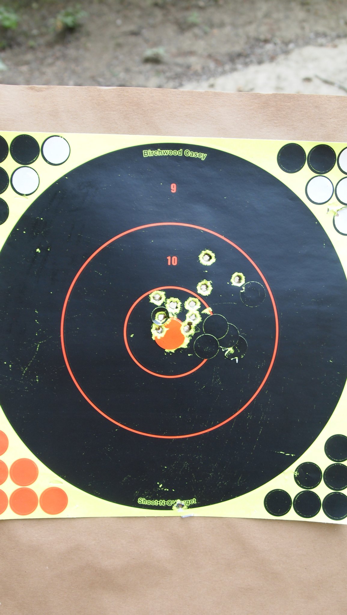

Made it to 100 yards this past weekend...
Shot some Fed Fusion hunter grade 150 grain lead tip to confirm sight settings....
Moved to the Creedmoor 167 Scenar in Lapua cases, match ammo...
I was impressed that 5 shots went into a tight knot and that when I pull shots they actually hit my point of aim. For iron sights I think it does well.

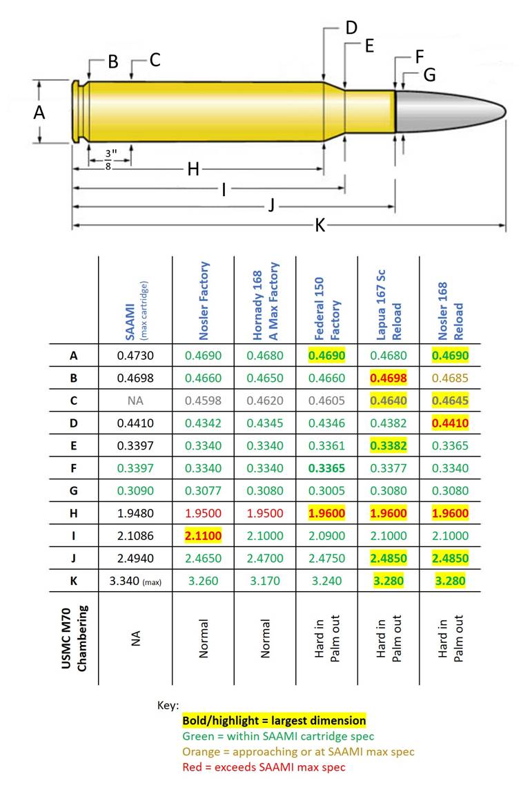

My builder did some analysis on a few rounds of ammo I sent him.
My reloads wont even chamber. The brass is on its fourth firing and it appears the Dillon dies, with their chamfered bottoms may not squeeze the case base enough for a tight match chamber.
Whats more distressing is that factory made match ammo (Creedmoor Sports 167 gran Lapua scenars in new Lapua 30-06 brass will chamber and fire but it requires hard palming the bolt open to extract/eject.
This is the neat analysis my builder did.

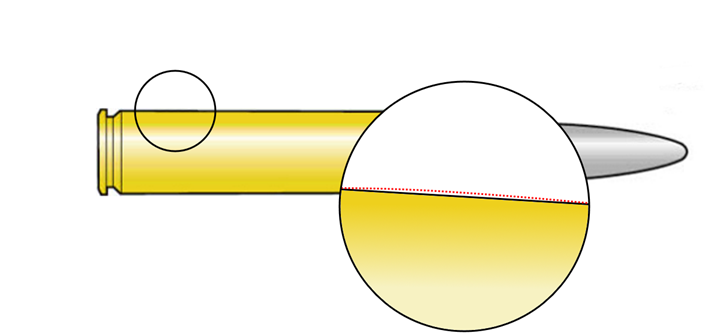

One picture shows the area where my brass is bowed out
One of my 168 Nosler CC reloads painted with marking fluid indicates the area of tightness. All looks well and good at the shoulder but just up from the base things get tight...
The builder took measurements off some rounds I sent him. The Federal 150 grn factory loads chamber/fire/extract fine. Creedmoor (factory, not a reload) chambers/fires but is very difficult to extract. My 168 Noslers only let the bolt close halfway before the handle comes to a stop.
The data shows my ammo doesnt compare unfavorably to the Creedmoor stuff which is very good ammo and shot well in this gun.
Im willing to add a Redding die after my Dillon size die and see if I can make my reloads a little tighter at Area C.
Still though I need this rifle to chamber/fire/extract a factory offering such as the CMP Lapua offering. Im buying a few hundred rounds of the Lapua match and those cases will be dedicated as reloads for this rifle.

The builder used another reamer on it that is not so much under SAAMI spec and he gave it another dose of fine polish.
I hope that gets the Lapuas shooting 100 percent.
Im going to correct my reloads - make them less Garand ready more bolt gun suitable.
That Douglas barrel is going to put the bullets where they need to go if I can hold it.

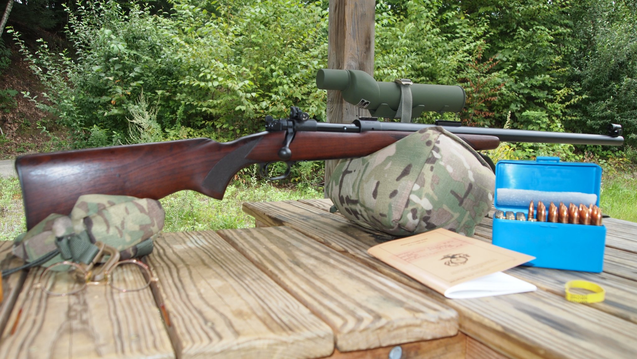

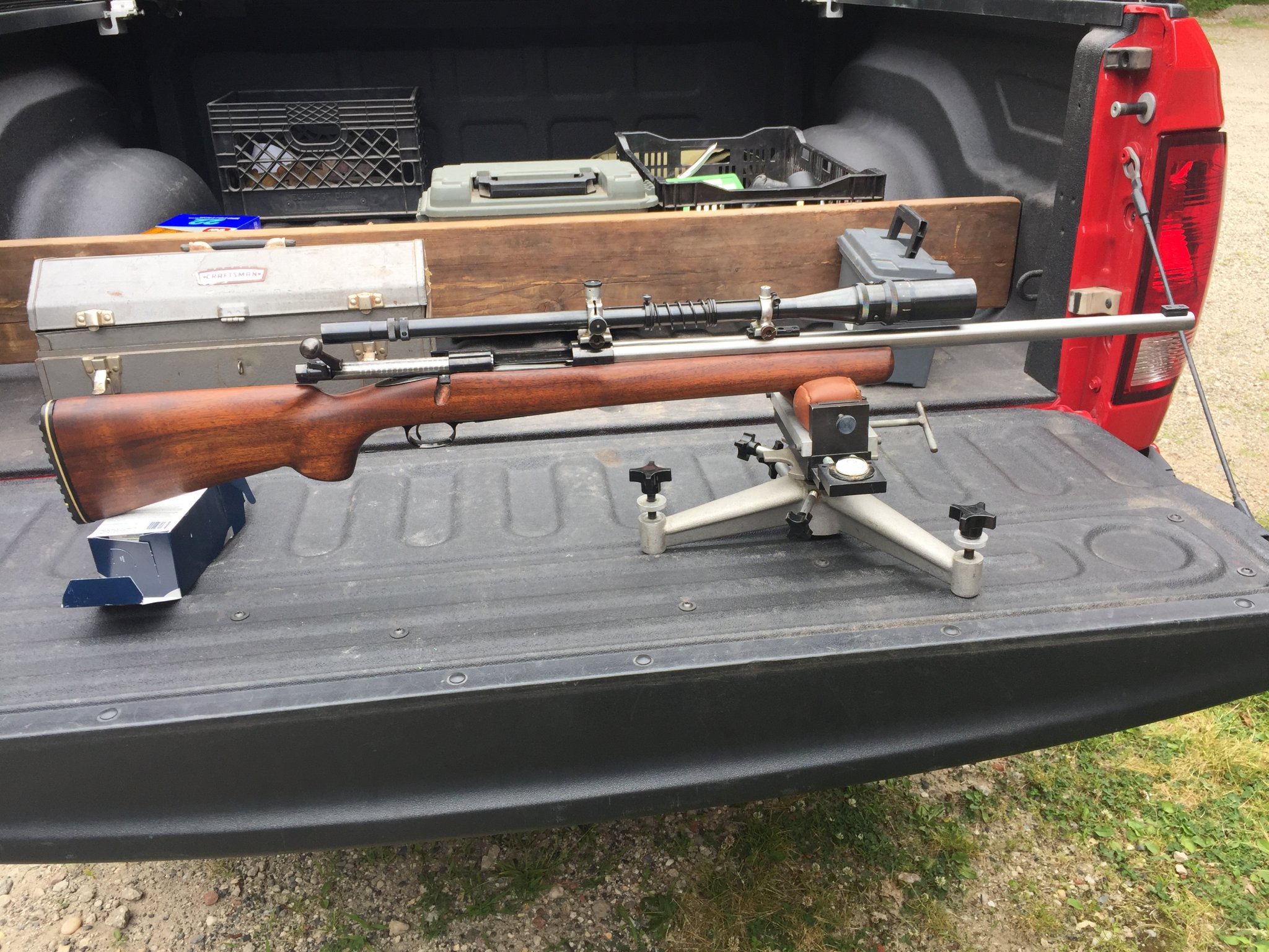

What started out as this;
Now looks like this;
Thanks to Justin at pre64win.com. Inletted, pillar bedded, and coated the action. Today was the first chance I had to shoot it.

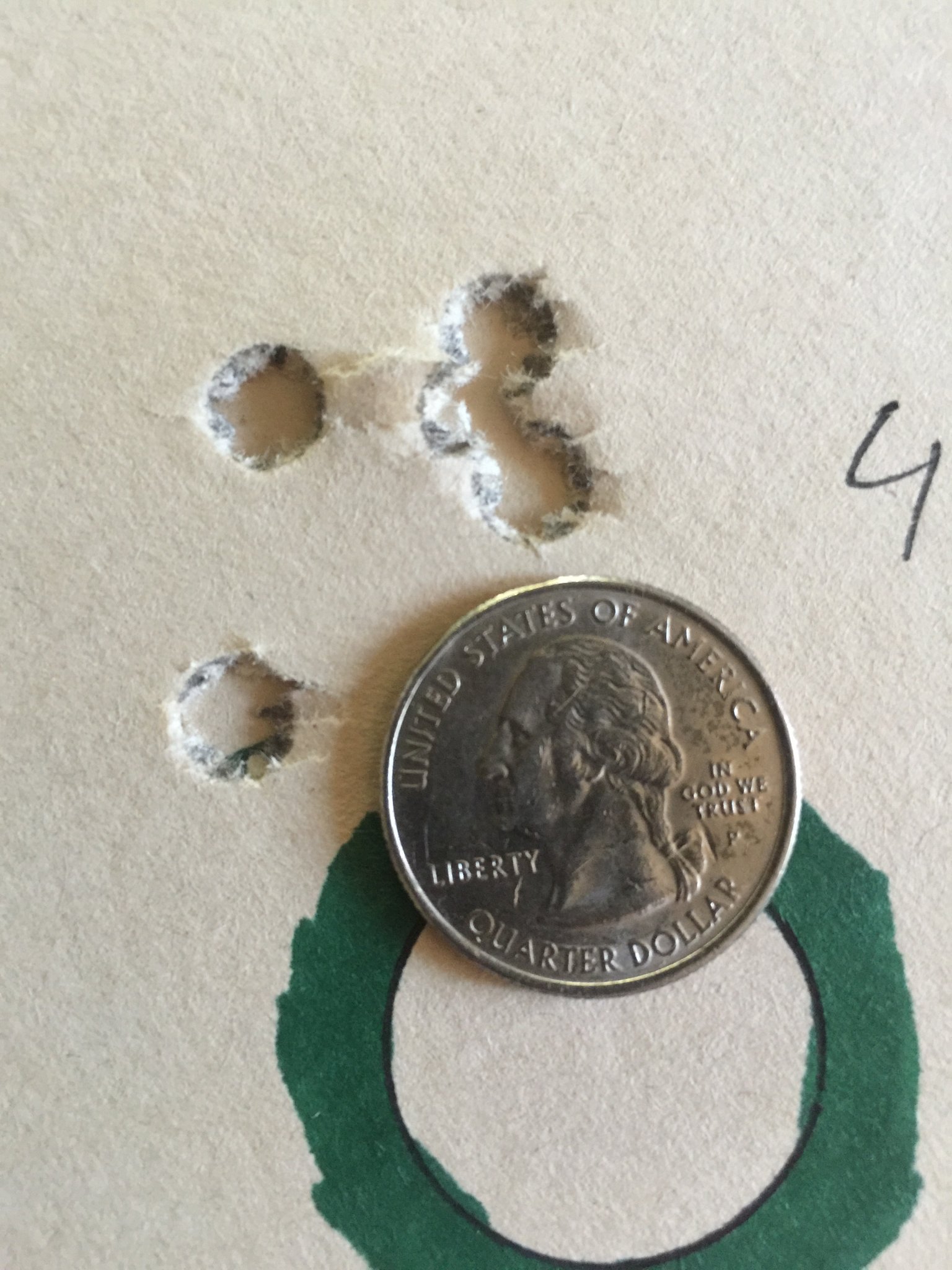

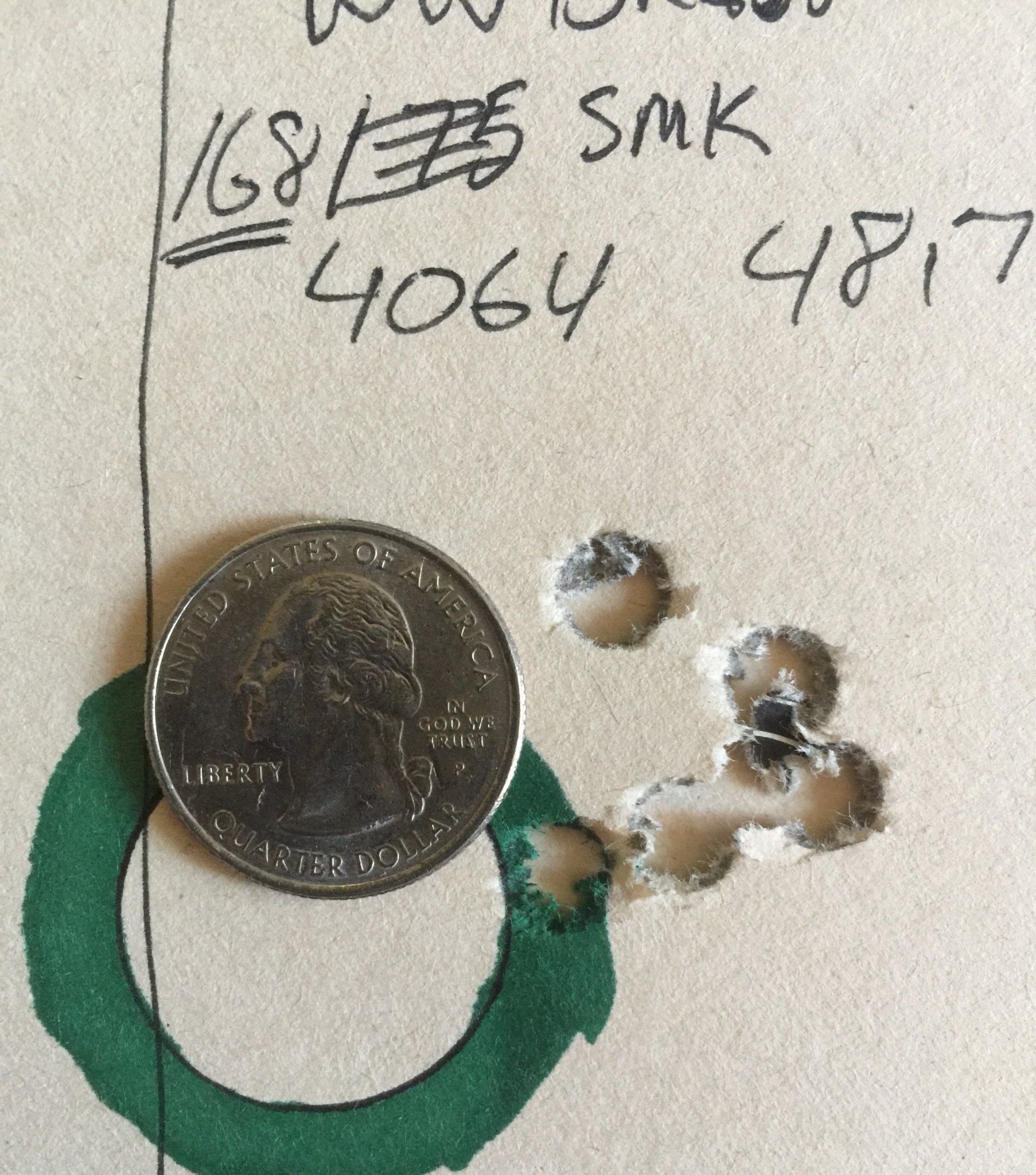

and it shoots!
the first is 175 sierras LCMatch brass and I4895, the second is 168's 4064 and Win brass

The ammo :
first pic, LC match brass fed 210 47.4 gr IMR 4895 175 sierra
second Win brass IMR 4064 48.7 gr fed 210 and 168 sierra. all shot at 100 yards.
Douglas barrel 1-10 24" same specs as the M70 sniper rifles of Viet Nam.

Just a thought on your reloading issue. With the tight chamber and the bow where you show it, I've come across something very similar. I'm using small base dies for my .308, which isn't good unless you need them. In my case I was noticing the mouth of the die was so tight it was pushing a wave, just like yours down the sides of the cases.
I backed the dies off to where they only neck size halfway down the neck. It's not optimal, but the cases fit. I was finding that anywhere in between full "cam-over" and where I have them at now for neck sizing, the cases would not re-chamber in the rifle. I reduced the loads even more to prevent ANY brass stretch with the neck sizing, and that seems to be working. It's been a pain in the ass ever since I started with this rifle. Probably more the dies....:mad:

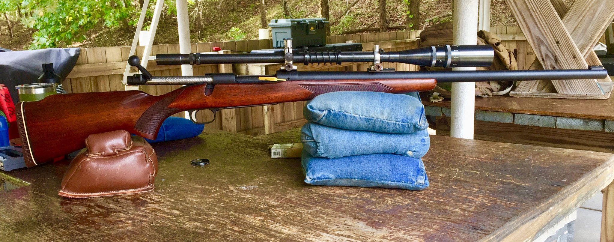

Yes you are and I am jealous! I owned a post-'64 Mod 70 in 264 WM and loved that rifle. Good shooter, and I miss it in every way except the recoil. :) Congratulations and good luck with the build.
Don’t fear the Unertl. They are great scopes and accuracy can be quite good by any standards. Not nearly as fragile as most seem to think.

The last picture is just me checking my sight settings to 200 yards.
A Unertl in good repair will dial right with a S&B of today for repeatability and accuracy.
If you can get to view the bottom of the photo with the squirrels note they are all headshot and most if not all in eye. That Unertl/52 combo has killed over 1000 squirrels in my hands and never shot one anywhere but head. Inside 70 yards almost all shot in eye.
Don't doubt the Unertl!
