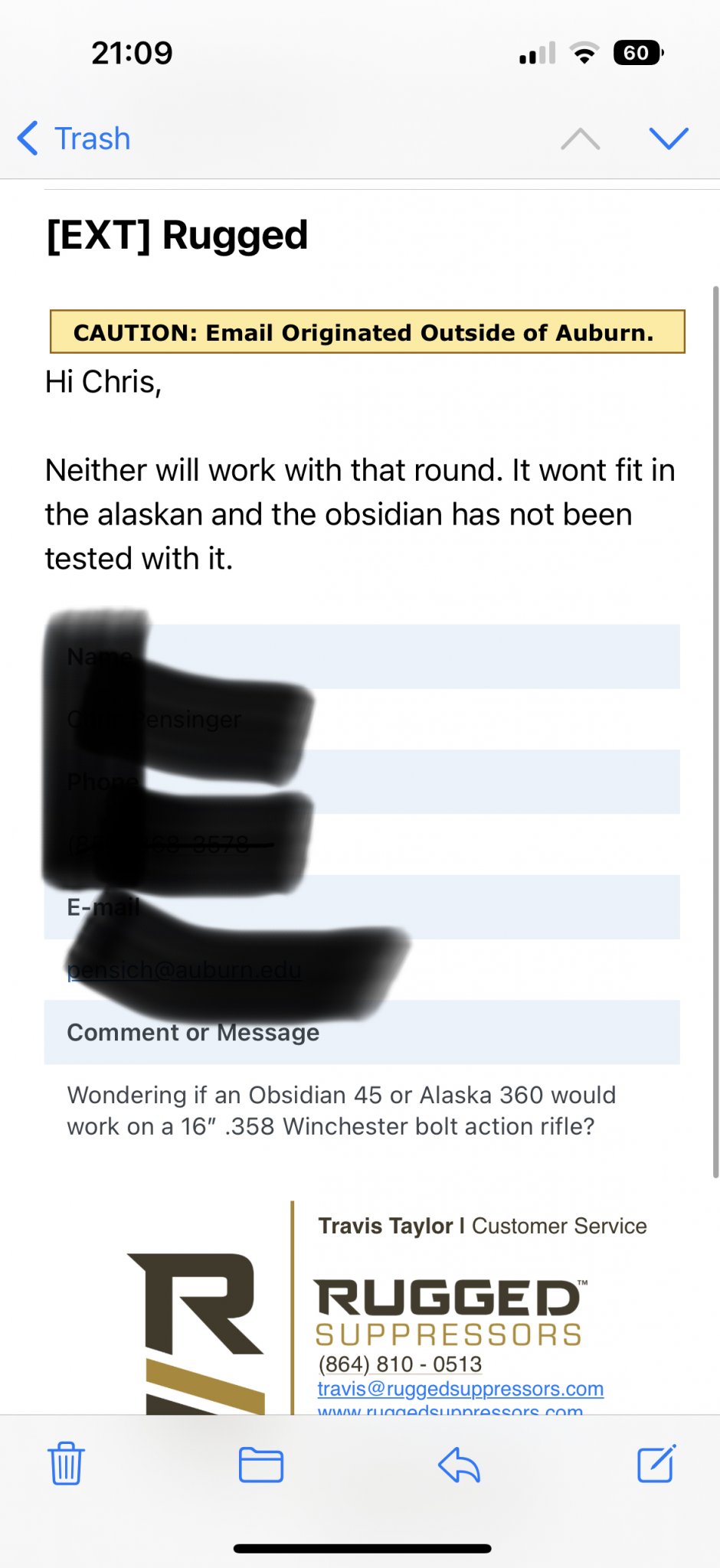

I have a Kimber 84M that started life as a 243. I had it rebored to 358 Win and shortened to 16.1”. It’s barely over 5.5 lbs with a Trijicon Credo 3-9 on it. It’s a fun deer and hog rifle. I don’t mind the recoil, but I do mine the noise.
Wondering if I could make do with a YHM R9? I reach out to them, and the answer was…maybe. Wondering if anyone has experience, maybe no one does. I’d like to keep the can short and light. I know it will still be loud, but I just want to lower the amount of brain scrambling boom it has.
Open to suggestions on other cans. I have thought about just getting an R9 with them being so cheap and having a machinist friend open it up to .36 to be safe.

SilencerCo just told me that the 36M is bored out to .360, but that they recommend not using any projectiles bigger than .357 and that .358 would be at my own risk.
Sorry, but I think you must have been talking to some new guy with very little technical knowledge of suppressors. Anyone telling you that .357" is OK but .358" might not be, knows nothing about suppressor bore clearances. Any 9mm suppressor that will handle the pressure will handle the tiny diameter difference with no issue.

Rugged told me it would not work, I asked specifically about the new Ti.
Did they give a reason? I'd have thought this wouldn't be a problem considering that it's rated for .338LM. Now I'm gonna need to drop a pin gauge in mine and see just how tight the bore is.
I think they just weren’t aware of what it is. A 358 Win is not some magnum extra long action blaster.
I can understand not recommending the Obsidian 45 due to uncorking pressure (it's generally not rated for big-boy rifle rounds), but to say that it won't fit through the Alaskan 360 is weird. I guess that extra 0.003" of bullet diameter over a standard 9mm is just too much :rolleyes:
I can't help but wonder if the person answering the question was just a secretary or shipping person, and not someone actually familiar with the technical details.
I've seen comments before on various forums to the effect of "38 Special won't fit in 9mm cans" or something of similar effect about .358" rifle bullets too, but of course it's always by someone relatively unfamiliar with suppressors and caliber sizes. It's a bit surprising to me that it's such a common opinion, but maybe the responder was one of those people?
With a typical clearance of about .040" or more over maximum caliber size, the difference between .355" and .358" doesn't mean squat as long as the suppressor can handle the pressure. Personally I'd be inclined to either just use it anyway (it'll obviously handle .358 Win if it's rated for .338 LM) or have a conversation with the head honchos at Rugged, depending how ornery I felt that day.

I just checked an Alaskan 360Ti with pin gages, and the first baffle has a bore of 0.428" (0.001" bigger than the Obsidian9 in my inventory). Seems big enough for a 0.358" bullet, but I'm not the guy who has to provide warranty service.
. . . have a conversation with the head honchos at Rugged, depending how ornery I felt that day.
Yeah I think the resident math nerd was OOO when you got that email. None of that adds up.
