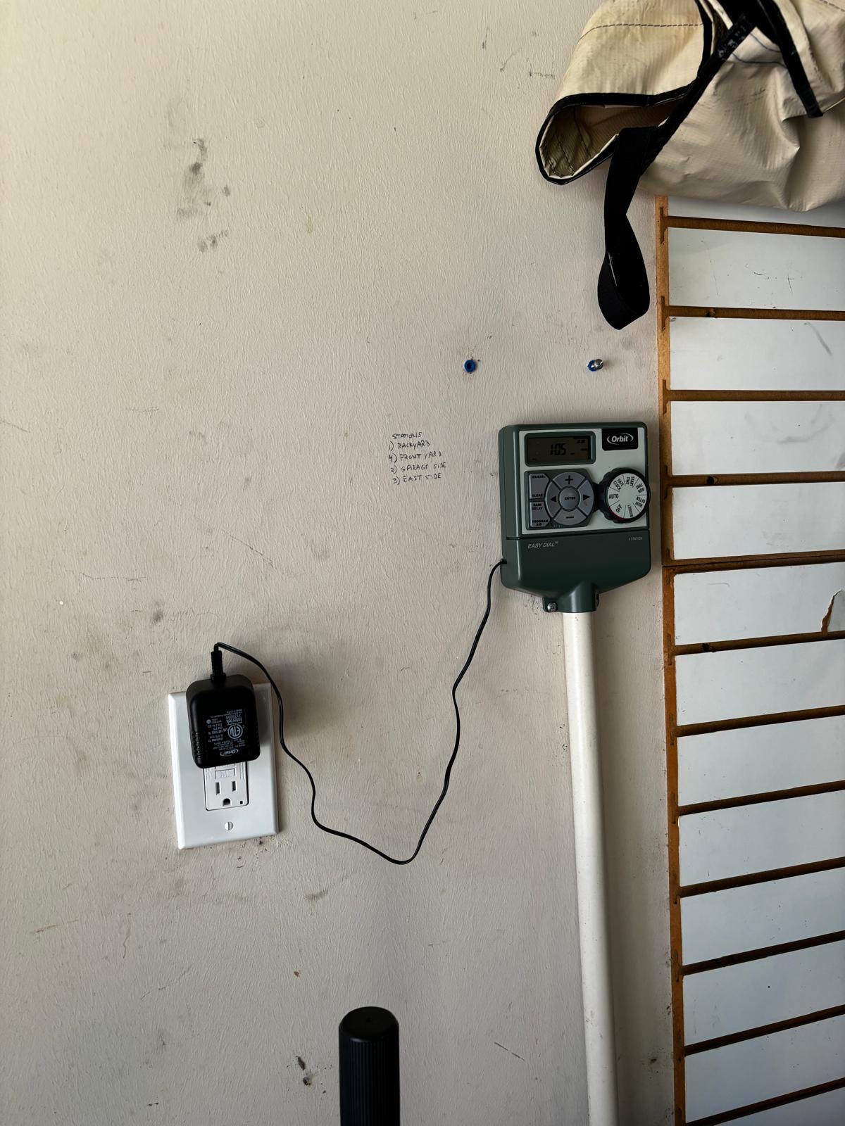

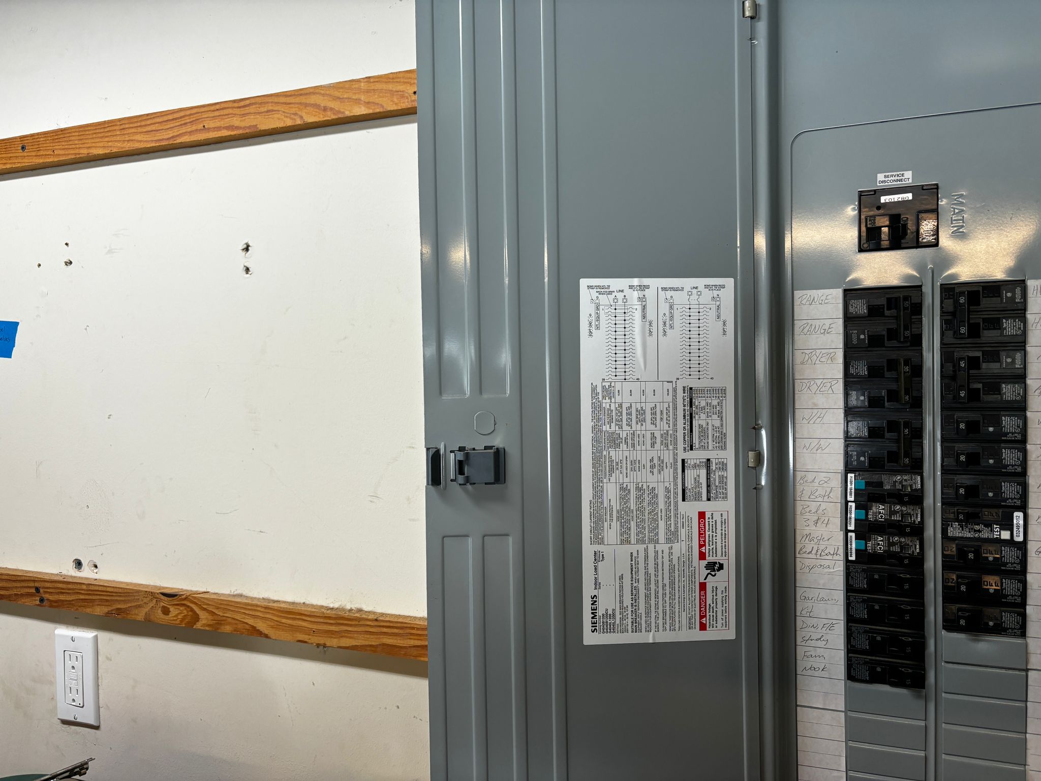

A year ago the garage wall outlet with GFI was constantly tripping after rain or sprinklers. Property management sent electrician to fix.

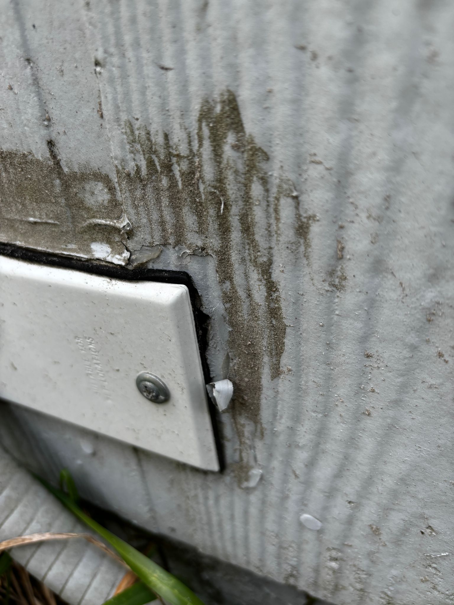

Determined the outside outlet in rear exterior wall was not sealed properly and tripping the garage GFI (yes the exterior outlets were on same circuit as 2 garage outlets. And additionally the shower light/fan assembly in master bathroom because it shares wall with garage.)
electrician said he rewired the garage outlet circuit to a different breaker.

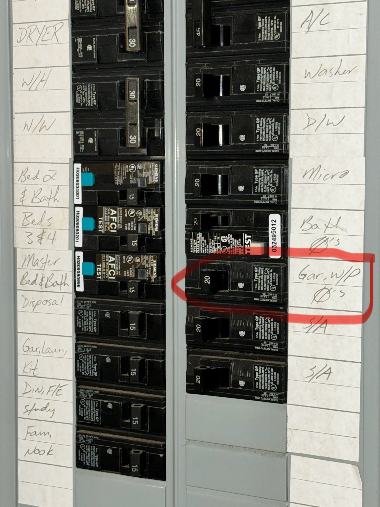

But now a year later the GFI on the garage outlet (on same circuit as shower fan) has been occasionally tripped and today the 20 amp breaker has tripped and won’t reset.
Any idea what the “WP” refers to on the breaker box?
Also, the lawn has a Sprinkler system
I know I shouldn't say this, but GFI outlets are garbage. I would replace it with a standard outlet as long as it's in a weatherproof box OR if it's inside the garage even that wouldn't matter.
HOWEVER, if you're renting probably better off legally to not touch any of it and let the landlord deal with it.
As for WP--no clue
ETA: weather proof---So obvious that I didn't think of it
Home im renting
I’m no electrician either but I saw one on TV once.
It looks to me like the electrician may have mislead you. I read that as the garage and weatherproof outlets are on that circuit. There’s a short in one of them that must be properly repaired this time and the breaker should also be replaced.
My experience running facilities taught me not to scrimp on electrical repairs. Landlords notoriously do so to save money.
Probably weather proof.
Could be exterior outlet. If it was getting wet and not replaced there is probably corrosion that is causing this.
It's notorious for something to be plugged into an exterior plug and the face of the plug is all corroded or the inside of the plug is corroded.
Usually fastest way to trouble shoot.
Unplug anything connected to plugs that are on that circuit and see if it will stay hot.

W Replace with a regular breaker and see if it fixes it. If it still trips there is a serious problem like water has probably corroded a wire and its arcing somewhere. If not it could either be a shit breaker or a less serious problem, that could still burn the house down. Bump your renters insurance up.
Reactions: mikeinfwa
Replaced a couple of years ago with the one in the photo. The box is reset into brick, my plan is to mount a double size weather proof box over the top 🔝 f the existing single box this time. Circuit never tripped, and this one was still hot when removed. Will use WR rated for replacement.

OMG, please tell me you followed NONE of the advice given here…
Get an electrician out there to troubleshoot the circuit. The breaker you circled is not a gfci breaker so you are drawing an overcurrent somewhere in the circuit. It is possible that the breaker is weak but not likely considering your other issues mentioned. In the meantime disconnect anything plugged into that circuit and see if that clears the problem by chance. It sounds more like a moisture/water problem somewhere that could take some time to track down. If you are aware of any leaks or water infiltration that would be a good place to start.

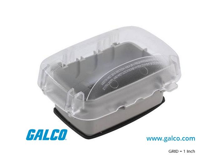

Another important thing that must be done is to have in-use covers on outside outlets. This allows having a cord plugged in without exposing the outlets to rain.
Also, outlets installed outside should be weather resistant / tamper resistant. They have membranes that ward off rain when a cord cap is not plugged in.

You have a Siemens panel. Technically, it will take Siemens, Homeline, and Cutler Hammer BR. But Siemens will fit in the dead front (front plate you see around the breakers.)

The GFI outlet lower left is connected to the outside outlets. This GFI would occasionally trip over the past few months. Last night I found the 20 amp breaker popped and it wont reset.
Pic below is the backyard outlet the electrician removed and installed a cover. It appears the seal has failed and allows water to creep in.

That may not be the culprit. The wires should be either capped off in there or completely isolated. I have seen people do some pretty sketchy stuff that doesn't last. Where is the irrigation system connected?
The sprinkler controller is located inside garage. Also connected to the same circuit as the outside outlets and the GFI outlet next to breaker box
I unplugged the controller unit and tried to reset the breaker but it still tripped.
And the sprinkler system is connected to the same Garage/WP breaker
