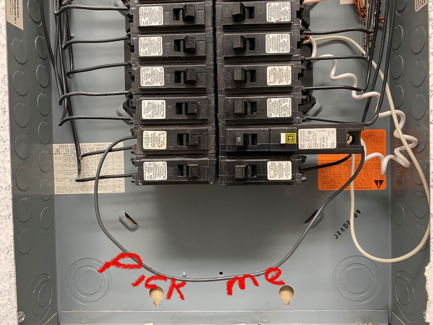

OMG, please tell me you followed NONE of the advice given here…
Get an electrician out there to troubleshoot the circuit. The breaker you circled is not a gfci breaker so you are drawing an overcurrent somewhere in the circuit. It is possible that the breaker is weak but not likely considering your other issues mentioned. In the meantime disconnect anything plugged into that circuit and see if that clears the problem by chance. It sounds more like a moisture/water problem somewhere that could take some time to track down. If you are aware of any leaks or water infiltration that would be a good place to start.
Good luck, hopefully you get fixed up quickly it could be dangerous to not have a fan in the bathroom if you’ve been eating spicy food.

Looks like Weather Proof Outlet..on the symbols.
Since its the only breaker tripped...you can not jumper it...it's internally tripped. Which is a problem, it won't reset for a reason. Usually shorted out, If just overload it would reset when things cool off.
That jumper idea is very dangerous, what if you hook up the wrong pole?
So...replace the wiring with a ground wire, plug, back to panel, to guarantee continuous ground, replace the GFI plug, replace the circuit breaker. Done...
It has to work cause it's the only problem in the electrical control panel.
Expose the breaker, pull the 4 screws out that hold the panel cover to the box.
Shut off the main breaker would be a good idea, to start for the amateur, but the lugs and bars at the top are still hot, 230 volts.
It can be done hot ...easy job for and electrician.
And with all the bad suggestions, I'd recommend an electrician.

Electrician found the cause.
Outdoor outlet on the patio went bad. wires were making contact with ground wire ?
Replaced the faulty outlet and all is working normal
I knew that was what problem was.
Anyway, so was this outlet not a problem before or did the other soi-disant electrician not catch it?
Good news to hear that it is fixed.

he cleaned up the wires inside the outlet and replaced the 20+ year old outlet.
I use this outlet to plug in my electric lawn mower. I'm guessing the outlet was moving around a bit while I walked the lawn ?
Anyway, the breaker doesnt trip anymore and that was the only change made to the circuit
