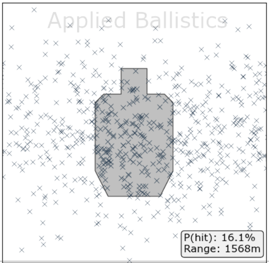

I want to get out to a mile with my M24r. Looking for 3-5 consecutive hits on an IPSC sized target. I have the optics problem solved (thanks nightforce), but there looks to be 2 methods for getting out to 1 mile accurately: the first would be a transonically stable bullet like a 185 Juggernaut, and dealing with massive wind drift. The other is trying to launch a 230 berger at 2500+. I'm not sure which path I should start down. Is a 208 amax the middle road? Advice welcome.
I've shot the factory Federal 185 Juggernauts a mile. I was good for 2 out of 5 hits with my 24" barrel bolt gun. So, as long as you have the scope turret elevation, you can do it. Just make sure you pick a calm day LOL! With something like the 230 Berger, I would be concerned that my rifling rate of twist wouldn't like it.

don't see why you could not shoot a mile with a 308 not sure about the accuracy you would end up with but if others can do you so can you .
I believe in you lol.
