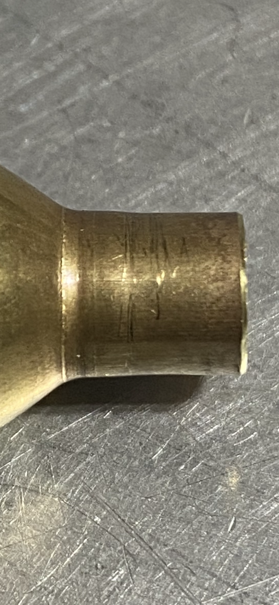

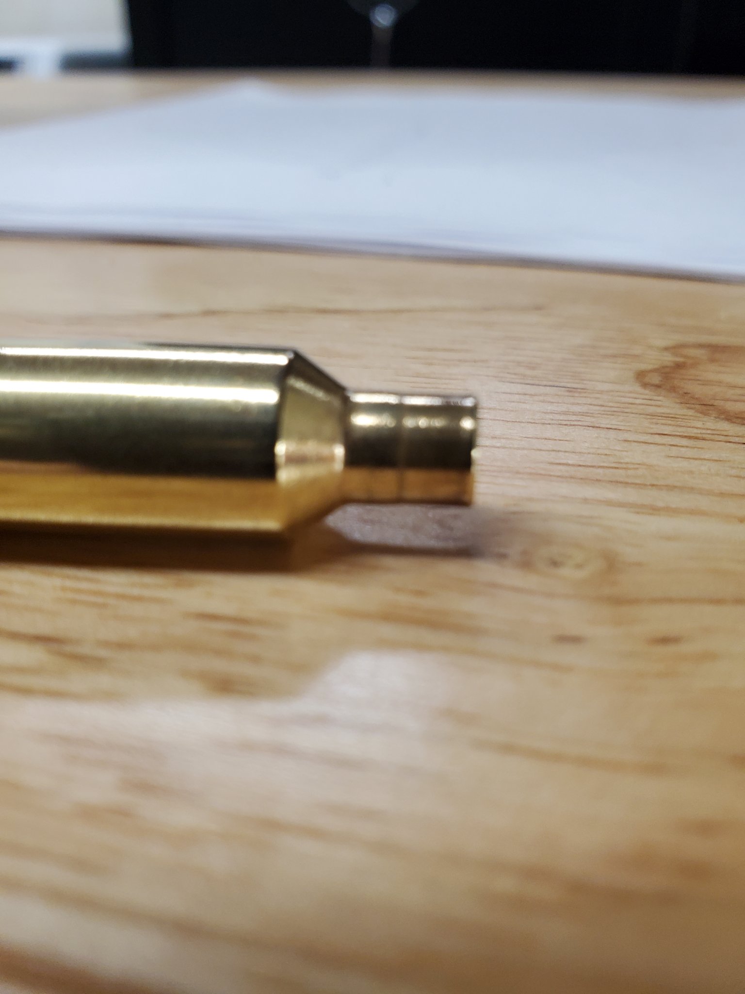

I got 15 firings from the Hornady brass before slight case head separations occurred on 7 out of 100.

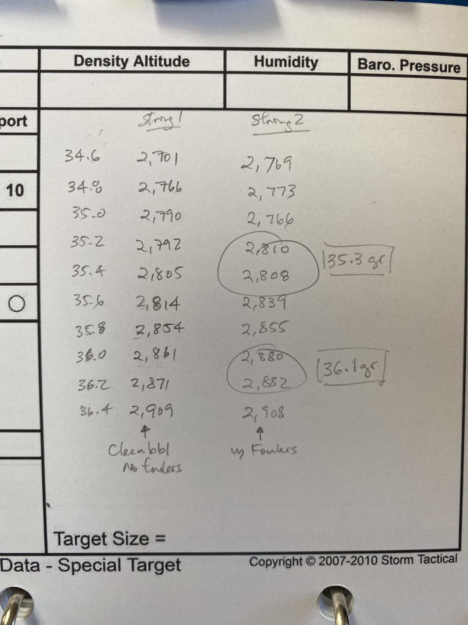

I’m no mathmatologist so could someone explain what it means when the line thingy goes more sideways than up in one of these? There’s been a few now. Not gonna lie I didn’t know how to do it until I saw the unknown munitions one a couple posts before.
Reactions: Juggerxxx
It means nothing. It's a Rorschach test... guys see what they want to see.
Some may call it a "node" they found using their "data"... but they'd be willfully ignoring the overwhelming likelihood that the anomaly they observed was just a simple coincidence, especially since it occurred while shooting a painfully small sample size of rounds (nowhere near enough to know anything or say anything with any certainty). Some of those same guys also speak of performing tedious and ridiculous rituals as essential to breaking in a new barrel. Some even claim to have possessed lots of bullets that went to sleep on them at inopportune times. Sleeping bullets. 🤔
If you want to burn 50rds worth of components and barrel life figuring out that, with that powder in that barrel, ~33 grains nets ~2850fps, and ~34gr nets ~2950... that's cool. Just know, you could've figured that out with 2 rounds, and then loaded 48 at your preferred speed.
Combustion requires fuel (powder), more fuel means more combustion, so more powder means more speed, derp. Combustion remaining constant while adding more fuel is not a thing (ask NASA).
If you ever run into an actual person educated and practiced in combustion and propulsion at a party, see how far you can get into explaining "nodes" and/or an "OCW test" before they spit out their drink laughing...

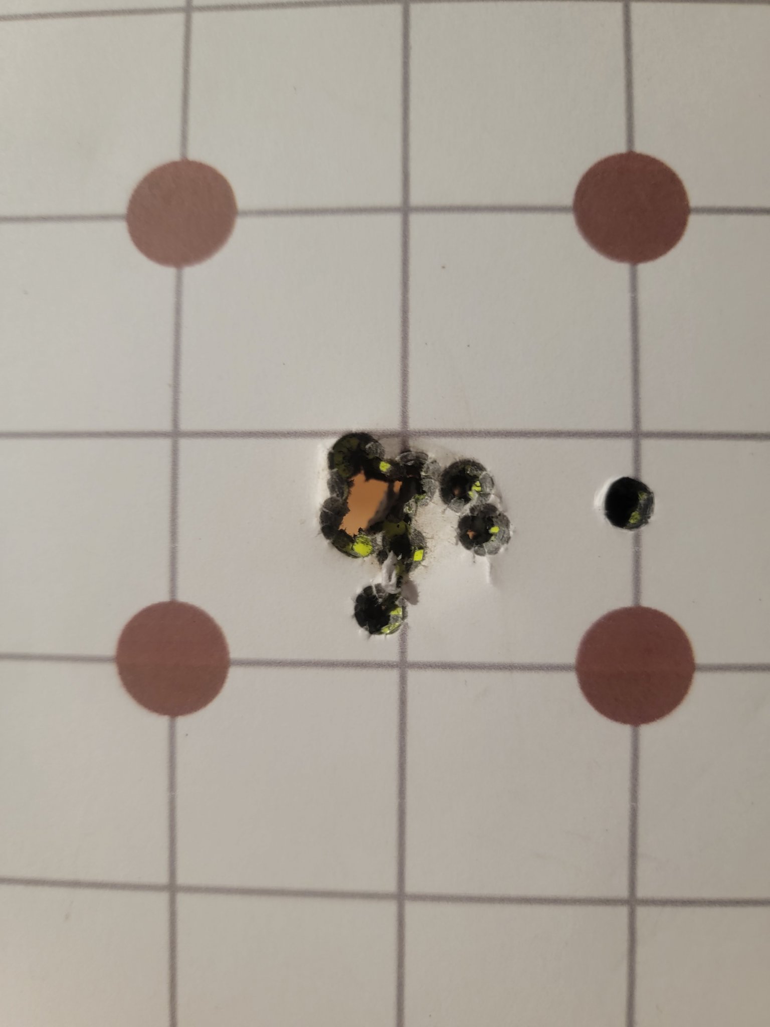

Went to the range to verify my drop with the new load. It’s not that fast but it definitely shoots good(2780fps). Our range only goes to 500yds so this’ll have to do till I get out to a friends range to check it at further distances.
Berger 109’s
Varget 32.6
CCI 450
.070 jump
Alpha brass twice fired
500yds 5 shots
450yds 3 shots

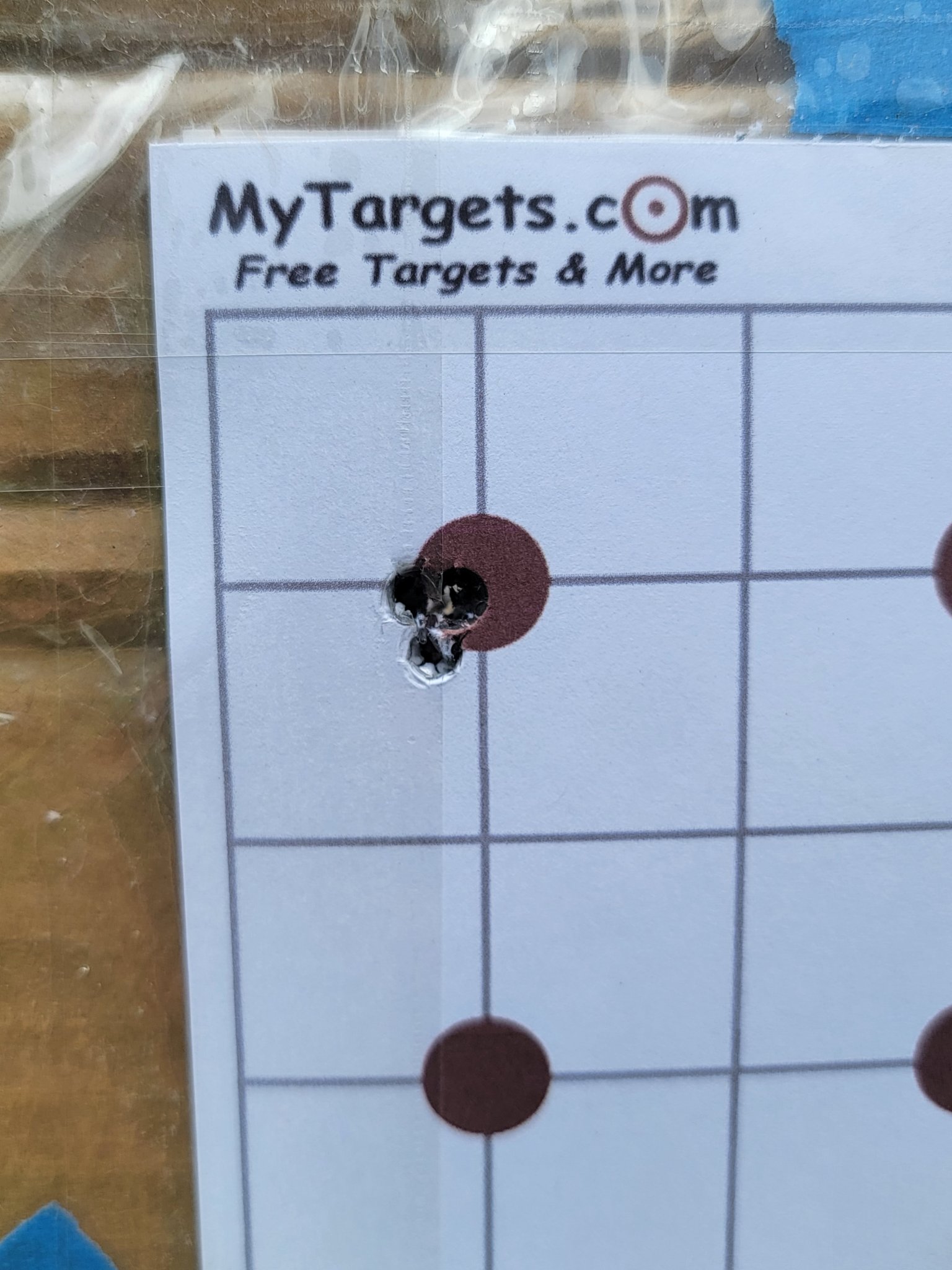

Alright brotatochips. Had to “qualify” the new rifle for the 1000 yard range per our range rules. Sub MOA 5 shot group at 100 yards and filling out a drop chart is all you need to do before you can take her to the 1k yard line. Then trued out the load in the kestrel and it said MV:2898 labradar said the 20 shot SD was 5.2. So do you fellas think my bullets are asleep or whatever?

Alright brotatochips. Had to “qualify” the new rifle for the 1000 yard range per our range rules. Sub MOA 5 shot group is all you need. Then trued out the load in the kestrel and it said MV:2898 labradar said the 20 shot SD was 5.2. So do you fellas think my bullets are asleep or whatever?
I almost missed the joke. For a minute there I couldn't figure out how shooting sub-MOA at 1000 yards and truing your load in a Kestrel turned into a pic of a 100 yard group lol.
An SD of 5.2 over 20 shots is awesome, but what did the results look like at 1000 yards (group/waterline, bench/prone, etc)..?
