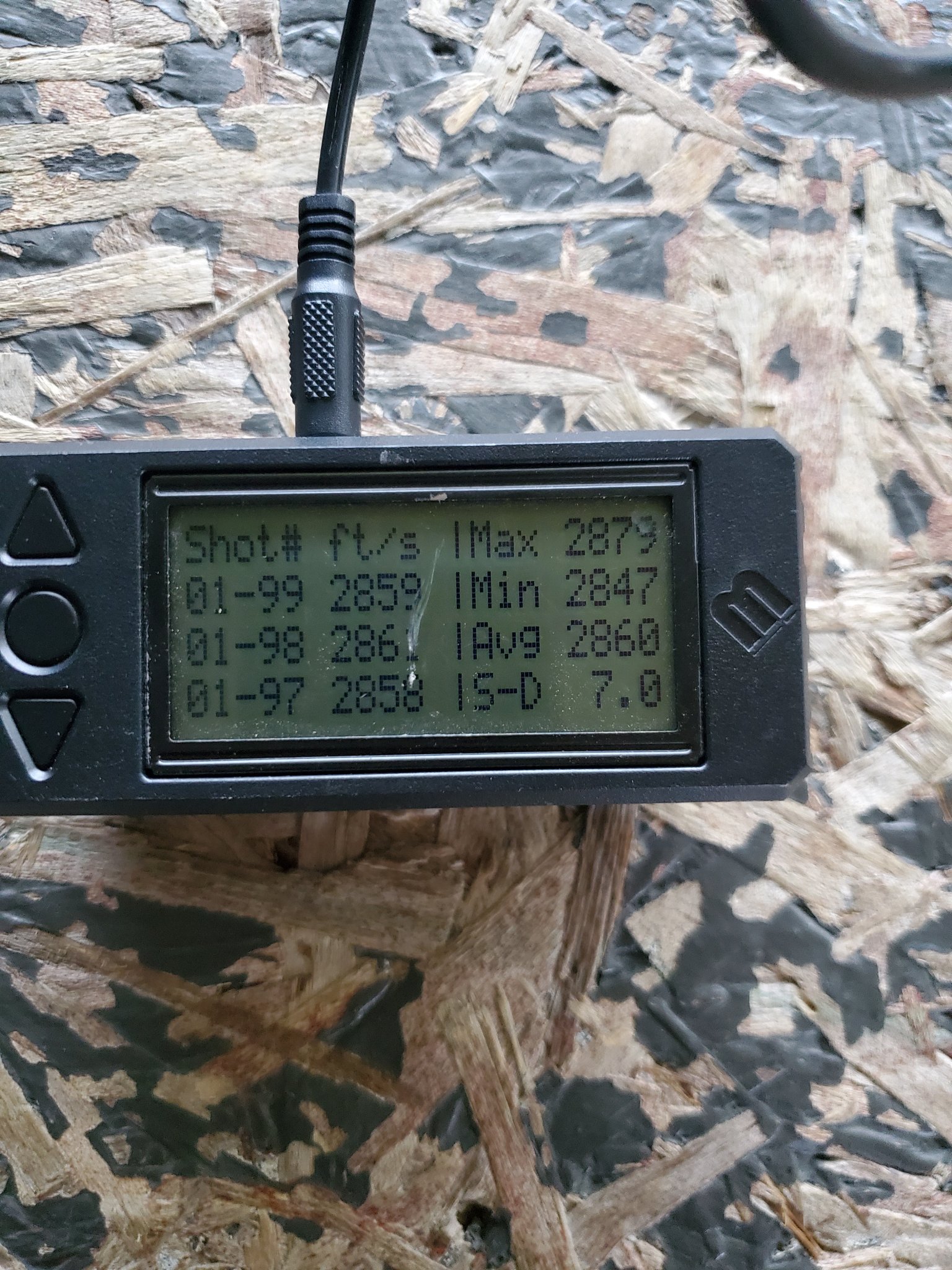

First attempt to download from load that I ran for last 2 years ( 36.7gr H4350 , 109 Berger, 2940fps)
Not happy with the SD or the velocity. I dropped down to 35.6 gr figuring that would put me right around 2850. Looks like i need to add about .3 more grains to get me to the target of 2825-2850. Groups were nice and tight but man I don't know why the SD is so high. Doing everything the same (Amp anneal, FL Bushing size, Mandrel, Henderson, Supertrickler, ect) with alpha brass and berger 109s. Running around 1.840 which is about .050 tho jump. Maybe its just a bad combo of jump and velocity.
Reactions: Malum Prohibitum
Perhaps try a faster burn rate to get the chamber pressure up a bit at that 2820-2850 range. 4166, varget, TS15.5 all do well. My 115 dtac H4350 load at 2850 has really good spreads at 35.5gr, but I'm sure psi is higher with that bullet.

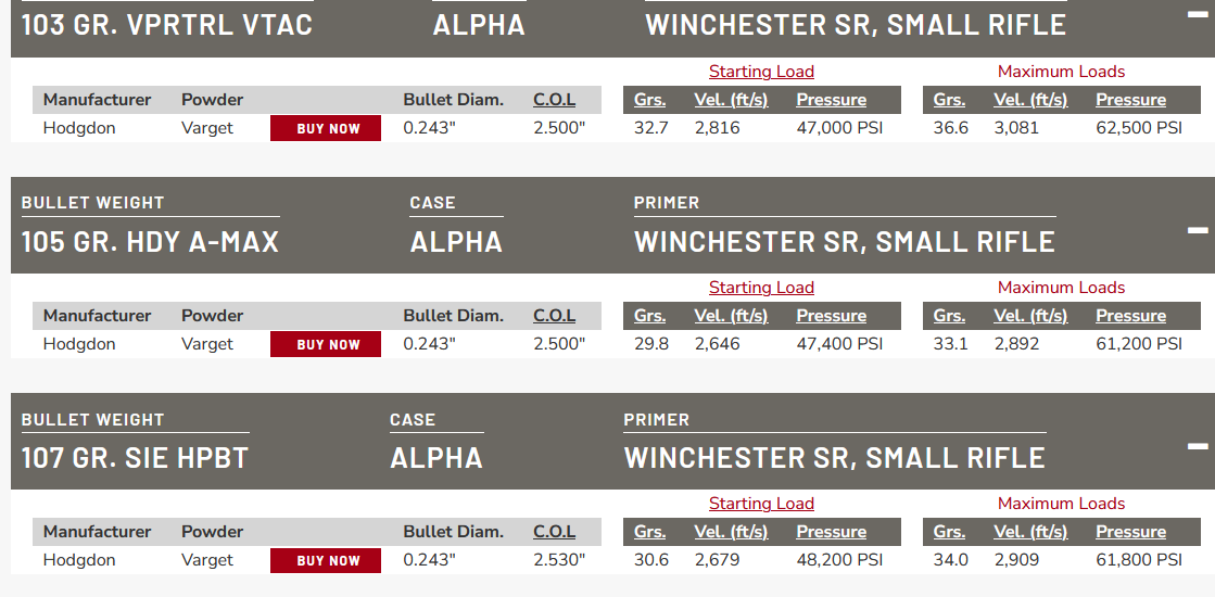

Bullets that are available right now; what would you run?
I starting from scratch. I have only ever shot the Hornady Match factory ammunition out of my gun.
I have Alpha brass, CCI 450 primers, Target powder.
Considering:
Sierra 107 SMK
Hornady 109 ELD-M
Vapor Trail 103 VTAC
Leaning towards Sierra, but I would like to hear from others here. I have no experience handloading any of these.

The sierra is a good bullet, I run them in the lady's gt and one my bra's. I also have the 109 eldm, and load them in my brothers 6gt. The 107s like to be 20-30k off, 109s we most consistent back around 55-70k jump range. They both routinely shoot half moa to a bit smaller at distance. I feel the pointed sierra is a lil more consistent within the same lot, but there is base to ogive differences from lot to lot. If you buy em, get enough of same lot to burn the barrel out. I have no experience with the vapor trails. The 107smk trued up at a 281g7 and 109 eldm trued up at 286. Very little difference. The eldm can be used on game but do not recommend putting the pointed 107s on flesh, if that makes a difference in your decision to hunt with the round.
Berger> DTAC >Sierra >Lapua > Don't shoot > Pick a new Hobby > Suck a dick > Hornady > Barnes > Nosler.
LOL! Thanks!
The DTAC comes in only 115 grains. Does it matter whether my Bartlein was cut with the Alpha Munitions Legacy Reamer with a .120” freebore? I thought that .120 was for the lower grain, i.e., lighter rounds?

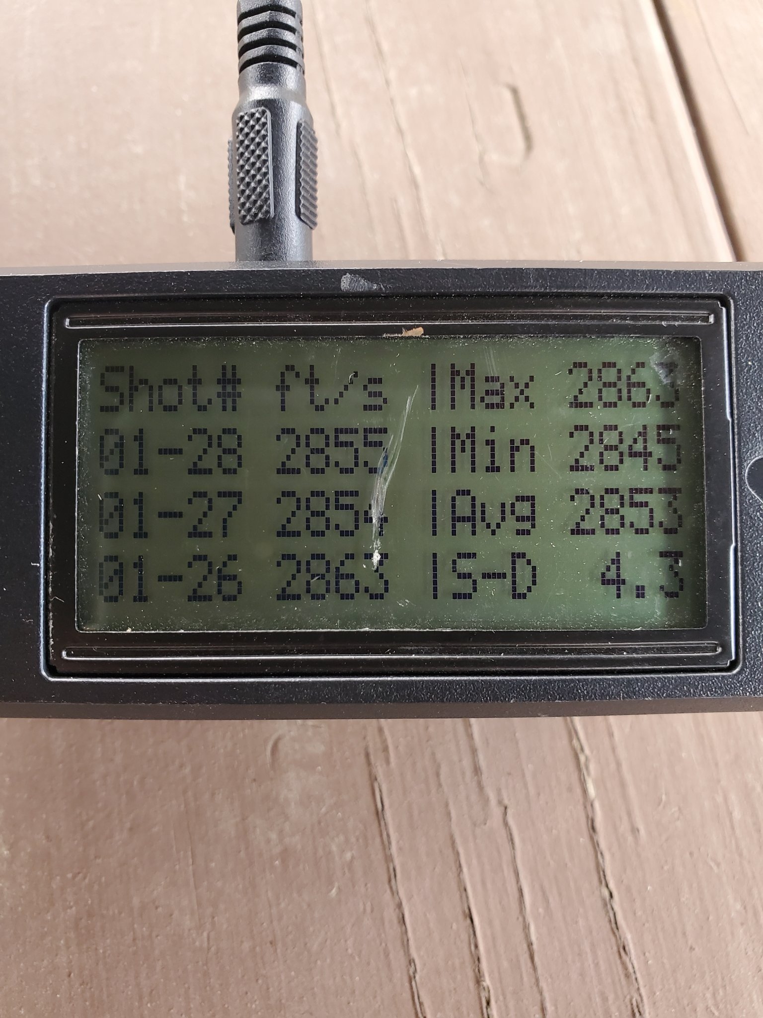

It's been a bit since I have been able to shoot due to injuries that required surgery. But I am back on my feet, not 100% but can shoot. Today I tested N555 with 110Atips in my 6GT. TL3, 27" straight taper Xcaliber 7.5 twist 5R barrel in MDT ACC Elite chassis with ZCO scope. Brass is Alpha OCD on 11th firing. Everything was shot with bipod and rear bag. No pressure issues.
2850 and 2920 in a gt hammering.......they all do that! Good shooting.

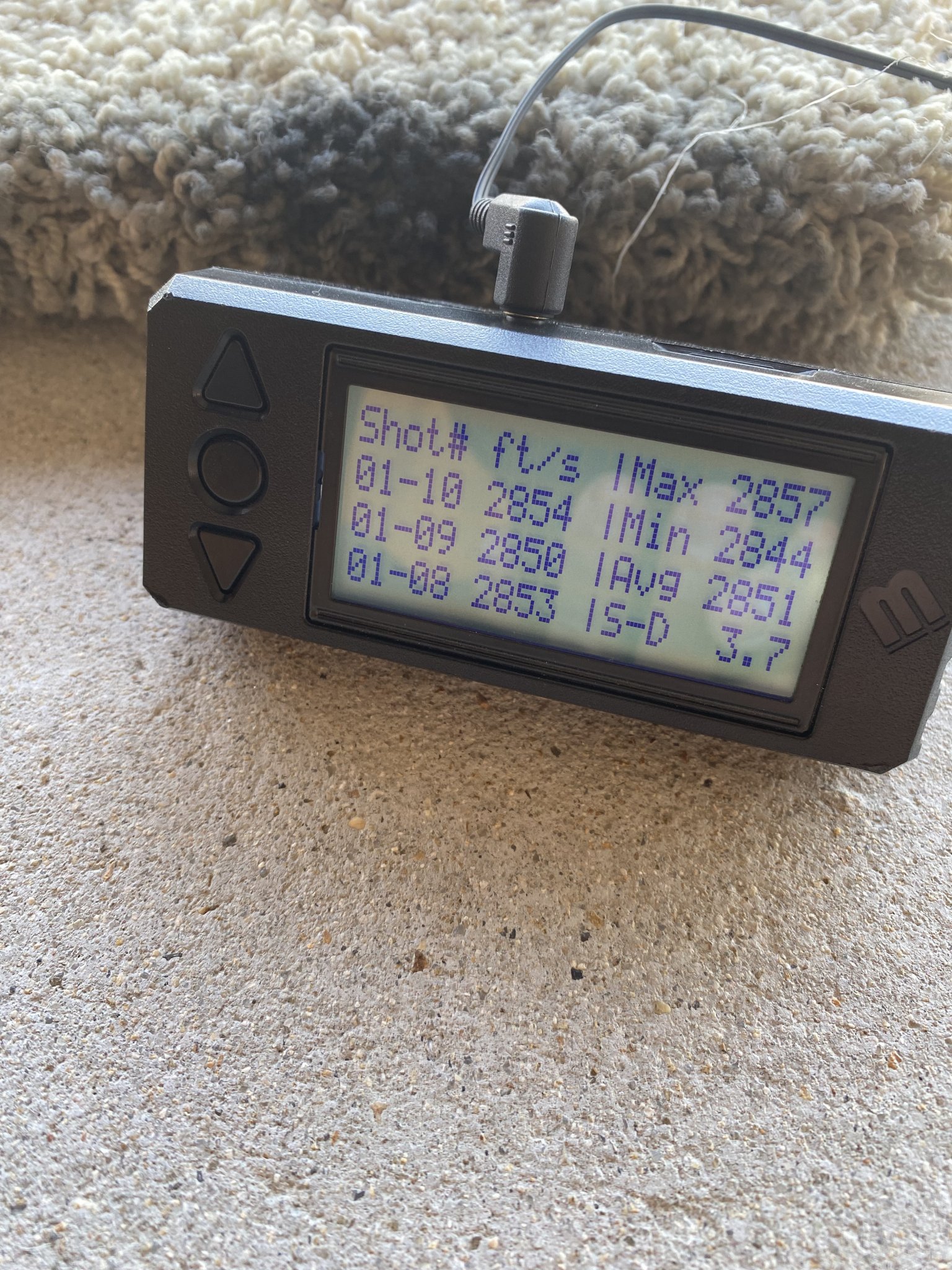

Alpha Gay Tiger brass + 33gn SWPR yielded 2825fps out of a Proof SS 26" prefit.
