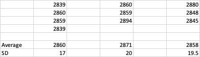

curious if anyone is running varget with 105's. what your load and speed are?
im currently running 34gr under a 108bt for 2880 from a 24", but may try some 105's
33.6 of Varget pushing a 105 Hybrid 2850ish. I was jumping them .040 or so when I started 2100 rounds ago and haven't looked back.
Still hammers.
So for Varget there is a three grain variance from short load to max. And max velocity is 2857.

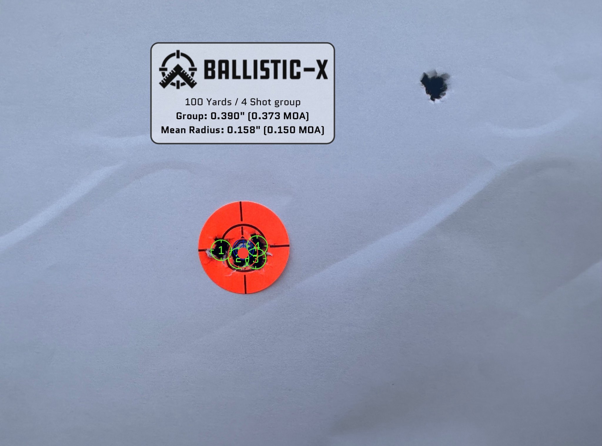

The pic below with three pics is chrono for the first 10 shots out of a freshly chambered barrel and the group is shots 6-10 (first 5 shots were just function test). Barrel is still settling in.
The other pic is 5 build and break shots (5 different positions on barricade) with same load in a proof prefit barrel for Falkor 7even. This was after barrel had about 30rnds. 100yds. Rifle and bag only.
Long story short.....don't complicate 6gt. Neither of these is cherry picked. This .562 group is one of the larger we've seen with this ammo.
Here's a third 6gt from today. It was chambered by another smith a couple years ago for a defiance. Barrel has about 2k rnds.
Today alone was three different rifles, chambered three different places. Same ammo.
The single shot upper right was from the bore sight. Adjusted and shot four more rounds to zero.

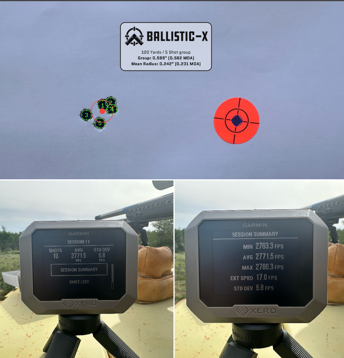

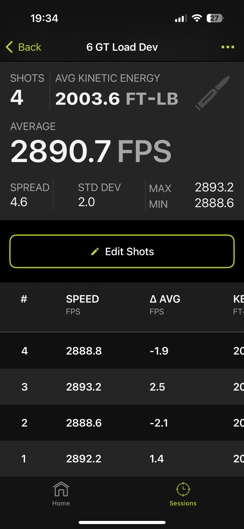

Got my garmin in hand this and took it out last weekend to finish my 6GT load dev. 36Gr of H4350, with a 108Eld seated to 1.994 CBTO
Thanks for sharing. These are the same components that I will be starting with. Alpha or Hornady brass, and what length barrel? (sorry if I missed it earlier).
