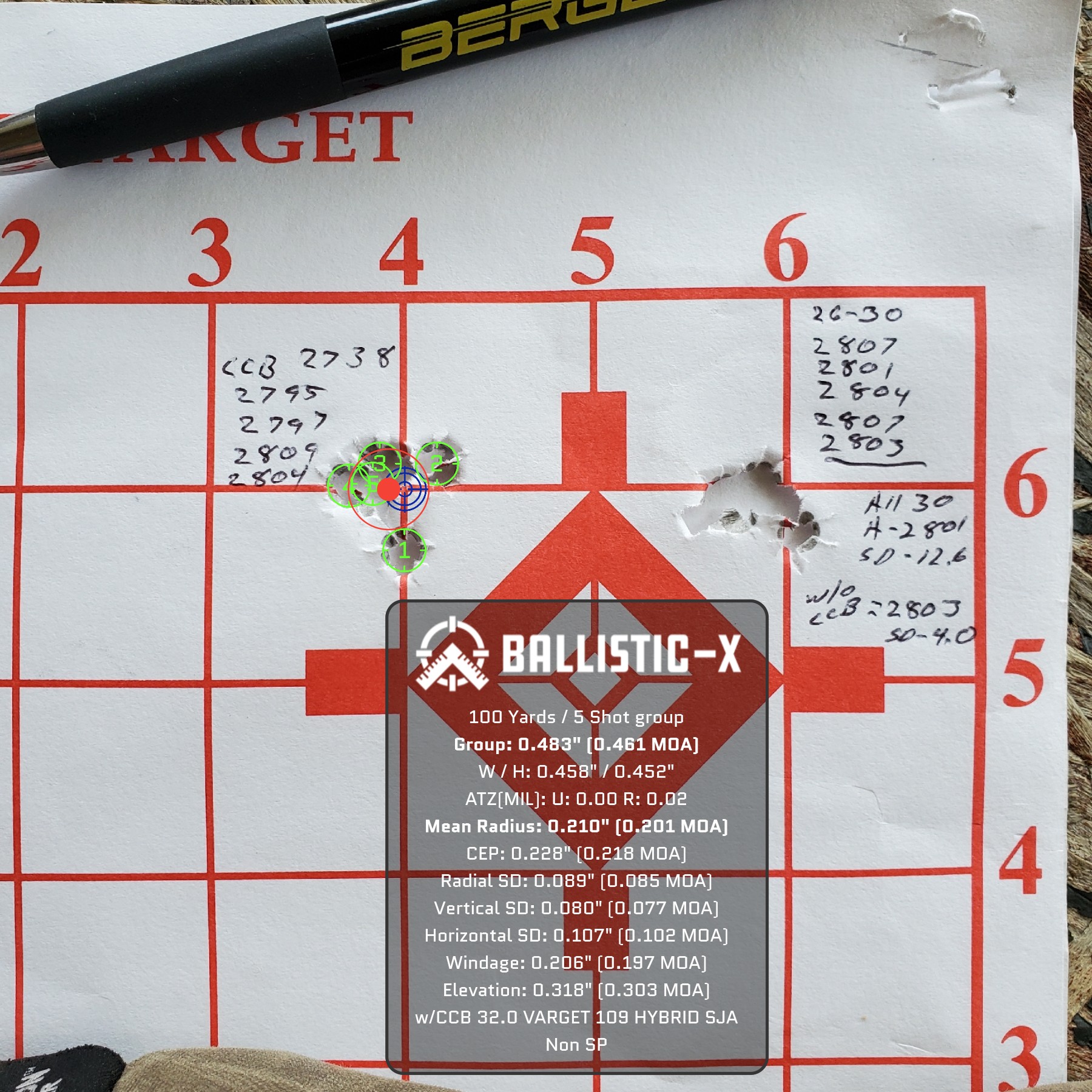

I’m confused…..are “accuracy nodes” still a thing?
I thought AB and Hornady had buried that myth in a deep hole under lots of data???
I think there are velocitiy windows certain bullets like to run at, and I do beleive it translates on paper at distance, not necessarily at 100y, this has been observed in my testing. In smaller cases like br variants and even gt, it's less apparent, but once you start getting into case over 60gr capacity, it definitely makes a difference.
Just to make sure I’m tracking with u-
  • Bullets “in the node” group size are linear at distance, excluding environmental influence? (Ex- 0.5 MOA @ 100, 0.5 MOA @ 600)
  • Bullets not “in the node” have group sizes at distance > than linear 100 yd group size? (Ex- 0.5 MOA @ 100, 1 MOA @ 600)
Is that what you are saying?
That's correct.
What I've found, there are velocitiy windows that will have the same vertical poi at distance, also known as positive compensation, or barrel timing nodes. It's used mainly by benchrest/Fclass guys as their powder tuning method.
I've had loads that shoot sub half at 100y, but at 600y on paper will have 6" of repeated vertical. Go up/down another 40-50 fps in velocity, and it'll be same sub half moa at 100y, but still hold half minute or less of vertical dispersion at distance.
There was a Cortina podcast with Alex Wheeler talking about positive compensation. I don't put a lot of weight in Cortina(some but not most his content) but Alex knows his shit.

I totally agree, I haven’t shot groups at 100yds for load development other than when I’m shooting a ladder test . Once I find the( flat spot with the velocity I like) I’ll do seating depth test at 500yds. Might not be the correct way to do it but it has worked in my 6GT for 2 different barrels and 3 different bullets and powders.

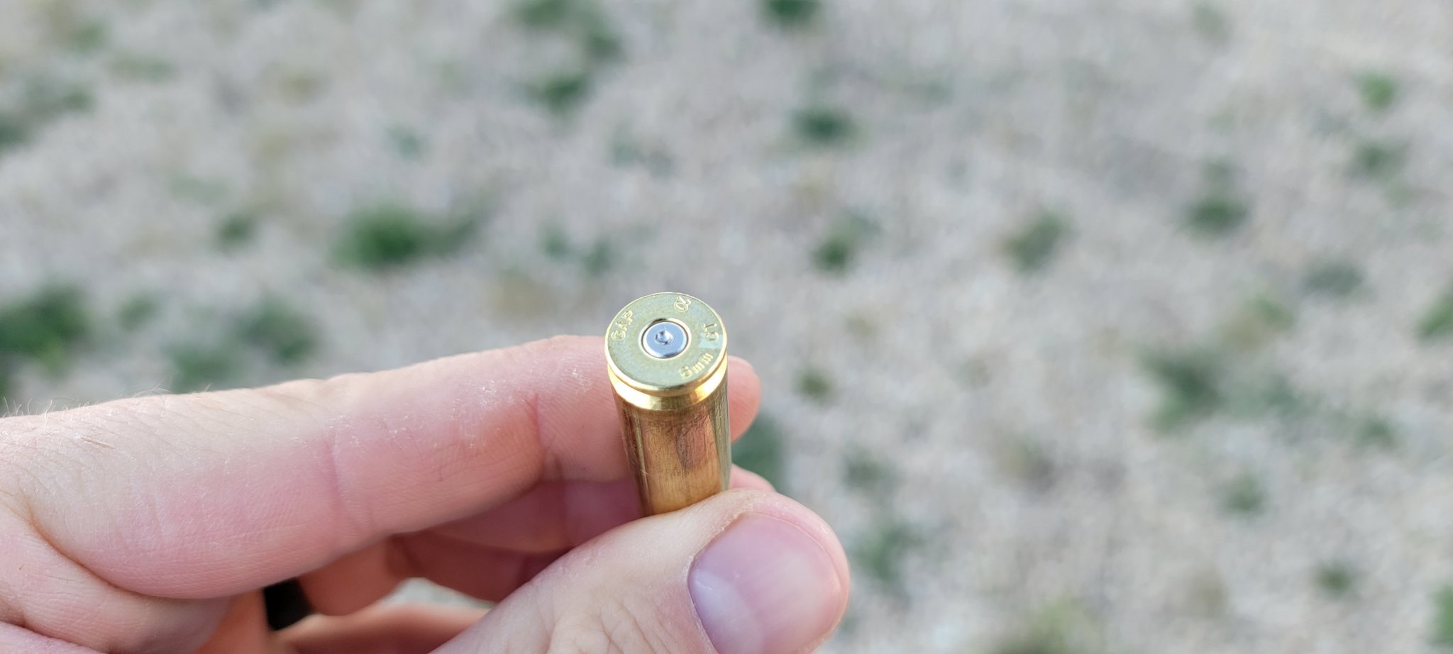

Hey quick question. I just got some barnes 112 MB's so I loaded them up with 33.5gr varget and Br4's in alpha OCD brass.
I ran a seating depth test 3 shots each. I was in a little bit of a rush and shot them fairly quickly.
The last two three shot groups were stiff bolt and ejector swipes.
Is this my negligence or does something seem off? Hoping to chrono that load later this week.
If it's virgin brass, sometimes you'll get psi signs as of light bolt lift and ejector marks as the brass is forming to chamber and coming back to the bolt face, these usually go away on second firing. How do your primers look? Are the edges flat, still rounded, is there cratering? I'm running 33.5gr Imr 4166 in virgin ocd brass to break in a handful of barrels right now with 108/107 gr bullets running 2900-2950 depending on freebore, but these are showing no psi signs on any of them but the AI atx, it gives ejector marks, AI uses a pretty stout ejector spring, it did it with virgin 65cm brass as well.
Stiff but not sticky bolt lift. This is in a zermatt, so just an ejector slot. But it is the first firing. The interesting part to me is that it seemed to come with heat increase. I didnt let the rounds cook in the chamber at all.
Stiff but not sticky bolt lift. This is in a zermatt, so just an ejector slot. But it is the first firing. The interesting part to me is that it seemed to come with heat increase. I didnt let the rounds cook in the chamber at all. View attachment 8185530
So this looks to me, is typical first firing with alpha ocd brass signs at the case head. The web is so strong on these cases it doesn't expand much first pop causing it to not grip chamber well, this slams the case head back to the bolt face, giving you that ejector cut signature.
My origin does same thing to primers, cratering at medium to Lower psi(probably gonna get it bushed eventually) those primers look very round at edges, I'd say your load it totally safe and what you're seeing is common with ocd brass upon virgin loadings.

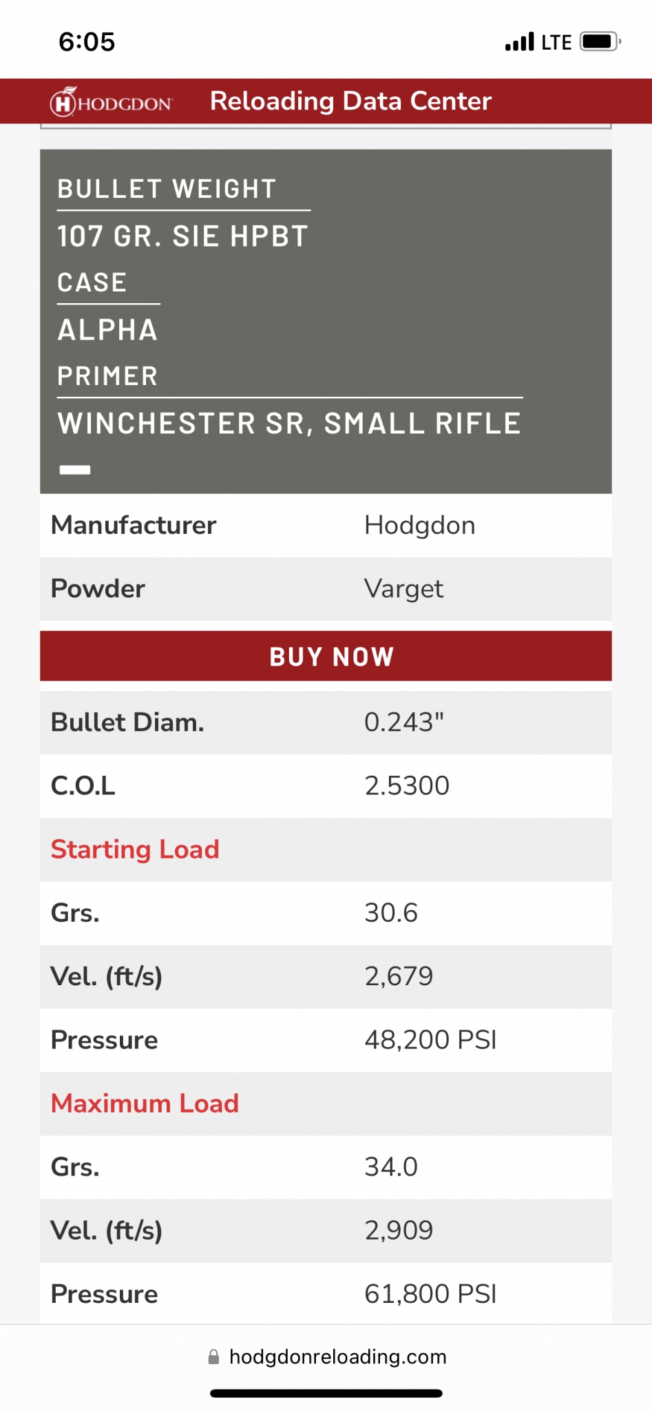

Hodgdon says max load is 34.2gr varget with a 110gr bullet. You might be right. I've got h4350 I can play as well but I kinda assumed varget was the east button.
Max load is max load in the book, but it should go without saying; you work up to a load to ensure safe pressure. This is reloading 101 stuff.

It doesn't matter what they say. I am on my like 5th firing of 800 pieces of Alpha OCD. ALWAYS work up to a load. You don't know how the powder/bullet/chamber/your reloading skills combination will work. Or don't then get laughed at when you blow your shit up or wreck your barrel/bolt.
Your load is spicy AF. Most people are using 2-3 grains less varget. This is why you have heavy bolt lift. Add summer temps and this is what you get.
I had run a ladder on the 108 eldm up to 34.5gr, went back down from 34.5 to 33.5 at about 2850fps. I had brought some of those loads along.
After seeing the pressure change in the 112 MB load at 33.5gr I went over to the 108 eldm at 33.5gr and also saw pressure signs.

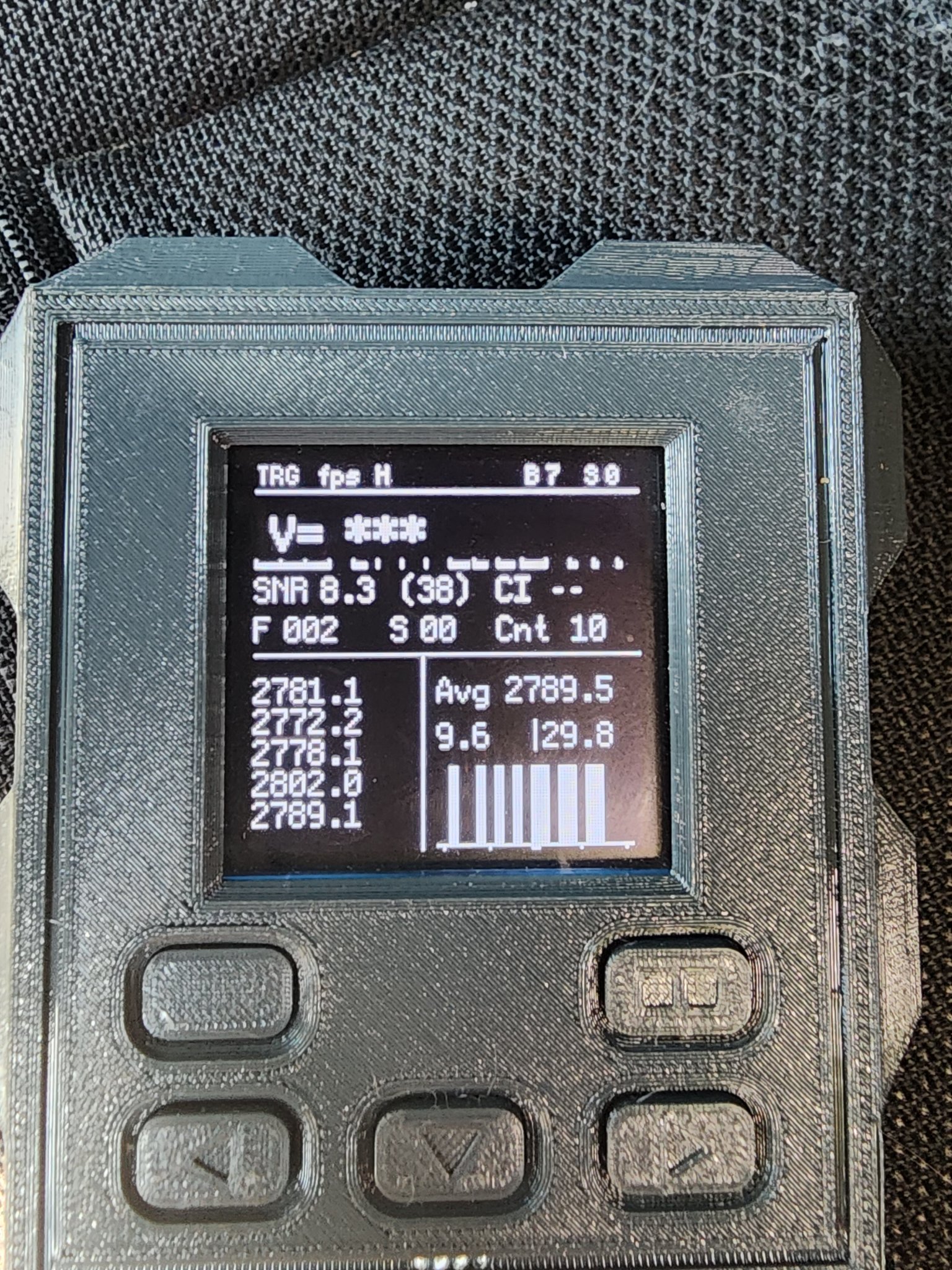

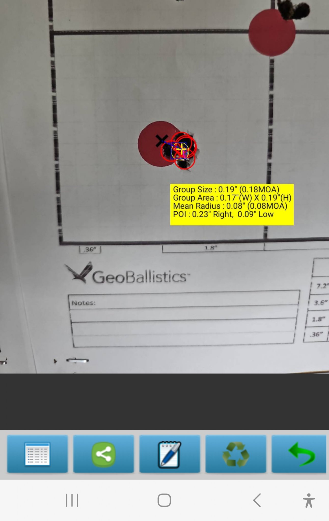

Shot a match with the DTACS and felt my load was a touch on the hot side, primers were a little flat. Temp that day was 104-105. So decide to reduce the load a bit.

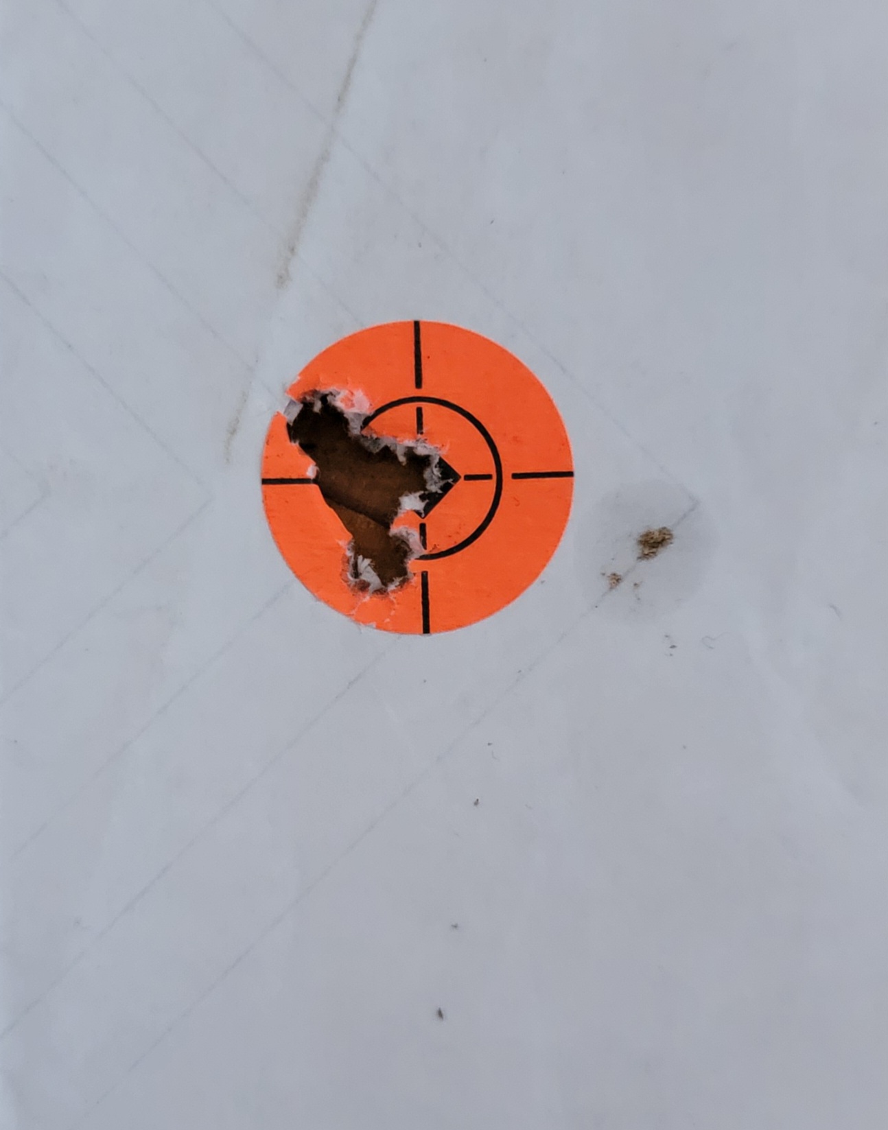

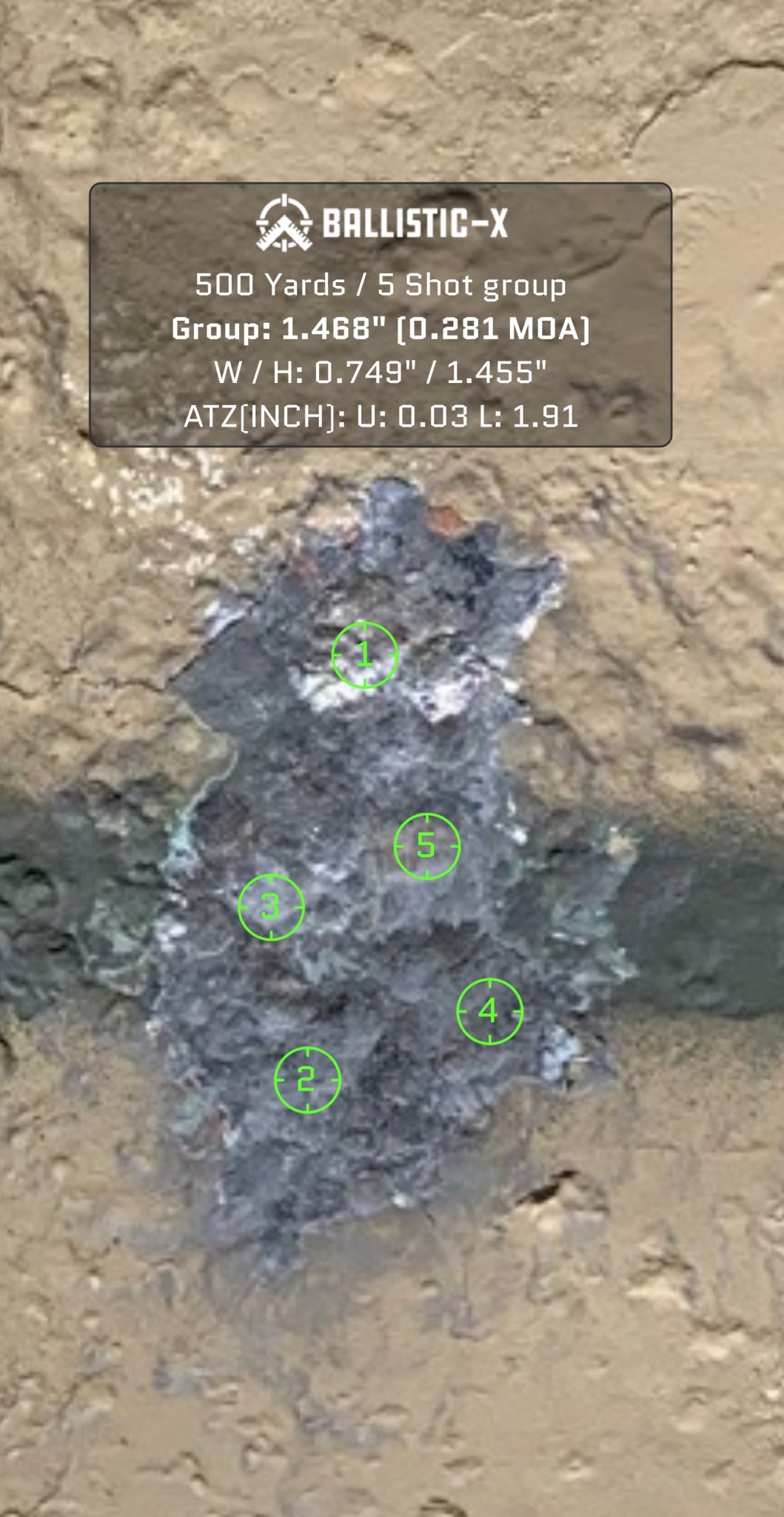

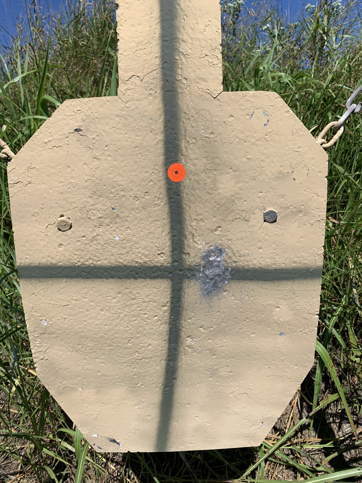

6GT Impact
Proof 7 twist @ 26”
H4350 33.7gr
Alpha 11x fired
CCI 450
115 DTACS
Velocity 2785fps
5 at 501yds
View attachment 8210057View attachment 8210058
I went from 34gn to 33gn of SW Precision Rifle with 112MBs (2850fps-2804fps) and am really digging it at ~2800fps, easier to see more on plates inside 500.
~2800fps it’s soft like a Dasher and my brass will last forever.
