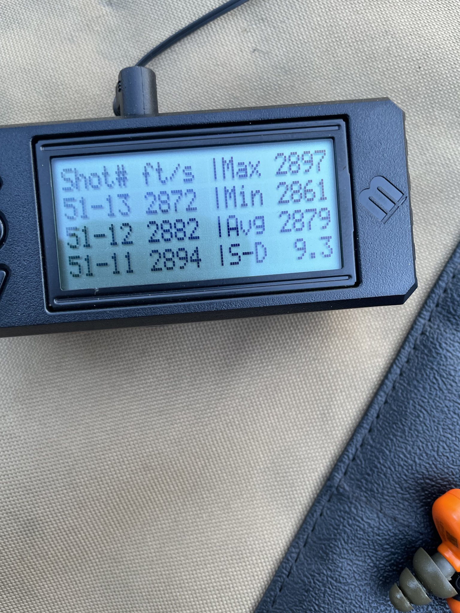

Alpha brass, CCI 450, 32.3 Varget, 108 Berger:

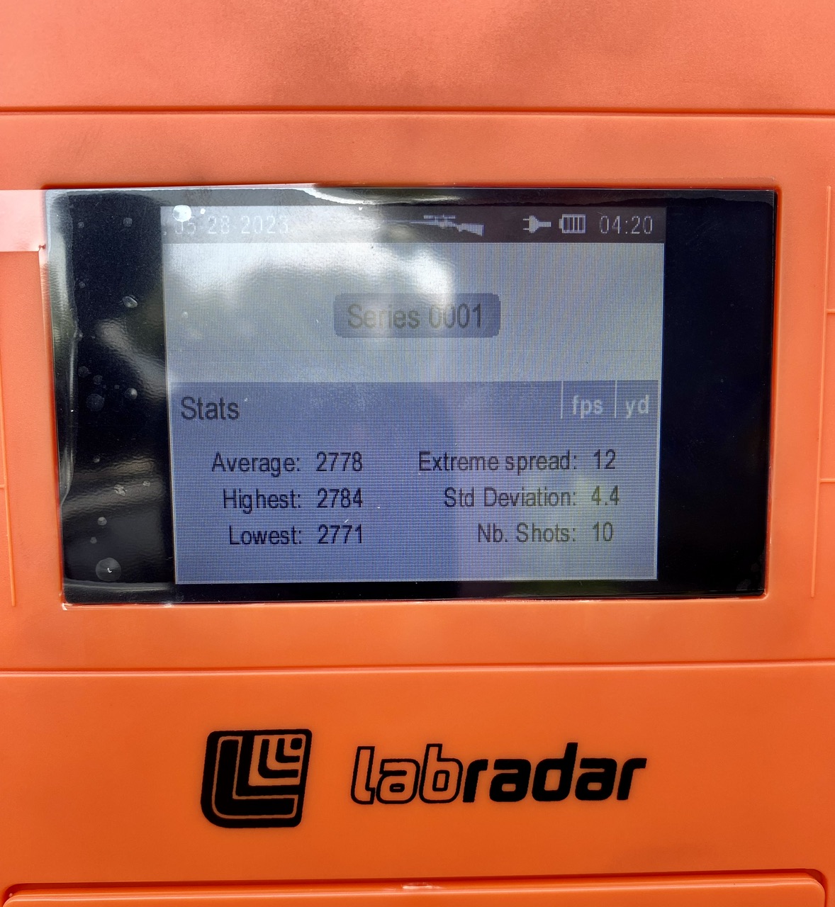

That’s around 100 rounds down the barrel so I expect it to speed up a bit. Faster than I expected for 2 grains below max.
38gr will likely be pretty warm. I know 36-36.5 generally gets me 2900-2930 with 108-110gr bullets after 200 rounds of break in. However one lot of powder required 37.2 gr, and a other lot only needed 35.7, I love H4350 but there are noticbale lot to lot variances, I've observed same with Varget and H1000.

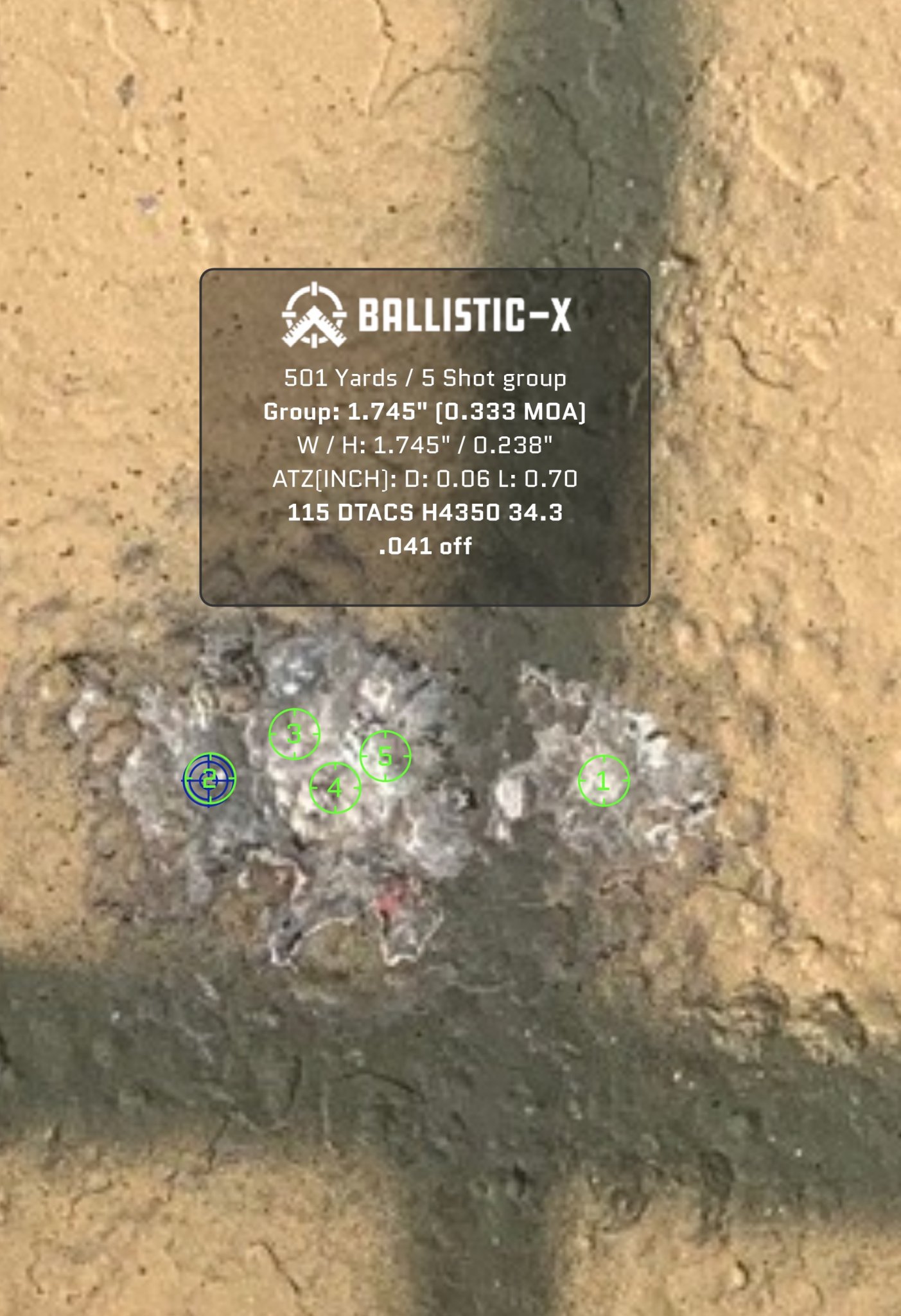

115 DTACS
Impact 737
Proof Comp contour @ 26” 1-7”
Foundation Centurion
Manson .120 freebore
6GT Alpha 10x fired
CCI 450
H4350 34.3
115 DTACS
BTO 1.9770
83*
982’ ASL
Hm: 59%
avg: 2801
SD: 4.3
ES: 10

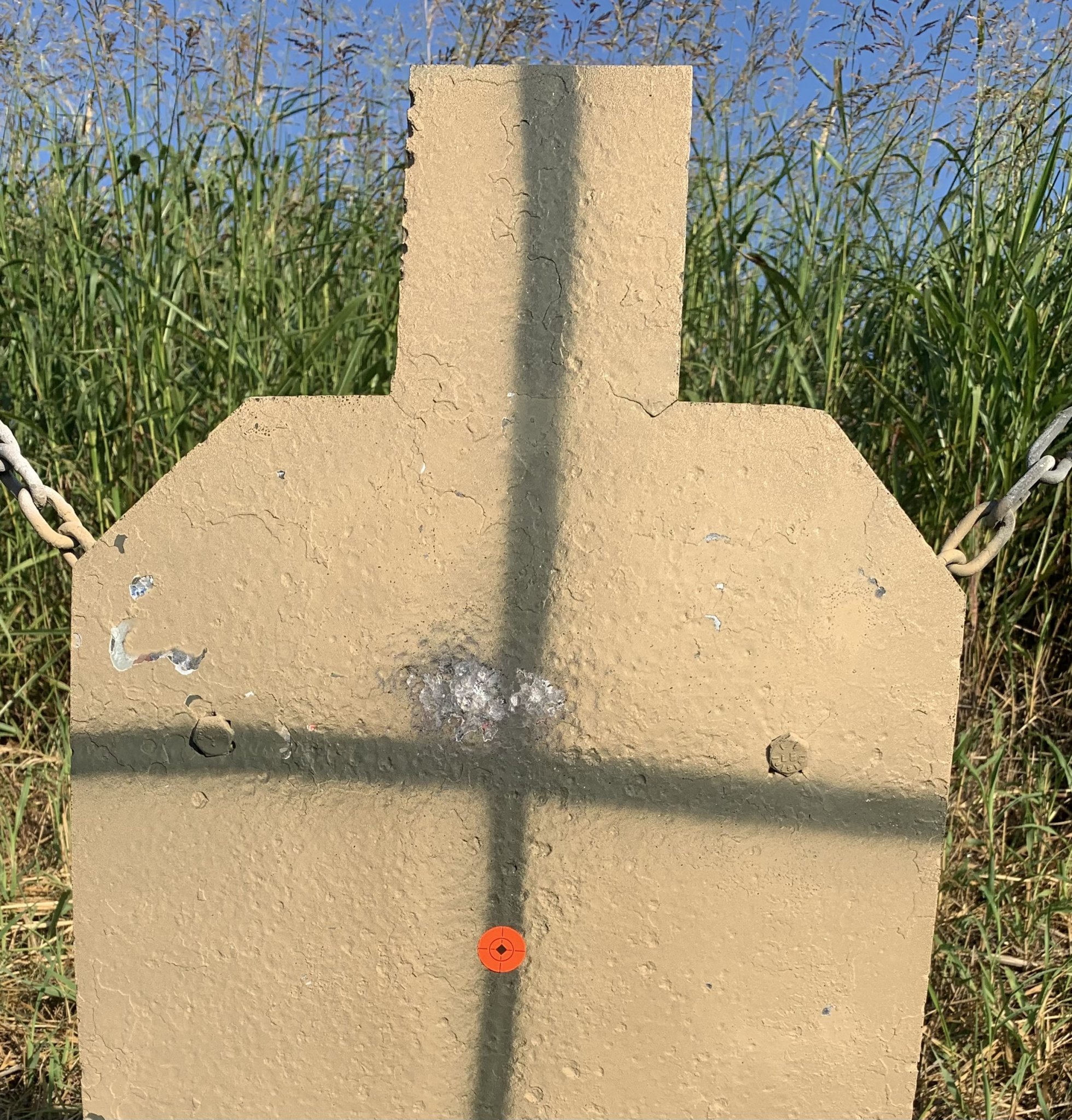

This barrel has 1231 rounds on it mostly from matches . Otherwise I’m not sure if you could get the DTACS to work in a .120 freebore.
10 at 100yds while doing my ladder test.
5 at 501 yds checking velocity. It’s probably going to true out closer to 2810-2815. I’ll check it again at 600 when I go to true the BC.
Ballistic-X-Export-2023-07-03 08:14:26.616024.jpg
