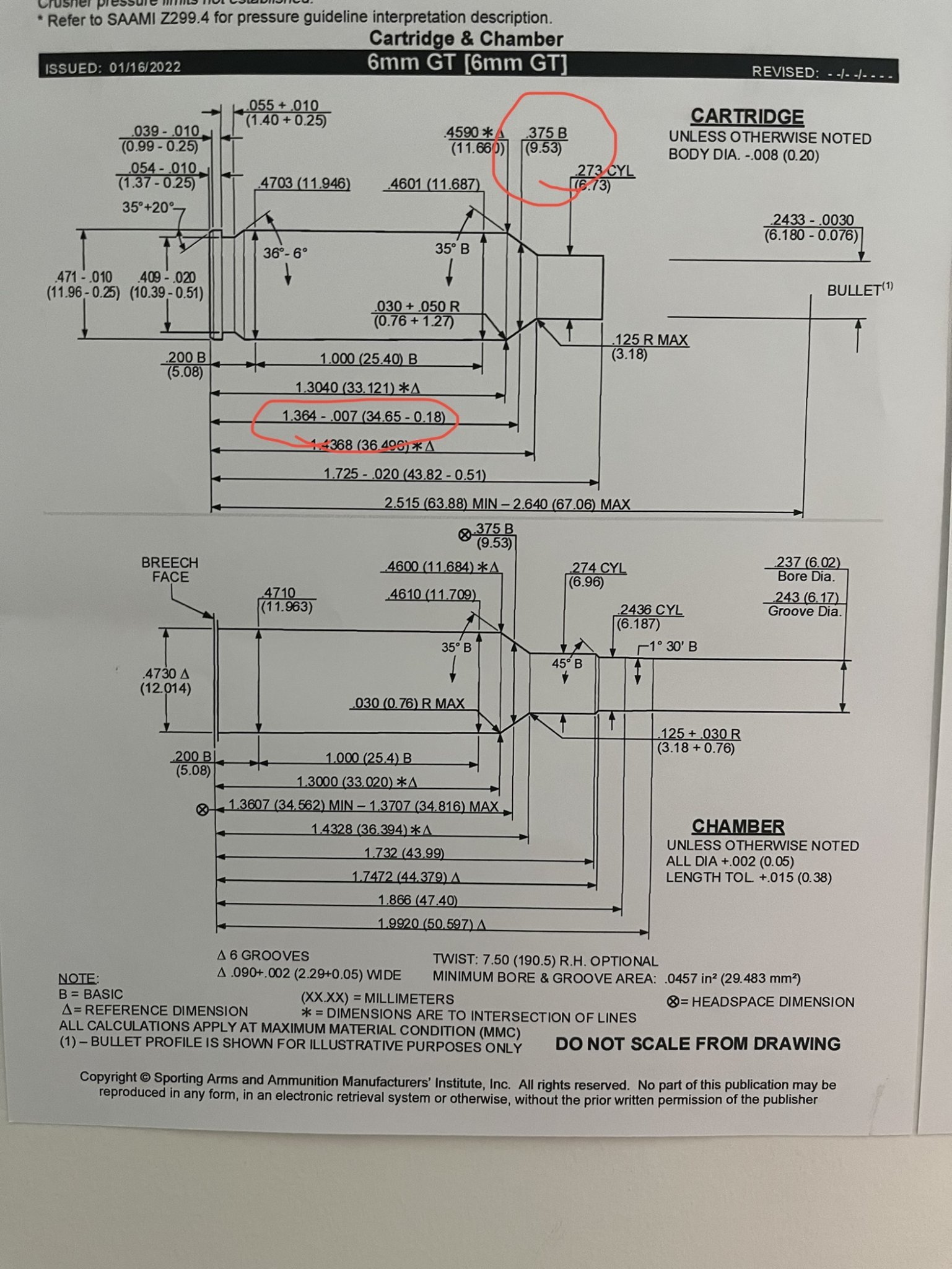

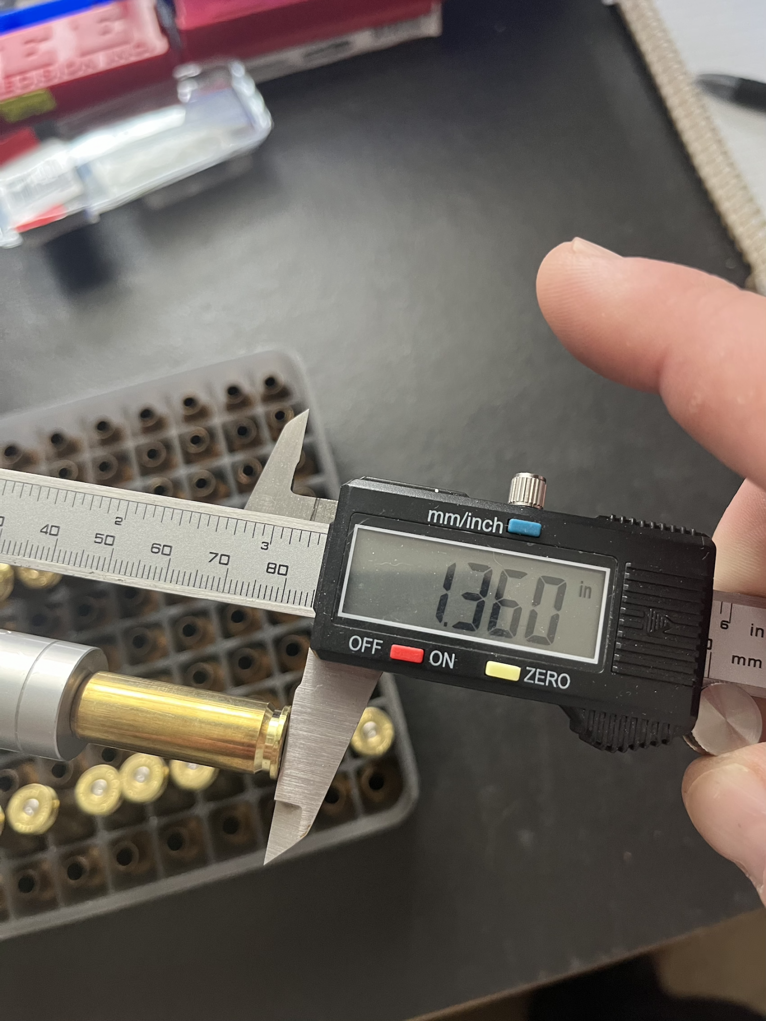

Happy holidays everyone. I wanted to ask if anyone has any insight with what I am seeing that has me stumped.
I got my 6GT from GA Precision spring 2022 and what an amazing rifle. So far I have loaded and shot 100 new alpha brass for break in process with 105 Nosler RDF because it’s what I had. By the way 34.7 Varget gets barely over 3000 fps and about .2 MOA.
The issue is now I go to reload those original once fired brass and the shoulder bump is HUGE. I have tried two good die’s with Same result. Also using zero press.
Fired brass measures from 1.3040 to 1.3100 with SAC comparator
— When I run SAC die to contact shell holder I get .031 bump
— When I run Micron die to contact shell holder I get about .026 bump
I unscrewed the SAC die until I got the proper .002 shoulder bump and then measured gap between shell holder and bottom of die body and as expected it was about .032
THATS A WHOLE LOTTA BUMPIN’
not sure I have seen that much bump in contact with shell holders for other cartridges. The guys over at SAC are incredible to work with way beyond generous and offered to help troubleshoot so I gave them some examples of fired brass and my die to troubleshoot.
Are you all seeing this much bump when contacting the shell holder? Could something be wrong with my chamber?
Any help I would be thankful for
Thanks
Ok I have root cause!
First SAC is amazing, they took my once fired brass and determined rifle had too much headspace and because they work with George at GA Precision sent him a note with the measurements. I offered to pay SAC and they refused saying just wanted to help their customer!
I contacted GA Precision told them the deal and next thing you know I get a call from George. He said not sure what happened but wanted to receive it and check it himself and they would pay for shipping. GA Precision then calls me when they get my rifle and next day George calls me again and says that it did have excessive headspace the exact amount that is the difference between an Impact action and my Defiance action. His Smith setting barrels that day did a bunch of Impact first and didn’t make the adjustment when he put barrel on my Defiance. I told George that I appreciated it getting done so fast and he told me that it doesn’t happen often because of their quality processes but if they get a warranty item in, it goes first and offered to send me new brass to replace what I ruined troubleshooting this issue.
This is amazing service from both GAP and SAC. This is why I will work with both of them again every chance I get and you should too.
If GAP and SAC is reading this, very appreciated guys, class acts!

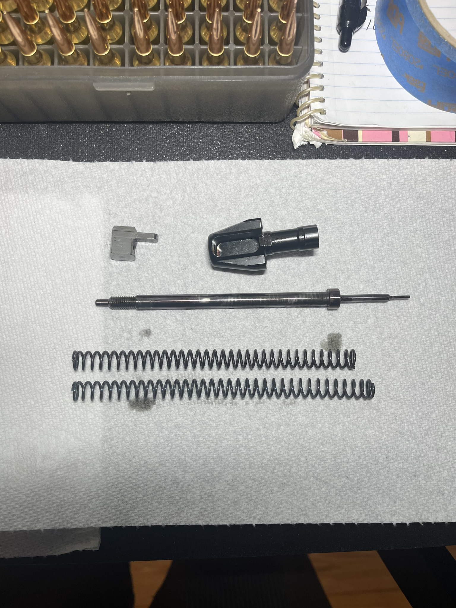

My previous outing was plagued by hang fires... just enough of a delay that you could feel/hear the pin drop before the discharge on each shot. On this outing I used a different primer and while it performed better I was still having hang fires about every 4th shot.
I'm going to clean my firing pin and firing pin channel and also change out my spring with a new one and see if it continues.
Temps were 16-18 degrees while shooting these.
Reactions: Northman623
26" proof, .170 alpha reamer, alpha brass, FGMM primers and 110 Atips. View attachment 8063098

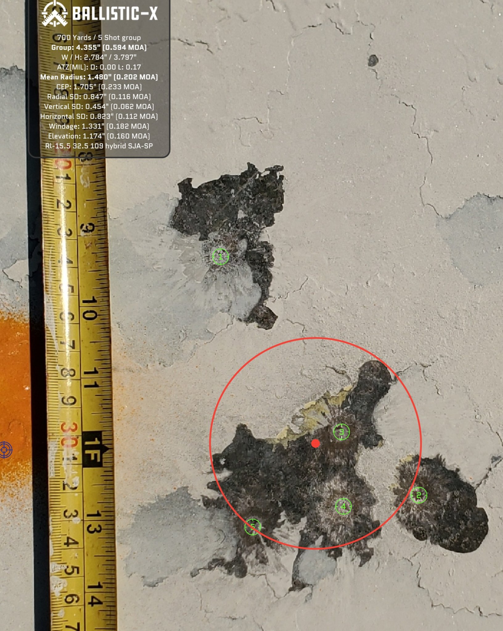

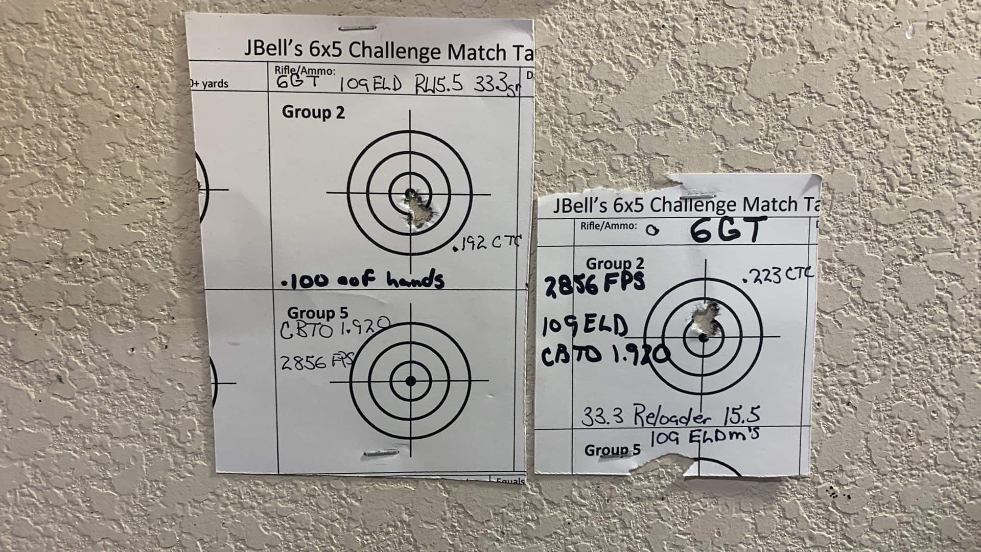

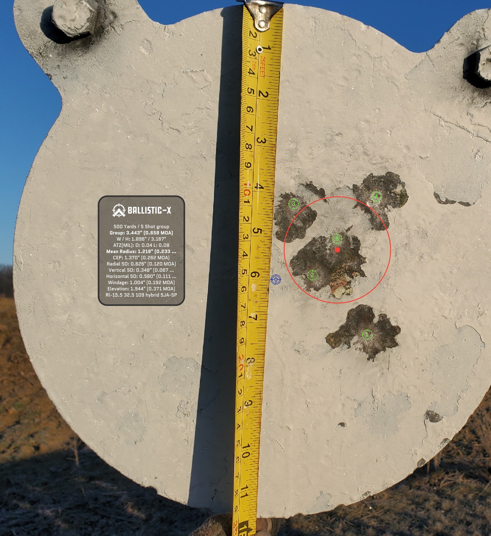

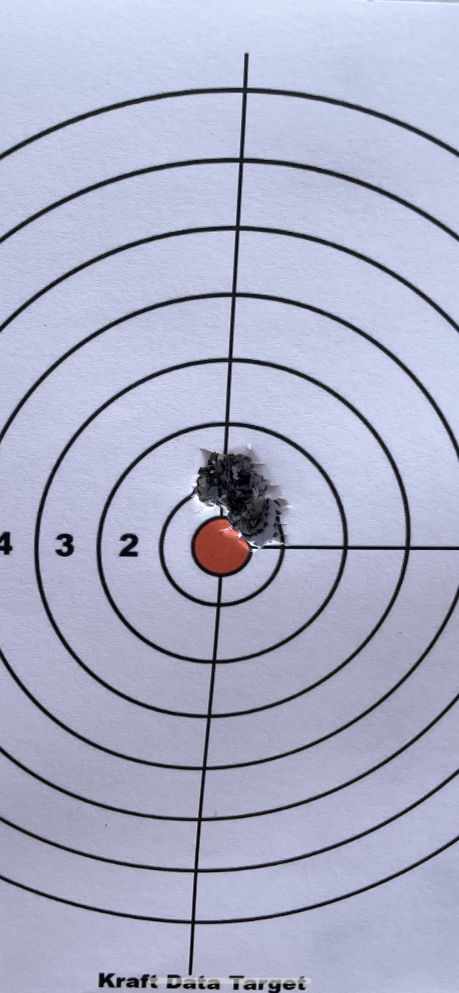

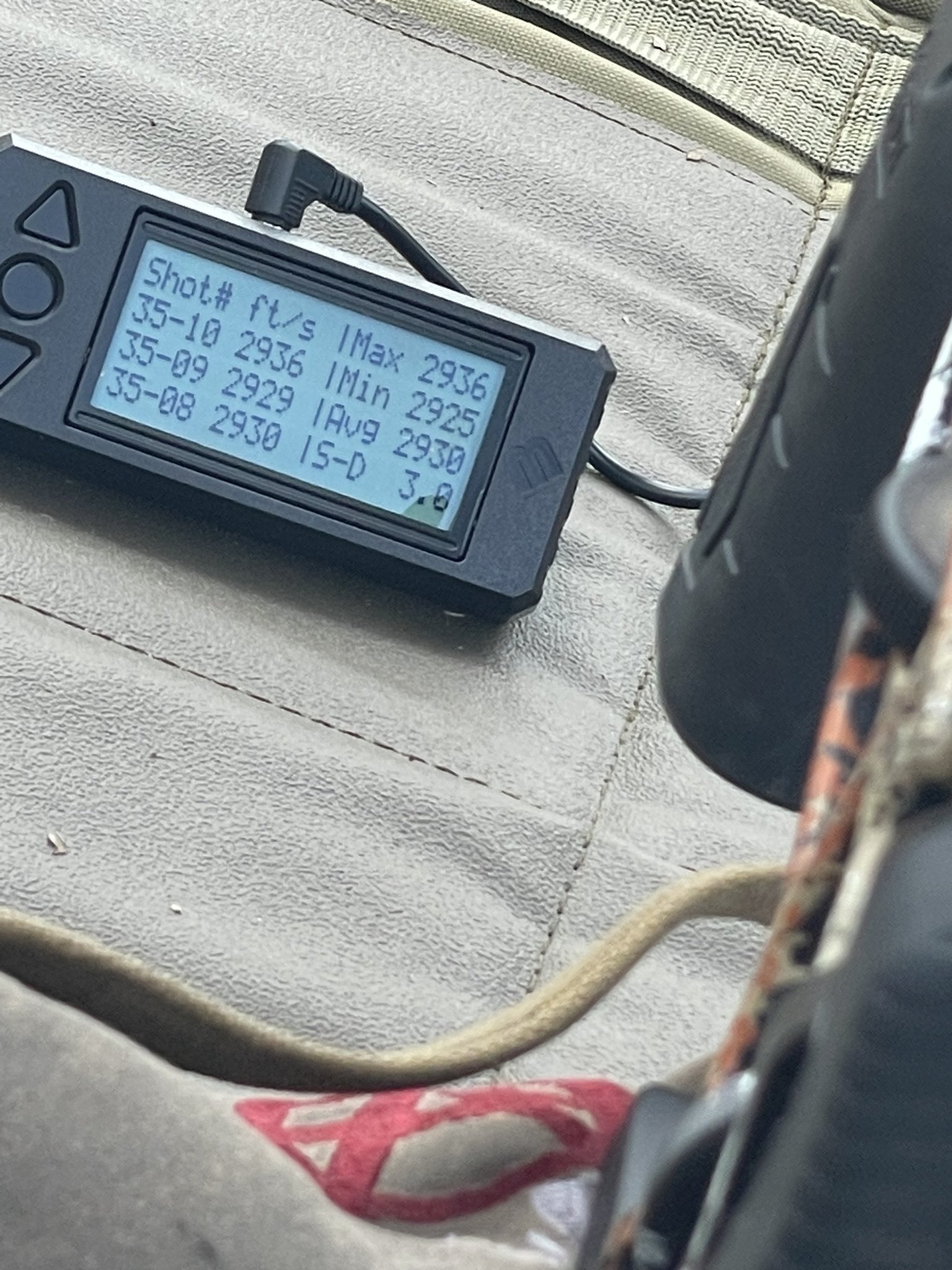

Barrel: Proof SS Origin prefit 26" 7.5T SKU133484
Generic guess/first-firing/virgin brass load:
Alpha OCD Gay Tiger headstamp
CCI450
32gn Shooter's World Precision Rifle
112gn Barnes Match Burner
1.96" BTO 2.61" COAL
Shot #100 at 1000 yards:
