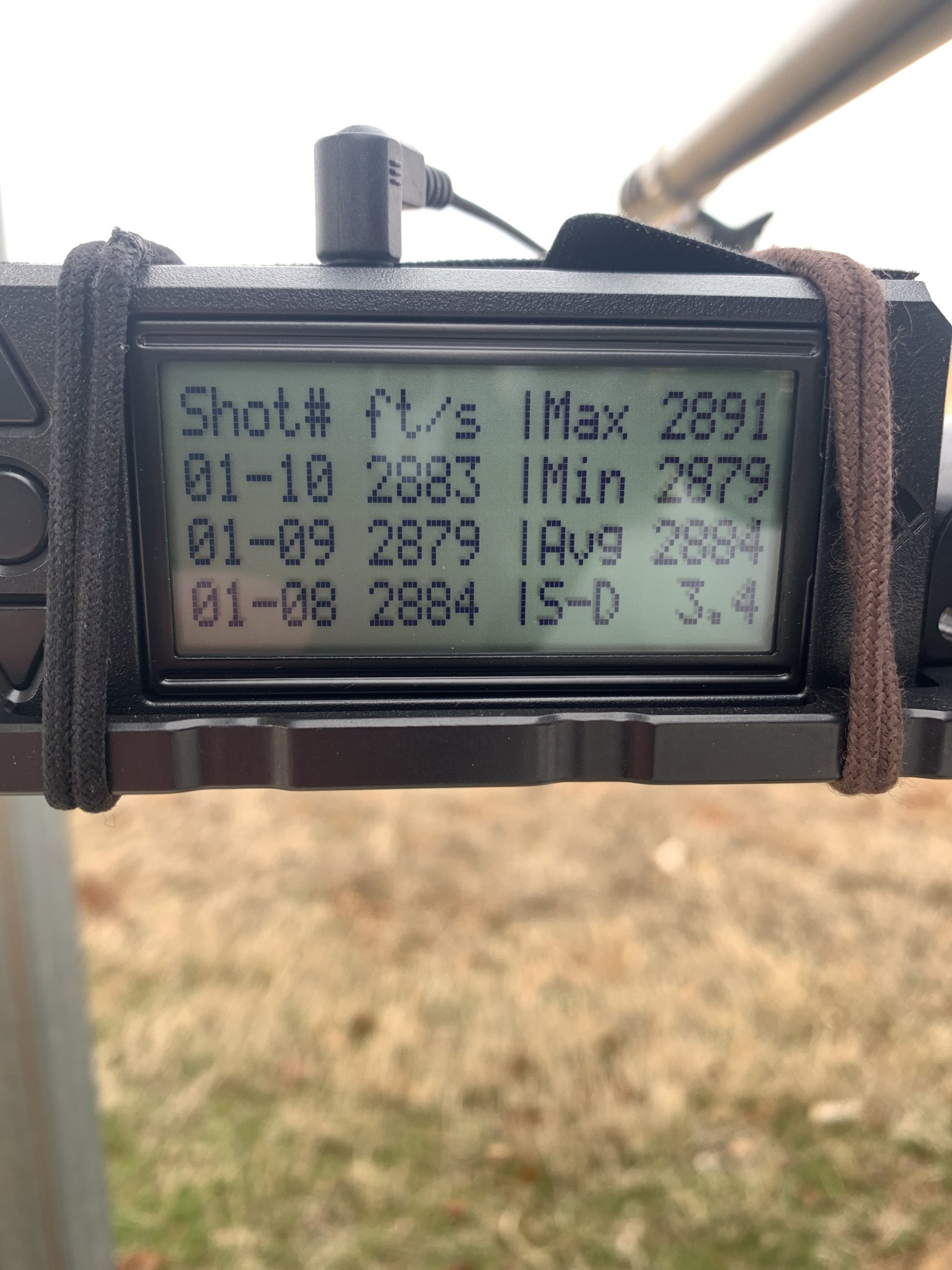

A friend uses it for prs... told me it was super consistent and grouped well on target but gets a little loose in when the wind kicks up.
I have been running the 108gr ELDM's @2930fps with hornady brass and H4350. It is easy to tune and does well enough in the wind. I have shot my 6GT out to a mile with good results. It holds its own.

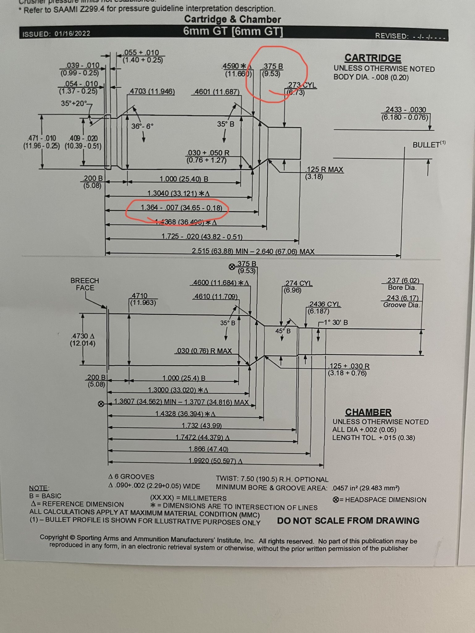

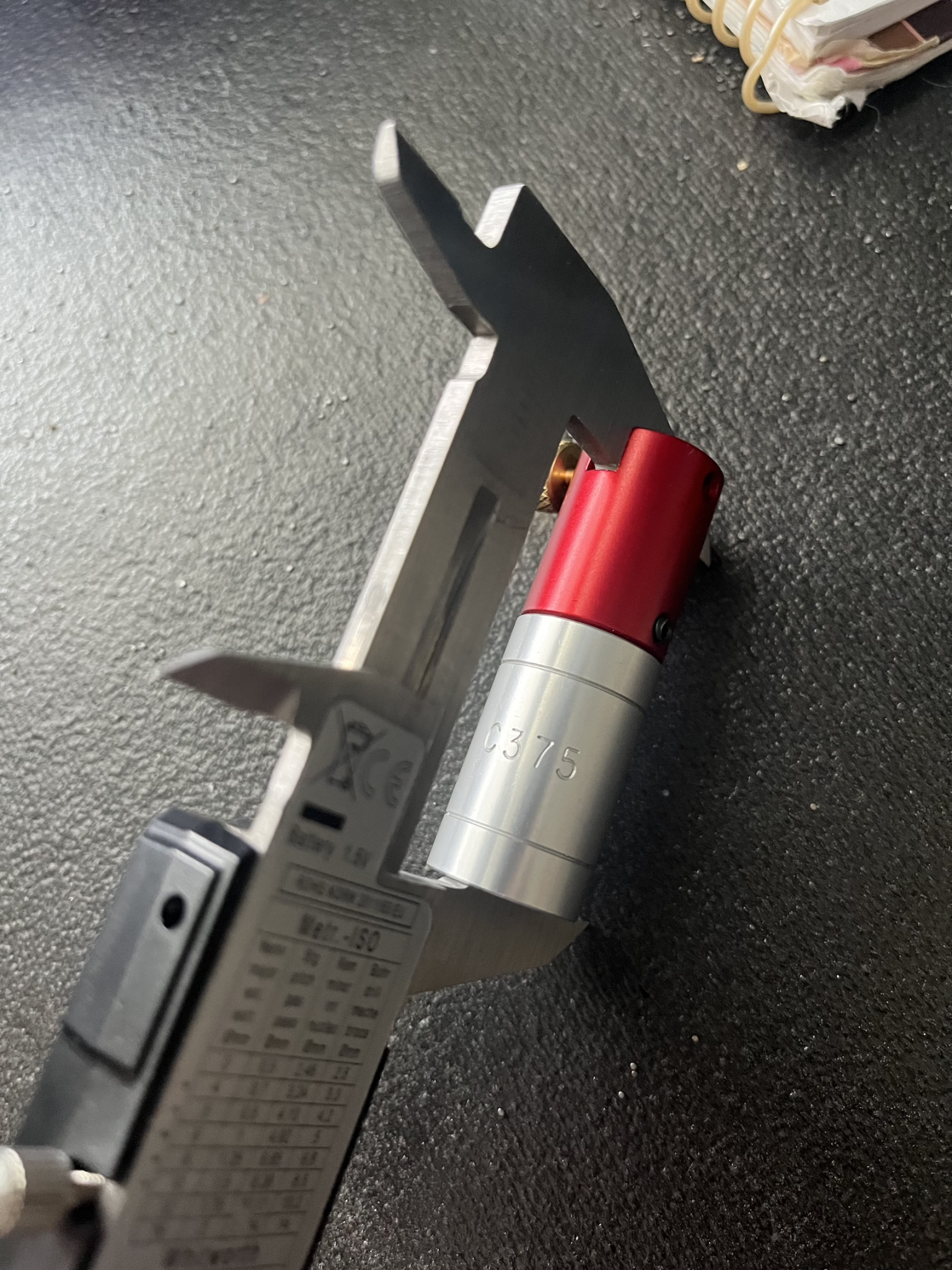

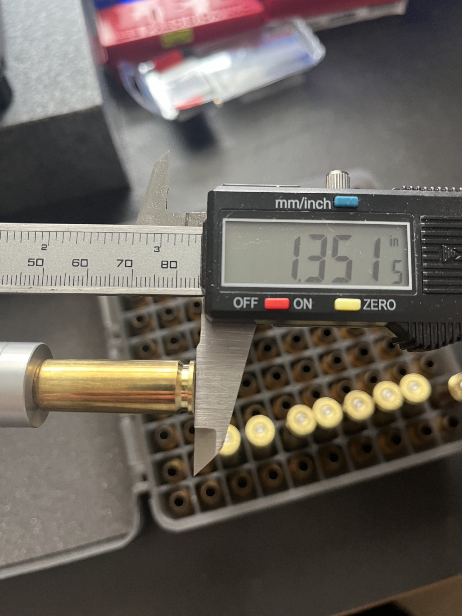

HELP HUGE SHOULDER BUMP​

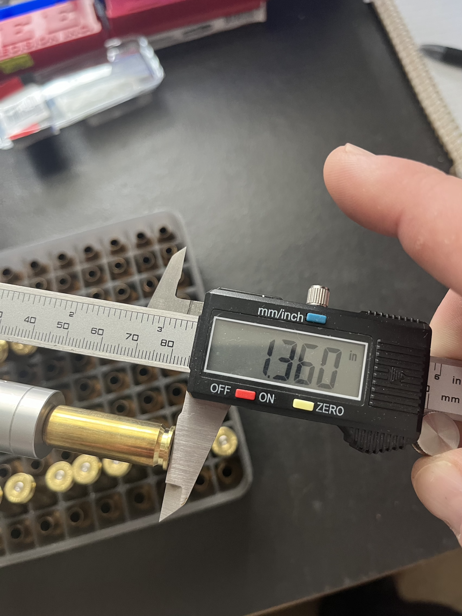

Happy holidays everyone. I wanted to ask if anyone has any insight with what I am seeing that has me stumped.
I got my 6GT from GA Precision spring 2022 and what an amazing rifle. So far I have loaded and shot 100 new alpha brass for break in process with 105 Nosler RDF because it’s what I had. By the way 34.7 Varget gets barely over 3000 fps and about .2 MOA.
The issue is now I go to reload those original once fired brass and the shoulder bump is HUGE. I have tried two good die’s with Same result. Also using zero press.
Fired brass measures from 1.3040 to 1.3100 with SAC comparator
— When I run SAC die to contact shell holder I get .031 bump
— When I run Micron die to contact shell holder I get about .026 bump
I unscrewed the SAC die until I got the proper .002 shoulder bump and then measured gap between shell holder and bottom of die body and as expected it was about .032
THATS A WHOLE LOTTA BUMPIN’
not sure I have seen that much bump in contact with shell holders for other cartridges. The guys over at SAC are incredible to work with way beyond generous and offered to help troubleshoot so I gave them some examples of fired brass and my die to troubleshoot.
Are you all seeing this much bump when contacting the shell holder? Could something be wrong with my chamber?
Any help I would be thankful for
Thanks
Thanks
