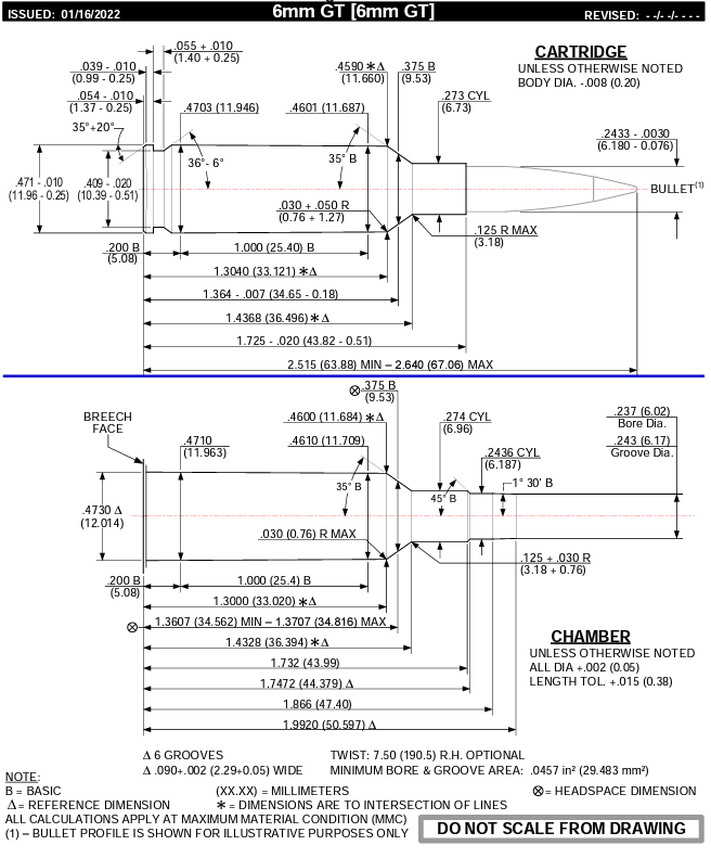

Anyone know the correct Dillon Precision powder funnel insert for the 6GT? I don’t see one listed in their chart and don’t know of any other common 6mm with a 35 degree shoulder (closest might be an ‘I’ insert for the 6mm Rem?).

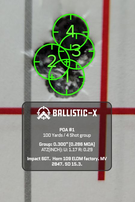

This is from a brand new 20" Carbon Six barrel. 7.5 twist.

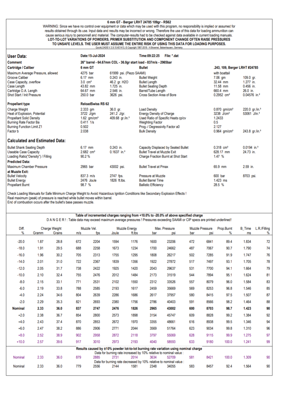

I would like to run Berger 105 and ELDM 109 out of a suppressed 22in barrel slow at around 2750 with H4350. I’m thinking 34g of H4350 would be gtg but worry about not efficiently filling the gt case. Should I do a 6gt or step down to Dasher of BR?

Your plan will work but I might take a little more H4350 with a 22” barrel to make that speed.

You think so? My guess of 34g might be off then, I just want to run them nice and slow. Will get new MDT mags for either BR/Dasher or GT anyway. I had a 26in 6GT before and I didn't like the length with a suppressor or how the ARC and MDT AICS mags didn't run 100% for me.
I think I might be up to 35g of H4350 to get 2750fps out of the 22in barrel. I'm just worry about low case fill as @4O6shootist mentioned above.
Bergers lists a case fill of 104% of H4350 with 109g hybrids at 36.3g. Obviously there is variation in cases but I think you will be fine at anything between 34-35g. 35g would be 100.4% and 34g is 97.4% according to Berger. So even if you dip to 95% then you are still good to go.

I needed 35.5 gr H4350 in my last 26” GT barrel to get a 109 Hybrid to 2860. Subtract 100 fps for the 4” shorter barrel and you are where you want to be.
