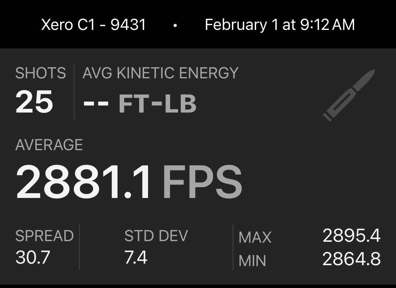

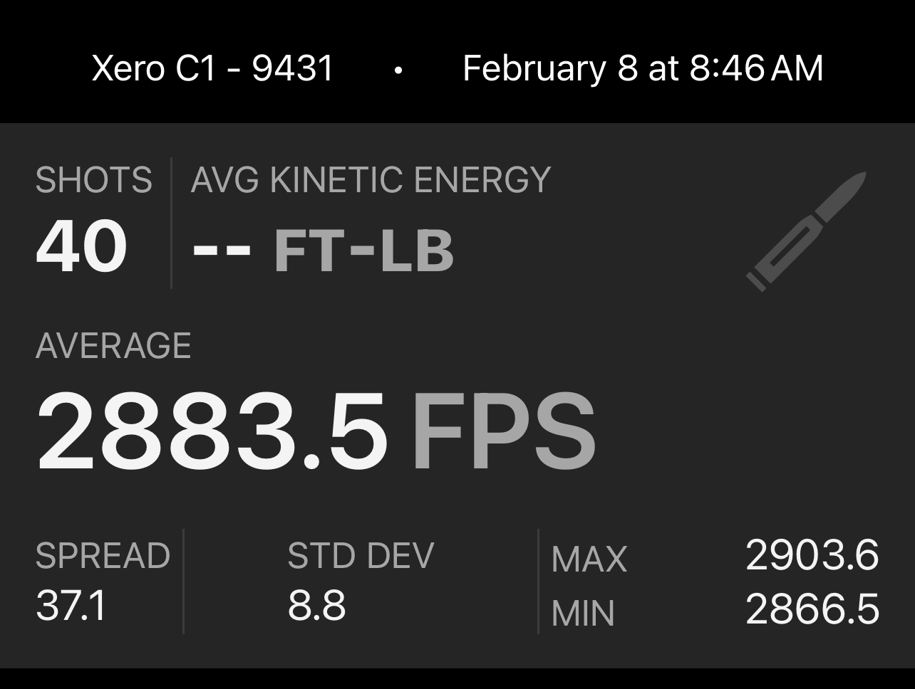

Relatively new to reloading and working up a 6gt load for my Bergara Premier Comp. I'm at around 85 rounds in, so realize things may change as far as velocity as the barrel breaks in.
Alpha brass
108 Hornady ELDM's
CCI 450 primers
Varget
I got pressure signs at 33.3 grains, which was 2881 fps. My concern is these pressure signs were ejector imprints/deformation of brass and a heavy bolt. But looking at all the brass, even down at 30 grains, I'm getting shiny marks from the ejectors. Is this normal...possibly from it being virgin brass? I obviously know the 33.3 is too hot, but it's hard to pick where the marks get "worse". Seeing many on threads like this getting higher loads, so also wondering if there is anything I may be overlooking on what I'm doing.
Alpha brass
108 Hornady ELDM's
CCI 450 primers
Varget

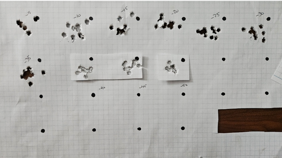

Loaded 15 rounds and tried an uber-basic seating depth test today, starting at .030 and going to .075 in .015 increments. Just shot (3) groups of 4, and (1) group of 3. I did warm the barrel up. I shoot these in backwards order too (short to long)...Basically because if something shoots lights out all I have to do is seat the next group in a little bit and try to duplicate the results.
Anyway, .075 was UGLY. Well over MOA and vertically strung. .060 double grouped on me, then .045 and .030 hovered around the half-minute mark. Velocity for the two groups I recorded was right at my minimum with single digit SDs. I should mention here that my barrel has already done well with N150 and the 105 Hybrid at a similar charge weight, so this wasn't a shot in the dark.
It's a start. I'll load up some more in that seating depth window and play with charge weights a touch next. We'll see if it falls apart on round two.
