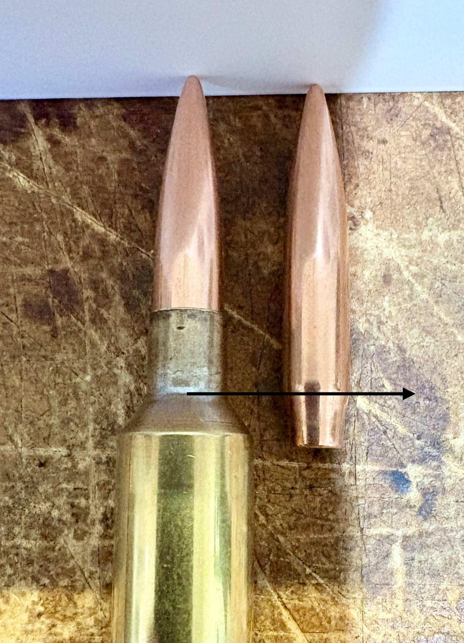

I had to use a kinetic hammer to pull the initial load data lot after finding that some of the brass in that box still had media from the dry tumbler in the flash holes (idiot). Decided to not re-size the cases (still primed) and couldn't be bothered pulling the decapping pin out. The necks were at that point a bit looser, as seen on the arbor press force dial.
Die is a SAC 6 GT + 0.2410" Decapping Expander Mandrel with .263" Neck / Shoulder Bushing.
I was only able to fire one round of the 'loose' rounds at paper, mirage became a major issue at that point in the day so the rest were shot at steel to just get velocity information sorry.
The single group that can be compared:
ChargeTensionMV AVGESSDGroup
33.6Standard2860.229.59.5.399 MOA (11.6mm)
33.6Loose2866.810.83.8.506 MOA (14.7mm)
Overall, the velocity only jumped up marginally on the looser neck cases, but I'd be less inclined to trust them being beaten up the magazine and storage compared to the standard necks. It may never be an issue, but still.... They slipped in with almost zero effort on the arbor press. (y)

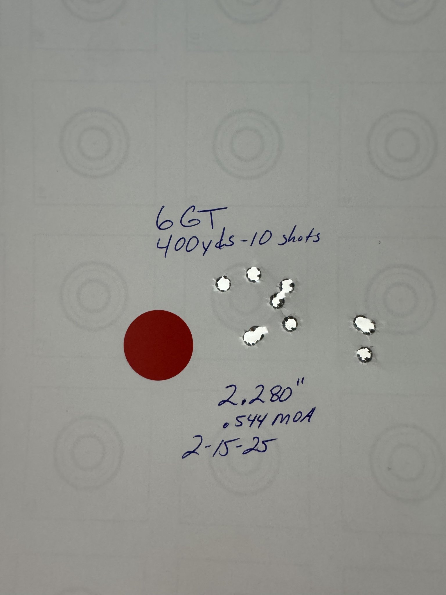

For example, the above seating depth test I posted above... I tested that load at 800yd after settling on my seating depth test and it hammered. I then trued my kestrel at that 800yd and here is the very next shot dialing what the kestrel spit out for 400yd after truing.. Doesnt get much more dead on then that..
As long as you have a good system and its repeatable and know what your doing and why, then youll get the results you want.
A lot of people shoot 100yd for load development because it typically requires less components, not factoring in environmental variables as much. But anyone not doing load confirmation at distance after choosing their final load is just asking for unknowns when it counts, whatever your game of choice is...
I do all my load development and seating depth testing at 100 or 200yd then do load confirmation at 800 or 1000yd. If all goes well, I true my Kestrel at the longest distance then dial up some dope at 400, 600, 800 and makes sure everything is spot on.
For example, the above seating depth test I posted above... I tested that load at 800yd after settling on my seating depth test and it hammered. I then trued my kestrel at that 800yd and here is the very next shot after truing.. Doesnt get much more dead on then that..

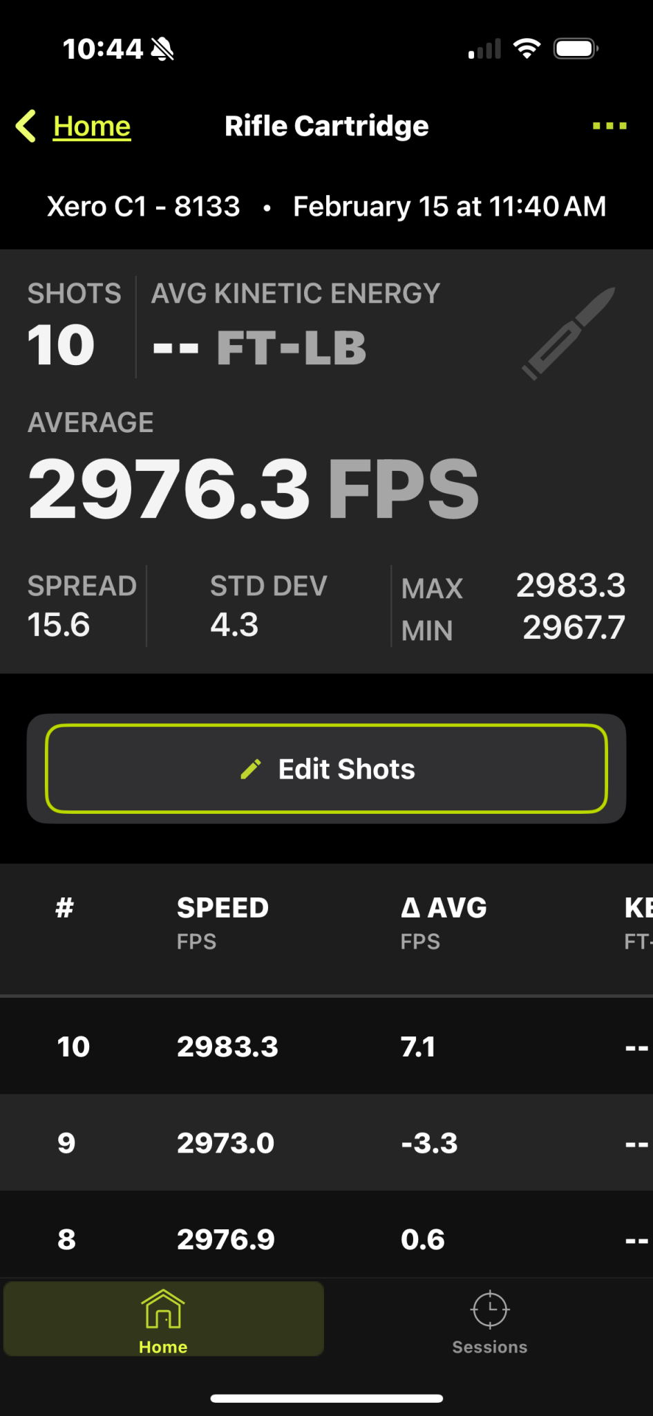

Either way I wouldn’t worry about it. If your velocity is that close you would have a great numbers.
With it being new brass there is no telling where that one piece was in the scope of things. I wouldn’t worry just continue to shoot your “break in” then do another load development after 200 rounds or so on the barrel.
Edit I can’t read lol. See you already have 400 rounds then I would just keep on loading and increase by little bits to gain a bit more velocity and see if the numbers get better.
Another edit. You typed there was a spread of 60FPS but your photos show they are almost identical.

I'm shooting a 26" proof prefit in my AI AT. Running Hornady 105s to bang steel. Touching lands, 34.2 gn of Varget with an average of 2,983. I think I'm seeing a little pressure sign (very slight ejector swipe) so I'm going to back off to 34gn even and see what that produces. Still under 100 rounds down the new tube and produced a .37" 5 shot group last outing. Looking forward to a full summer of shooting and see what this thing will do.
Reactions: CK1.0 and memilanuk
I doubt you'd lose any accuracy backing it down even more if you wanted to.
IMO/IME anywhere in the ~2800-2900fps range is kind of magical with the 6GT, without ever having to step on the brass, smoke the barrel too fast, or think about pressure issues.
I've been shooting only 33gn of Shooter's World Precision Rifle for 2000+ rounds now with 106s getting 2800fps, and it's a pussycat recoil-wise and still hammers out far and prints small groups in close with SDs in the 4-6 range over 20 shots. The only reason I'd dial up to 2850-2900fps is for more smack on plates with the 106 (and I might at some point), but it's been shooting so well "slow" that I just haven't fucked with it, and running it slower has probably made me better at picking up impact locations on closer steel inside 400-500 yards.
