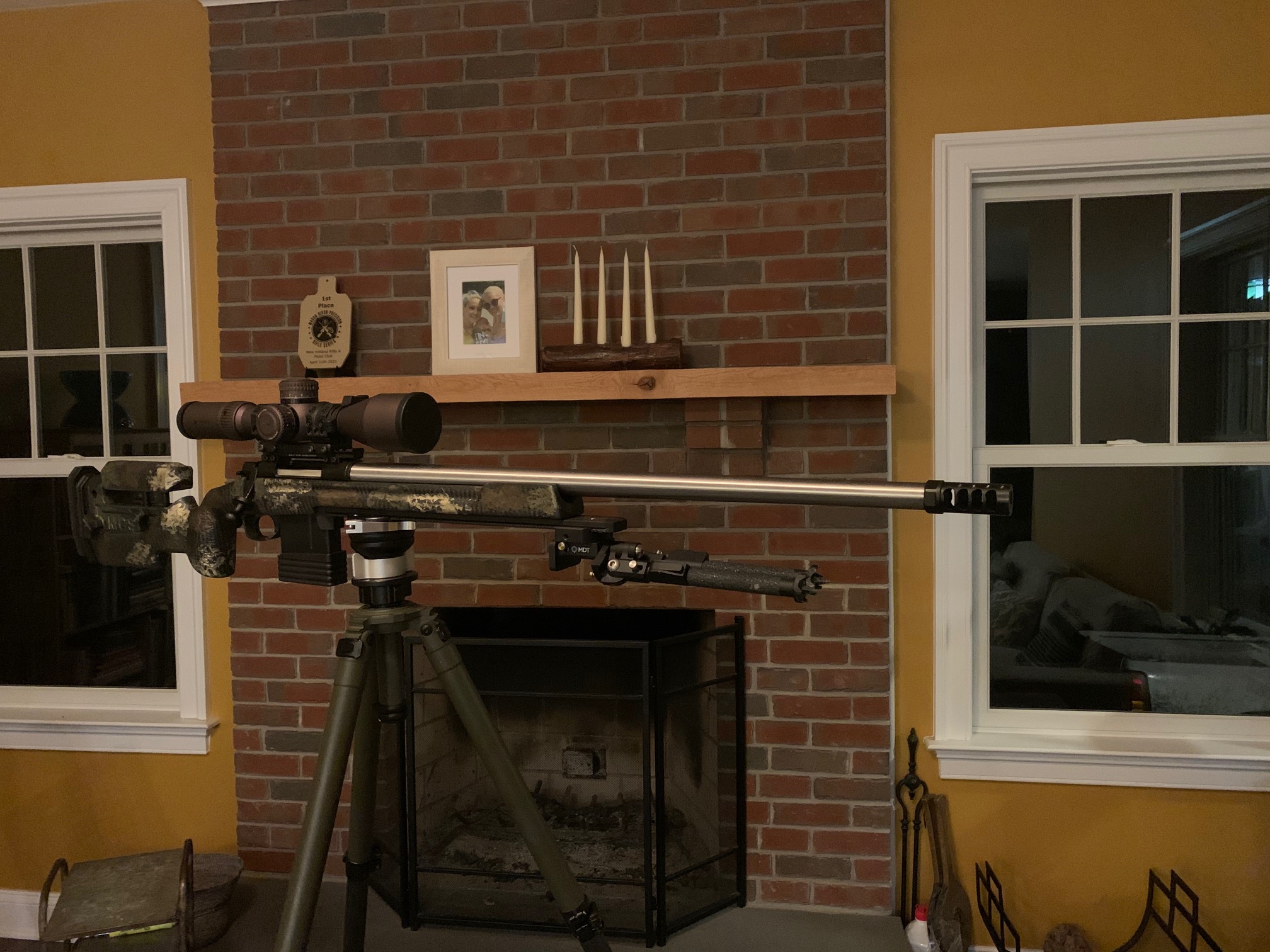

There's no competition in the Gas Gun division.
I just ran my match this past weekend, a PRS Pro Series Qualifier. I had multiples in every Classification and Division, but not a single Gas Gun shooter. Wasted $200 on the trophy..
Too bad I already had plans of I would have brought my 223 out to win that trophy! 🤣
I don’t know shit about PRS gas guns. I know a few guys back east running their rifles and liking them.
I was really asking if anyone else is running a SgtofArms gasser, and how they like it.
You'd probably have better luck posting in the semi auto section.
I can't imagine the 6GT being a popular gasser round....

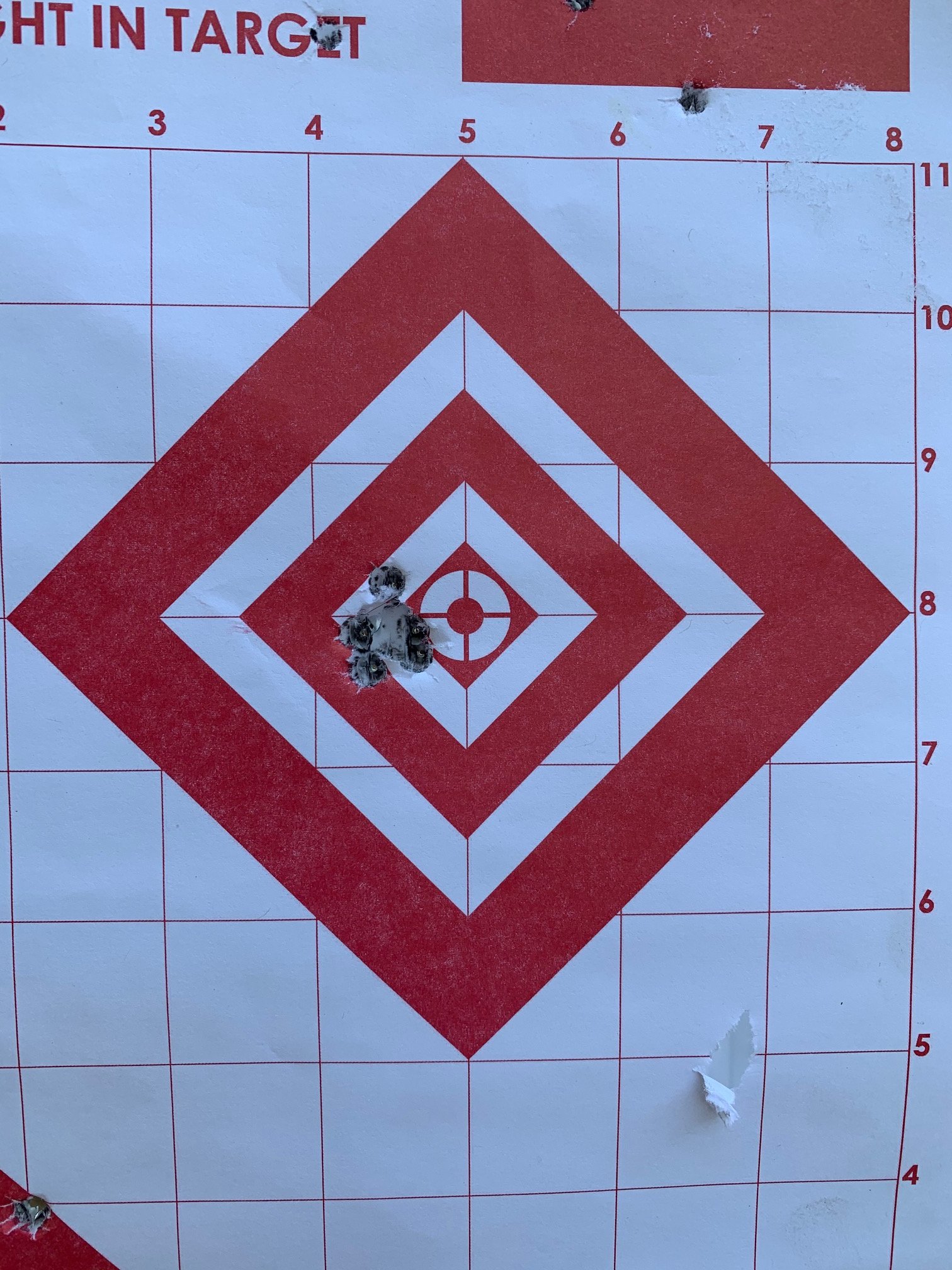

Some results of my first test load for the GT.

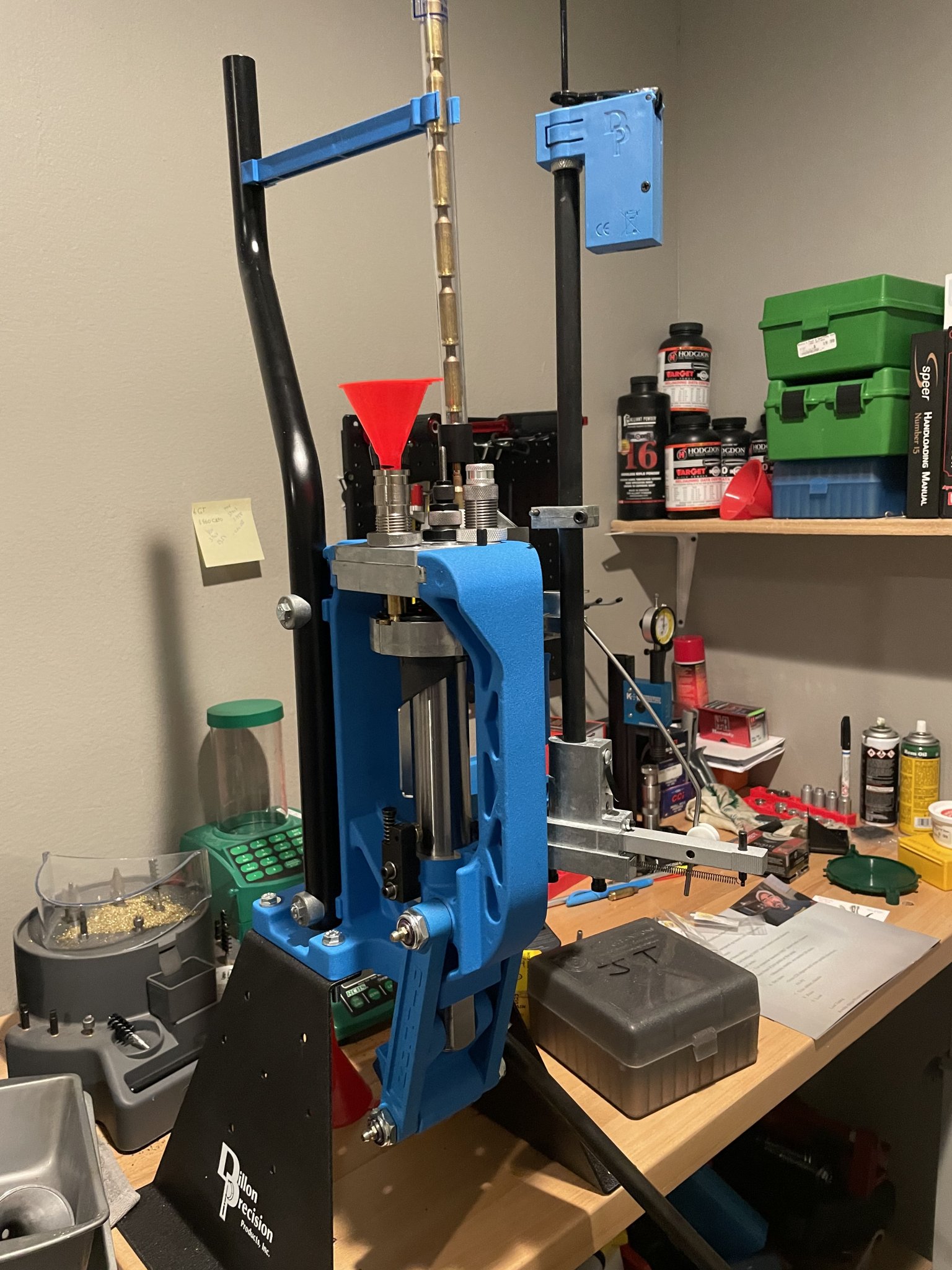

Birddog that’s really bad ass! Stuff like this gets my mind going and that’s trouble for my bank account
Haha, I feel ya.. it all didn't come cheap.
And its been a long evolution to reach this point. It took about a year to really work out the wrinkles on creating a fast, quality reloading system for precision rifle.
I had most of what I needed on this loader as I've 3 gunned for years. Ran many thousands of 223 and 9mm through this thing. It became a simple matter of setting up differing tool heads and eliminating slop in some moving parts.
What I really enjoy is being able to load about 800 rounds an hour for my 223 Ackley that I use as my trainer. I just bulk load it about 2000 rounds at a time. With the bulk Hornady 75gr BTHP, I'm only into those rounds for about .18 cents apiece.
Were you finding too much variance in the Dillon powder drop and you are using the CMs to drop each charge, one by one, or was there another / different reason.
Yes, there's to much inconsistency with the powder drop. That powder device works by volume, not weight. So some powders work pretty good, specifically, small ball powders. And other powders such as stick or extruded are super inconsistent.
I use XBR8208 for my 223 Ackley, and it works great. Its off by .1 of a grain or less whenever there's an error. I can live with that for that particular rifle. Start loading different powders and expecting it to be dead nuts accurate and it won't happen.
So yes, I individually charge every case from powder dispensed by the Chargemasters. Thats why I needed three of them to keep up 🤣

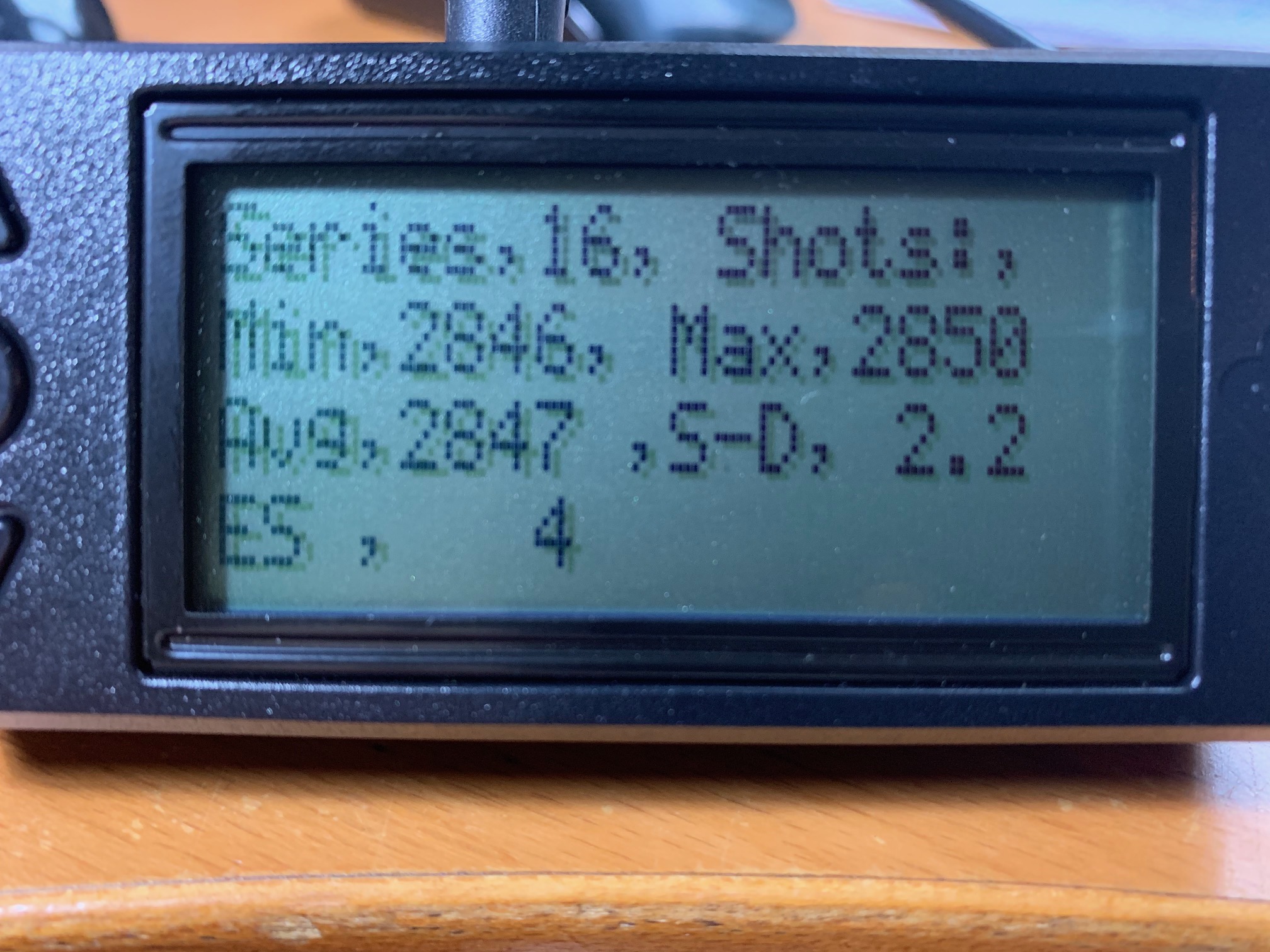

Chrono numbers are #23-25 new barrel so it may speed up, but damn it's pretty close to what I expected per the box & new barrel.
