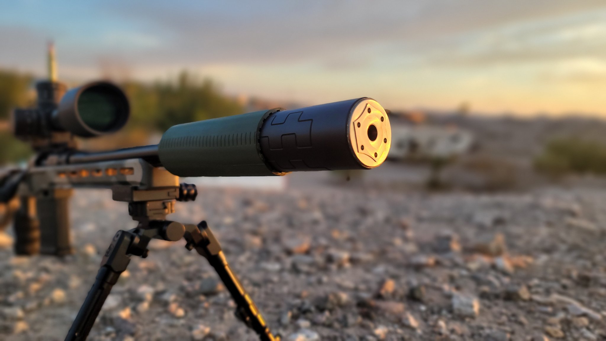

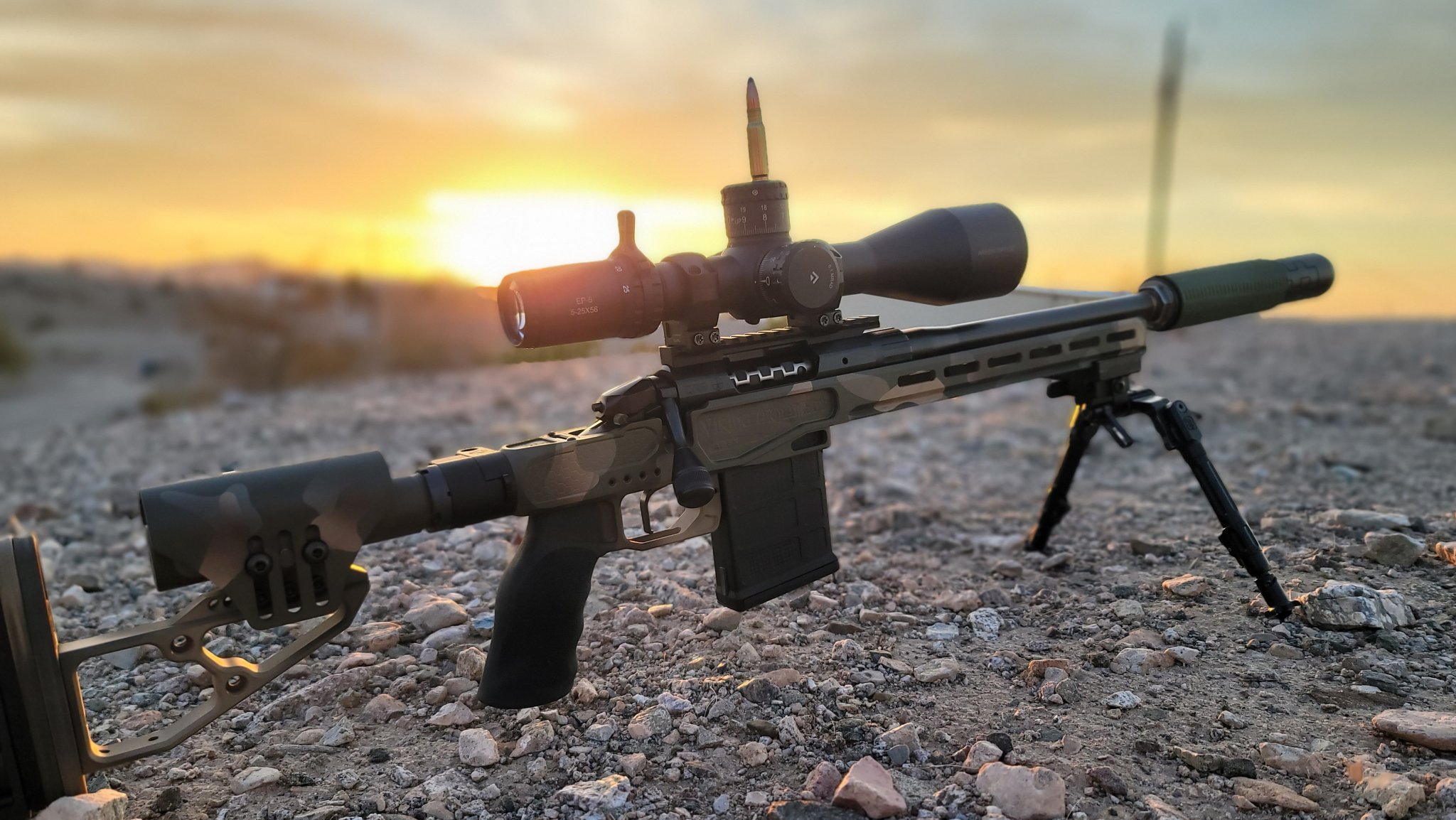

Just finished up this Custom SBR build
Faxon 16" barrel cut down to 12.5" threaded 5/8x24
Kauger Arms CRS action
XLR Element 4.0 Viking Armament edition
Thermal Suppressors Glacier suppressor
Rifle weighs 10lbs fully configured and folded up is 22" with can is 32". Our shop will be rolling out some options for builds

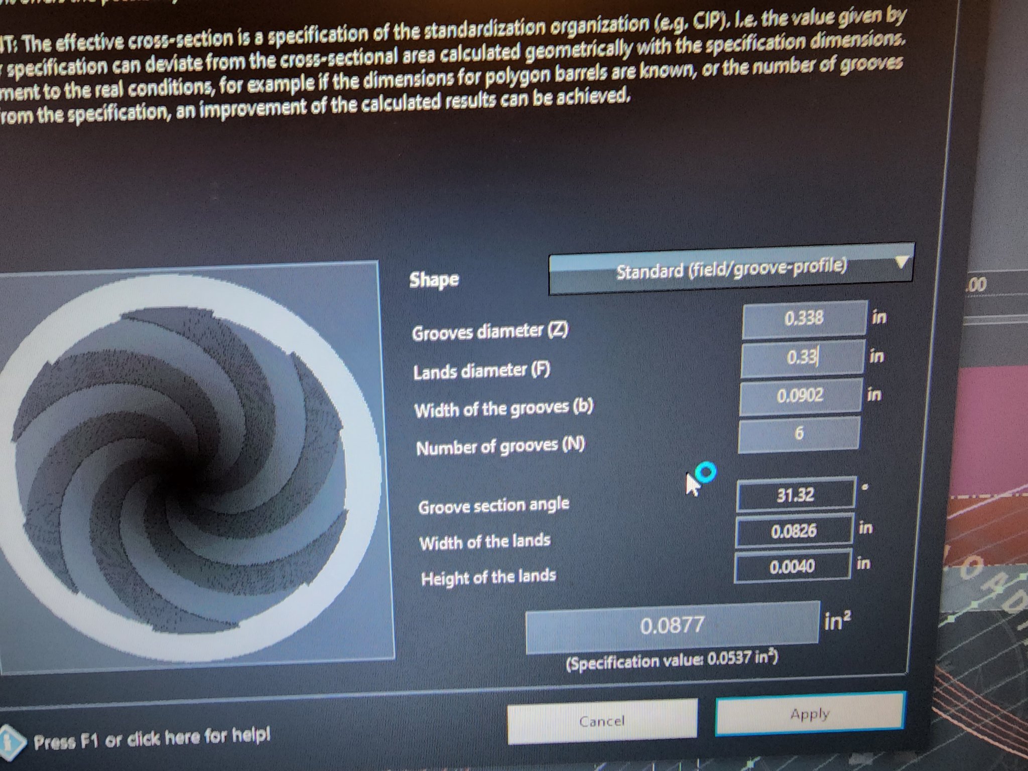

Thank you, I have been learning GRT and I really like it. I use to use Loads From a Disk, but he passed away years ago and his family didn't want to pursue it when I last talked to them a couple years ago.
I found one issue, you have both Z and F set to 0.3382 for the groove and bore, F should be set to 0.3299 that made it happier, and if I set the twist to 8 the error goes away, but when it is set at 3 it freaks out lol.

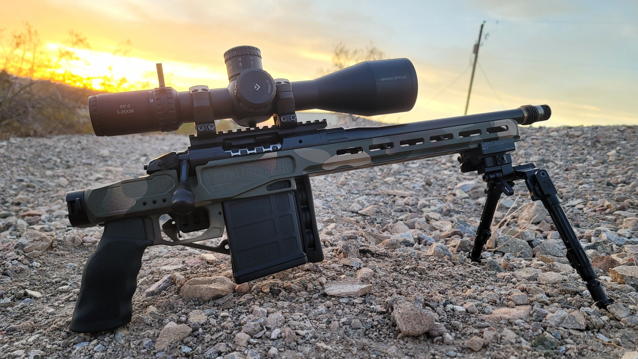

View attachment 7916050View attachment 7916051View attachment 7916052
Gorgeous rifle and nice photography. Might think about jumping into the 8.6B if a cool little suppressed bolt gun that takes the Magpul R700 mags I already have is available.

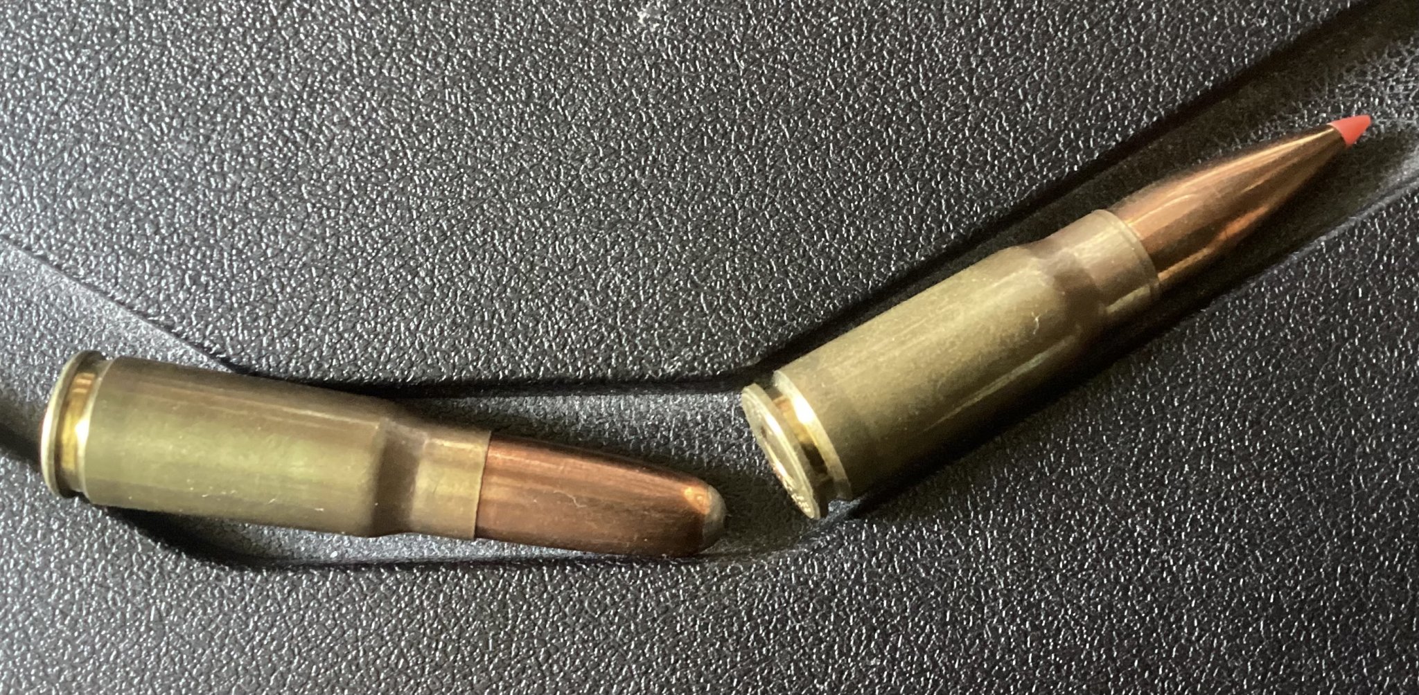

I've given up trying to convert Starline 6.5 brass. I went so far as to turn the necks but it seems to just want to spring back. Its just so much easier to use the Hornady 6.5 brass.
If you’re struggling with brass spring back, then it needs to be annealed.
Nothing about this cartridge should be difficult for brass forming, but sometimes annealing is an important part of the process.

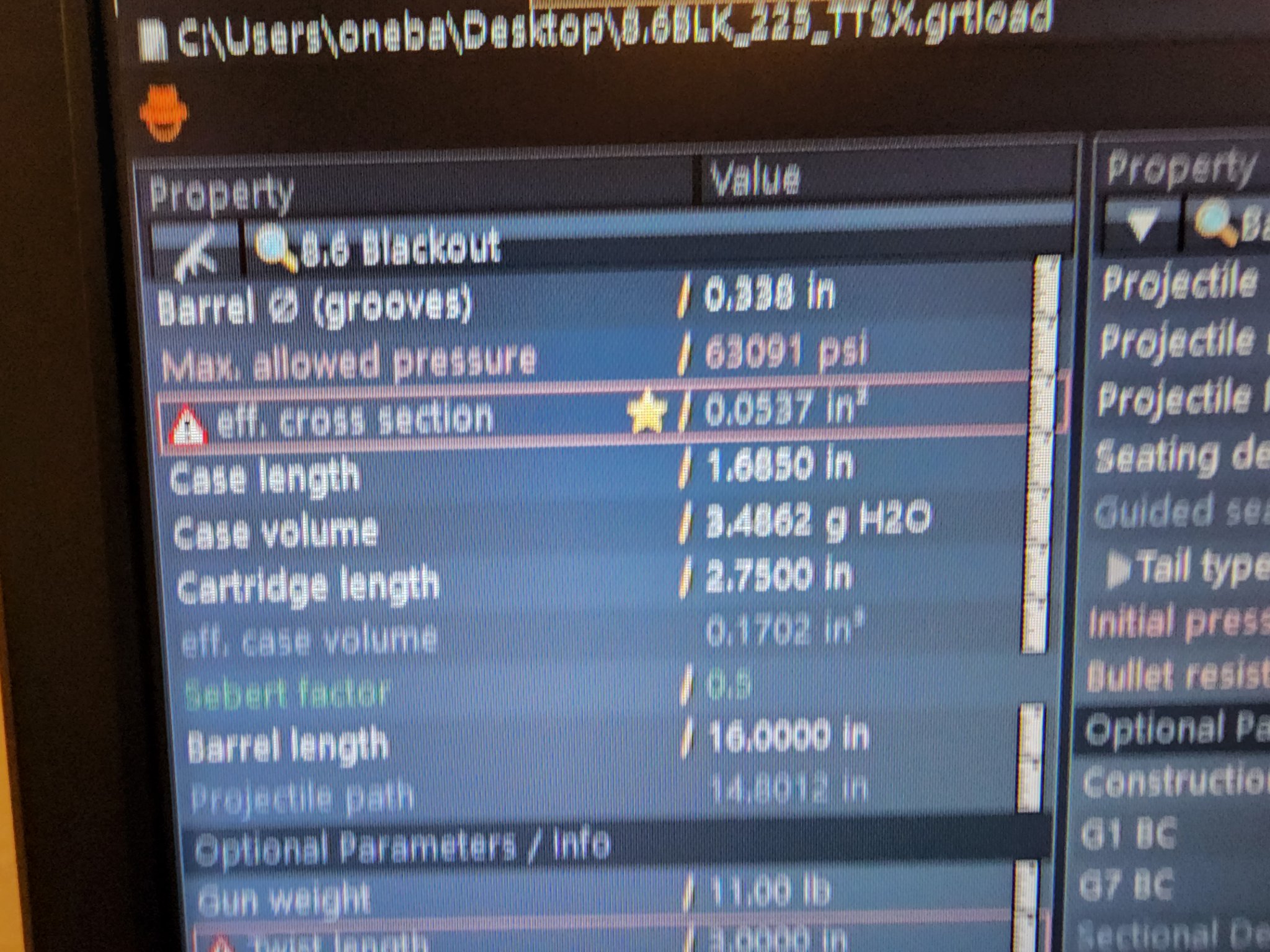

I have a question about the effective cross section in your .grt file.
How did you come up with .0537 as the number? Everything I am reading shows that number should be up in the .08-.09 range and that significantly lowers predicted pressures.
I'm not questioning your numbers, just want to know if there was any method behind it or if it was arbitrary?
Look at F in the second screen shot, it should be different, check my post for what it should be as I am at work and can't look it up.
Greg
Greg
I found your post. Put in the value you set (.3299) and I still get .0878 which is much different than the .0537 in the @Veckk generated file.
The area difference listed above is accounting for a 30kpsi prediction delta.
I want to know if .0537 (what is in the original .zip provided by @Veckk) is arbitrary or if it mathematically generated.
*edit: the difference between .33 and .3299 on the land diameter doesn't make a difference with respect to the effective cross section value outcome.
Greg spotted an error in the original file I had uploaded. Using the corrected number makes GRT output a value thats very close to what Quickload spits out (.0882). I dont know which one is "better" but my predicted velocities are very close to the chronograph readings I'm getting so I'm calling it good for my purposes.
Reactions: SAUMuvabitch
Thanks for clarifying. I went back after reading this post and looked at velocity deviations. .0573 only shows 30fps slower, but shows 30k psi higher pressure.

I had some 185gr .338 federal fusion (bonded) loaded to very mild pressures, that came apart from the ultra fast twist and took out every single baffle, and the end cap, in my supressor.
Word of warning...test fire projectiles without supressors to verify they are staying together.
That seems to be the moral of this thread, I would wager bonded bullets are for subs only
