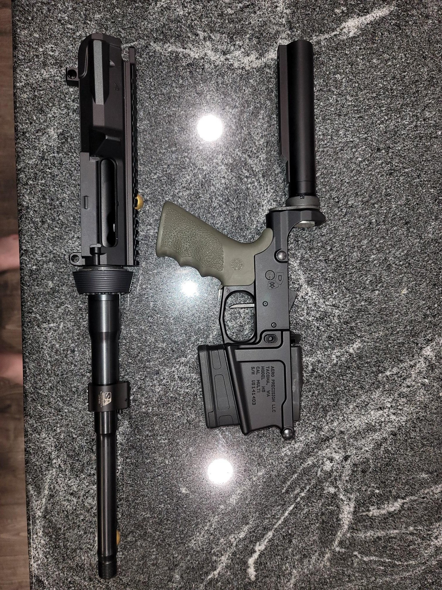

just loaded 25 350gr Makers in mod 6.5 H brass . Built a AR10 pistol off a 12 " faxon and have a 16" Q barrel am changing on my 6.5 Fix. Also got picked for one of the 1 in 50 kits ... at the dealer for me to do the Form 4 on.

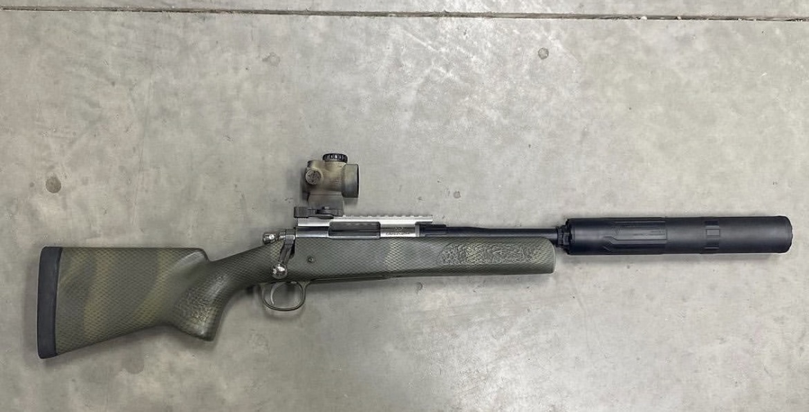

Not specifically on ammo, but kind of interested in doing a setup on the cheap. Someone mentioned Mack brothers as a solid rem 700 action, then snag a faxon or mos tek barrel. I’d like to try the 8” and focus mostly on Subs. Don’t really want a “chassis-looking” chassis , but can anyone recommend a more traditional looking stock that has the V-blocks or something similar so the barreled action can be closer to drop in without bedding, etc? Would like to use a detachable mag.
Had something like this aesthetic in mind. Would appreciate any tips on actions, stock/chassis and the like.
Have you looked at the Magpul Hunter stock? That Mack Brothers action is nice. Pacific Tool and Gauge does a good job, too.

After jacking up my Palmetto State Armory upper I replaced it with an Aero Precision build. :D
So loading 282 hammerheads subs with 15.45 gr cfeblk in converted H8.6 brass annealed amp144 f210 primer 2.6 oak. .75 Moa out my 16” fix with a converted aac titan-qd to hub. Damn quiet don’t have fps as LabRadar took a crap at the range. Using 350 Rex makers @ 2.8 same brass primers seen pressure same gun at 16.2 gr h110. Got lab radar up and running going to range tomorrow

8.6 Blackout 1:3 twist - cast for subs are possible!!!​
This is an exciting time, being at the beginning of something that challenges traditional wisdom. A very few folks have begun to work with cast in the 1:3 twist barrel. There is a very detailed work up on one of the 8.6 Facebook groups that shows the cast boolits holding together until 1115fps with a 24bhn alloy but the poster declined to share the alloy ingredients/percentages. The mold used was a 338 dia 270 grain NOE spire point with no lube grooves. I would like to also do some cast experiments but wanted to get a heavier, flat point mold to work with. NOE has already manufactured, but is currently out of stock, the HTC339-315-FN-BZ1 315gr flat point. There is currently a post on the NOE forums directed at getting NOE to make more of these. Apparently the mold was originally designed for the 338 Specter but will also work in all 338 cal applications.
If you are interested in a 338 mold, and this would work for you in your pursuits, could you please sign up on the NOE forums page?
HTC339-315-FN-BZ1
Reactions: hseII
