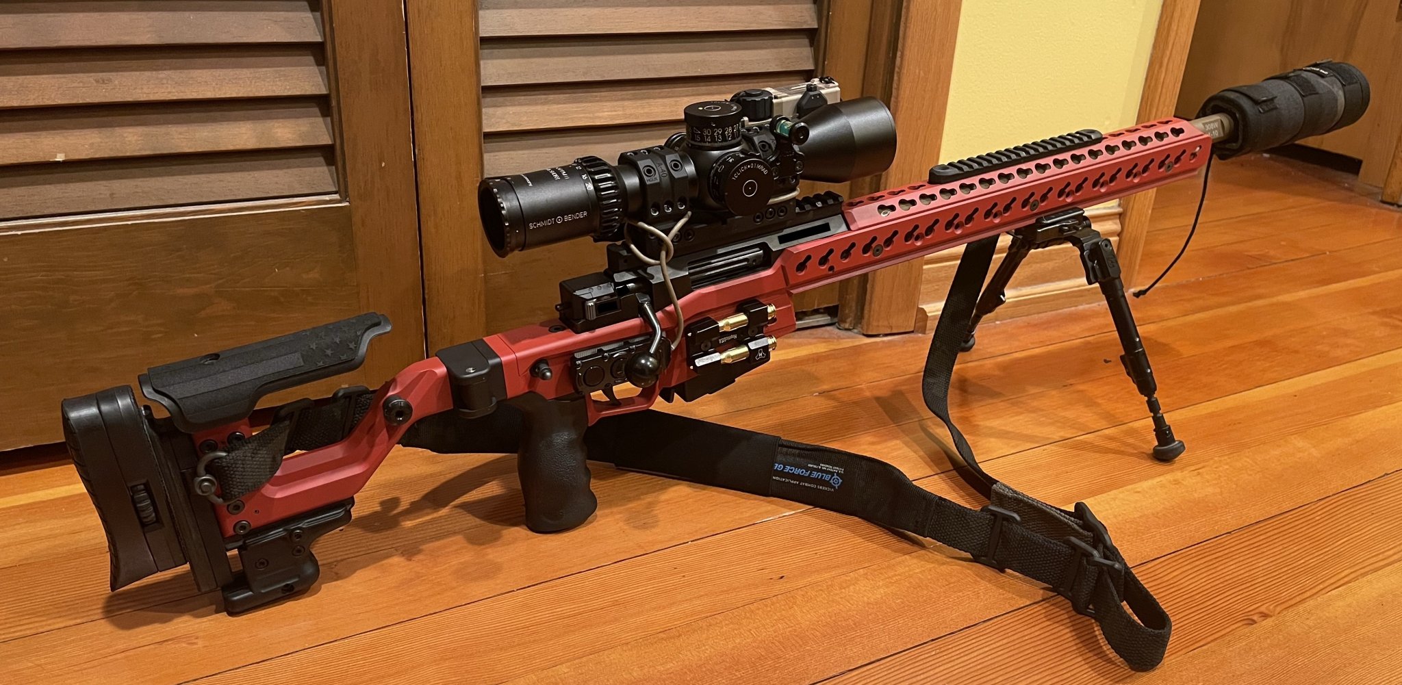

I guess I’m now officially poor.
LOL
I believe I said, "never unless all options were available at the time of purchase." All options were available today so my statement is consistent.
I am on the fence but I figured that this was a no-lose scenario. I will always be able to sell the parts to some poor sole like me when the AXSR is replaced and a southpaw is looking for parts or earlier if the LH parts dry up.
I don't think I would buy the rifle without trying one but who knows
Blue Oyster level pics here. How dare you sully an AI thread with a picture of a Ford. Sure, it isn’t a white Ford, but still.
I guess AI’s can’t buy class. 😂
I kid, I kid.
