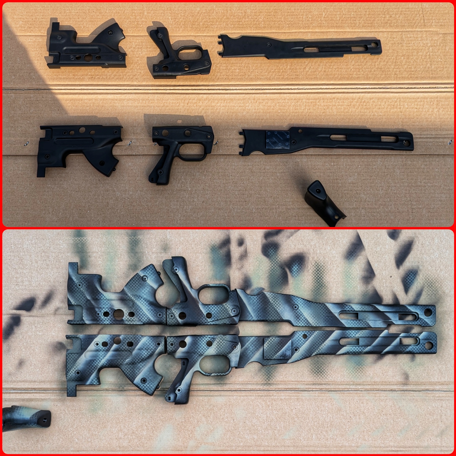

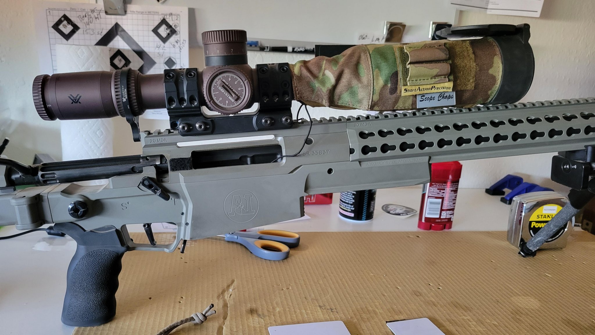

Spoke to some more experienced guys about bonding the ATX chassis. They pointed out the ATX chassis is thinner in design and would require milling for the epoxy to be correct on the flat bottom chassis as well as the washers needed for this.
So after arguing with the voices in my head I ripped her down and loctited all 4 action screws and the 2 screws holding the chassis halves together
#loctiteforlife
#12lbsboltliftgangforlife
With the ATX checking torque is much more involved then a standard chassis as you have to take it apart each time

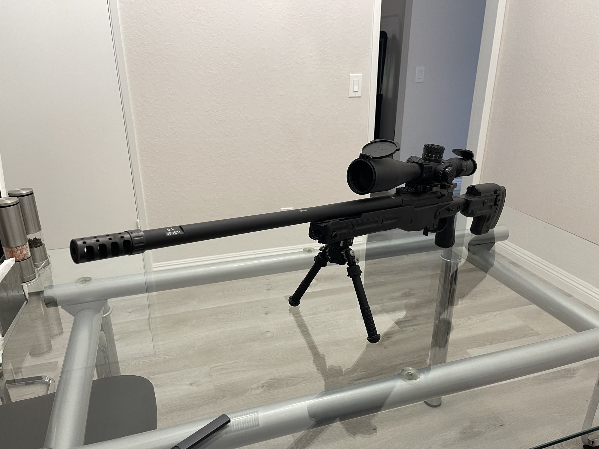

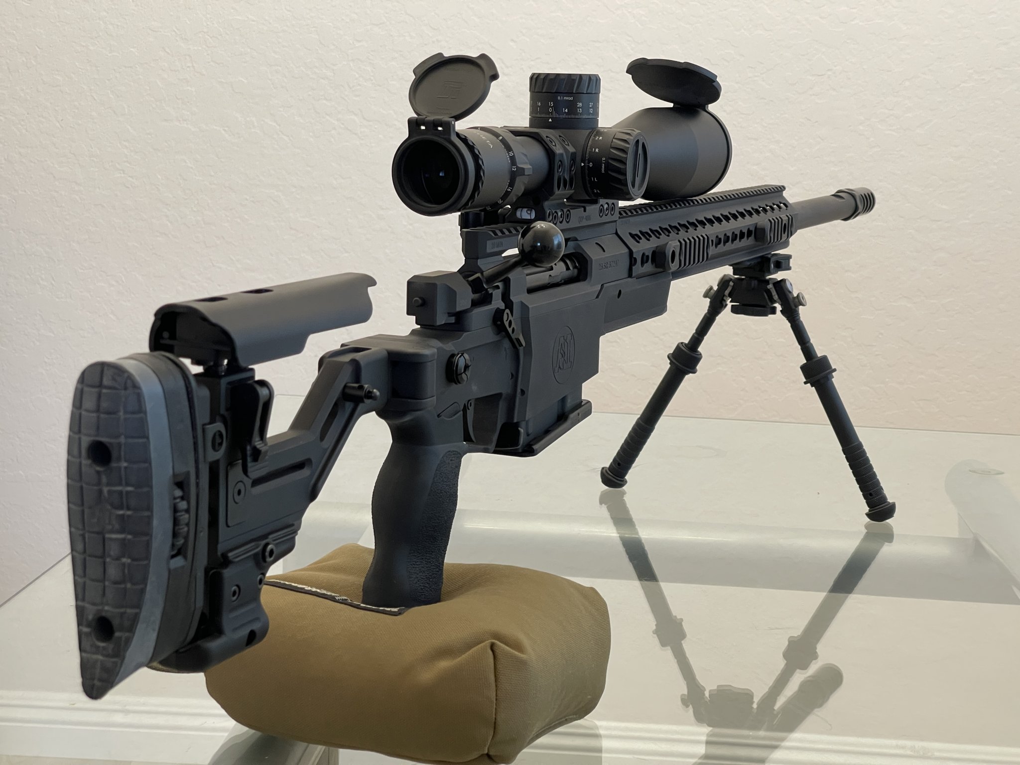

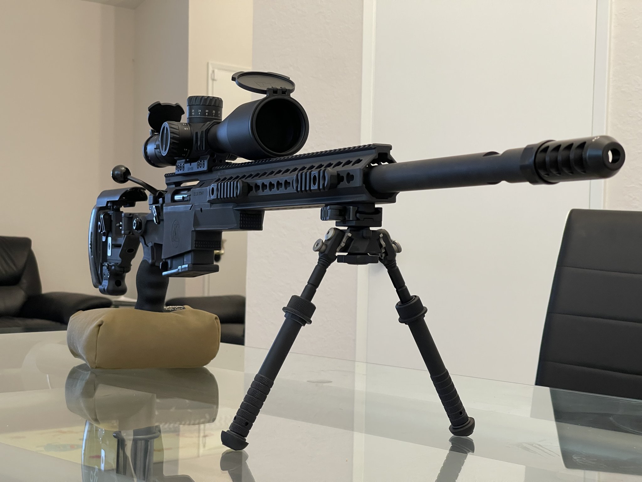

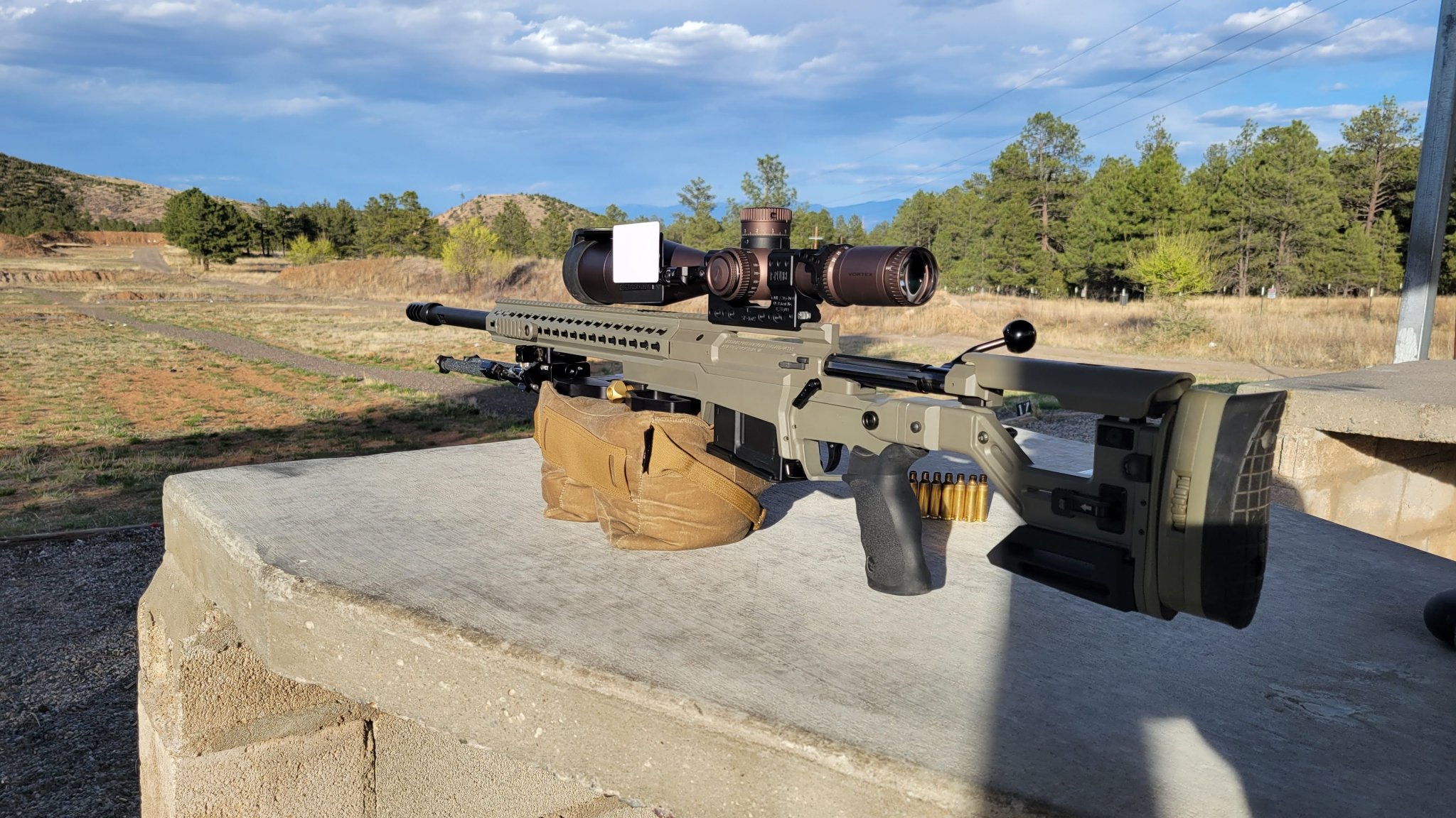

Just picked up this AXSR in 300 PRC. I wanted to get the Kraken but the wait time would be too long and I would miss the CA excise tax deadline!
I am going to try this out at the range tomorrow. No time to get back into reloading yet, so I'll use Hornady Match to see what kind of grouping I get out of the box. Hope the blast won't be too much with this Fat Bastard brake or I'll have to get an Insite Heathen or Ace brake.

Beauty. As much as I love sage green and elite sand, both times I laid down my own cash for an AI I went all black. I was accidentally shipped a sage green AXMC when I ordered. So tempted, but sent it back for the black. That being said, if elite sand was still available that would be my next one now that I have black covered.
I have a Black AT and a PB AXMC.
I am waiting for the Sage Green AXSRs
Reactions: Chargerguy
There's definitely some elite sand guns that are more on the extreme sides of the curve. Below is the same gun with different lighting. I like mine, but I also appreciate that most of the time it looks more green outside. Plus it was different than just another black or fde rifle.
Concrete-ish
Sand-ish
Green-ish
Is it just optic illusion, or is the optic touching the forend bridge ?
#loctiteforlife
This is what I did after my little fiasco...but add that I also did the two screws holding the trigger into the action.
#blueloctiteforlife
#blueloctiteforlife

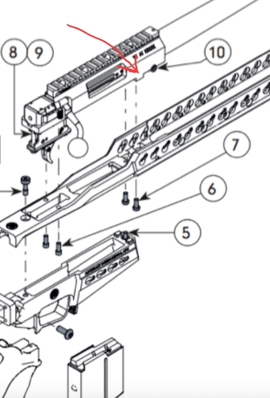

Just wondering is there any kind of internal lug to keep the recoil forces off the receiver screws ?
I have never been inside a ATX rifle.
Definitely happy my AX is bonded, but will keep an I on screws torque’s from now on.
The stuff between the action on the AX/AT/MC would have a hard time keeping the gun together with no action screws fastened under a fair amount of shooting.
People keep calling it bonding but its a carry over from the days when the actions were not as flat as they are today and they needed to keep flatness consistent. I.e the four brass washers to create a gap and fill.
Its not glue and it wont keep the gun together under real use if the screws are not tight.
Lil bit of heat and it peels off like blue tape.
AI might know.
I vaguely recall @Scott Seigmund explaining the compound was used in order to create uniformity between the action and the chassis back in the day AI was leaving tool marks on the actions. Also explaining that the application process is safety hazard to the operators on the assembly line (gasses/fumes ect).
Maybe he'll chime in. Bottom line is the solution to an action coming loose is more torque on the bolts.
Reactions: carbonbased
Do you normally shoot in 250°F weather? Because I've never had an AI fall apart unless it was coming out of an oven.
I use Devcon 2-part Aluminum putty #10610. In my research I found that was what I believed to be what AI used on their production rifles, but I certainly could be wrong. I tried the Devcon plastic steel epoxy and it sucked.
Reactions: Bravo6niner
Not at all what i implied so for the guys in the back that just showed up.
By itself, I don't believe its meant to keep the gun together under a heavy use which is what most people here think its meant to do.
Does it add a thin layer of extra holding strength specially considering there is zero draft between the mating entities?
Sure.
I mean...I don't think anyone believes the bonding is intended to allow the rifle to perform normally without action screws, but I know for a fact it won't come apart on its own.
In my opinion the true benefit of the bonding agent (which IS glue), is to prevent zero shift in the event of a hard knock or rifle drop. An inherent weakness of a flat-bottom action on a flat-faced chassis is lateral impacts can shift the action in the chassis worse that a round action in a v-block.
I shot the best 100-yd group of my life with an unbonded action in my chassis, but then when I beat on the barrel with a mallet the zero shifted. When the action is bonded I didn't have any issues with zero shift.

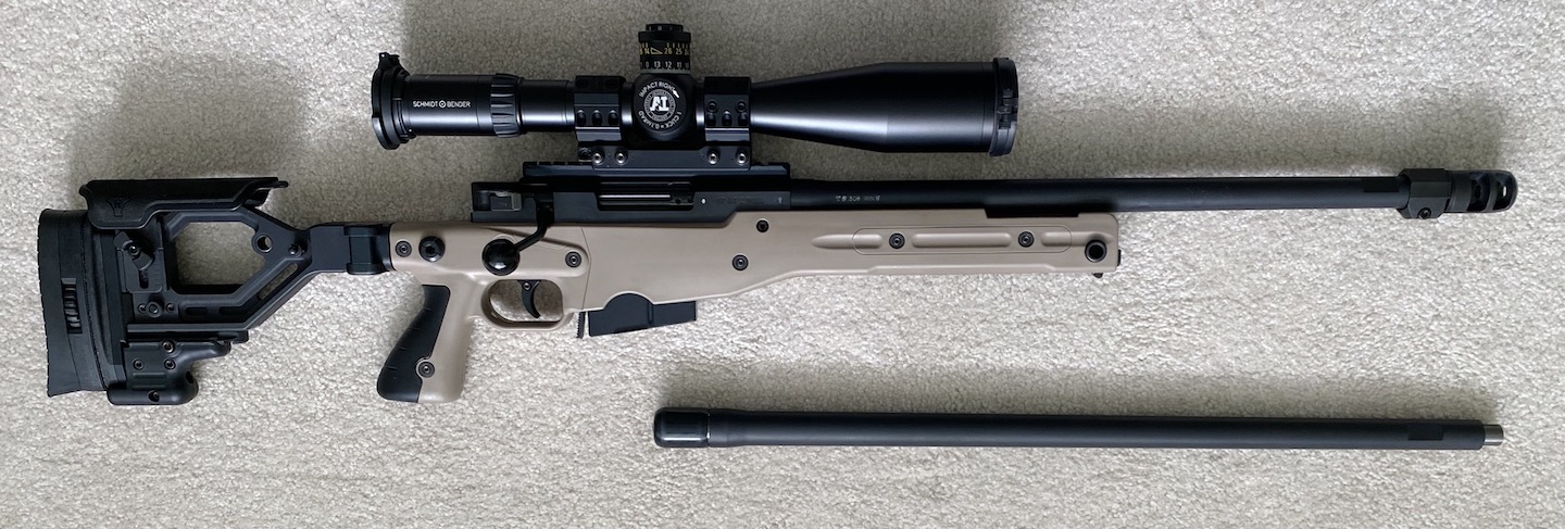

I have read throughout this thread that while 49lbs is the spec for the barrel, many have found 55lbs to be the sweet spot for returning to zero.
If I do not intend to change out my barrel until it is shot out, will 49lbs suffice?
-Stan
You can test it for yourself, but if it's shooting good at 49 in-lbs there's probably no reason to change.
I never had an issue with 49 in-lbs personally. I had a theory that for the bonded rifles (AT/AX) that had issues with 49 and needed to go up to 55 or even 65 in-lbs, that the barrel clamping feature had excess epoxy on it that prevented it from moving freely. This was shown on a rifle or two that had been de-bonded to be put into an aftermarket chassis. Obviously this wouldn't apply to non-bonded rifles.

I agree with @samb300. Just shoot your zeroed rifle, loosen the barrel, unscrew it a bit and screw it in, and then try 49lbs. Shoot again and see where the shots go. Try other torque values if 49 is no bueno.
Do this a few times and you’ll know the answer for your gun.
Personally, I follow the process here:
Except on my AX, I am lazy and don’t take off the handguard or wipe the mating surface on the front of the action (can’t reach it with handguard on). My AT is easier in this way.
I use 60lbs. I haven’t tested it. I should. So take my advice for what it’s worth.
I think installing the barrel when the gun is upright is easier anyway. Doing it consistently the same way might/might not be important. I fall into the former camp.

Are most AI shooters using torque wrenches calibrated well enough to distinguish between 49 and 55 ?
That’s basically 10% and a quick google search said most torque wrenches are advertised +- 2-6%
I use the Fix It Stick 49 in-lb limiter, which yes, is listed as being +/- 6% (46 - 52 in-lb)

I use 65 and the AT and AXMC produce slightly better groups at that setting. Nothing to lose sleep over though.
I use my Snap-On torque wrench which I calibrate annually. In the field I use torque limiters that are not calibrated
