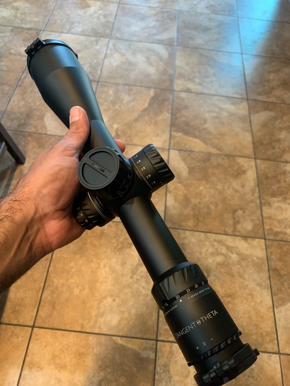

Did you shave down the reptilia diving board to fit the GII razor objective bell? 🤔
Anything against the ZCO, or you just wanted to compare?
Nothing against it. Was trying to sell it to buy and try the SB636 with the TR2ID, but a guy on here offered this as a 1:1 trade so I said sure.

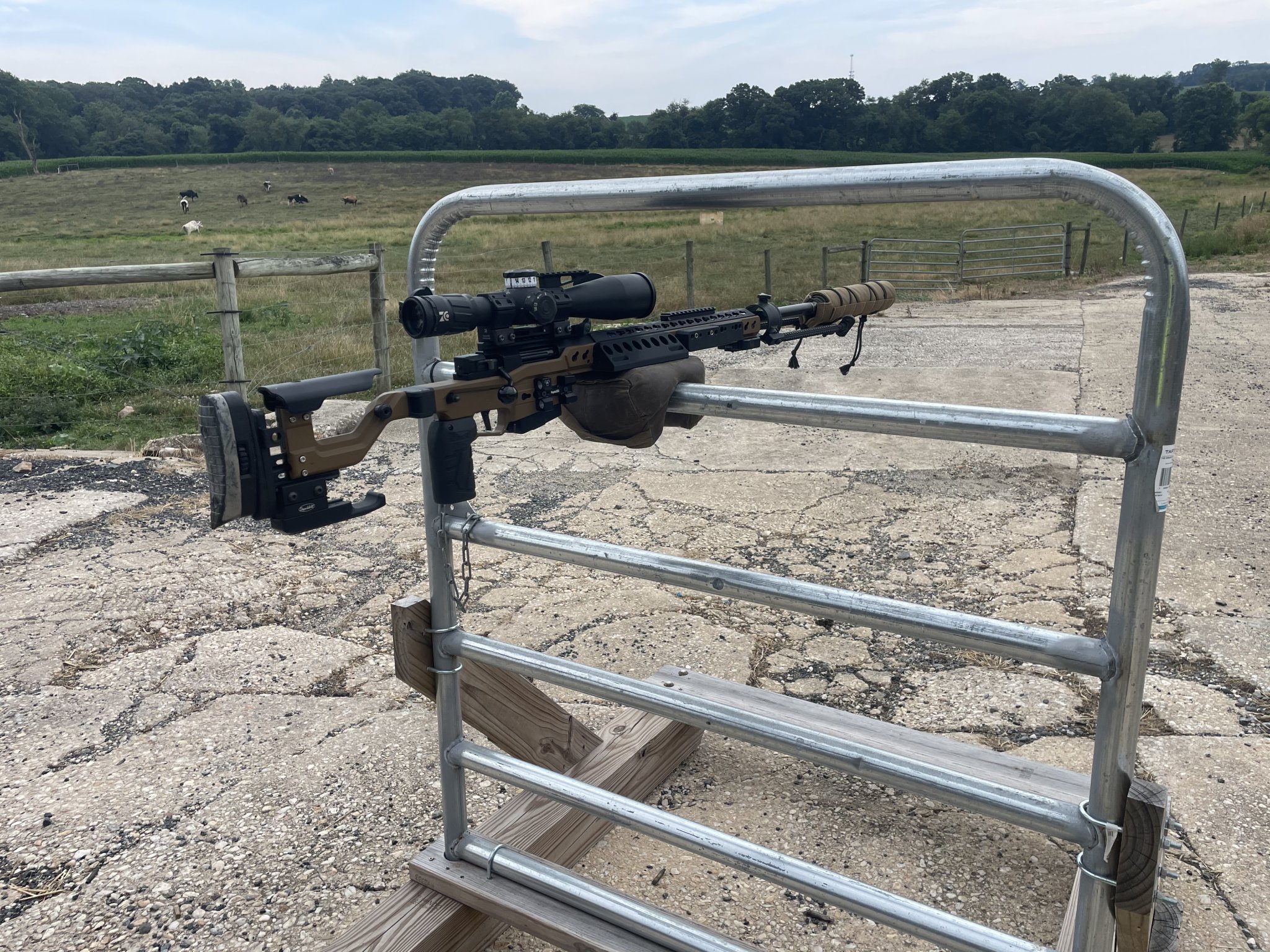

Just bouncing around scopes before picking one to live on the AXSR before I paint it.
