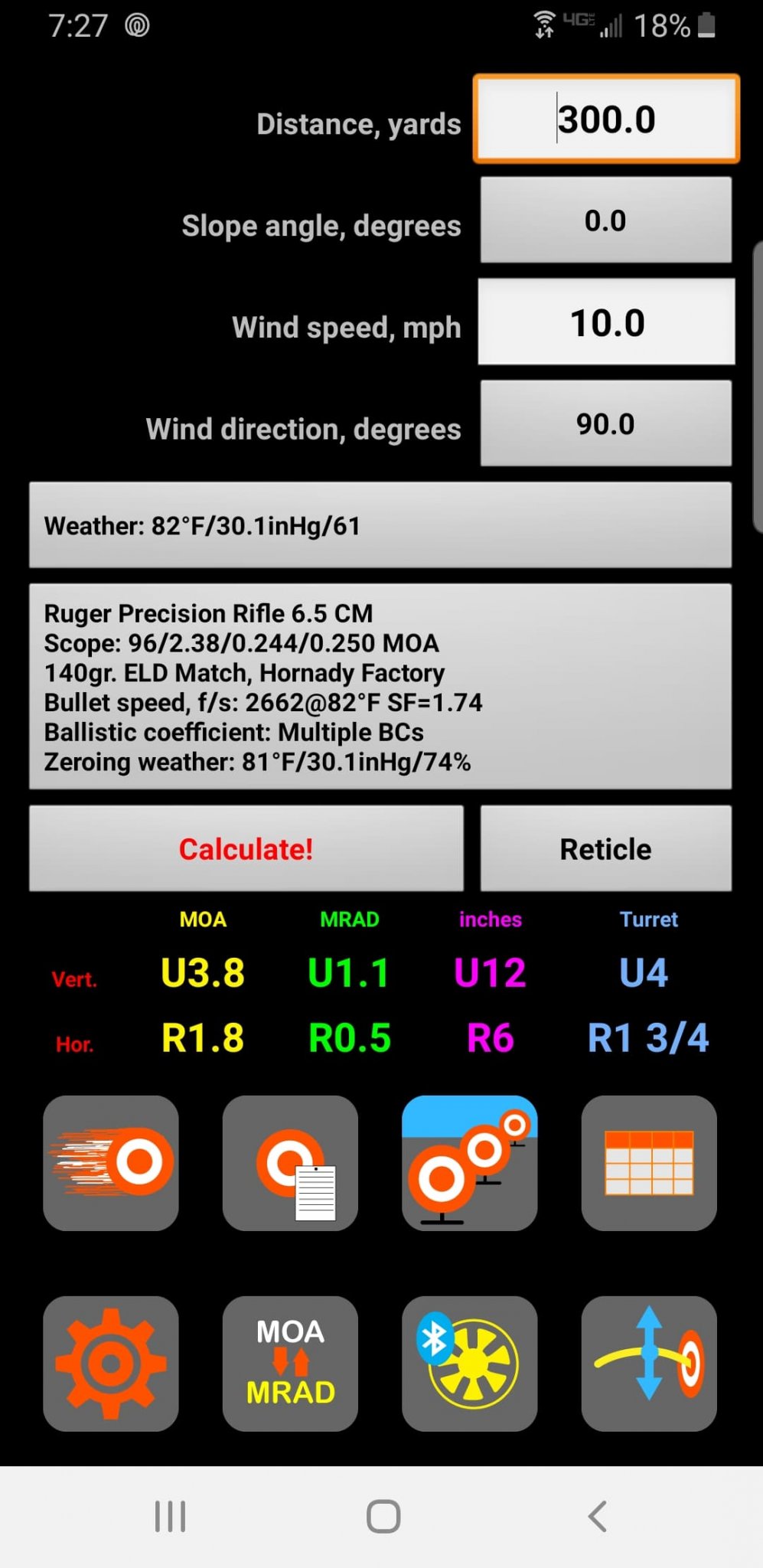

    ANOTHER new feature on Strelok Pro!
    I am continuously impressed with what Igor Borisov is doing with the Strelok Pro ballistic app! He constantly improves it. I own a few of the other major ballistic calculator apps, just so I could compare. Strelok Pro wins, hands down!
    So, those already using Strelok Pro are familiar with entering your parameters and then hitting the "Calculate" button on the main page:
    7059882

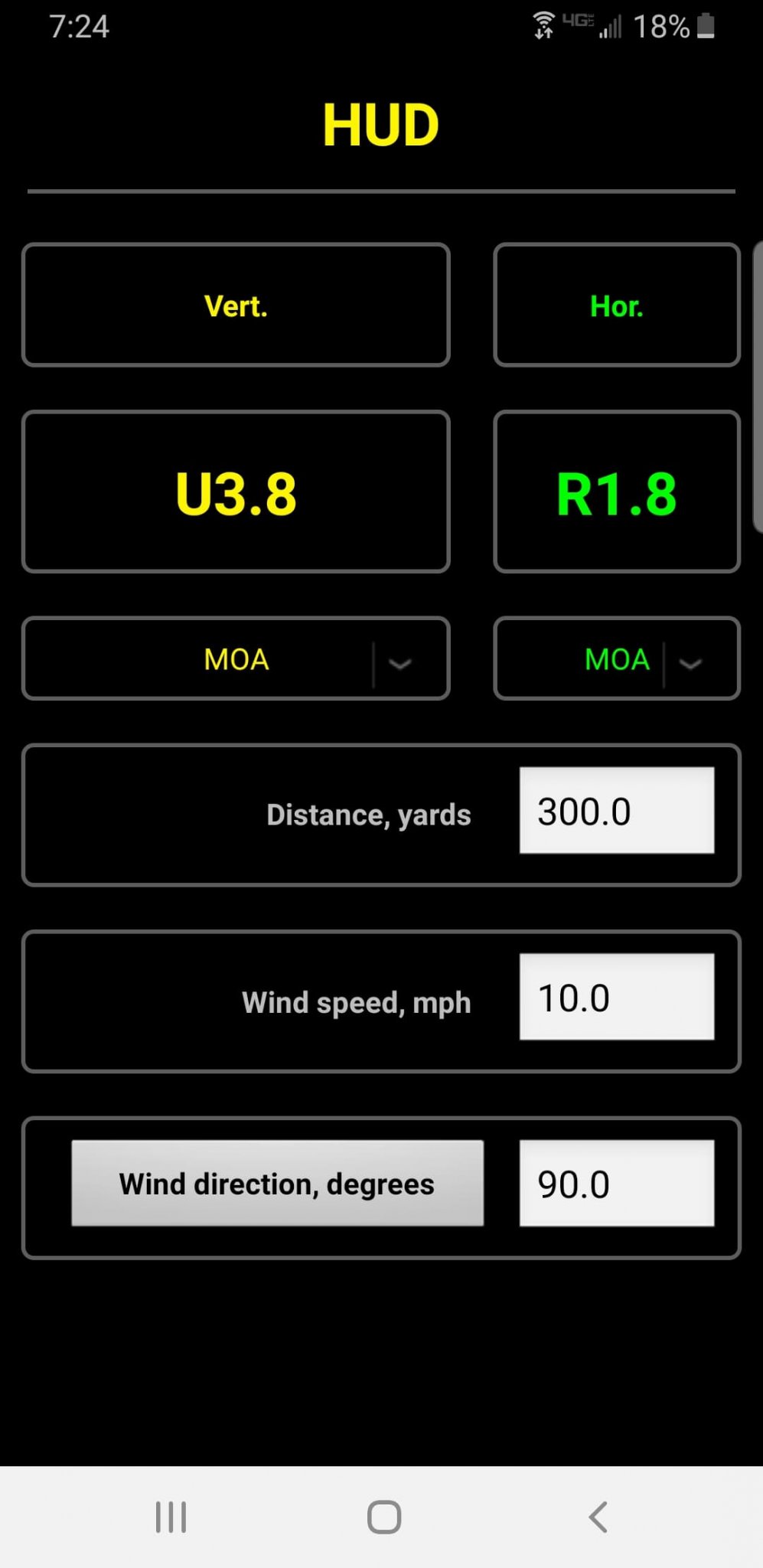

    Now there is a "HUD" feature that appears if you "long-click" the "Calculate" button. "Long click" meaning that you press and hold the button. It produces a simplified and easier to read display of your turret values. You can also change the wind and distance parameters from this window:
    7059883

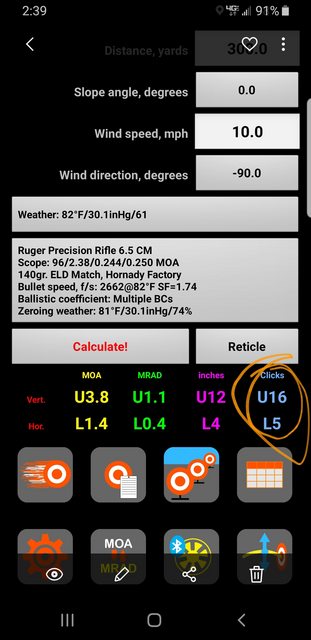

    I also discovered a couple of Easter eggs in strelok Pro today.
    The first is that if you tap on the turret settings in the ballistic Solution on the homepage, it will toggle between 1-3/4 format and clicks. (Circled in orange)
    7060046

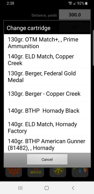

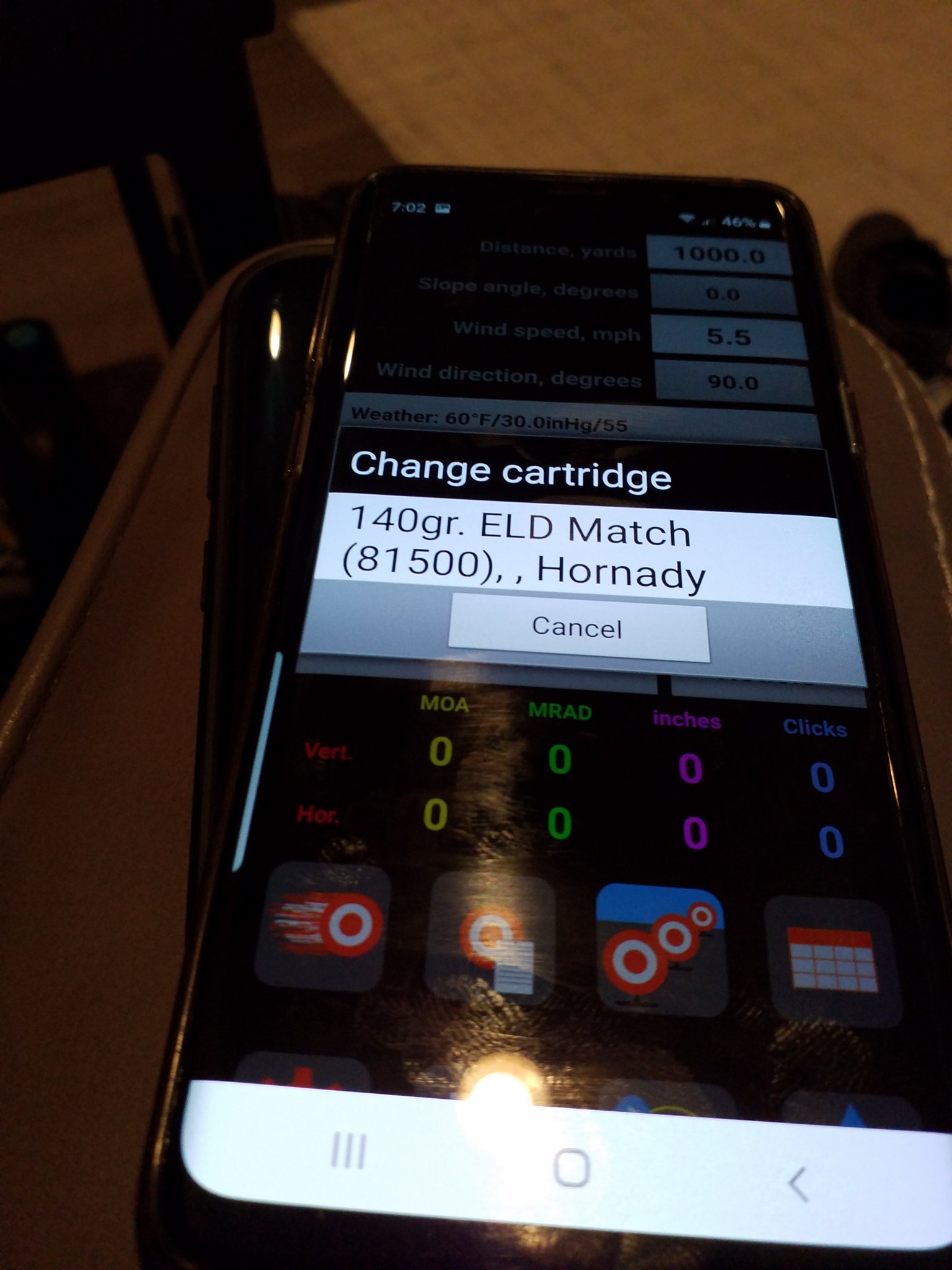

    The second Easter egg is if you long tap on the rifle information on the homepage, you'll get a quick-change pop-up where you can change the cartridge that you're using (instead of drilling down through a couple of pages). Cool!
    7060047

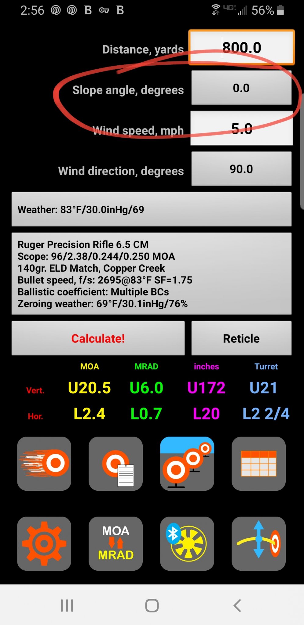

    Not much occasion to use this really, here in Florida, since most of us are shooting at nearly 0-degrees.
    You can use the camera to set the slope angle.
    First, you've got to check that option in the settings.
    7083849
    Then tap on the slope angle box on the home screen.
    7083845
    Then you'll see this camera view. Put the crosshair on the target and hit "OK." It will enter the measurement (-11 degrees in this case) into that field.
    7083847
    If you tap on the "0," it will zero out the slope angle field.
    Pretty neat, eh?

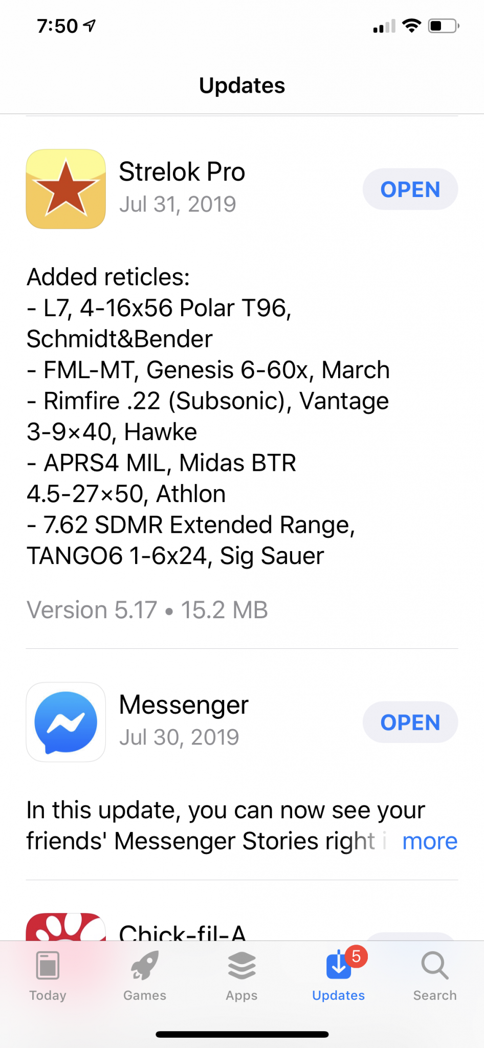

    just seen that. mines showing 5.17. i'll check again but I couldn't get the Pst 4-16 FFP to pull up. nothing 4-16 in vortex.
    You are going to have to look for the Reticle name which is EBR-1 and then choose either the MOA, or MRAD version, and SFP, or FFP whatever version you own; also it isn't listed as Viper PST, plus "Vortex" is the last word listed for each reticle not the first.
    Manufacturer's often use the same reticle for several scopes, Zeiss is a prime example for that, so I guess the designer of Strelok Pro decided to list scopes by the corresponding reticle because the data you receive allows you to hit your target using this particular reticle which might be used by several scopes and he didn't want to have to list that same reticle over and over again with the addendum of another scope name.
    This is how they are listed:
    EBR-1 MRAD SFP, 4-16x Vortex
    EBR-1 MRAD FFP, 4-16x Vortex
    EBR-1 MOA SFP, 4-16x Vortex
    EBR-1 MOA FFP, 4-16x, Vortex
    Yours is either the EBR-1 MRAD FFP, 4-16x, Vortex, or the EBR-1 MOA FFP, 4-16x, Vortex depending on whether your scope is in milliradian, or minute of angle.

    I'm using an iPhone 6 and updates are automatic for me - now using 5.17. You can find the version by opening 'settings' and scrolling to the bottom, click on 'about strelok pro' and it will show what version you have.
