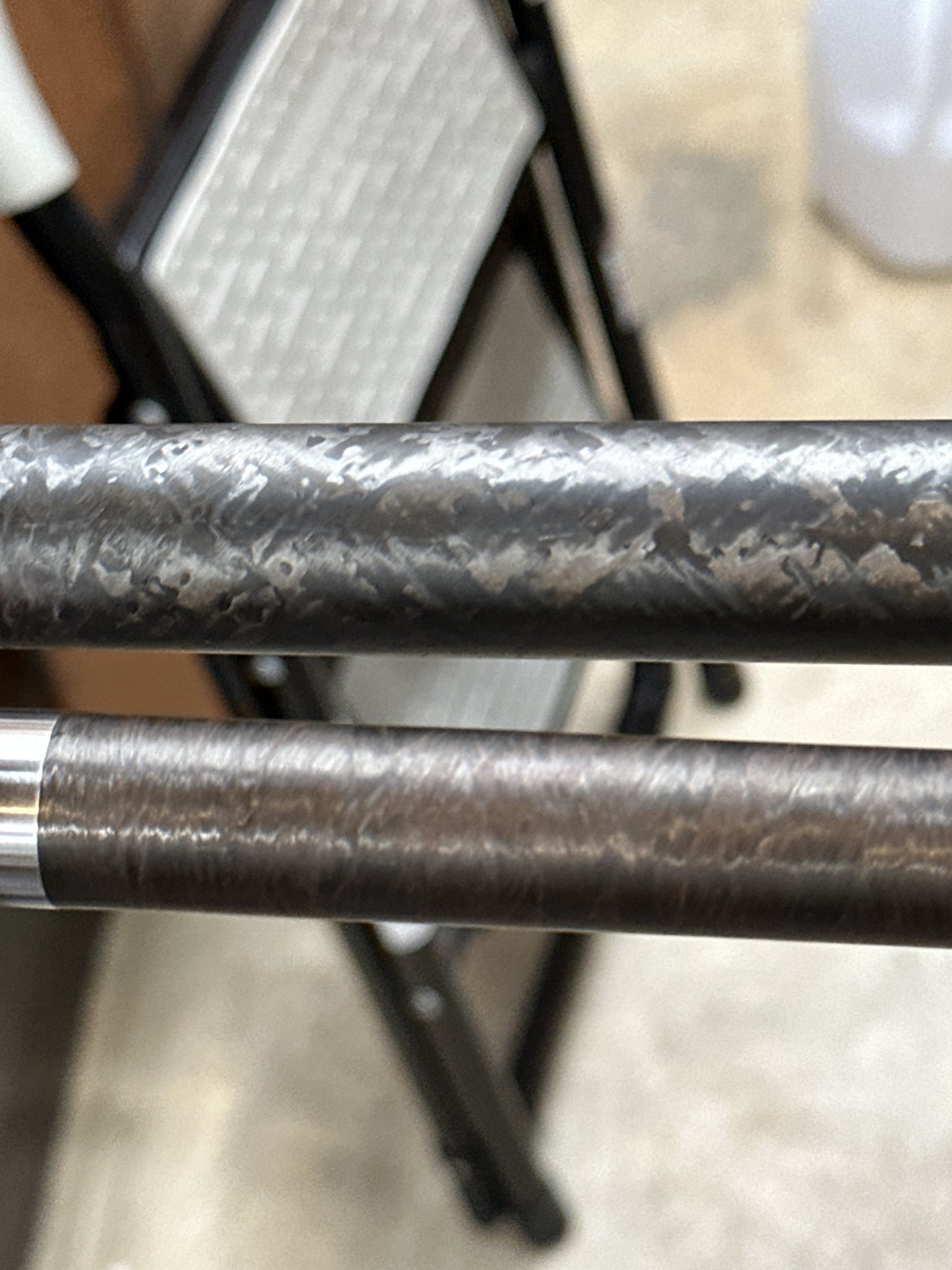

Another thing I noticed is that the Bartlein barrel I originally installed on the CDG seems to have point of impact shifts, depending on how heavy the suppressor is at the end of the barrel.
I don’t have that issue with my TRG 22 with any of the suppressors I put on there with the stainless barrel. (all suppressors shoot the same POI on the Bartlein stainless barrel, which was a significant shock to me… TBAC Ultra9, R30K, Biscuit 30)
Proof (top) vs Bartlein (bot)
I have a stainless rock creek crucible Uber heavy barrel on its way to PVA to spin up a solid steel bbl to see what the differences are between them.
….and PVA is making an Osprey 1:7 CF bbl to compare to the other two!
It was a little surprising to me that the bartlein was such a thin profile and that’s the only profile their carbon fiber barrels come in.
bartlein CF come in 2 sizes. one is an M24/M40 (might be 3 now?)
