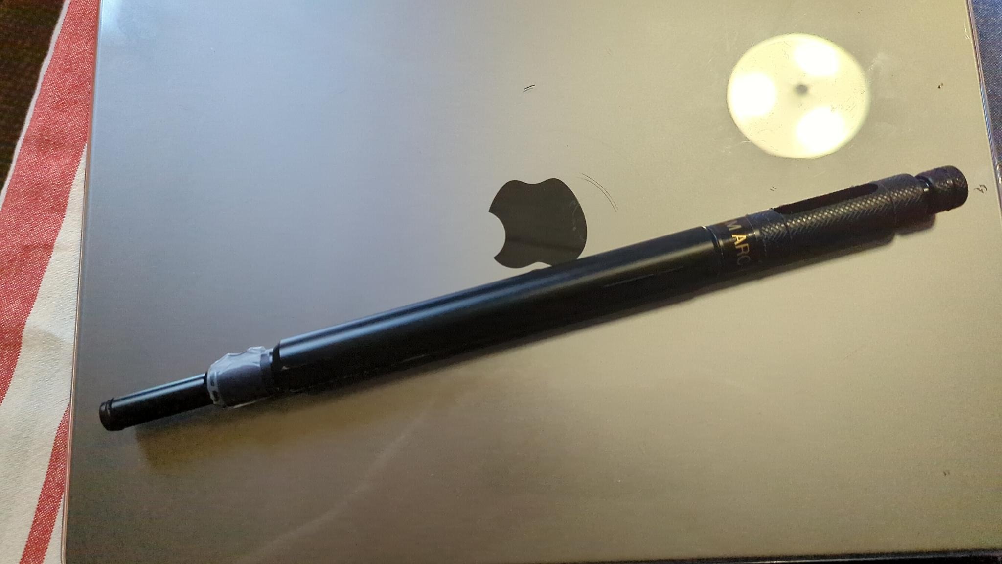

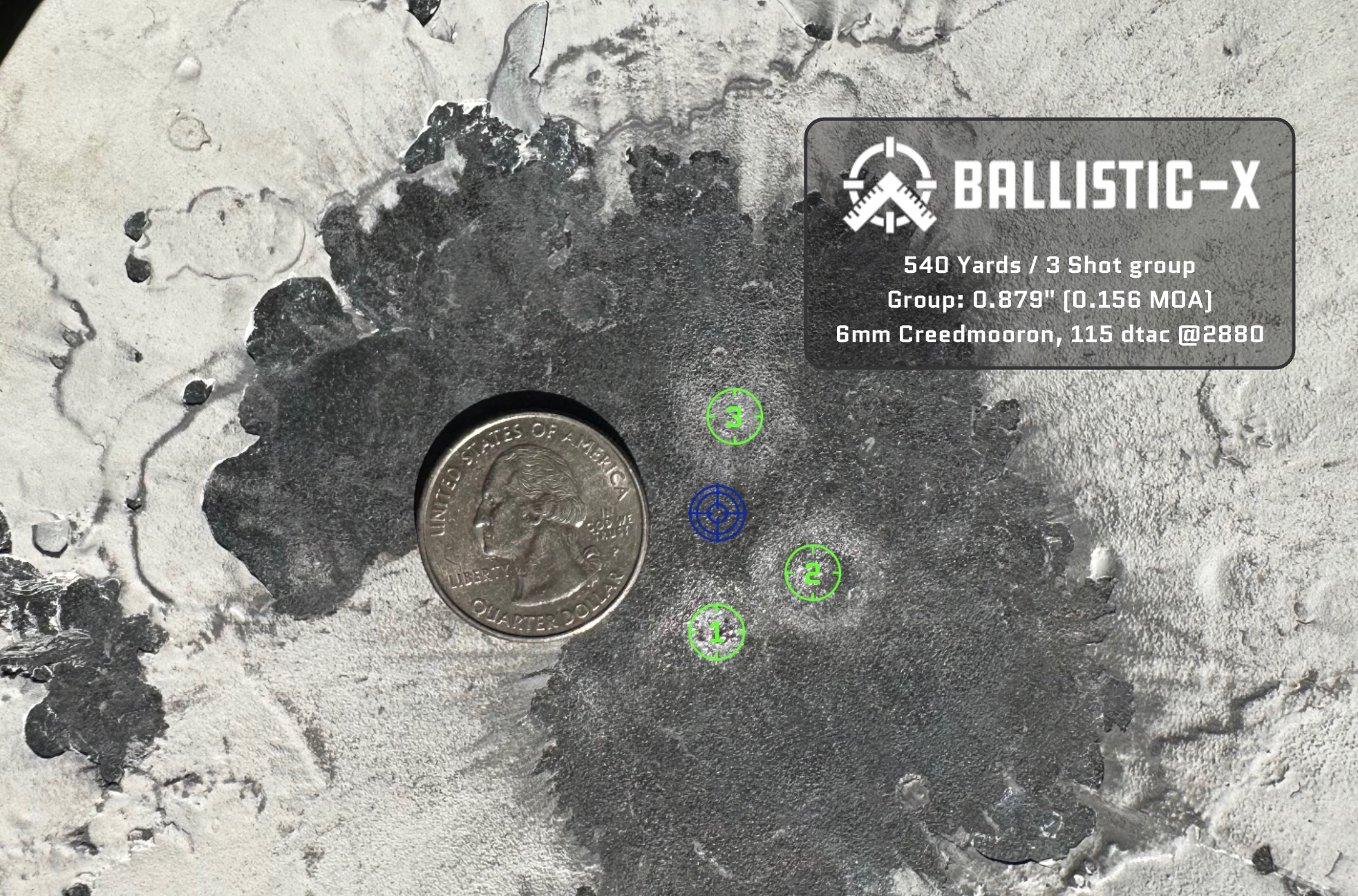

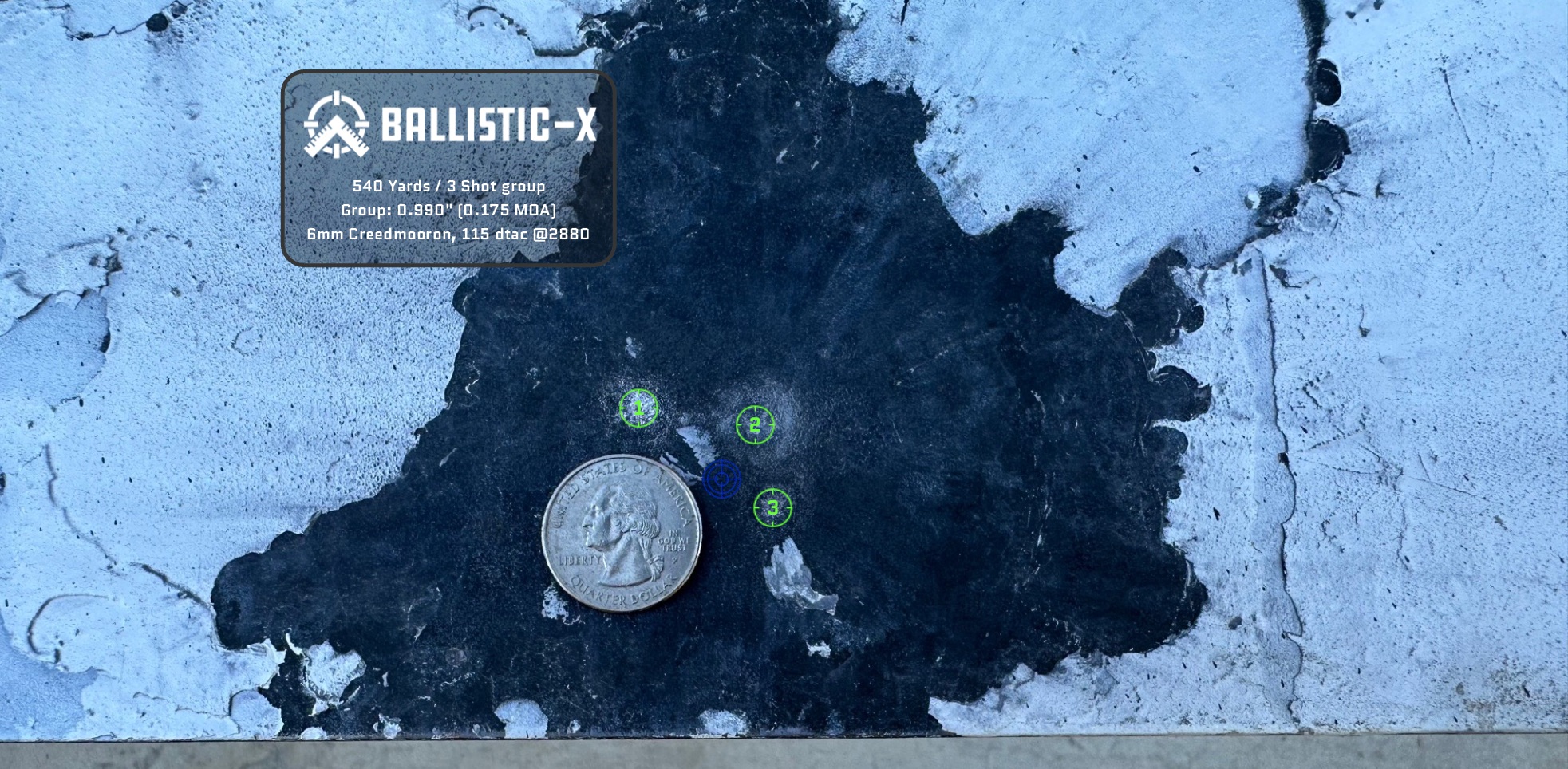

The short action is keeping me satisfied for now. Suppressor test with two different cans. U7 and a Diligent Enticer LTI shot back to back.
View attachment 8189575View attachment 8189576
How has accuracy been with the Enticer? I need a "precision" can. Tbac is usually the answer, but I'm curious if the diligent stuff performs as well in the accuracy department.
The top pic is the enticer, so no degradation in accuracy. There was no point of impact shift between the two cans also, which is nice. Its only 1.2 oz heavier than the U7 gen 2 when both are in Area 419 trim. Among the quietest and lightest cans ever made for $850.

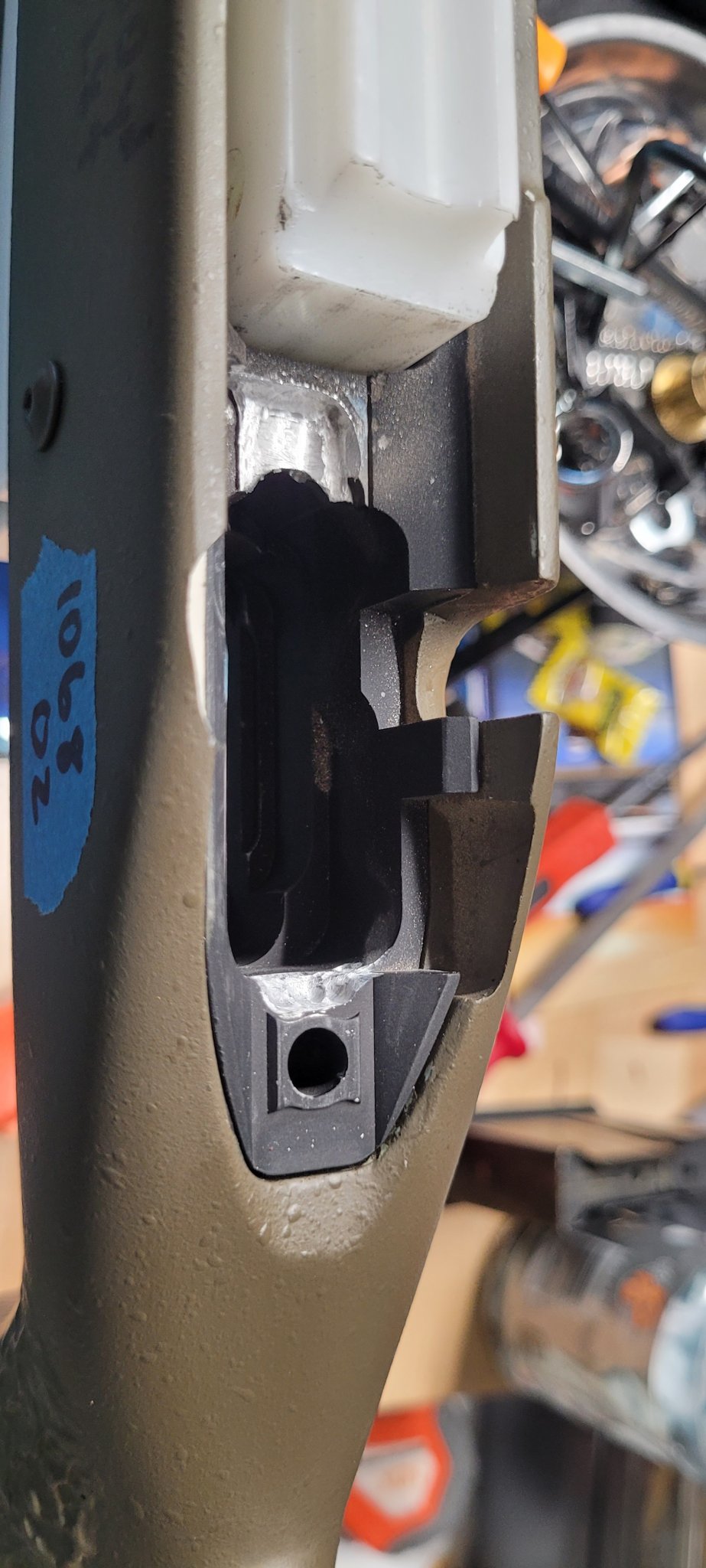

Wasn't able to get them to seat all the way. You could probably get them to work by taking more material off the mag latch but I didn't attempt it.
I haven't been able to get mdt or arc aics mags into my xlr or atx chassis with a cdg action installed. The dimensions of the front the mag cut on the action just don't seem to let the mag come up high enough to latch. To me this seems to be an AW only action.
  • Wow
Reactions: b6graham
MDT 6mm ARC.
I’ve got an ARC, Accurate, and AW kicking around for short action that I haven’t played with, but will by next week as far as checking out the chassis/action - short action barrel hasn’t come in yet.
Interesting. I didn't try adjusting the latches, but usually an aics mag will slip up into the action cutout some to get rounds up above the feed ramp. However the mags I tried with the CDG def didn't present like a traditional aics cut. Even my tl3 that aw cut let's aics come up all the way up. I'll attempt adjusting the latch and see if they'll even catch.
I couldn’t latch AW and AICS in the same chassis without adjusting. Even between MDT 6mm ARC and Accurate .223 AICS I had to adjust the latch, but both fed fine.

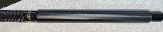

Courtesy of Mike Lucas, I just received my bore guide for the CDG. Nice work. I'm waiting on placing the boretech order as some stuff is missing at their place.
Hard to tell in that picture because the left side is in the shadow, but is Mike now cutting the needed relief for the ejector on side of the bore guide? I played with the brightness and contrast of your picture and it looks like it may have a flat cut on the left side, but it's still hard to tell.
Mike is now milling a slot in the bore guide for the ejector. I had to send mine back since I ordered them prior to the action hitting the streets. Just received them yesterday.
