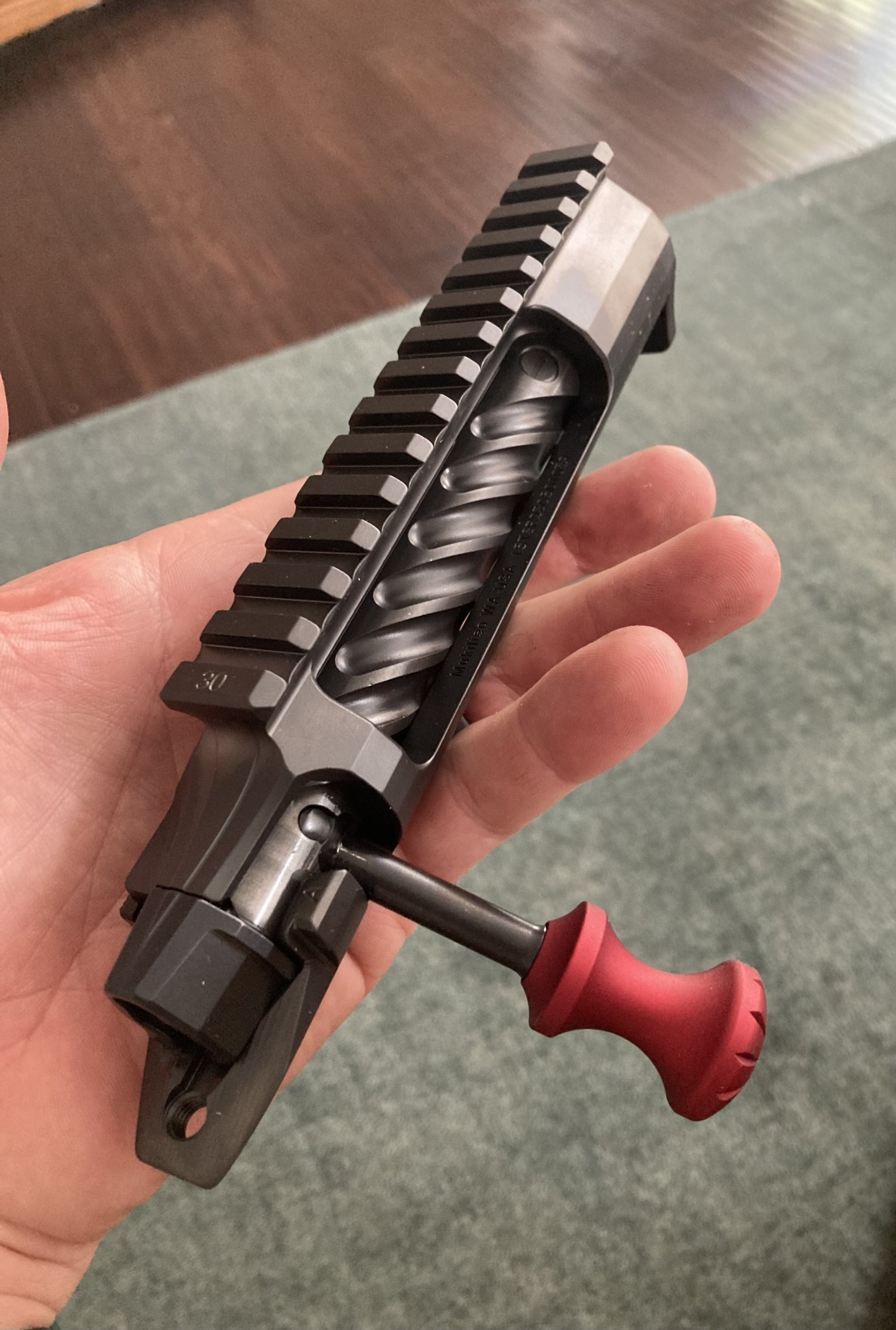

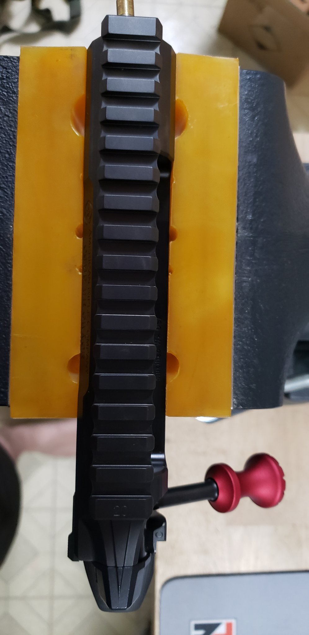

Hard to tell in that picture because the left side is in the shadow, but is Mike now cutting the needed relief for the ejector on side of the bore guide? I played with the brightness and contrast of your picture and it looks like it may have a flat cut on the left side, but it's still hard to tell.
Yes Mike Lucas milled a flat side for the CDG bore guide.

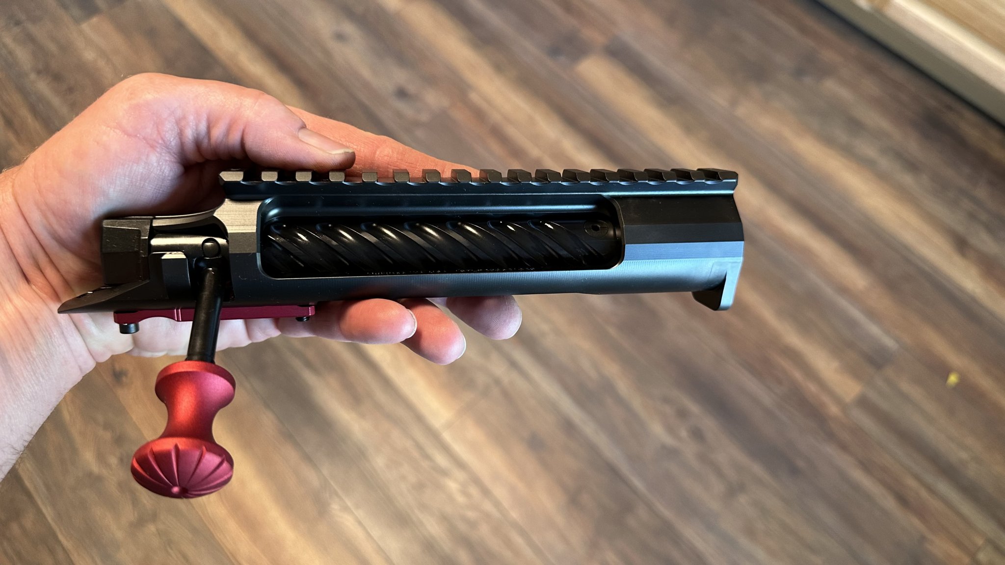

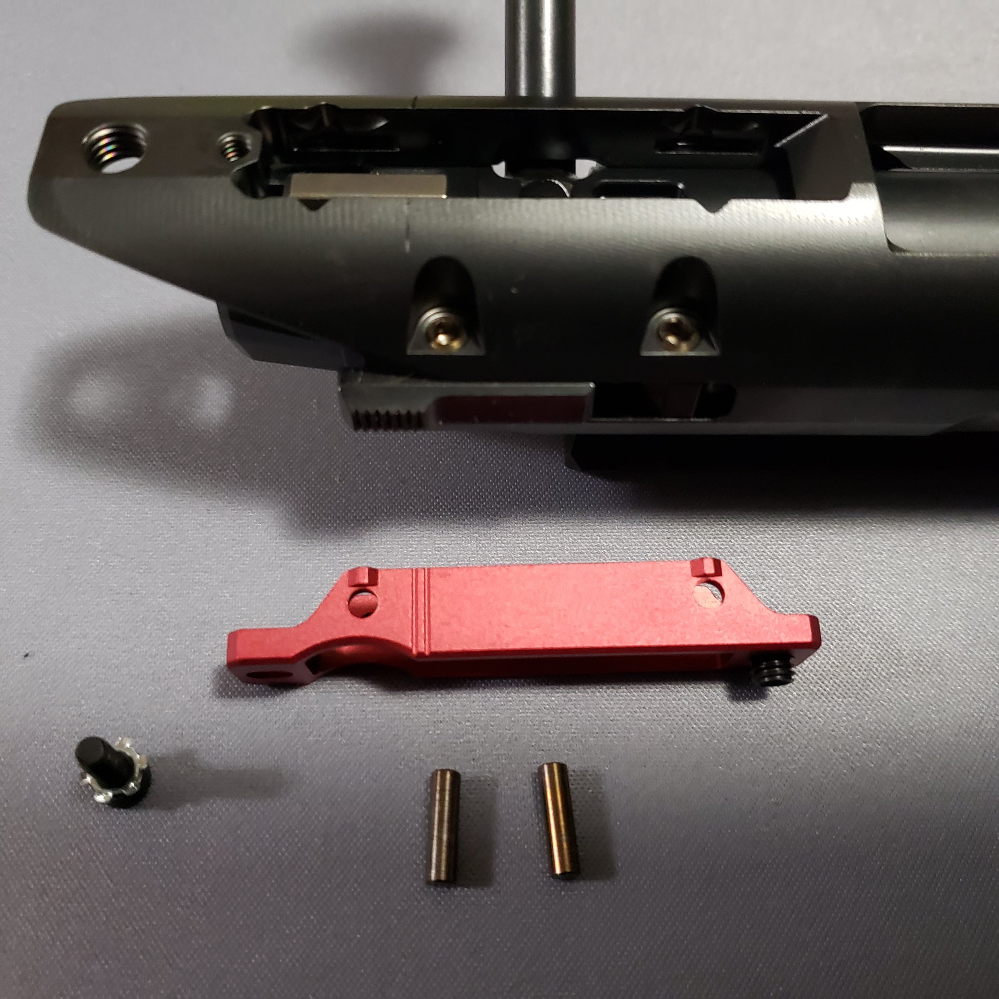

I see they modified the trigger hanger to add clearance for the Bix-'N Andy safety and it appears they added clearance for the safety knob at the top too. Nice! Two less things to worry about.
The short action with black hardware I just got one PBB is the original version; wonder when minor revisions will flow back to the short actions, if at all? Hanger is replaceable obviously.
Consider that those at PBB were likely part of the first runs. I guess that we need someone who ordered later to report on whether or not the revisions have been incorporated in theirs.

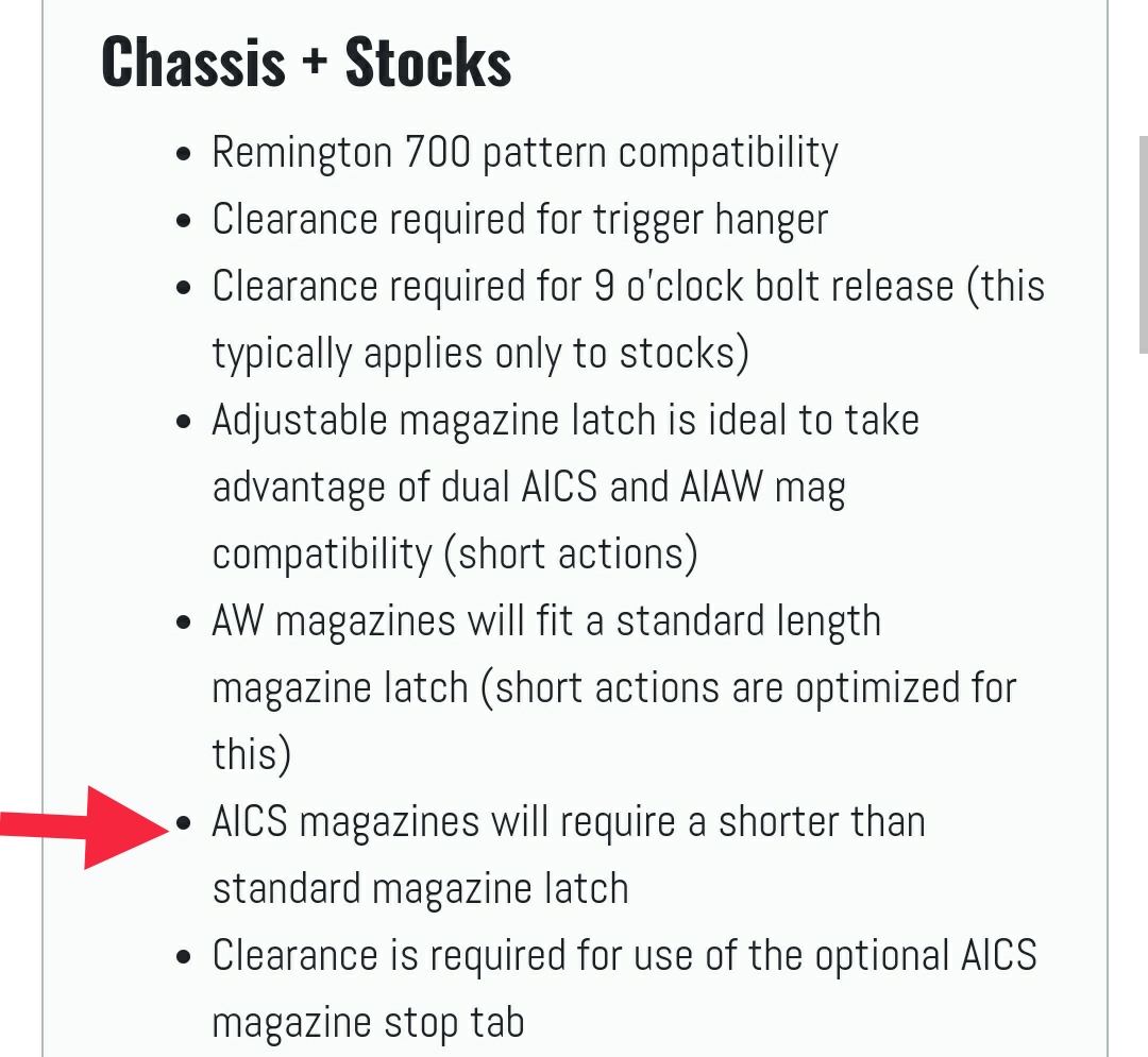

It was said by Ted early on that you'll probably have to do latch mods for AICS single stack mags, as the larger diameter bolt will probably hit the feed lips and keep the mag from latching with a stock height mag latch. An AW mag has wider feed lips and won't hit the bolt.
Direct from ARC's website, ever since the page went live back around February:
That being said, I had to shorten my mag latch in my manners TCS by about 0.025" for AW mags to seat fully against the mag stops in the action, but now that the mag latch is modified all 6 of my AW mags fit great.

Yep, part of the reason for the larger diameter bolt.
