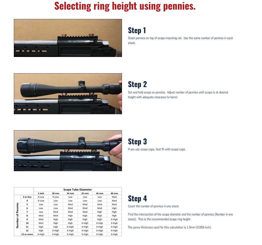

Has anyone mounted up a mk5 5-25 with arc rings yet? If so what height seems to work best?
between 1.0 and 1.6 but that's entirely up to you, your face, your stock/chassis etc
This ^^. I have a Mk 5 5-25 on one gun with ARC rings with 1.10" (medium per ARC) rings and it works as I need a high comb due to the configuration of my face and there is only so much comb riser in my chassis.
I have a ZCO in ARC rings that I just changed to their .126" (high per ARC) and its working...barely as I'm pretty max'd on comb height..... and they give me a bit more clearance under the scope for...well, various things...levels, mirage band, etc. I'm prob going to change out rings on the Mk 5 also.
Use the ARC penny method....it works.

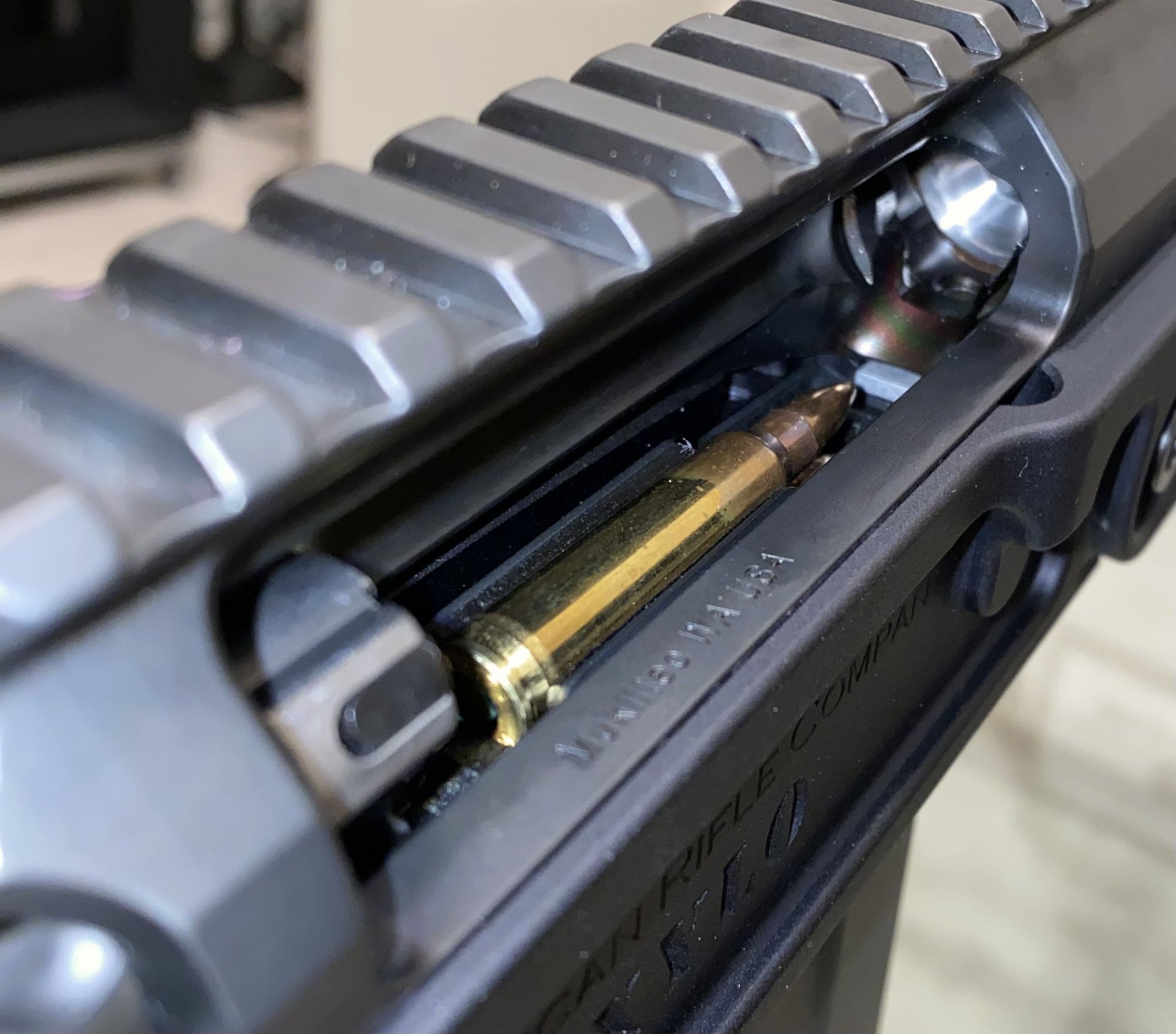

Today I received my CDG with a LRI 24" M24 barrel chambered in .223 Wylde. I'm using a Xylo chassis and Accurate-Mag 10 round 223 AICS magazines.
The standard M12 magazine latch on the Xlyo chassis is too long for the AICS mags. I had to file off about 0.007" to make the latch work with an Accurate-Mag 10 round 223 AICS magazine.
Removing the latch and installing it is easy with an appropriate sized punch. The latch has an inner bushing that holds the spring in place. That's nice, as I thought that I'd have to make a slave pin to reinstall the latch. The latch pin is also chamfered so it's easy to reinstall.

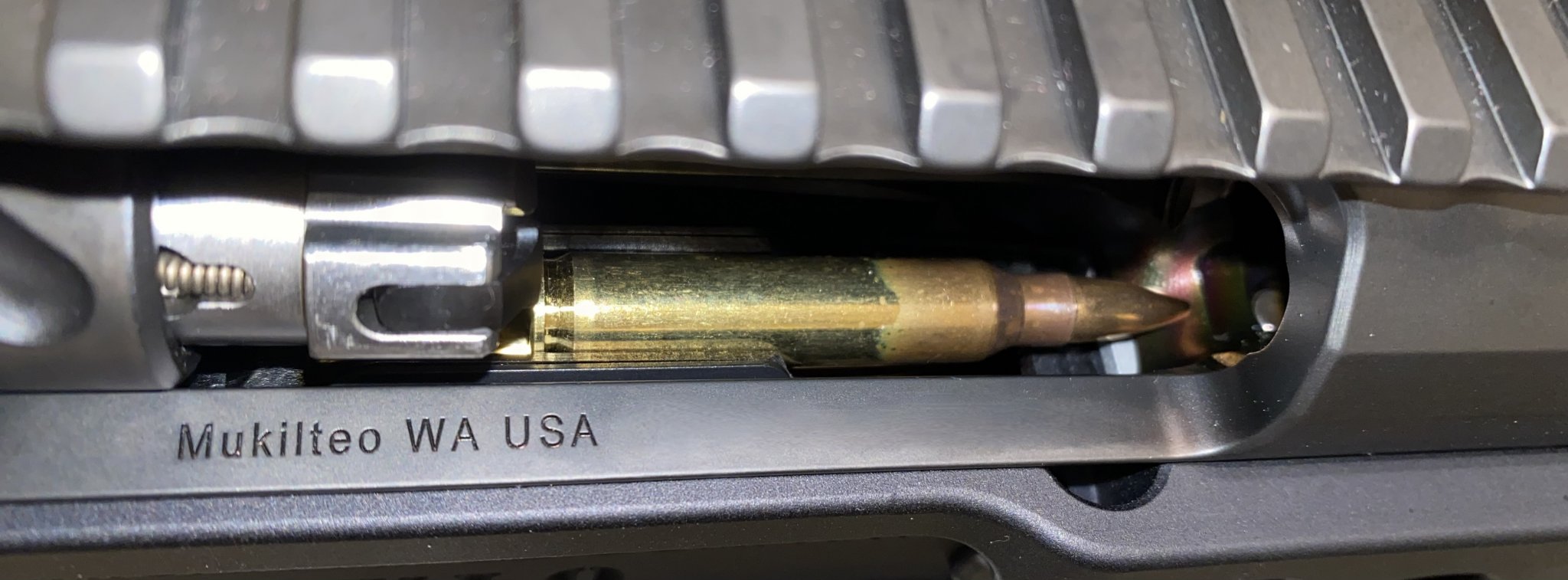

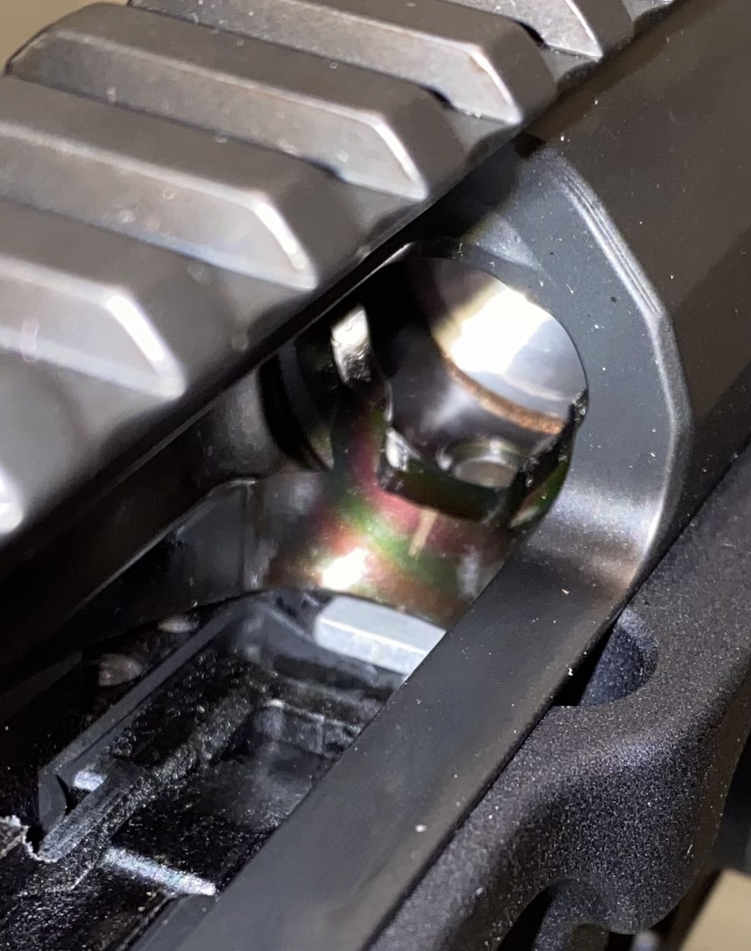

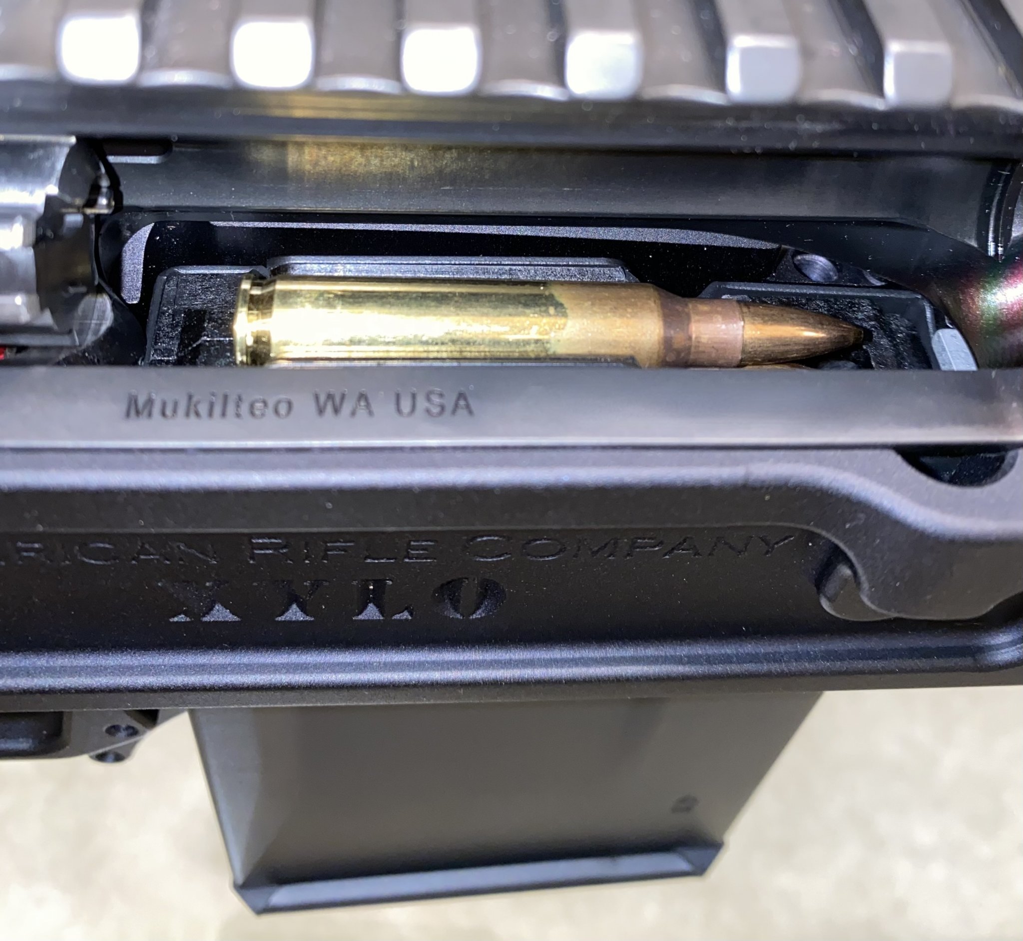

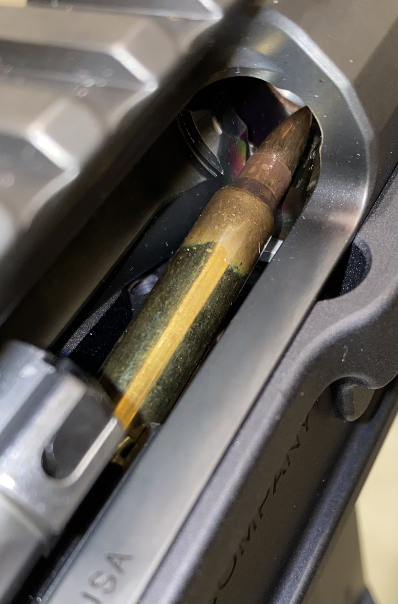

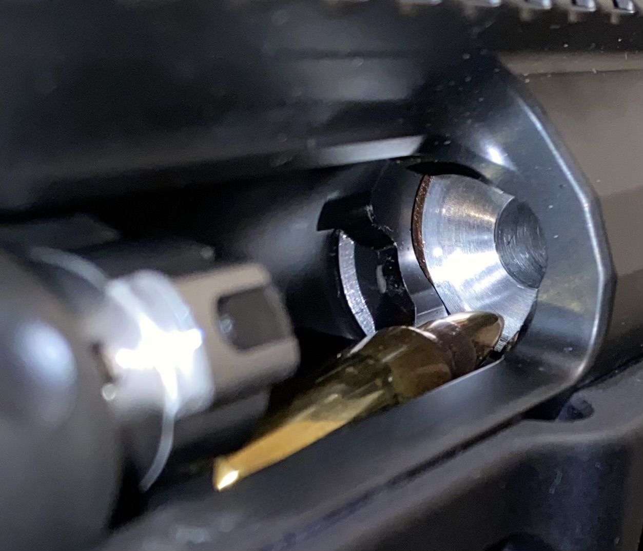

With the Accurate-Mag .223 AICS mag working, I chambered a few rounds. There where no feeding issues. The rounds moved smoothly from the magazine and were presented to the face without any issues. No issues with extraction.
I did not notice any deformation of the hollow point tip of the bullets. Nor did I see a lot of marks on the conical barrel face.
However I did notice that the tip of the bullets left a single straight mark on the what I would refer to as a ramp that is located in front of the magazine well and above the aluminum tab stop for AICS mags. I know that it has been said that the CDG does not have a feed ramp. But this does seem to work as ramp for .223 Rem.
It appears that you can also single feed .223 Rem ammo just by laying it on top of the empty AICS magazine.

All the machining on the CDG looks good. The 0.378" and 0.473" bolt faces look good, feel smooth and polished.

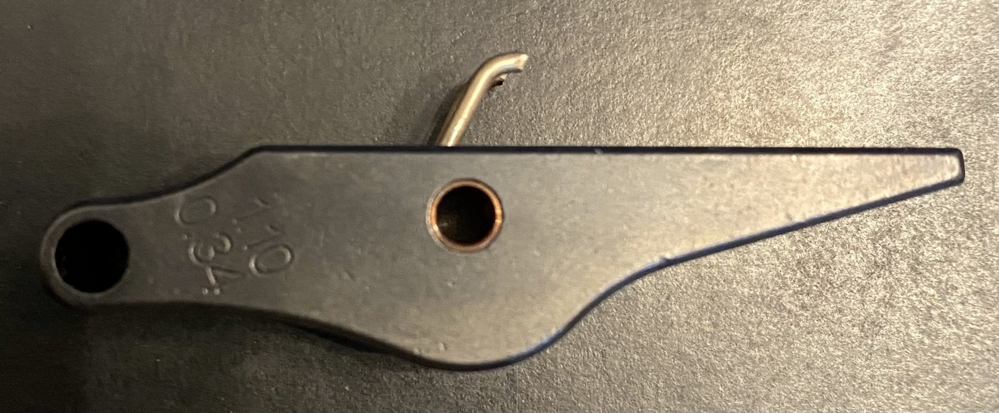

Setting the timing on a Trigger Tech Special trigger was not difficult. But I may need to fine tune it since the firing pin will sometimes drop when I'm opening/closing the action very, very slowly.

Looks good with regular 223, thanks for the good pics.
Hopefully 223AI doesn't hang up when the steeper shoulder contacts the bottom edge of the chamber; waiting to hear back from kadams1563 when he gets his 223AI barrel. That's what I'm fighting on my AI AXSA in 223AI which also has no real feed ramps and a conical breech. It ran perfect when fireforming but now the formed ackley brass is catching the end of the chamber at the shoulder/neck junction because of the steeper shoulder angle.
The easy solution is stick with regular 223, but I have a thing for 223AI, lol

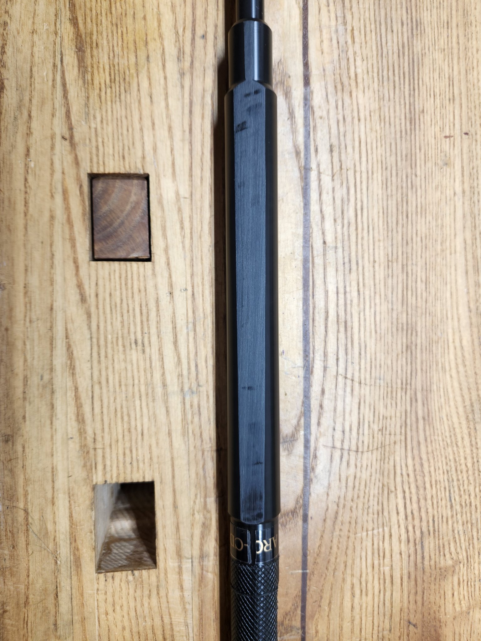

If you are going to purchase a bore guide for your CDG from Mike Lucas, it might be a good idea to remind him that the CDG requires a groove down the left side to clear the mechanical extractor. I don't think other actions require this groove so this is a new requirement in his process.
The Lucas bore guides are very nicely done.

Ohh no, I ordered a guide from Mike, it recently came in. No groove cut in mine. Didn't know it won't not work, both my CDG's are sitting in gunsmith jail.
You can return it to Mike to have a groove added, or you can cut a flat spot on the left side (see picture above) so that it clears the ejector. I did mine with a hand plane but it can be done with a belt sander too. Or if you have a milling machine....

Interesting, my Archimedes (and previously nucleus) didn't need a relief on the bore guide for the mechanical ejector, obviously the CDG is different.
I'll have to modify the bore guide I received from Lucas about 6 weeks ago.

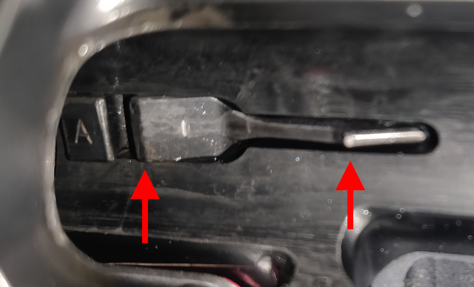

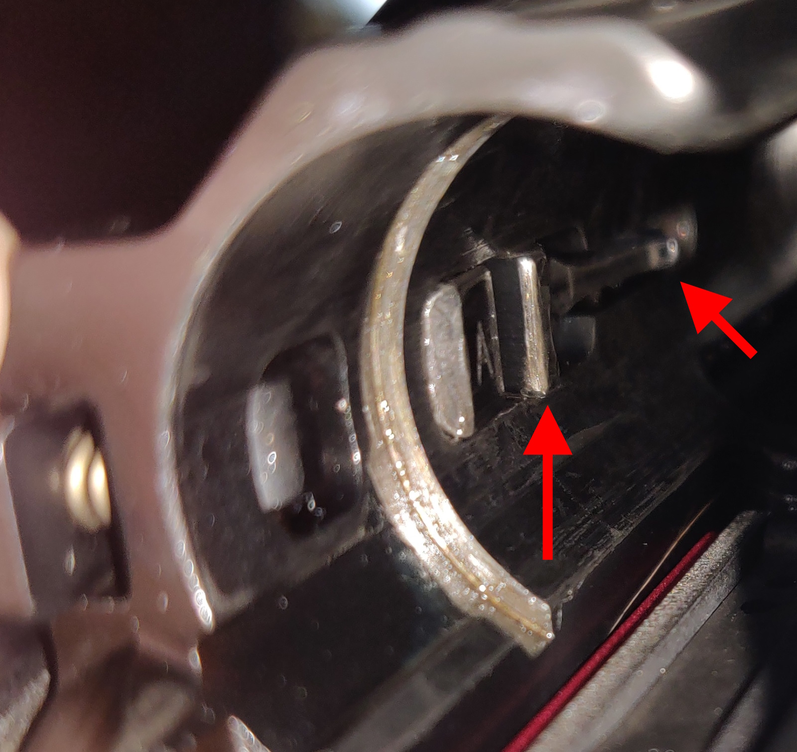

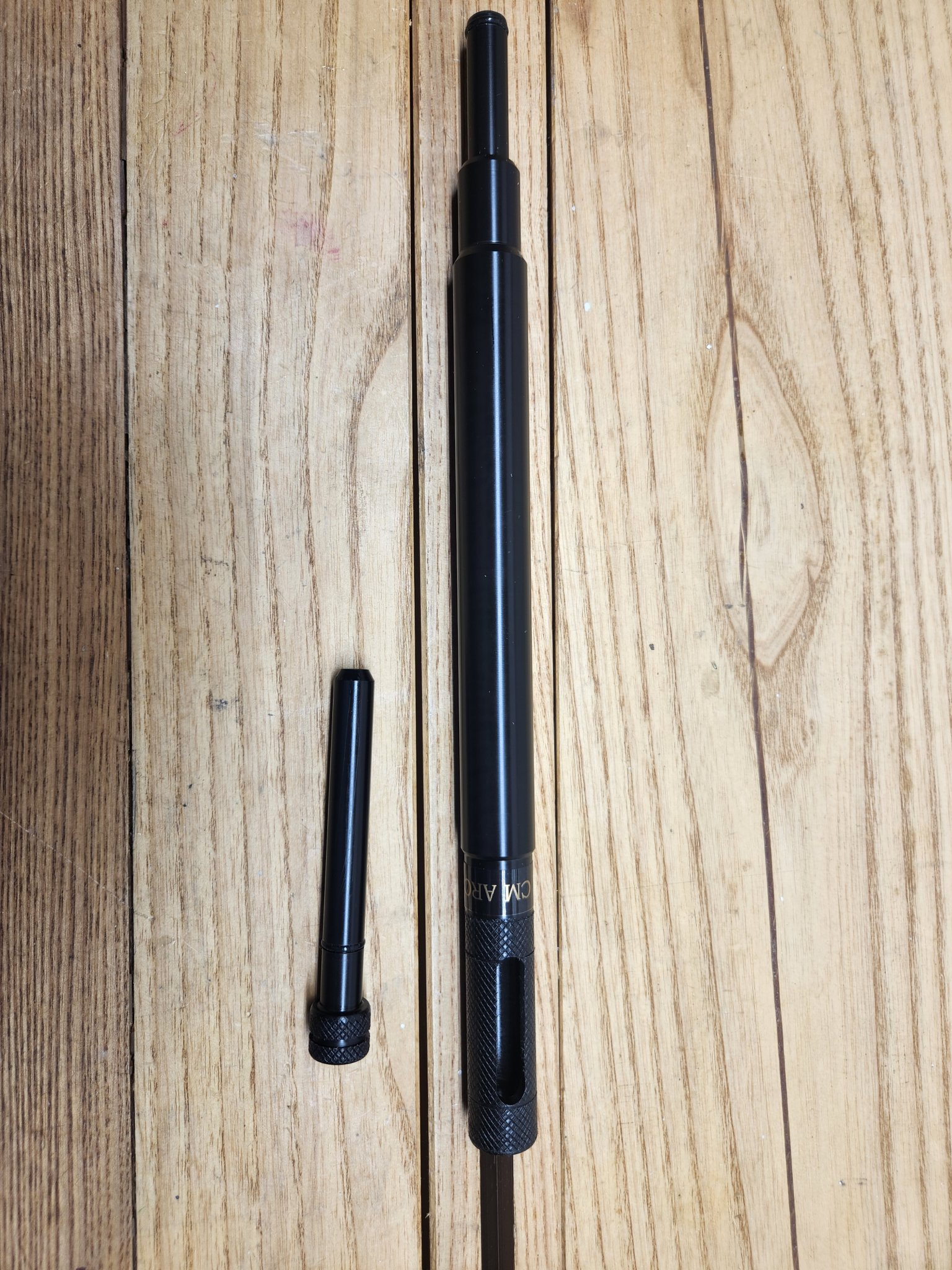

I'm looking at it right now. It's the ejector. Unlike the nucleus and Archimedes where the ejector can swing totally out of the bolt bore in the action so a full diameter bore guide will fit, on the CDG part of the ejector is always protruding into the bolt bore in the action regardless of the ejector position so the bore guide will need a relief cut. Looks like removing about 0.050" from the side of the bore guide will do it (like in AllenOne1's pictures above.)
Pics of ejector showing bore guide clearance issue... no matter the position of the ejector, some portion of it always protrudes into the ID of the action. The ejector position in the pics is about at the point where the front and rear of the ejector are both protruding into the ID of the action by the same amount.
Sorry the pics are a little blurry, with one hand holding the bolt stop open and the other hand holding the phone to take the picture I couldn't swipe on the manual focus adjustment on the screen to focus the ejector area, but you get the idea. Red arrows show the portions of the ejector that protrude into the receiver ID.

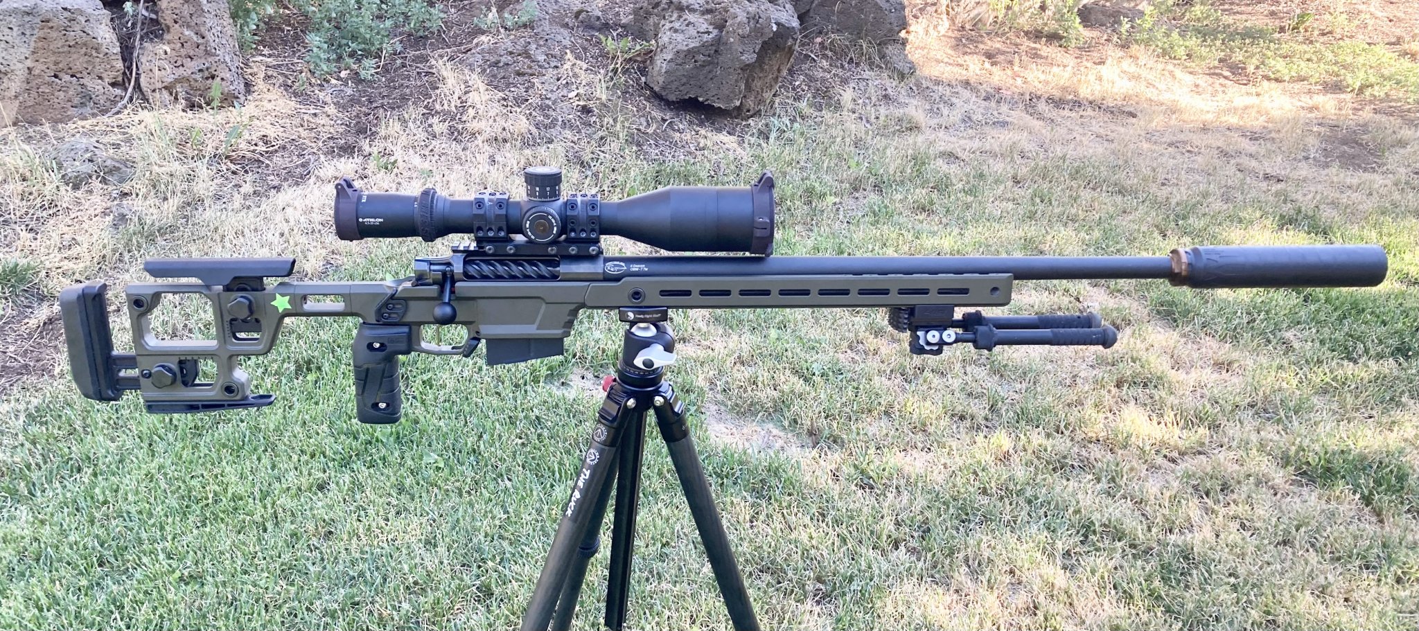

Since I had it out of the safe to look at the ejector and bore guide issue, here's the pics you asked for of my CDG in a TCS. The TCS is in gloss metallic GAP camo that I picked up off the PX a couple months ago, barrel is a marksman contour 28" 22GT (kind of wished I went heavy palma or MTU since this is no longer even trying to pretend to be a somewhat light rifle, but the marksman will still work great.) No scope or mount on it yet since I'm trying to decide if I want to sell the S&B 3-20 that I originally bought for this when I was trying to keep it a lighter build.

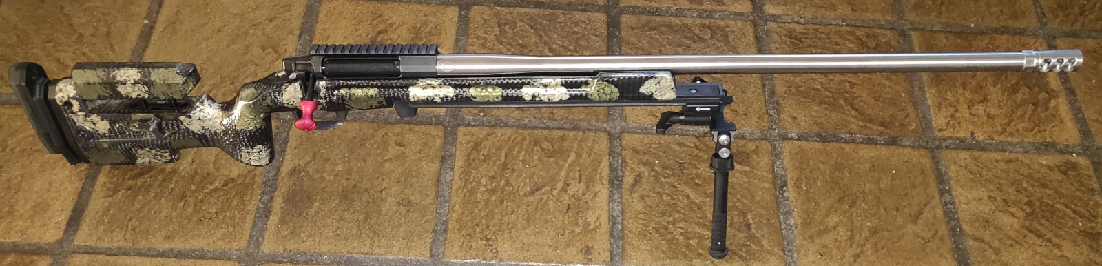

Looks amazing, looking forward to hearing how it shoots. I won’t have mine together until September sometime.

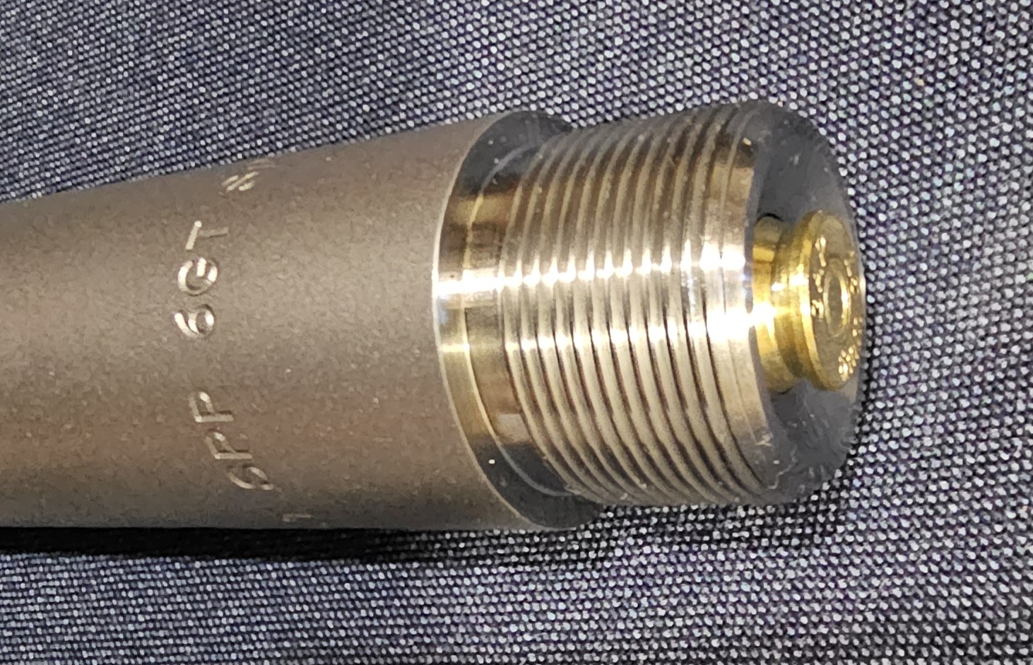

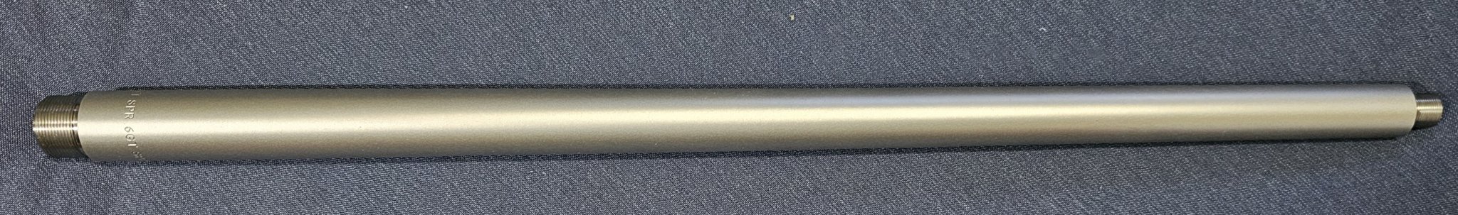

just some spr goodness
Did you send your action to SPR or order it as a pre-fit?
I have a barrel on order from SPR as a pre-fit and their disclaimer that if the drawing didn't fit the action any fix will cost me gave me pause. It would be confidence inspiring if I knew they were turning out good barrels off the drawing alone and without having the action to fit the barrels.

i sent my action direct to spr from arc, was also the first to order a barrel for cdg from them

Pretty happy with the quality for the money. Got the PVA deal on a 6 dasher barrel, TriggerTech special and the Solus chassis, took a little filing and had to trim the comb to be able to remove the bolt, haven’t shot it yet but it feeds and feels great.
