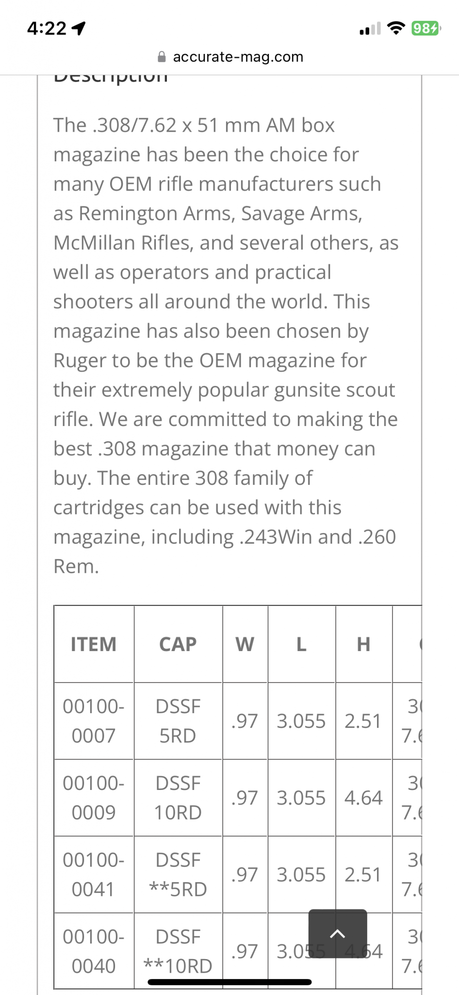

I believe Accurate Mag makes a 5 round AW. Five round AICS exist.
The Accurate Mag 5-round mag is a dssf mag, but not a true AW magazine.
