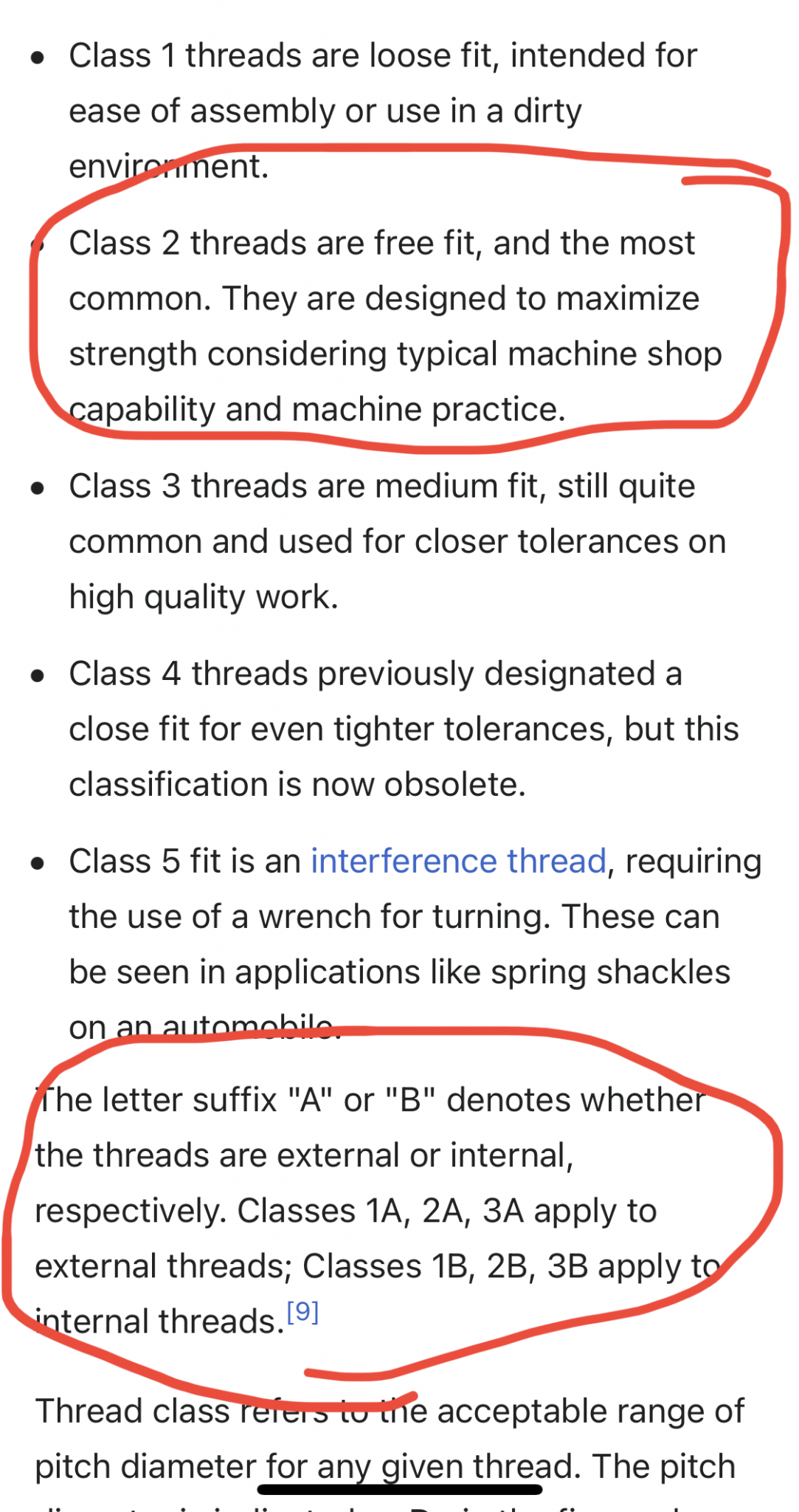

Anyone know if other 5/16x24 thread bolt knobs will fit the coup? I have one from anarchy outdoors I had on hand and it's for 5/16x24 but I'm not sure if the 2A thing on the thread description on the ARC page makes a huge difference
  • Fits standard 5/16-24 UNF 2A bolt knob thread
    When referring to the bolt knobs on their site
Unified Thread Standard. Class 2 means that it it is the most common 5/16-24 thread, “A” denotes external. So almost anything should fit. See basic info below.

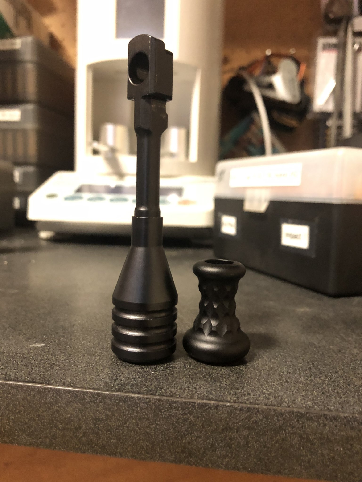

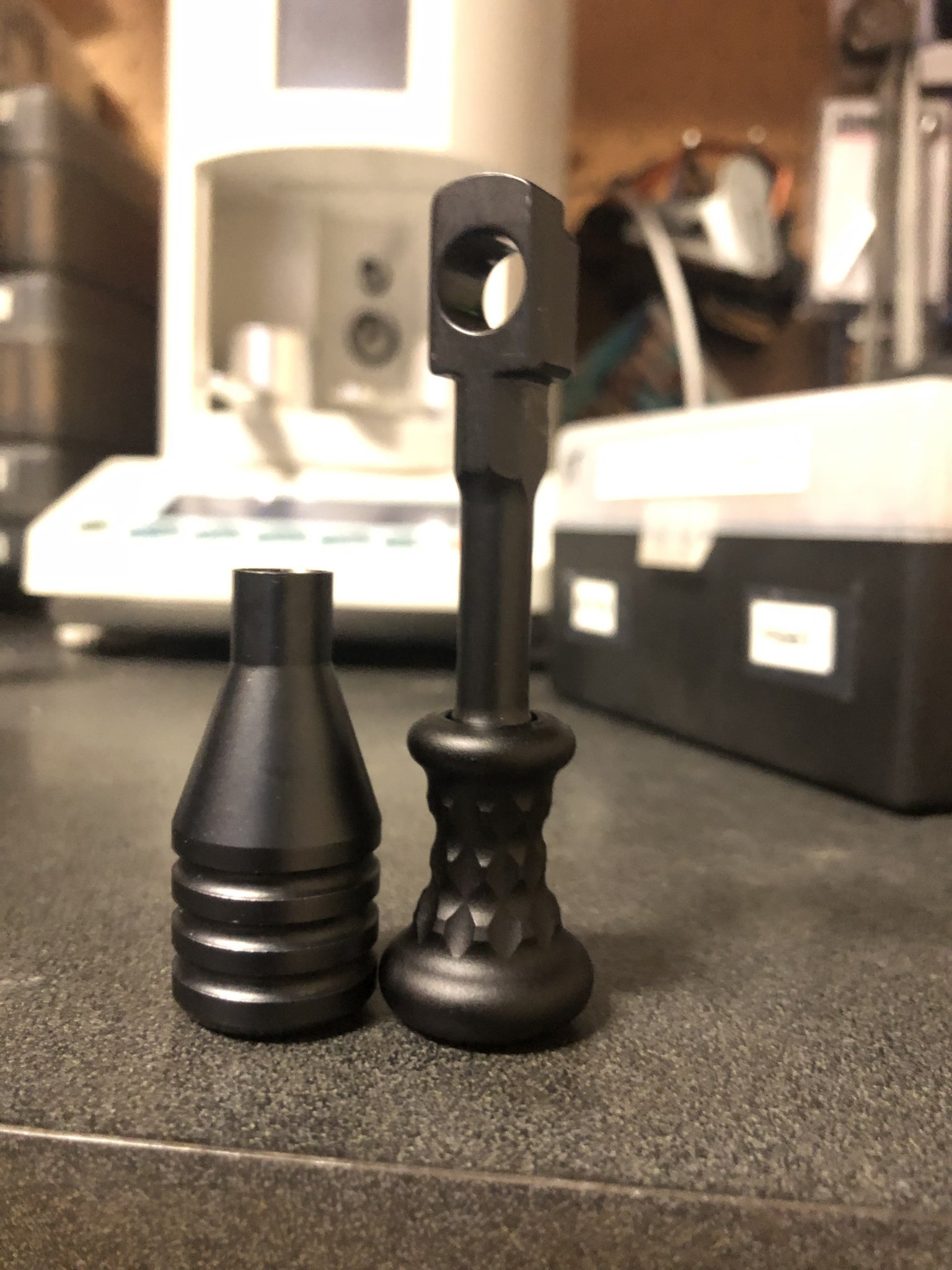

An Impact spun on, but added a little over a 1/2” to overall length.
Interesting that the CDG, Defiance and Remington bolt knobs from Area 419 are 5/16"-24. While the ARC Mausingfield and Nucleus knobs are 10-32.
Changing to a more standardized size on the CDG?
Yes. The CDG is the culmination of features Ted’s been historically resistant towards: tool-less bayonet shroud, AW mag cut, standard thread pitch bolt handle/knob, etc

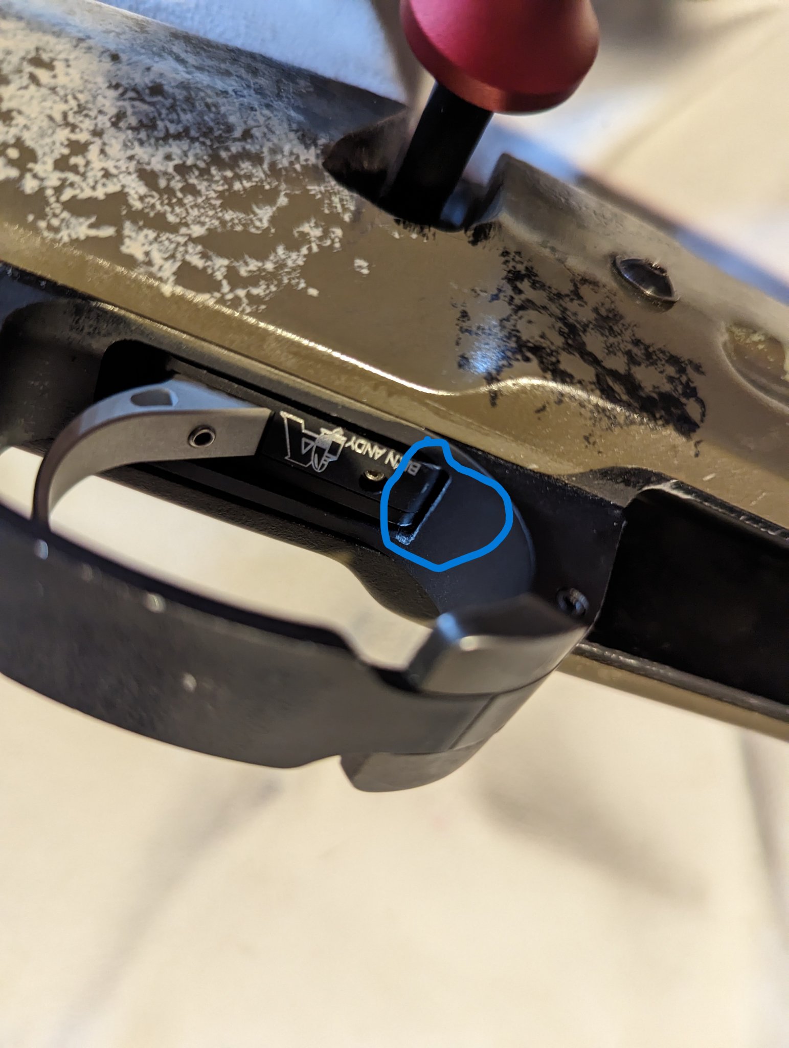

Follow up on trigger setting. I decided to try a bix N andy trigger that I got at a good price.
Managed to set it at 3oz pivoting handle, no issues with slamming the bolt hard, maybe I'm lucky or that trigger just works.
I did have to file the trigger inlet in the manners a bit to make it fit. Happy so far! just need a barrel now.
The cocking piece only moves .001 inch on closing, verified with an indicator.
Someone here asked me to show the areas I removed material for a trigger fitting, so here they are.
Here are the photos, I marked the area were I removed some material. This is a mini chassis, so other versions may vary.
Hope this helps. will need to clean it up to make it look better , but for now this is what it look like.

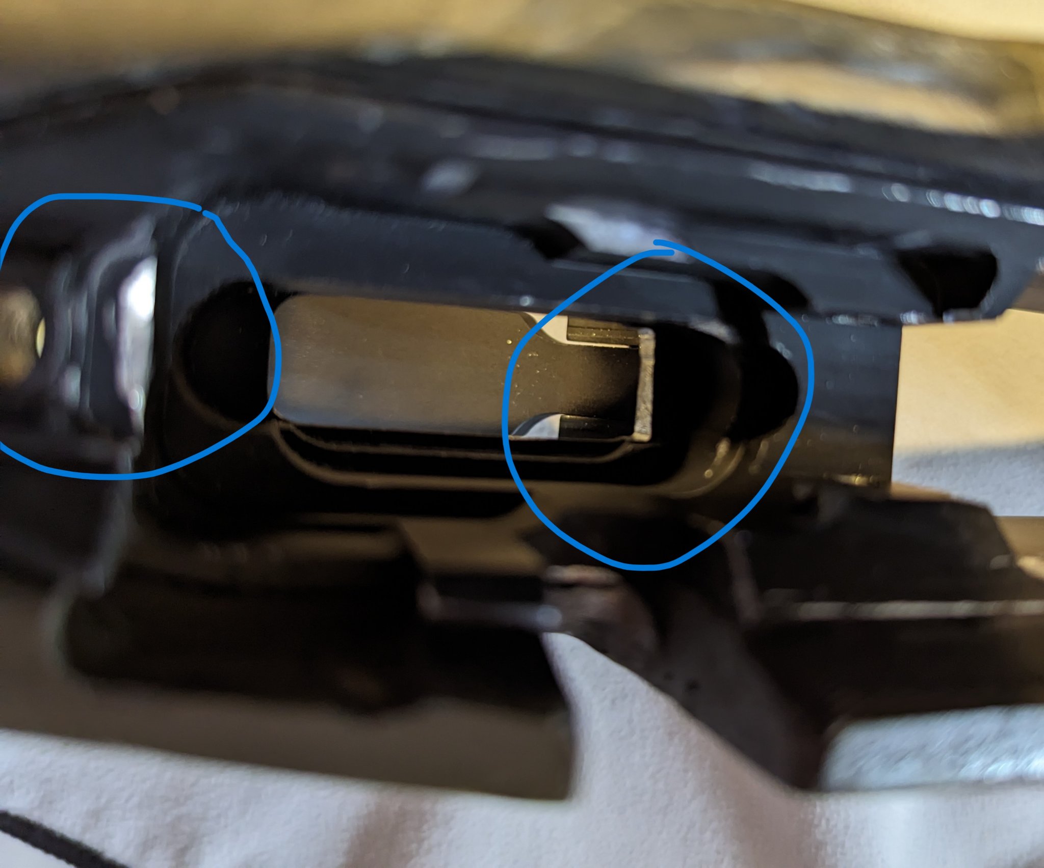

Picked up my CDG on the way home from work yesterday and assembled it last night.
First impressions: Very nice machine work. Neat how the action and bolt shroud blend together. Giant ejection port makes it easy to load AW mags through the ejection port if you don't want to drop the mag. Completely toolless takedown is cool, but you have to be careful when compressing the firing pin spring not to launch anything or push sideways and tweak the firing pin tip on the bolt cross pin. Bolt lift out of the box is good, but isn't quite as smooth as my Archimedes-- but my Archimedes has about 4500 rounds on it plus dryfires so it's nice and worn in. Adding a bit of moly grease to the cocking ramps on the CDG really smoothed it out and it should get smoother after some use.
Bolt handle on the CDG is much more difficult to pivot than my Archimedes since the CDG uses a dedicated heavy pivot spring while the Archimedes bolt handle piggybacks off the firing pin spring. The stiffer bolt pivoting on the CDG is a good thing IMO as the CDG bolt handle is very unlikely to pivot unless you have a stuck case and really have to yank on the bolt, whereas with the Archimedes if you run the bolt fast and hard up you can sometimes feel the bolt handle give a bit, especially when you hit the bolt stop. The CDG handle with the stiffer pivot spring makes the bolt handle feel more "solid" when running the bolt fast.
Had to clearance the trigger hanger a bit for a Bix'n Andy tacsport 2 stage safety lever, not a big deal; I've had to do that for Bix's and other triggers in other trigger hangers. Also had to sand off the front of the oversized Bix safety lever knob so the safety would fully disengage (again, not a big deal, have had to do that before.) Unlike the Archimedes which absolutely needed a low sear (all 3 of my Archimedes measure 0.154" pin to cocking piece height, and that's right at the bottom of the acceptable range even for the low sear on the Bix chart) the CDG had a 0.177 pin to cocking piece height which means it can use any of the Bix sears, but the medium (default) sear is the one right in the middle of the acceptable engagement window according to the chart, so I used the medium sear. Much like my Archimedes I set the Bix in the CDG up for 9oz first stage and 1lb 6oz break (13 oz break, the first stage on a Bix is just rotation of the trigger shoe before it contacts the lower sear lever) and had no issues with the firing pin following the bolt. Trigger timing is super easy with the CDG trigger hanger.
Dimensionally, the action, PVA barrel, and new Alpha 22GT brass were all very close; based on depth mic and gauge block measurements it looks like the brand new brass will only have to grow 0.003"-0.0035" on the first firing, so no excessive case stretch. Just for the sake of more data, the receiver face to bolt face dimension between 3 Archimedes (with 5 bolt heads between them) and the CDG all fall within a 0.0013" total window, the measurements ranged from 0.8242" to 0.8255"; ARC seems to have no problems holding the stated 0.825" +/- 0.001" action face to bolt face dimension. No issues with the tip of the extractor contacting the conical breech even dropping a case in the chamber and then closing the bolt to make the extractor snap over the case rim (extractor to breech contact was an issue someone else had on a build earlier in this thread, so I figured I should check.)
Before I spun the 22GT barrel on, I decided to bolt the CDG into a stock and play with some 223 and Accurate mags using the flat breeched .223AI barrel from my Archimedes. The small diameter 223 rounds slip through the 6 o'clock lug cutout and get presented very low on the breech face, so the conical breech is a must with the CDG and the small diameter .223 cartridge. Has anyone got a .223 CDG up and running yet? I'd love to hear how the feeding is. My current .223AI Archimedes build runs perfect and feeds excellent, and I still have another unbuilt short action Archimedes in the safe I was planning to use for a lightweight 223AI build since the Archimedes has a smaller diameter bolt and a full feed ramp optimized for single stack mags like the 223 mags. However, if the CDG feeds .223 smoothly and reliably I may consider selling the unbuilt Archimedes and picking up another CDG, because down the road if I ever decide to switch to a .308 family case I can run AW mags in the CDG, but I'm limited to single stack mags only with the Archimedes.
The CDG fit into a mini-chassis in a Manners TCS with no mods needed for the trigger hanger, but I did have to shorten the magazine latch about 0.025" for AW mags to latch in place. They sit all the way up against the magazine stops in the CDG. I need to call Manners and order a replacement magazine latch to keep in inventory.
Now I have to load some initial test/break in loads, and also need to rob a scope from another rifle for now. I bought an S&B 3-20 (non-ultrashort) for the CDG initially since I was planning on keeping it around 10-10.5# with a light barrel and HNT26 stock for varmint use; the S&B 3-20 non-US is super clear with a huge FOV, forgiving depth of field, and only about 32oz... a very nice crossover scope. However, I ended up changing to a much heavier barrel profile and dropped the CDG in a Manners TCS with a steel arca rail, so weight savings is no longer a concern (lol!) and now I want something with more top end mag than the 3-20. Have a Razor Gen 3 on order to try that will go on the CDG, but it's probably 3 months out. For now I'll probably rob an S&B 5-25 off one of my AIs to put on the CDG for testing and load development.
I'd love to get some test rounds loaded up this week and go test this weekend, but it's supposed to be 108-110F both days this weekend... the pool sounds more inviting than the range, and unfortunately I think the neighbors wouldn't like me shooting from the pool.
Looking forward to using it as soon as the weather cools off a bit.

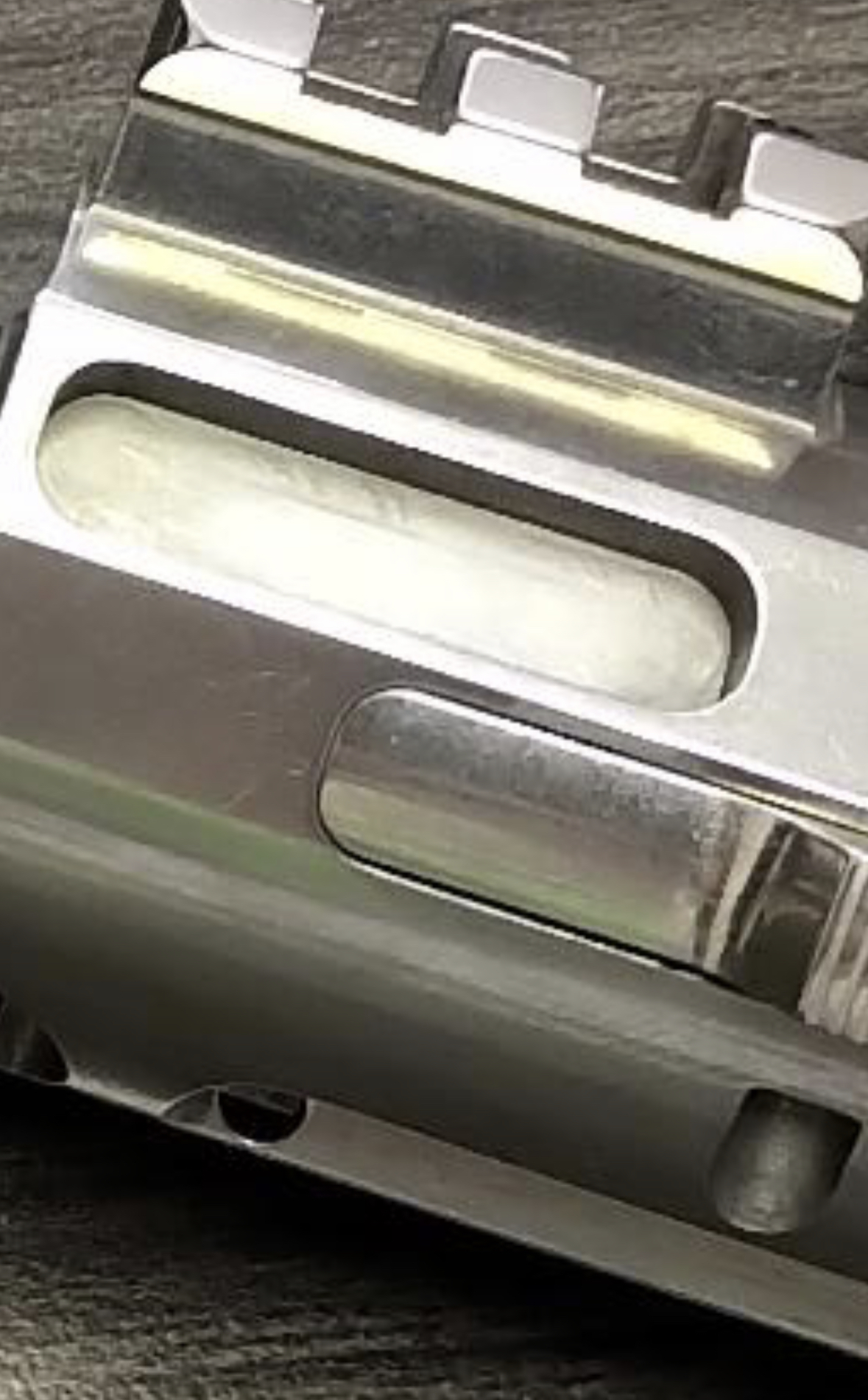

It is on them to hand sort out the best machine runs that would be set aside for polishing. I wonder if they hand polish or if it's machine polishing. Either way the pockets would suck.
It's amazing how bad the finish machining finish Is on almost anything not nitrate or coated once you strip them.
