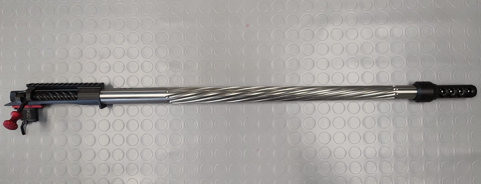

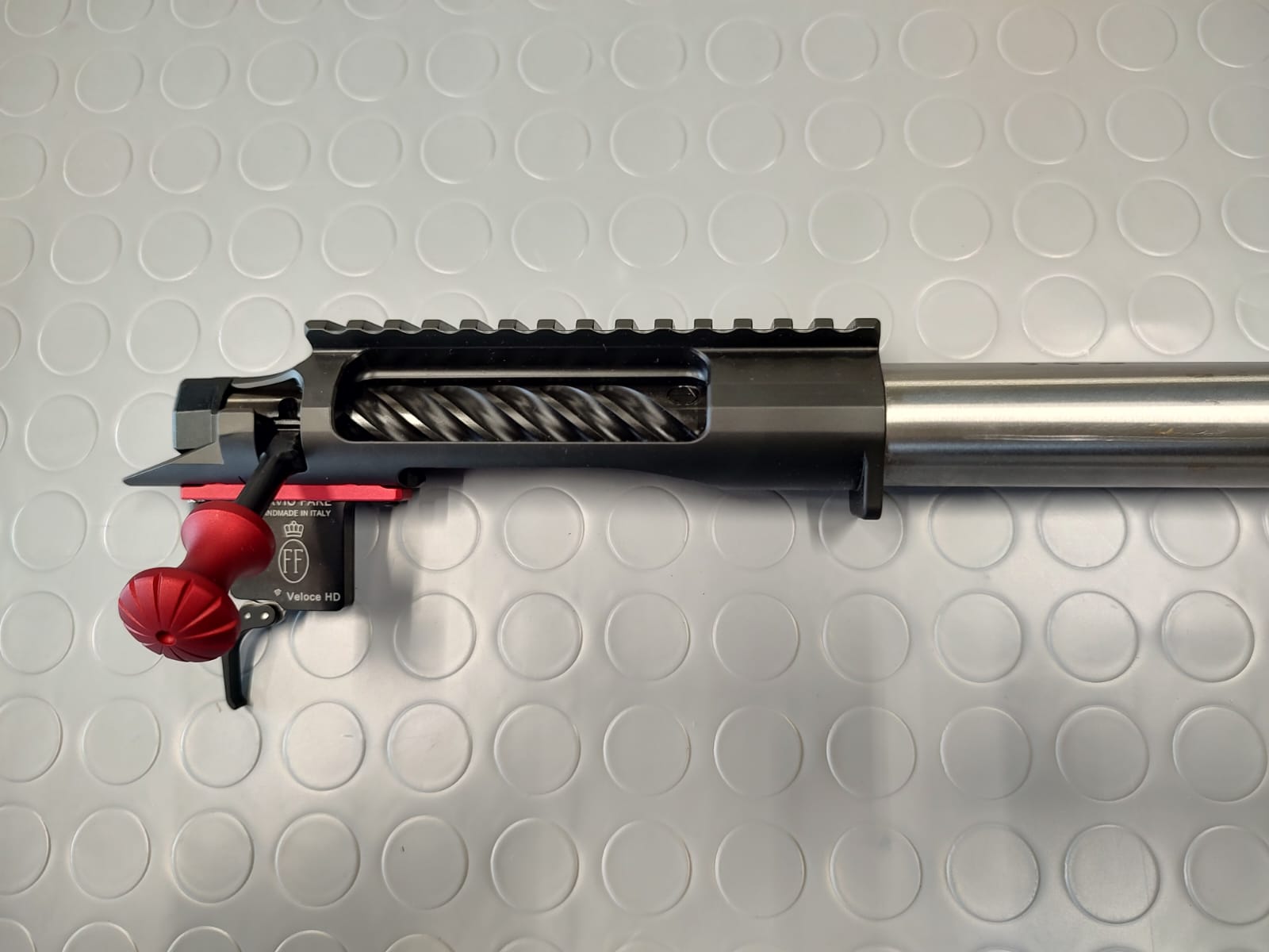

Almost ready... last step is final testing and branding at the Natl Proof House.
The trigger is local to me, made by my gunsmith, Flavio Farè "Veloce" trigger in its competition config (no BR no safety) single stage set at 8 oz. Bruno SS sells them in the US, for the record. Fits like a glove and works flawlessly. IBI MTU+1 or 'Viking' contour, chambered in 6 Dasher, Alpha legacy reamer .154 fb. TMB brake. Super pumped about this build.
Idk I was so excited to get it all together with the new barrel I never tried it. Another member here is using a savage style with 6.5CM though and he said it was feeding fine.

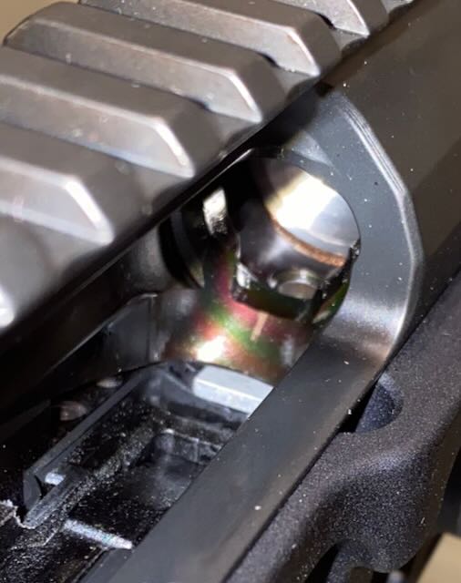

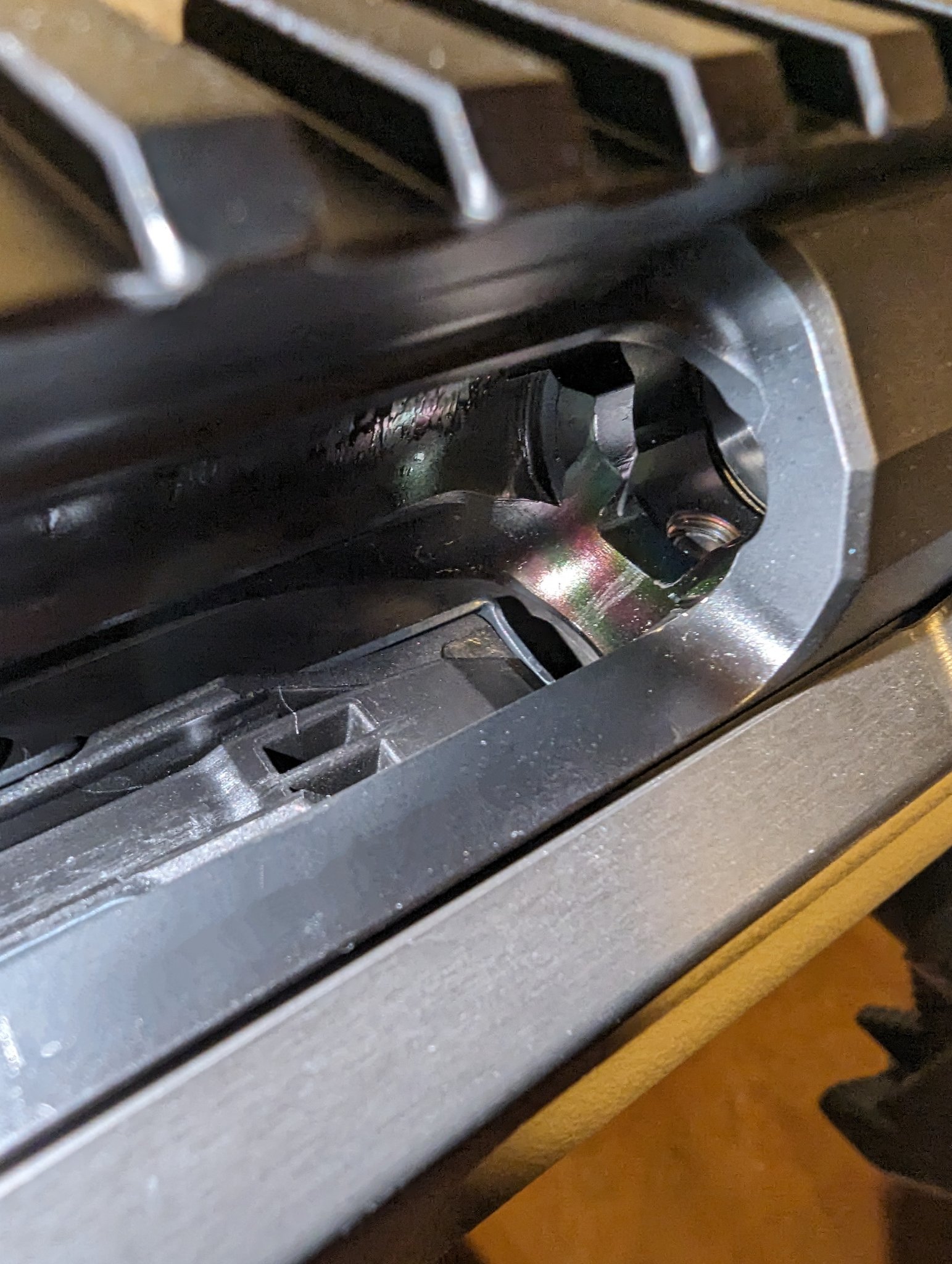

It's a Lite Competition chassis, 700 LA with 3.850 mag well. The luxurious brown color is Stealth Shadow Vortex, looks even better in person than it does in most pics on the web.
It does not fold and capture the bolt handle as is, perhaps a different knob and or sweeping the handle a bit (maybe both) would allow it to though.

Hi Sentinel!
Thanks for the info! Would you mind providing a photo of where the interference is located with the folding stock and the knob/handle? I'm working with Jamie from Cadex to try to get my order sorted out and he's very interested in any potential issues that may prevent the CDG from being used with their chassis (since they don't have any to try themselves. Yet.).

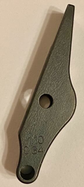

When using a CDG with AICS magazines in a recent Xlylo chassis you will need to shorten the length of the standard length magazine latch.
The Xylo standard magazine latch is stamped with 1.10, which is the distance from the center of the pivot pin to the top of the latch that impinges on the magazine.
I had to file down the length the magazine latch to allow the use of an AICS magazine in a Xylo chassis with the CDG action. In my case, I removed 0.04" from the standard magazine latch. The distance from the center of the pivot pin to the top of the latch is now 1.06".
You also need to use the aluminum tab that ARC ships with the CDG action. The aluminum tab is positioned between the action and the chassis when assembling the rifle. The tab extends into the magazine well far enough that the front of the magazine impinges on it and prevents the magazine from being inserted too deep. The tab is held in place by the forward receiver screw.
I am currently running a CDG, a barrel chambered in 223 Wylde, in a Xlyo chassis that I puchased after the CDG was released. The magazine that I am using is a Accurate Mag DSSF (AICS) magazine.
When shooting 6.5 Creedmoor, I can use the PMAG 10 7.62 AC magazines without issue with the Xlyo magazine latch that I shortened to 1.06".
Here'e the standard Xylo latch. Note the 1.10 stamped on the side.
Here's the aluminum tab positioned between the action and the chassis.
