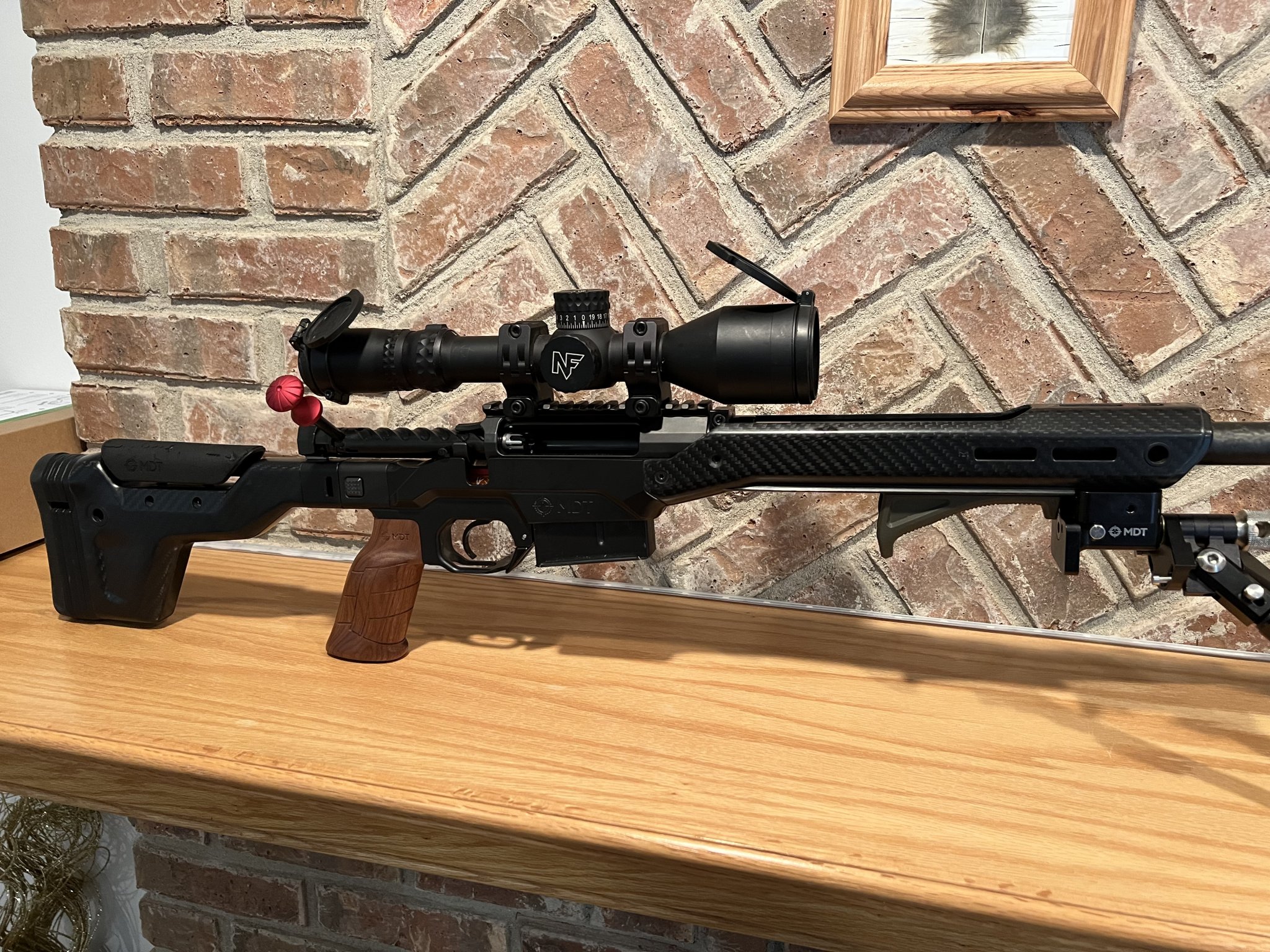

Anyone running a CDG with pivot in an HNT26?
Were there any modifications needed?
I have a LA in a HNT26 with no issues. Cycles rounds through a AICS magazine with no problems.Were there any modifications needed?
AW mags were tight to release at first. They have worn into the factory latch perfect after call it 30-40 mag changes. I recommend AW mags if your caliber will allow. They are awesome.Yes and the only one I needed was a slightly lower mag latch to work with AICS mags, I reached out to MDT and they sent me all the sizes so I could find which one worked best. I’ll have to double check but I believe it was the -2mm.
