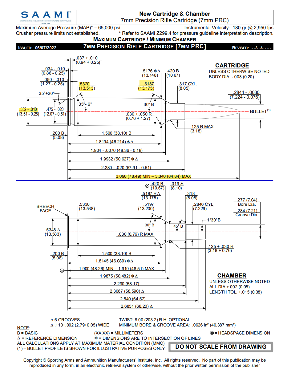

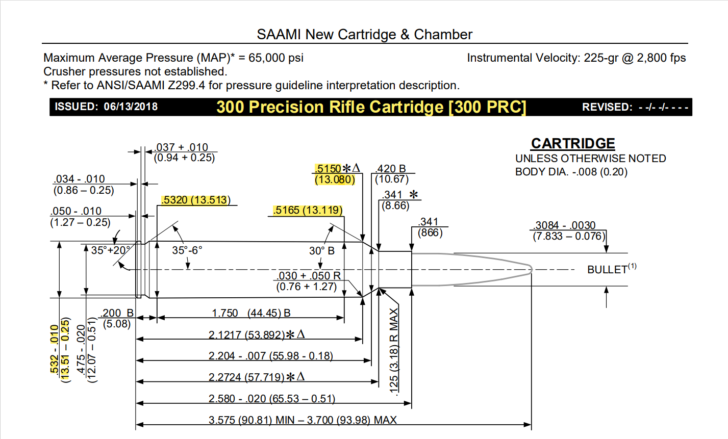

That’s what I use with no issues in my MDT chassis.My suggestion for the closest out of the box with minimal (may need to widen the front of the feed lip a tad) but probably no tuning necessary is MDT's 300 PRC CIP length AICS. https://mdttac.com/300prc-mdt-metal-aics-magazine/ You can compare the two cartridges' case body dimensions below to see why.
When you want to use an AICS mag for a different caliber (than stated by manufacturer), you will likely have to "tune" the feed lips via bending (ideally with a magazine feed lip tool) in order to accommodate the different case body dimensions and have optimal feeding. The closer you can get out of the box to match the cartridge you desire (in your case 7 PRC), the less tuning required.
Also to emphasize the previous post, your chassis or bottom metal will dictate which length mag you can use. If your desired chassis doesn't allow for a 3.850 CIP mag, then ignore the suggestion. If your desired chassis have an adjustable fore/aft mag well, then you can pretty much use them all 3 sizes. 3.340" is the 7 PRC COAL max, so any of the long action AICS mags 3.715", 3.775", or 3.850" would generally work.
If the mag is too long relative to the chassis mag well, it won't go in. If it's too short, it won't stay latched in. One caveat to going with the longest mag is that the longer you go relative to max COAL, the more at risk you get for feed issues due to follower tilt with poorly tuned feed lips (and theoretically even with properly tuned feed lips) or feed issues due to the round releasing from the lips too early.
However, I'm almost certain someone has tried the 7 PRC with a 3.850 CIP length AICS with no problems.
