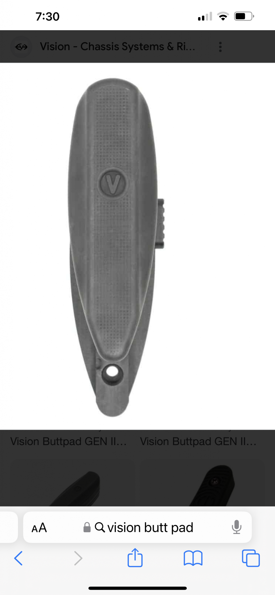

They did fix the butt pad issue? How?
The new butt pad on the vision chassis is super comfortable.The shape is perfect.I’ve replaced all three of mine with the new version.
Ok, I’ll ask you too…what did they change. I know @GBMaryland objection was them putting a hard round button in the middle of the pad for adjustment of pad (I believe this is the pivot point).
What did they change exactly, please.
Most of the pre-orders have taken longer than 5 months.
The latest shipped actions I can find in this thread are a long action ordered on 3/1 (post #5169) and a short action ordered on 2/26 (post #5231). Both were shipped right about the 6 month mark from the order date.
The long actions appear to be moving faster, I'd guess fewer of them were ordered relative to how many are being made. My guess is ARC will have caught up to their 4 month estimate on long actions in the next month or two, but they'll be working through a short action back log for awhile longer.
Still waiting on a RH LA from 2/10.....creepin up on the 7mo mark
The button in the middle is gone.The material is not as hard and the rear is shaped differently kind of tapered from the edges towards the middle.

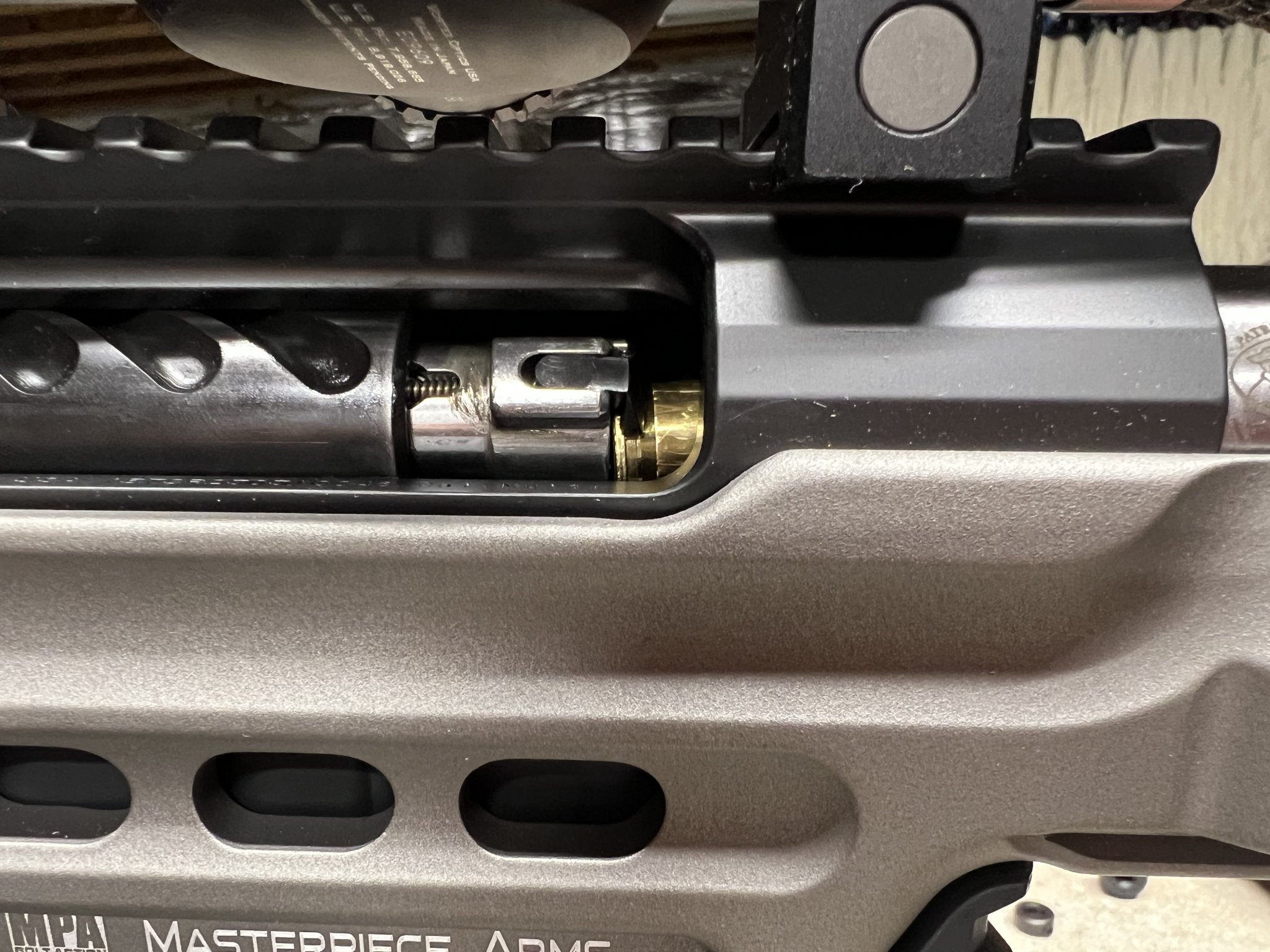

Is there a way to smooth out this part of the CDG feeding? It's where the brass is sliding up the bolt face as it's captured by the extractor. You feel it more when you're working the bolt slower.
You could remove the extractor and burnish it a bit. Feed a bunch of rounds first, and see where the brass is building up on it.

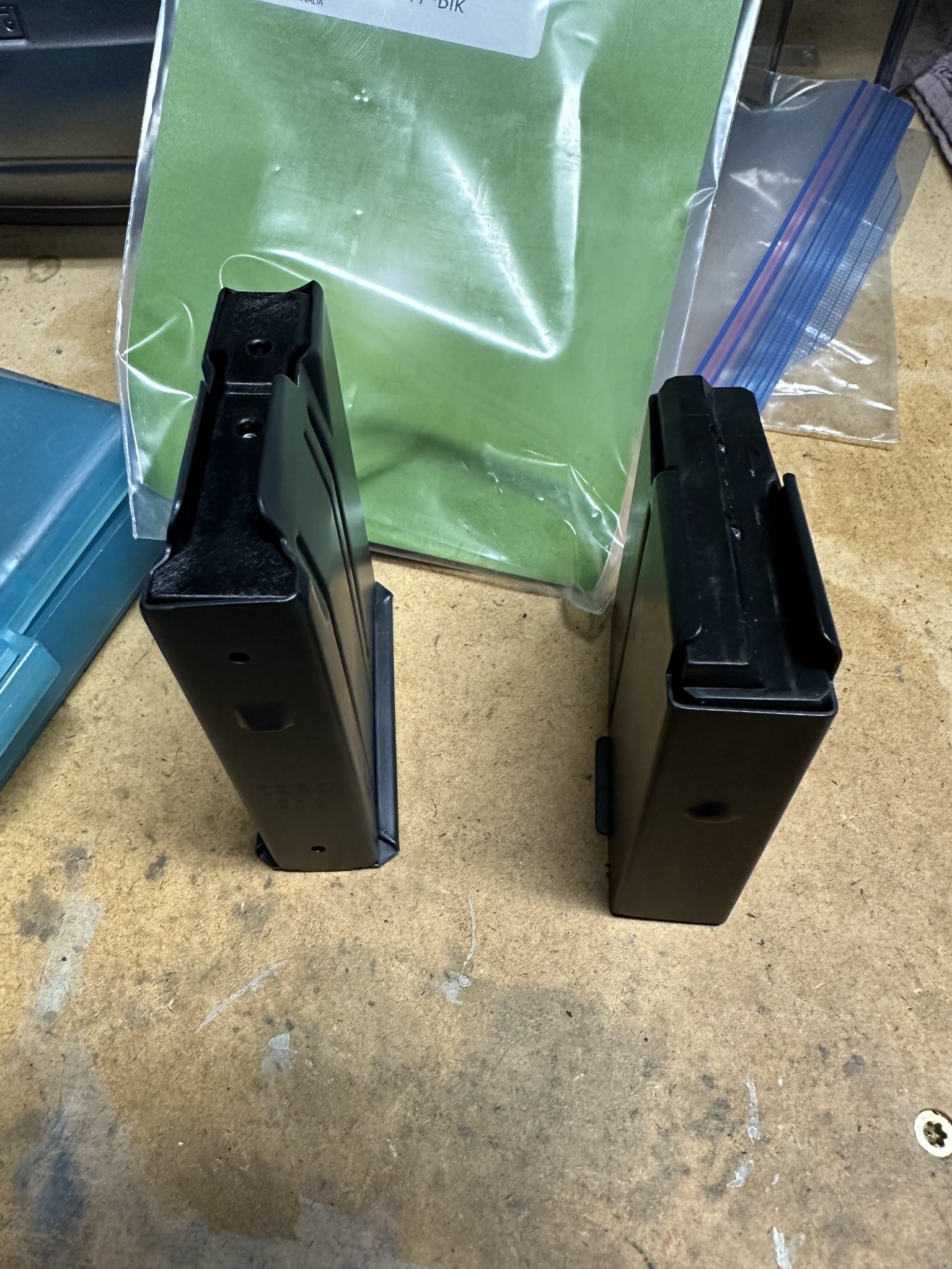

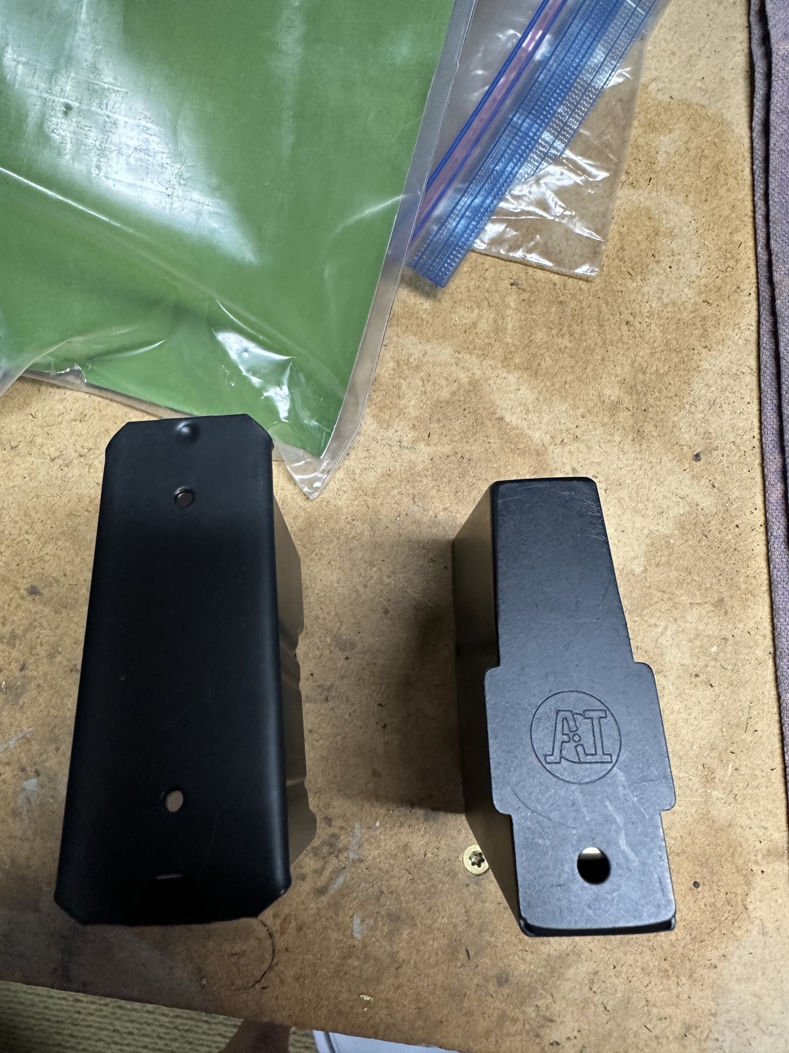

My CDG/Xylo combo works perfectly with AW magazines. I’m pretty sure ARC even says no mods needed for them.
AICS magazines will not go far enough into the chassis without hitting and stopping on the action first. Honest question. Are you sure you have AW magazines?
Yes sir. Tried both styles. AICS definitely hit. AW style (they are new metal mags that I bought from MDT) are just shy of latching in
Yeah if he sourced them from MDT he has AICS mags.
Try these AI AW mags and it will work fine.
Reactions: FredHammer
Phew....They still will not latch. Close but no cigar.
Is your Xylo one of the first ones released? I know they made a few changes. Did your CDG trigger hanger clear without issues? I think the original once have clearance issues with the hanger.

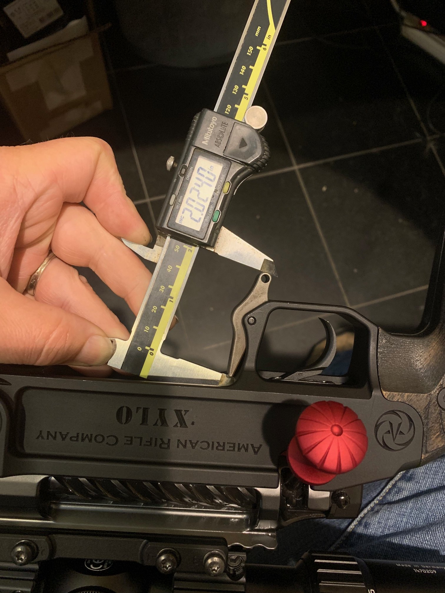

That's a negative Gearguy.
Std mag latch on a Xylo works with AW's. A shorter latch is available for AICS mags.
CDG/Xylo/AW without touching the latch.
View attachment 8223156 View attachment 8223157
My early Kylo mag latch had to be changed to what is now "standard". I made this post earlier in this thread. What is now standard wasn't standard on early models.
Reactions: lash and gearguywb
That's odd. Mine is a very early model Xylo. Had to machine front & back of trigger pocket for hanger, but the latch in the picture is stock.
Works perfect with CDG + AW's. Mine feels like it has about .005-.008 extra clearance once it's latched. There are no part #'s on my latch FWIW.
If @gearguywb CDG bolted in the Xylo without mods then it must be the later version & should have the "std" latch?
Ted intentionally designed it so that:
If the chassis was set up to run AICS with any other ARC action, then a change to CDG & AW should be tits without latch modification.
CDG + AICS requires the shorter latch.
I was happy that was my case. Allows me to swap back and fourth Nuke/AICS - CDG/AW & no other changes.
Reactions: Ichi and lash
My Xylo fits the CDG just fine, AICS mags don't fit, but AW fit great. It does not have the cut out for the silver spacer they sent with the CDG for the Xylo stock. I got my Xylo less than a year ago. Is this cutout in the Xylo balls ass new?
All I can say is mine required buying a different latch to run AW mags. I have an ARC email about it and made a post about it some pages ago in this thread.

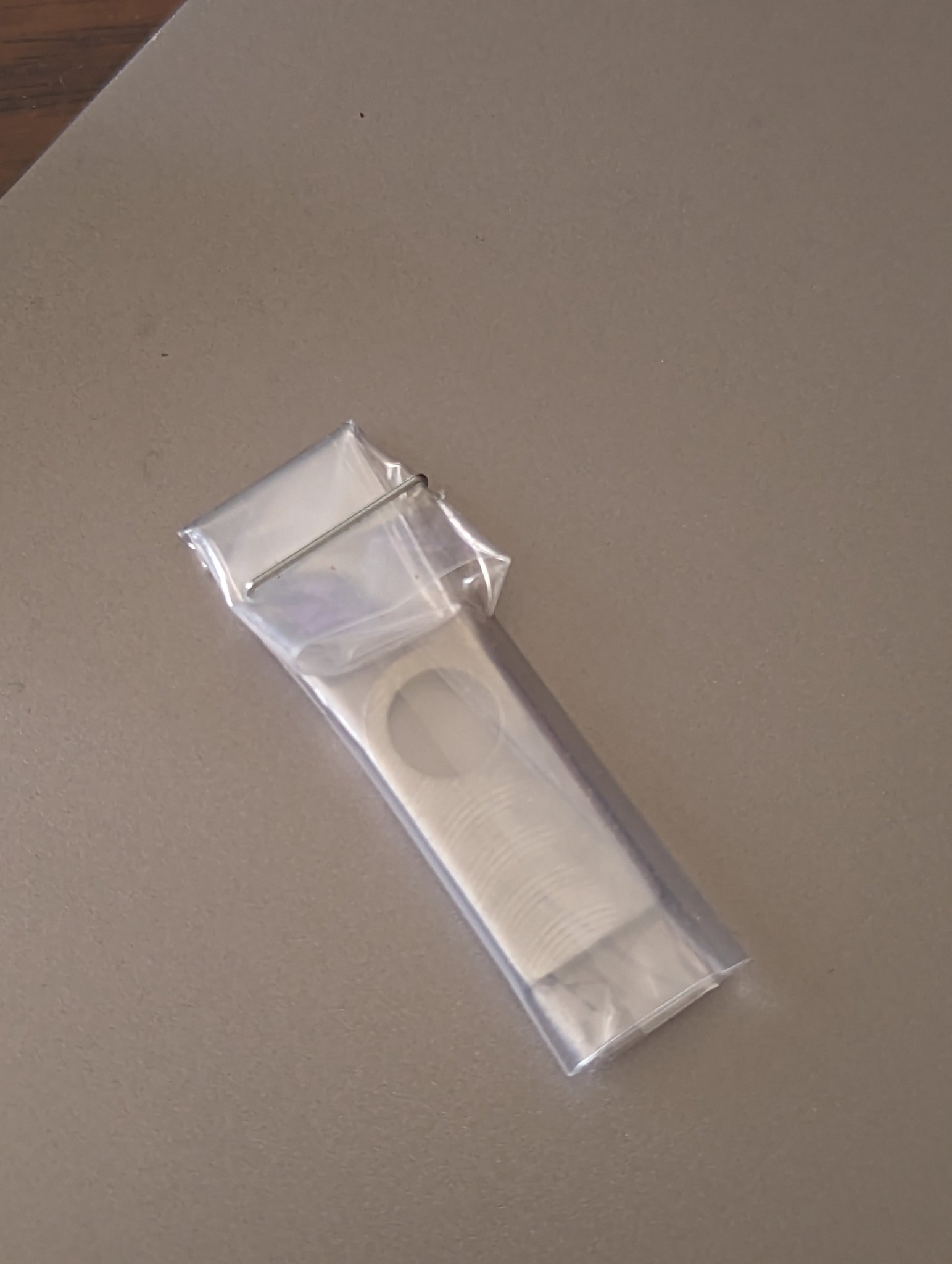

This was in the box with the action. Ironically it was under a bunch of padding, which was in the bottom of the box. I'm glad I yanked up the padding. Does anyone know what this is?
