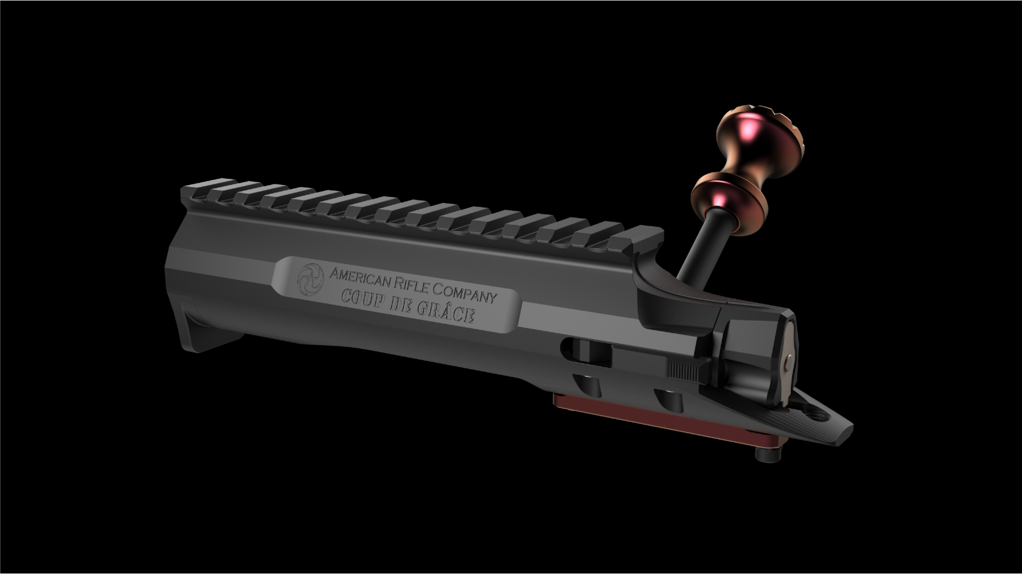

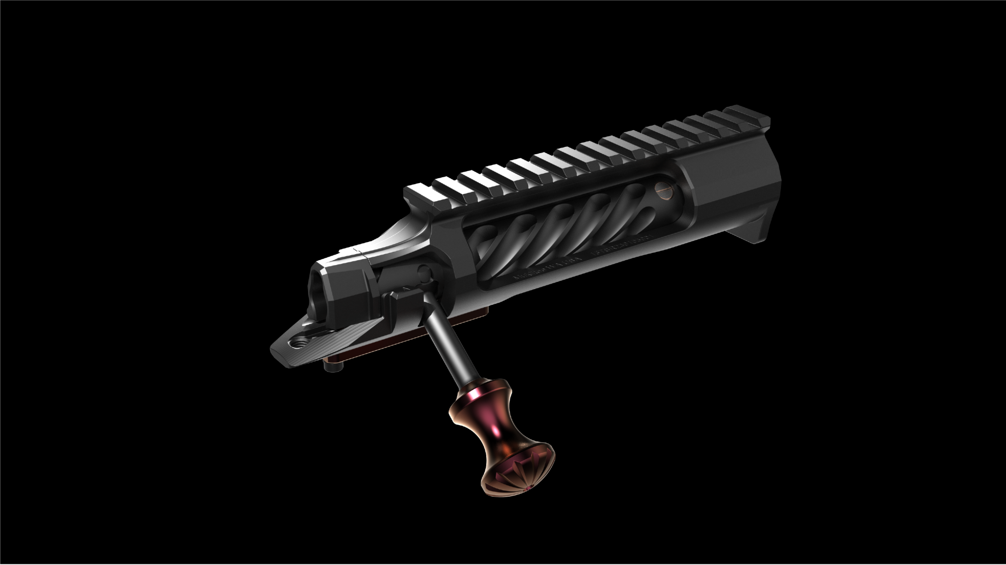

Simply put, the Coup De Grâce does more with less and looks great doing it with its beautiful design, DLC and salt bath nitrided finishes.
It’s Rem700 footprint receiver is machined with an integral recoil lug and integral 20 MOA rail.
The three-lug, 70-degree bolt uses interchangeable floating bolt heads and accommodates everything from 223 Rem on up to 338 Lapua.

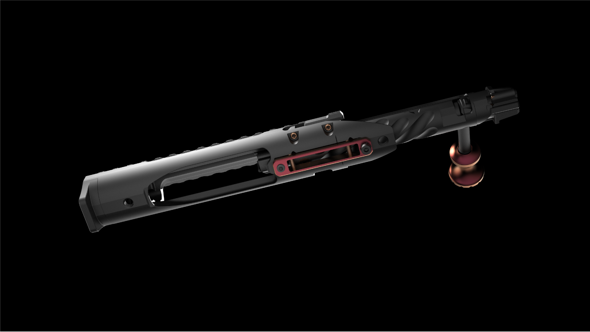

Receiver and bolt work well with AICS mags but are optimized for incredibly smooth and reliable feeding using AIAW mags and conical breech barrels.
The AIAW mag will hard stop against the bottom of the receiver thus preventing interference with the bolt.
The back of the AICS mag will hard stop against the receiver but if pushed upwards, the forward tips of the feed lips will interfere with the bolt. The mag will be driven down when pushing the bolt forward. An optional forward hard stop for the AICS mag can be placed between the receiver and the stock/chassis.
Receiver-mounted passive (aka mechanical) ejector sends cases out at three o’clock through a large ejection port.
Controlled-round feed extractor grips a large portion of the case rim taking full advantage of the patented pivoting bolt handle that easily pulls even the most stubborn cartridges from the chamber.
The pivoting bolt handle can be swapped out for a fixed handle thus converting the action to one with conventional cam extraction better tolerated by highly sensitive triggers.
The entire bolt assembly is composed of only sixteen parts, but can function with as few as twelve, of which two are springs and one is a ball.
The entire bolt, even the striker assembly, can be disassembled in the field without the use of tools.
A screw-adjustable trigger hanger makes easy work of positioning Rem700 compatible triggers for bump-free bolt closing.
Dual cocking cams reduce friction within the bolt for easier bolt lift.
The bolt knob is our best ever and makes fast cycling really easy. Other knobs can also be adapted to the standard 5/16-24 handle thread.
The circular section of the bolt handle makes sweeping it back easy if that’s your preference.
Robust 9 o’clock bolt release has a direct load path to the receiver which protects the its pivot pin.
Patented toroidal bolt-lug bearing surfaces reduce stress.
The Coup De Grâce is explosively tested for safety at pressures that greatly exceed standard proof loads.
Weight: short action 947 grams (2.1 pounds), long action 1084 grams (2.4 pounds)

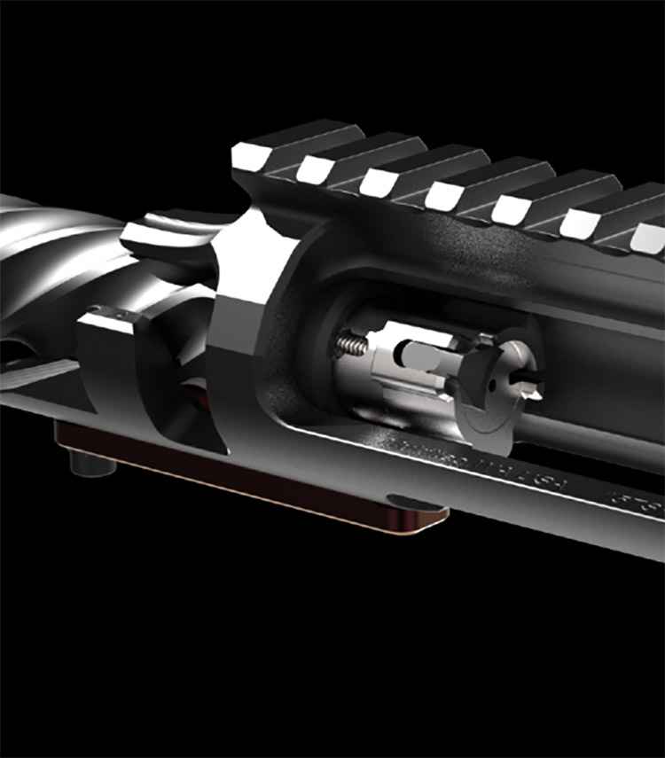

So am I the only one that is reading conical barrel requirement and thinking unique barrels to the action, or less chamber pressure being run due to the unsupported case body?
Maybe, but the pic below should address your concern, which by the way is rather insightful. The case is a 308 Win, representative of many 0.473" diameter heads and you can clearly see that it is fully supported. You can also see that the extractor is in close proximity to the inner wall of the receiver making quite tolerant of case head separations.
It's worth noting that case heads are surprisingly strong. New brass is all but useless for testing case head separation events. The breech faces of the test barrels need to be cut away so that the thinner part of the case, well ahead of the web, is left unsupported, said case also requiring a groove to better initiate failure.

How would this new extractor rate against the Nucleus, Archimedes and Mausingfield extractor? If I recall correctly, in the Nucleus video, you've stated something to the effect of not needing a spring to bias the extractor radially inwards is superior and demonstrated the strength of the "leaf spring" type extractor by bending a cartridge against a table. Will this new design be as robust?
Reactions: BenW
@karagias
Looking at the coned breach drawing Ted posted above, there is quite a bit of detail on the extractor exposed in the drawing. It appears that it has been designed such that rearward bolt movement engages a surface on the extractor piece and cams the extractor claw into the brass rim? I’m sure Ted will jump in and elaborate, but to my eyes it looks like another one of his well thought out and deliberate design tidbits that works in our favor.

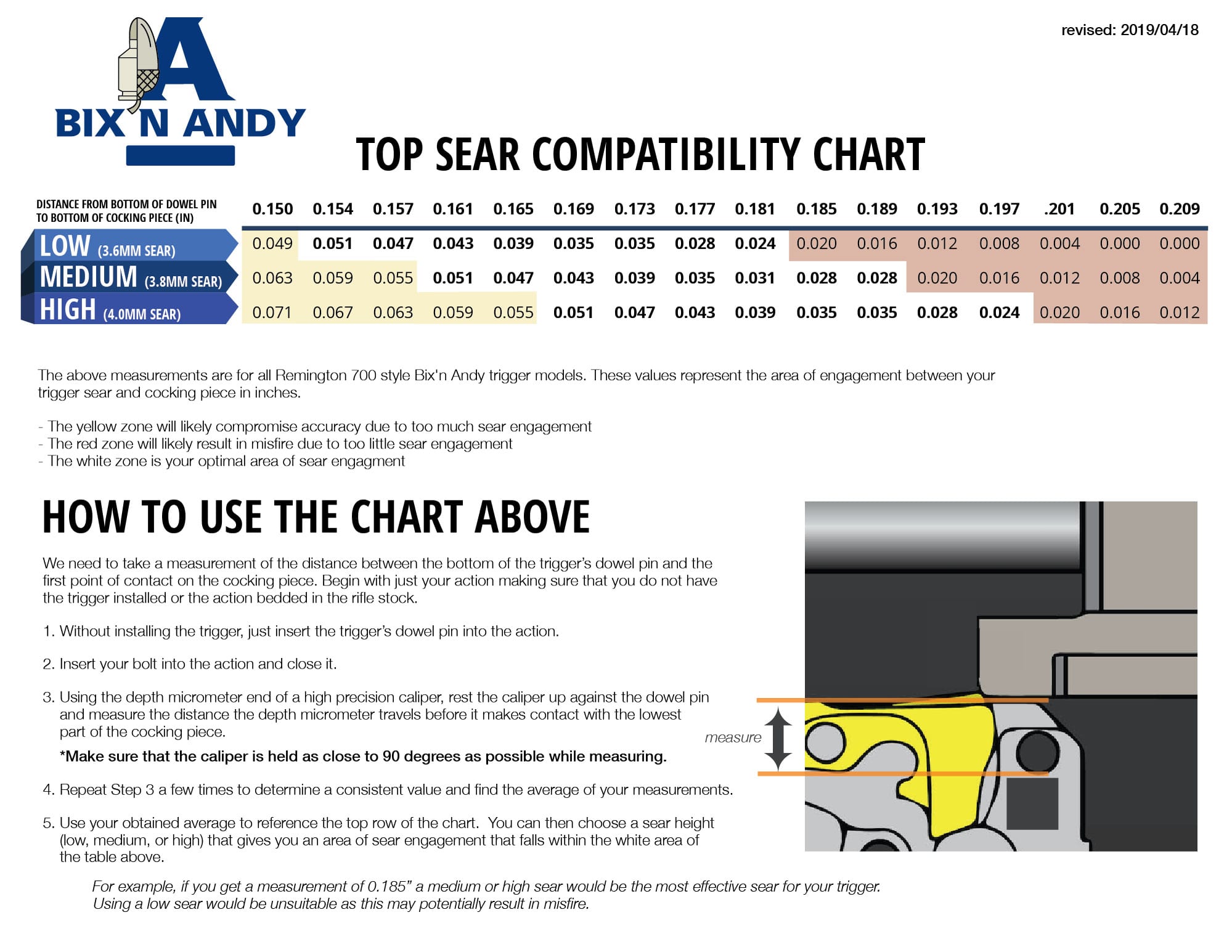

I never knew people had issues with triggers in the arch? My bix tacsport pro worked great and the tt diamond in it now has the sear slide over when going as fast as possible but every tt does that in every action I’ve ever put one in.
I want a pretty bolt knob for my other arc actions now.
Im jealous! All I normally run are BnA, can't for life of me get one to work with my Arch. Diamond......no problems, go figure. What sear height you running? Sorry for derailment.
