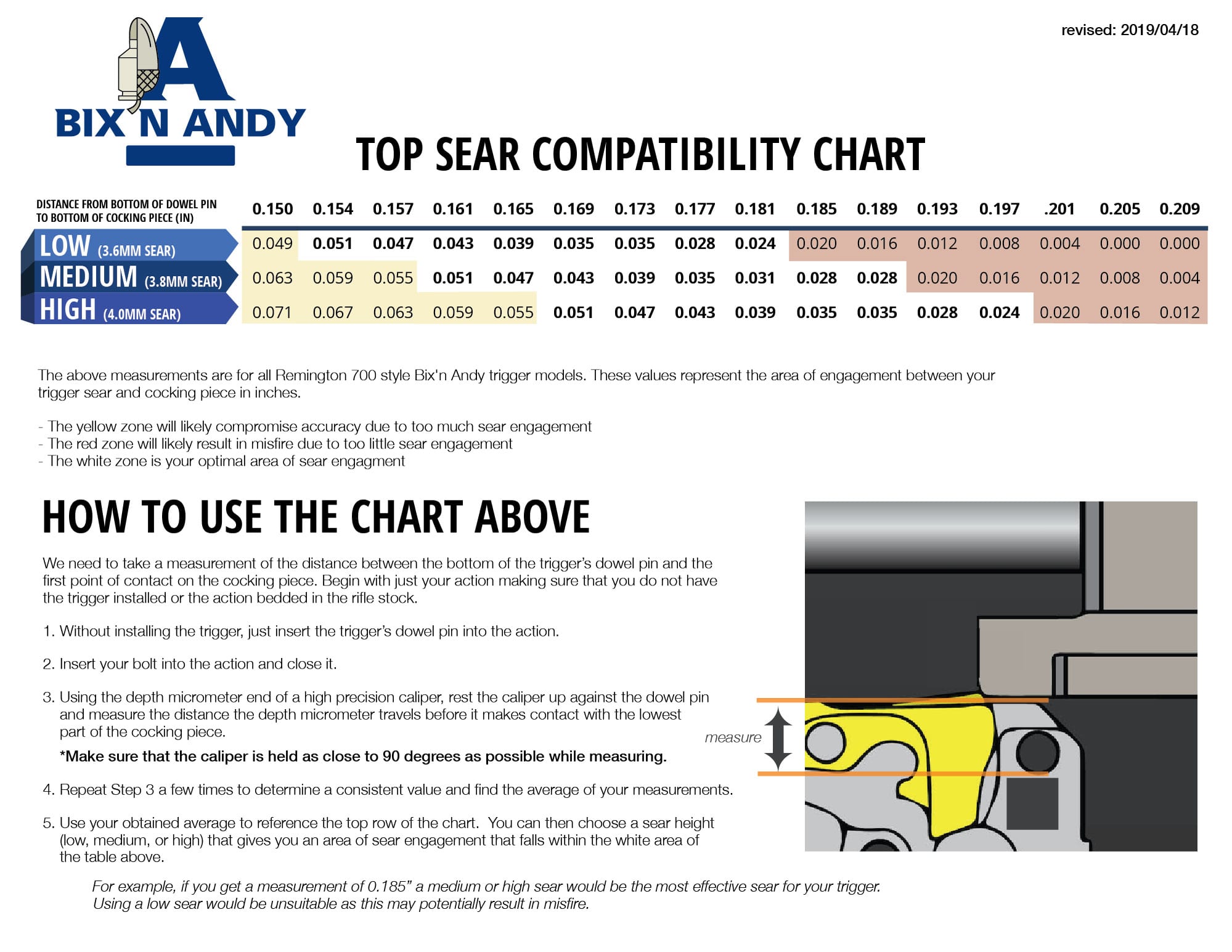

Low 3.6 sear I believe. You measured your action for it? From the bottom of the trigger pin to the bottom of the firing pin sear?
That dimension is 4.39mm (0.173in) in the Coup. Highly recommend max sear engagement for safety. Not sure why BnA uses multiple sear bars.

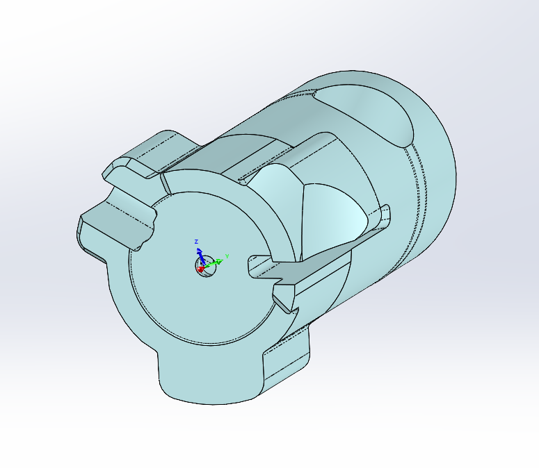

Looking at the coned breach drawing Ted posted above, there is quite a bit of detail on the extractor exposed in the drawing. It appears that it has been designed such that rearward bolt movement engages a surface on the extractor piece and cams the extractor claw into the brass rim? I’m sure Ted will jump in and elaborate, but to my eyes it looks like another one of his well thought out and deliberate design tidbits that works in our favor.
You are correct. Positive feedback (self-reinforcing effect) ensures engagement with case rim. Nice observation.

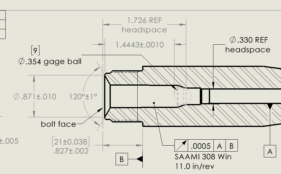

Curious to know if savage prefits will work as I use them with the Barloc on all my other ARC actions.
Depends on the mag and caliber but we're recommending conical breeches. They're essential when using AICS mags. AIAW mags have worked with flat breech faces when running 6.5 CM and similar. Go with conical breeches. We'll work hard on getting barrel drawings on line and to barrel makers. I think 0.588 (338 LM and Norma) will work with flat breech faces as it is hard to miss that big hole.
308 Win breech looks like this but wait for the final drawings.
