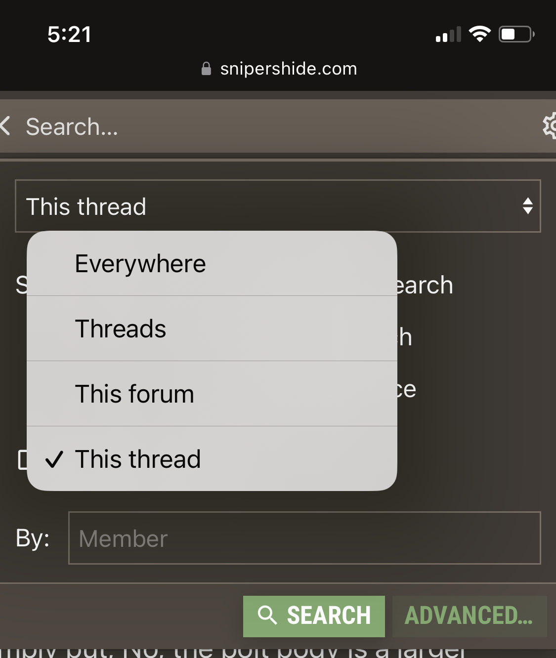

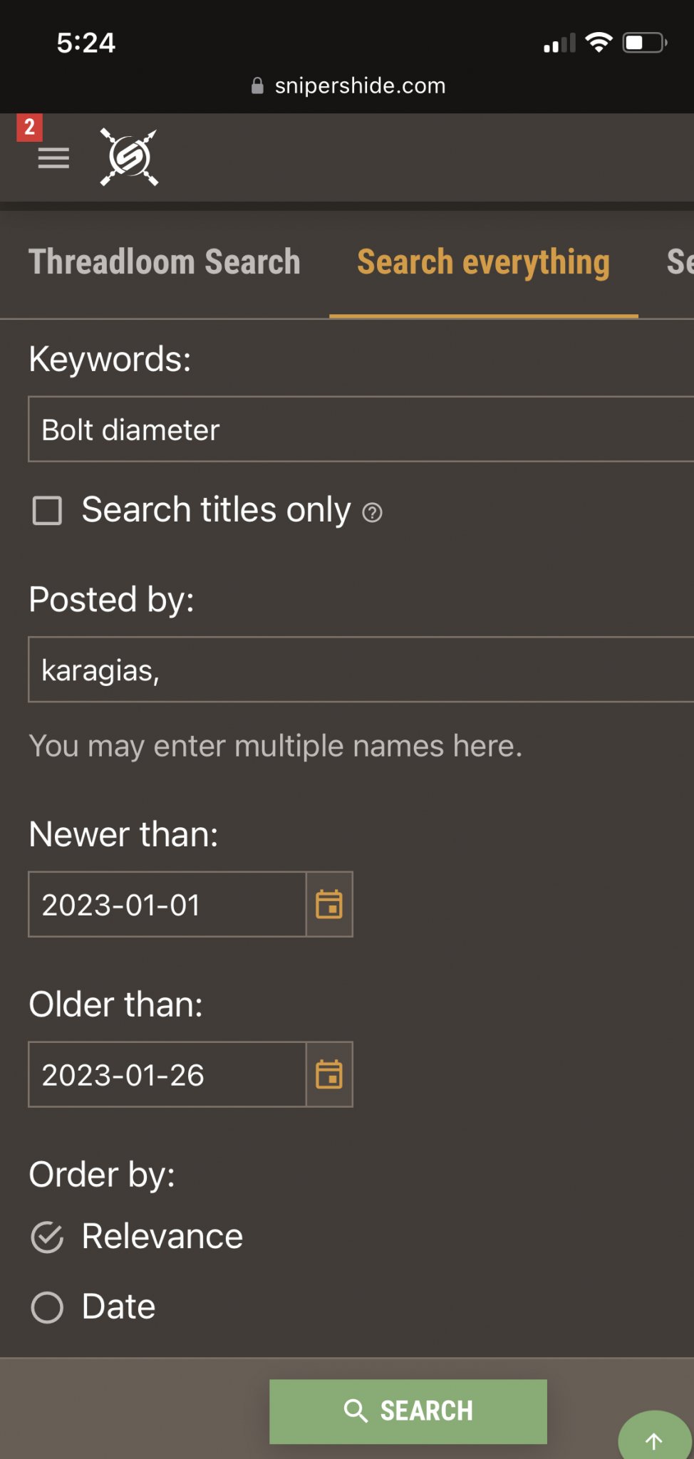

It would be really cool if there was a search feature where you could lookup things in a particular thread...
🤣 lol, yup. You mean like this?
Then Advanced search:
That really would be neat…
