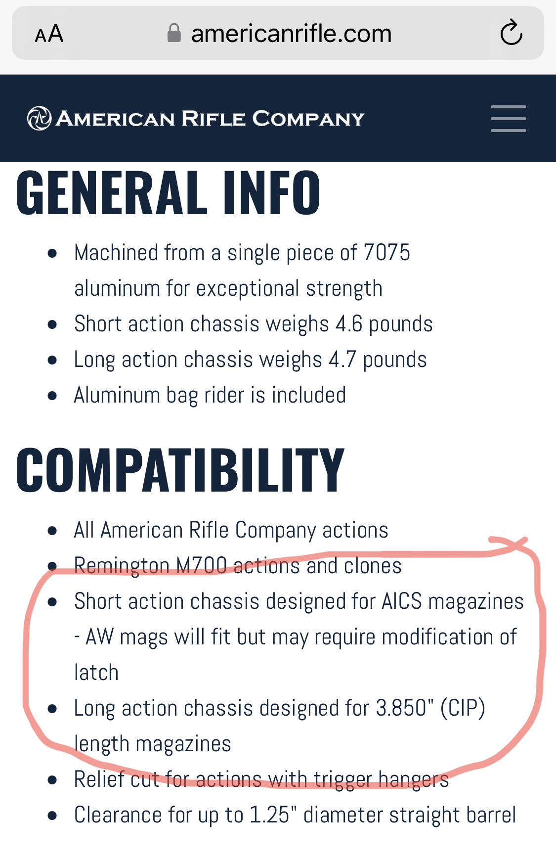

I’ll piggyback on this by asking if my Xylo, that was one of the first ones available, is compatible with the CDG and both AICS and AI AW magazines? Just making sure there isn’t a Gen 2 or newer version Xylo available.@karagias can I start my build by ordering a xylo and its bells and whistles now being assured that it will marry seamlessly the CDG and AW mags? Website description stil mention latch modifications required for AW mags.

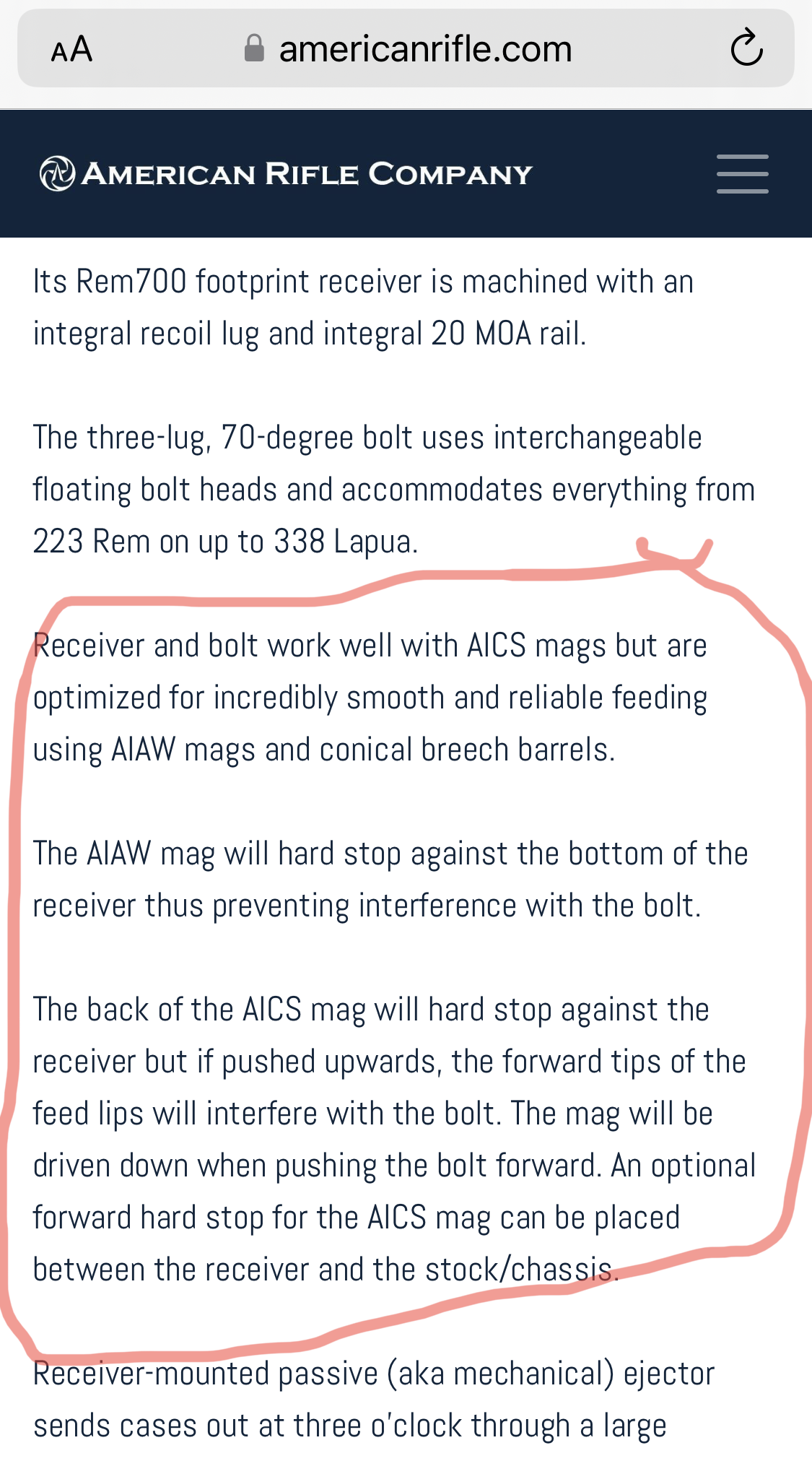

You need to read it again. It has always said that the CDG will work flawlessly with AW mags. It’s AICS mags that will work better with a shim in the mag well.@karagias ,can I start my build by ordering a xylo and its bells and whistles now, being assured that it will marry seamlessly the CDG and AW mags? Website description still mention latch modifications required for AW mags.

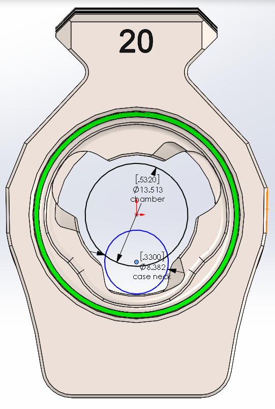

That subject has been discussed at length in the first few pages of this thread, though I get that just coming into a thread that’s 21 pages long would discourage one from wanting to read all of that. Especially since pages were wasted on those complaining about the name.This is my first post as new member. I’m more of a moderate to short range enthusiast for now. I have been wanting to put together a custom diy build and really like the features of the CDG. I really appreciate the ingenuity of the ARC actions, am also considering a Nucleus or the new Solus from Aero. I’ve read this entire thread and understand that barrels will need a cone breach similar to a M70. I’m a mechanical person and am curious what the difference in feeding is compared to the Nucleus to require cone breaching? Maybe I missed it somewhere. Does it have to do with AW compatibility. I like the simplicity of being able buy any off the shelf small shank savage barrel, but don’t see myself buying that many barrels so it’s probably a non-factor. Probably would start with a 6.5 creedmoor or even 6.5 grendel. I like the 6.5 family, currently playing around with a Swede.
Read page four of this thread where this is discussed. Posts #152 & 190 include descriptions and diagrams to help with understanding.This is my first post as new member. I’m more of a moderate to short range enthusiast for now. I have been wanting to put together a custom diy build and really like the features of the CDG. I really appreciate the ingenuity of the ARC actions, am also considering a Nucleus or the new Solus from Aero. I’ve read this entire thread and understand that barrels will need a cone breach similar to a M70. I’m a mechanical person and am curious what the difference in feeding is compared to the Nucleus to require cone breaching? Maybe I missed it somewhere. Does it have to do with AW compatibility. I like the simplicity of being able buy any off the shelf small shank savage barrel, but don’t see myself buying that many barrels so it’s probably a non-factor. Probably would start with a 6.5 creedmoor or even 6.5 grendel. I like the 6.5 family, currently playing around with a Swede.
Since you don't have experience with ARC actions I can see how the obvious would easily be missed.This is my first post as new member. I’m more of a moderate to short range enthusiast for now. I have been wanting to put together a custom diy build and really like the features of the CDG. I really appreciate the ingenuity of the ARC actions, am also considering a Nucleus or the new Solus from Aero. I’ve read this entire thread and understand that barrels will need a cone breach similar to a M70. I’m a mechanical person and am curious what the difference in feeding is compared to the Nucleus to require cone breaching? Maybe I missed it somewhere. Does it have to do with AW compatibility. I like the simplicity of being able buy any off the shelf small shank savage barrel, but don’t see myself buying that many barrels so it’s probably a non-factor. Probably would start with a 6.5 creedmoor or even 6.5 grendel. I like the 6.5 family, currently playing around with a Swede.

This makes sense. Thanks for the explanation and pics!Since you don't have experience with ARC actions I can see how the obvious would easily be missed.
To put it in simple terms, the lugs on the CDG are at 10, 2, & 6 o-clock. The opposite of the Nuke & Archimedes @ 12, 4, & 8. On the latter 2 actions there is a feed ramp between the lugs 4 - 8 o-clock. Without the ramp there is nothing to lift the projectile into the chamber of the smaller cartridges. The projectile/case neck pass through the 6 o-clock lug gap & hit the flat wall of the barrel below the chamber. With a cartridge like 223 the chamber diameter is small so there would be a taller flat wall adjacent.
CDG
Nuke
Feed ramp

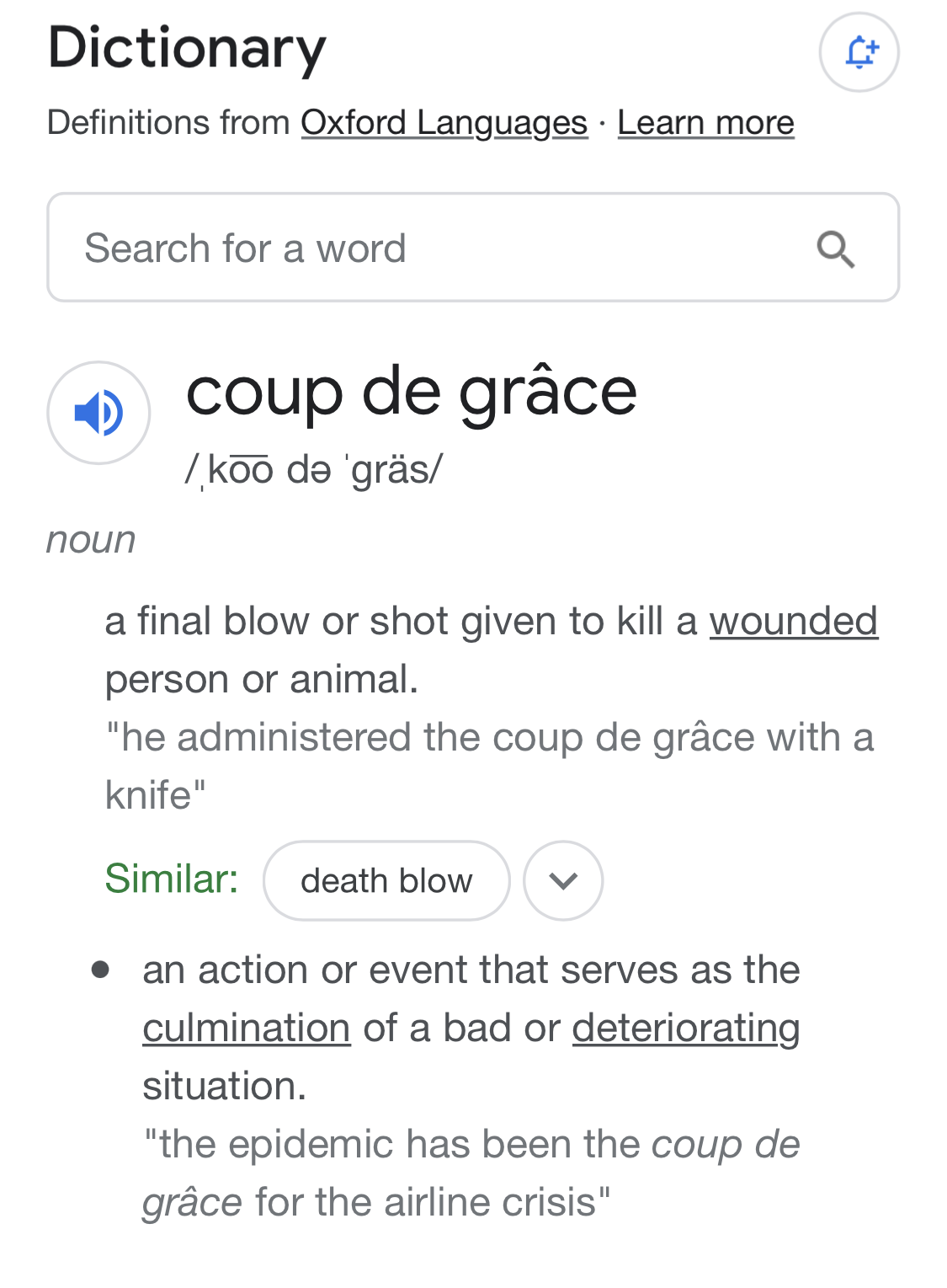

From the Oxford English Dictionary:
e. coup de grâce n. /ku də ɡras/ [literally stroke of grace] a blow by which one condemned or mortally wounded is ‘put out of his misery’ or dispatched quickly; hence figurative a finishing stroke, one that settles or puts an end to something.

Receiver and bolt work well with AICS mags but are optimized for incredibly smooth and reliable feeding using AIAW mags and conical breech barrels.
The AIAW mag will hard stop against the bottom of the receiver thus preventing interference with the bolt.
The back of the AICS mag will hard stop against the receiver but if pushed upwards, the forward tips of the feed lips will interfere with the bolt. The mag will be driven down when pushing the bolt forward. An optional forward hard stop for the AICS mag can be placed between the receiver and the stock/chassis.

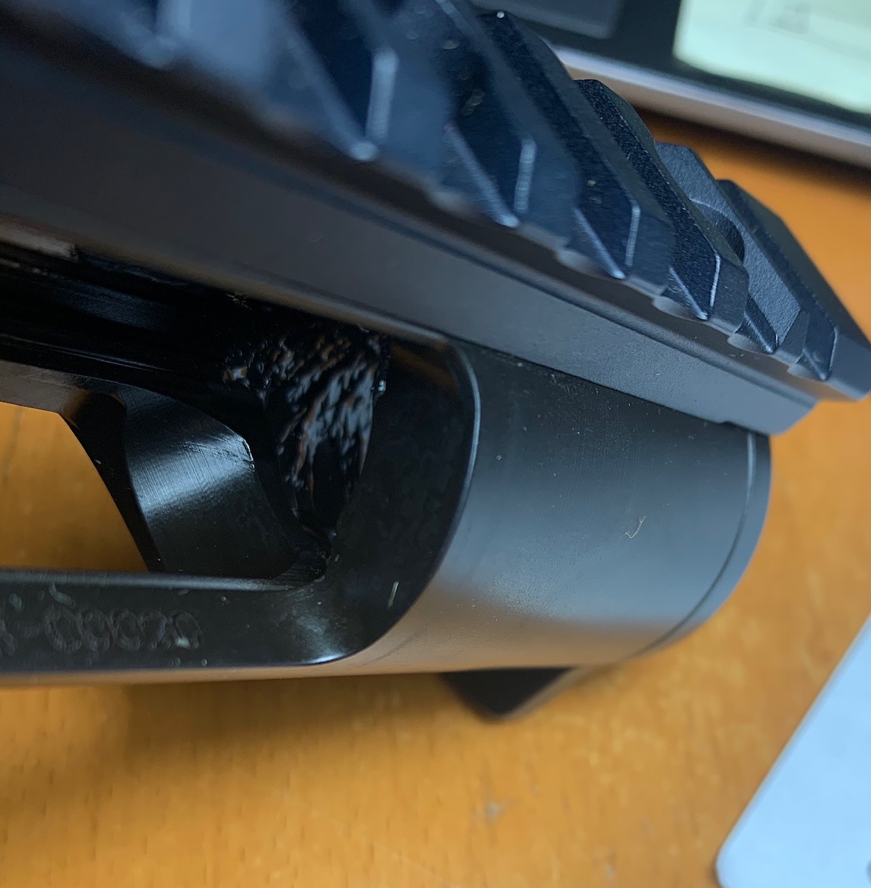

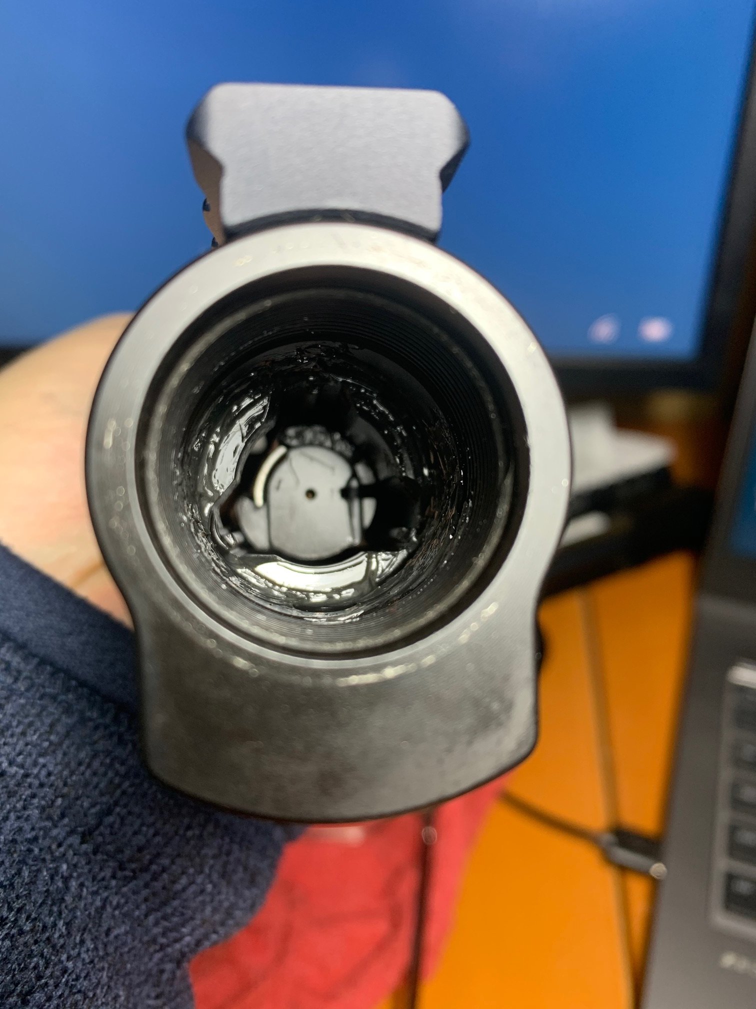

Mine were dry as a bone. Was it used?That's what it shipped with.
No direct from ARC.Mine were dry as a bone. Was it used?

I've got two arc actions, neither were slathered in what appears to be axle grease either lolWeird, mine were dry except for some oil on the striker assembly.
