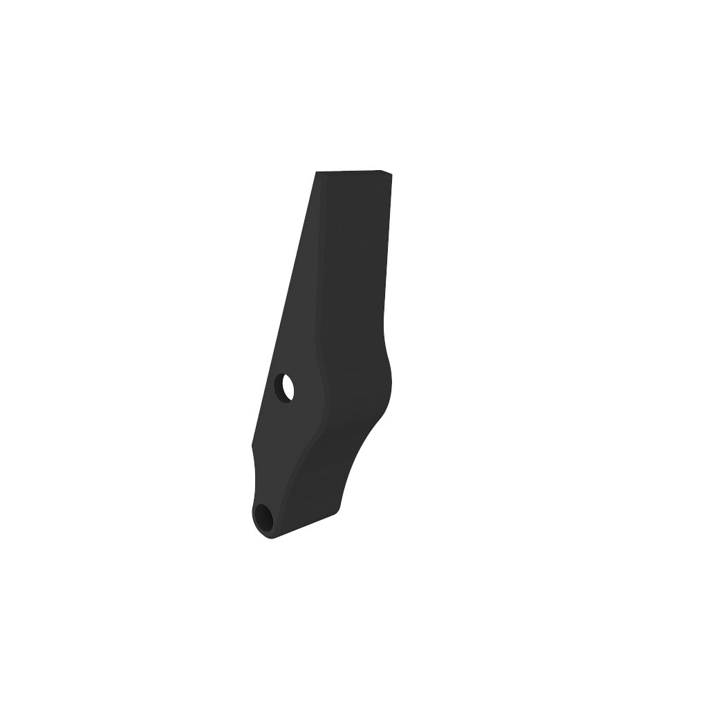

It's not the knob he doesn't like (heh), it's the diameter of the stem of the pivoting lever that sticks out of the bolt body that the knob threads on to . He would prefer it larger diameter and beefier looking. That's good only hangup with the action... Even after I reminded him his AI has what's basically a piece of spaghetti between the bolt knob and the bolt body. :ROFLMAO:
Reactions: lash
Ah, okay. ‘Cause a beefy looking 700 handle never broke off when somebody thought a 4# hammer was in order.

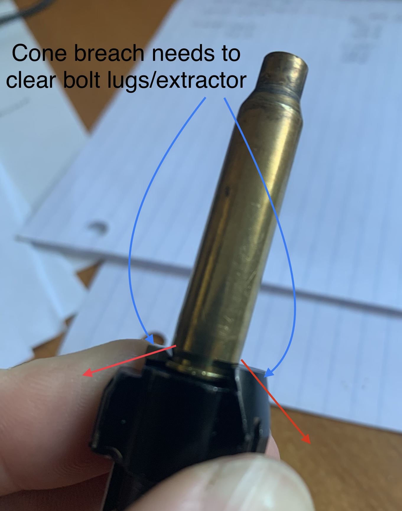

I don't think having them coned will be as simple as you think. Headspace is close to same, 0.825 vs 0.827, however the flat breech is 0.675 long from barrel shoulder and the beginning of the coned breech looks much closer to the bolt nose on the new action.
This has been nagging in the back of my head. I did a little ruff scaling from the sketch & come up with about .115" for how far the cone needs to extend down below the chamber to guide a .223 projectile in a 223 chamber. If my math is right then the tenon would need to be at least .067" longer than the std. .675" used for the flat breach.
What's bugging me is how will that clear the extractor & opposing lug nub/case support??? They stick out about .110" on a Nuke.
Almost seams like 223 would need a stepped cone breach?
