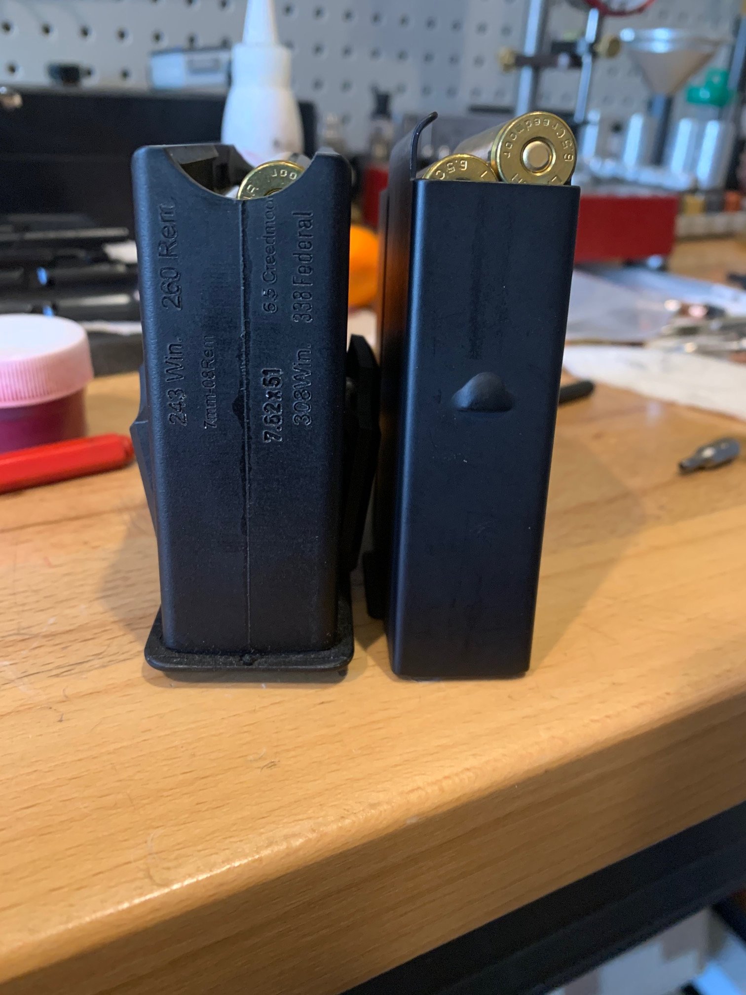

Sitting here figuring out how I'm going to get an extension on One of these AW's. It's going to be a PITA. Might as well make it from scratch. I'll post up some pics when done. I really need to finish the retrofit on my little CNC mill while waiting for the action/barrel.
Never used AW's before so my bitches are probably well known to many of you.

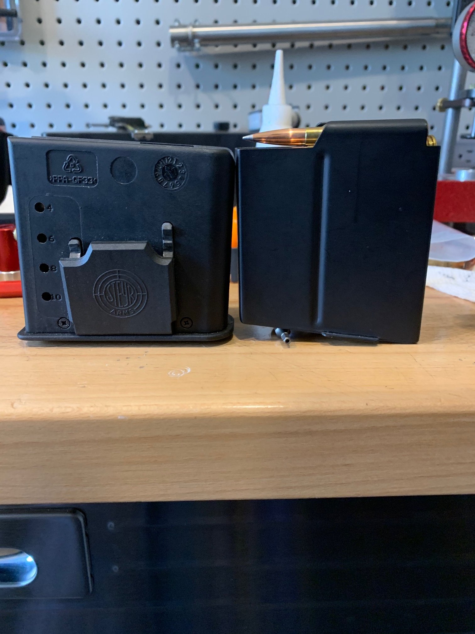

AW's are easy to load sure, but beyond that I'm not very impressed. The feed lips are looong & that can't be good for CRF?? It's pretty damn easy to get 1 or a couple rounds to fly out of these. Rounds stick up so if you inadvertently push down on the front of the top round, out she comes. They're also going to need the feed lips tweaked a little so the rounds have full even contact with the lips + round below. That should help to keep them from popping out so easy.
I guess the Steyr double stacks have spoiled me. They don't have any of the above negatives. They allow 3.150" & have a rib inside that's just ahead of the shoulder. The rib keeps rounds from sliding forward & it steers the round towards center as it feeds. The THB's & SSG's are 2 lug with a 6 oclock lug sim. to the CDG.
I think you can use an AICS extension, you just cut out the bottom of the AW to let the spring come down more. There’s chatter about it somewhere on this forum.
View attachment 8084258 View attachment 8084261
While I understand your concerns coming from your perspective, many of your concerns are completely unfounded regarding the use of AW mags in a competition environment. I believe that I’ve already covered that above, having experience over about 11 years of almost exclusive AW mag use.
And as I’ve also mentioned above, adapting the AW mag is very doable using a mill and the Area 419 extensions. I’ve not done it myself, but I’ve seen a couple in use that were done that way.

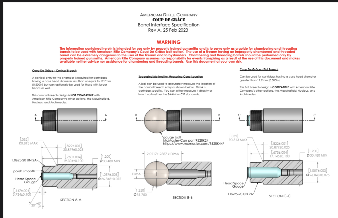

Contacted ARC regarding installing a CDG in a Xylo chassis and using AICS and AW magazines. I also asked if shorter latches and the AICS magazine stop tabs will be available for the Xylo chassis.
Below is my email and their response.
I have a Coup de Grace on order. I also plan to purchase a Xylo chassis.
I plan to shoot both .223 and 6.5 Creedmoor.
I'm confused by the Xylo compatibility description on your website and Ted's video demonstration of using both AW and AICS mags in the Xylo chassis with a CDG.
The webpage (https://www.americanrifle.com/shop/xylo-chassis-139#attr=301,228) for the Xylo chassis states that it is a "Short action chassis designed for AICS magazines - AW mags will fit but may require modification of latch".
Yet in Ted's video, he seems to contradict this and states the opposite. He states that a modified latch is needed to run AICS magazines. Is this due to the CDG action itself and not the chassis?
Will ARC offer the different magazine latches as an accessory for the Xylo chassis? Or do I need to have a gun smith make/modify a latch for running a AICS magazine with a CDG in a Xylo chassis?
Ted also mentions a small metal tab that can be placed between the action and the chassis to provide a hard stop for the front lip of an AICS magazine. I understand that this tab may or may not be necessary. Will this tab be available as an accessory?
Thanks for your help.
Sorry for the confusion. For other actions, latch modification may be required to run AW mags as most are designed around AICS magazines.
We have chosen to optimize the Coup De Grâce action for use with AW magazines, which allows them to use a standard length magazine latch without modification and requires a shorter latch for AICS magazines.
We have extra magazine latches that can be easily shortened (for use with AICS mags and CDG), but I believe we will also be making shorter latches in the next batch.
The magazine stop tabs will be available if not provided with actions. The Xylo also has two small threaded holes and screws for this same purpose which can be used instead of the tab. The screws don't come with each chassis by default, but we can include them with a Xylo if requested. They're also available for purchase on our website: https://www.americanrifle.com/shop/1290
