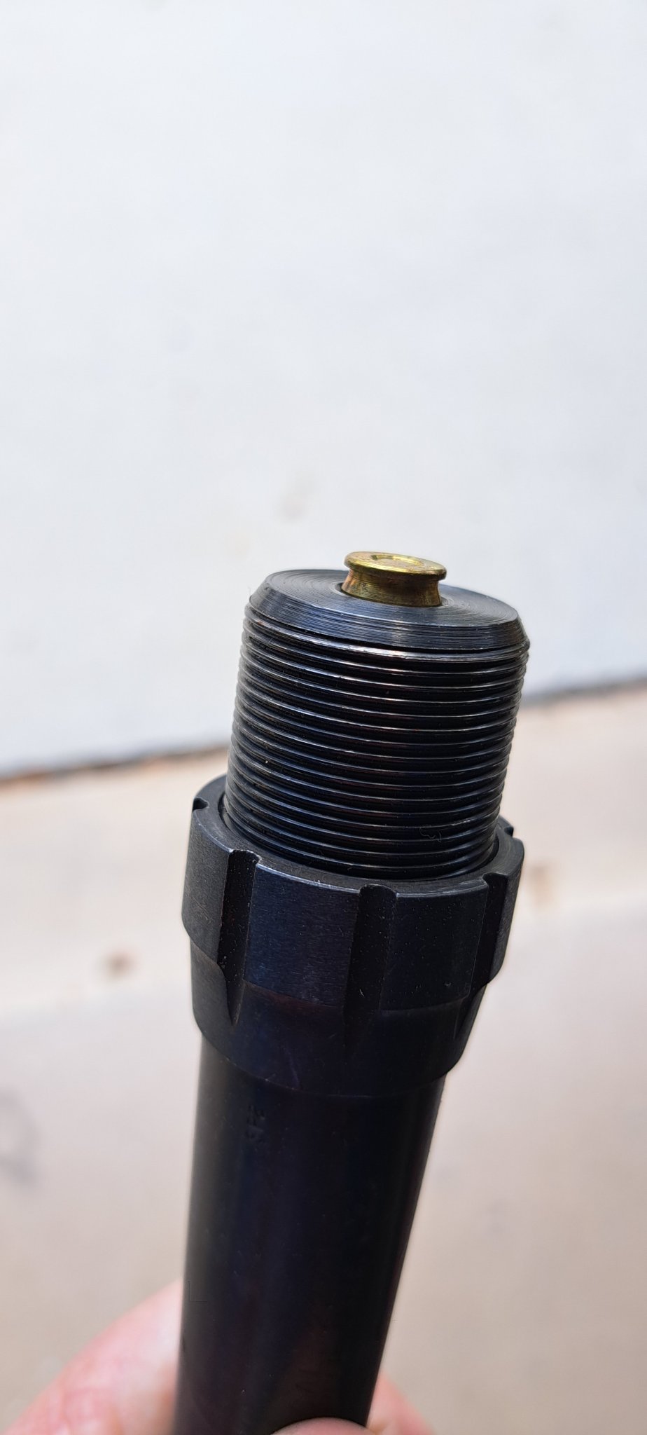

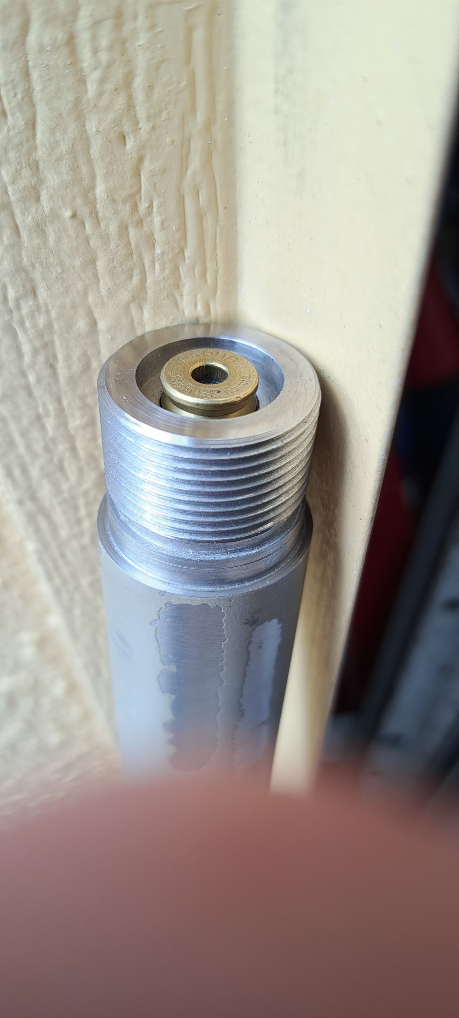

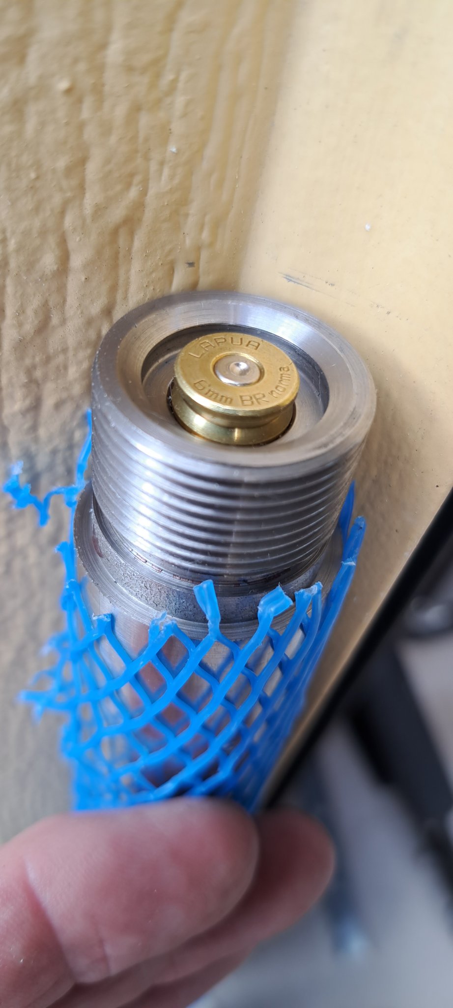

Maybe this will help explain all of the questions about tenons that have been answered numerous times.
Flat breech factory Savage 223 barrel.
Notice that the brass is supported all the way to where the extraction groove begins.
Next up is the Remington "3 rings of steel" breech. Sorry about the finger in the bottom of the pic.
Note that the brass is supported all the way to where the extraction groove begins. (Some may detect a trend here)
Up last is a barrel that started life as a coned breech for a Farley action.
It was rechambered from 6 PPC to 6 BR and the breech end was modified to the Remington bolt nose.
Note that the cone sits further back than the flat breech but doesn't really affect the Remington setup. It does aid in feeding though because the back of the barrel isn't flat.
