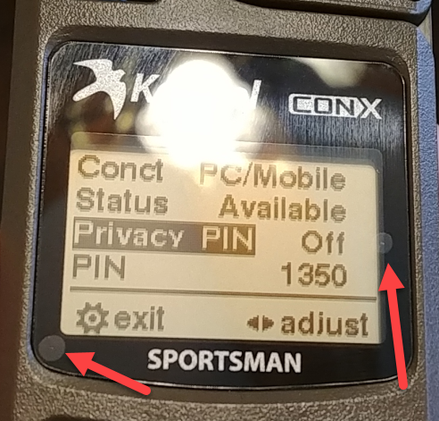

On a side note any of you all with these. IS there a clear protective piece over the screen? I noticed a couple weird circles and it looks like it may have a screen protector on it but didn't want to jack screen up if it doesn't trying to remove it.
@x_789 try and delete and reload the ballistic link app. And yes there is a plastic film cover on the screen

Mine has a weird “bubble “ on the bottom of the screen too, but doesn’t act like a removable film.... I’m scared to get too crazy with it....
I had to work with my finger nail to get a corner up is why I asked. It did come off and now screen is clear with no issues. Its pretty heavy plastic almost like a cheap phone screen protector vs the thin stretchy stuff that is more like plastic wrap.

Got mine off! Sure was heavy-duty; on hindsight maybe I should’ve left it on for a couple years.?
