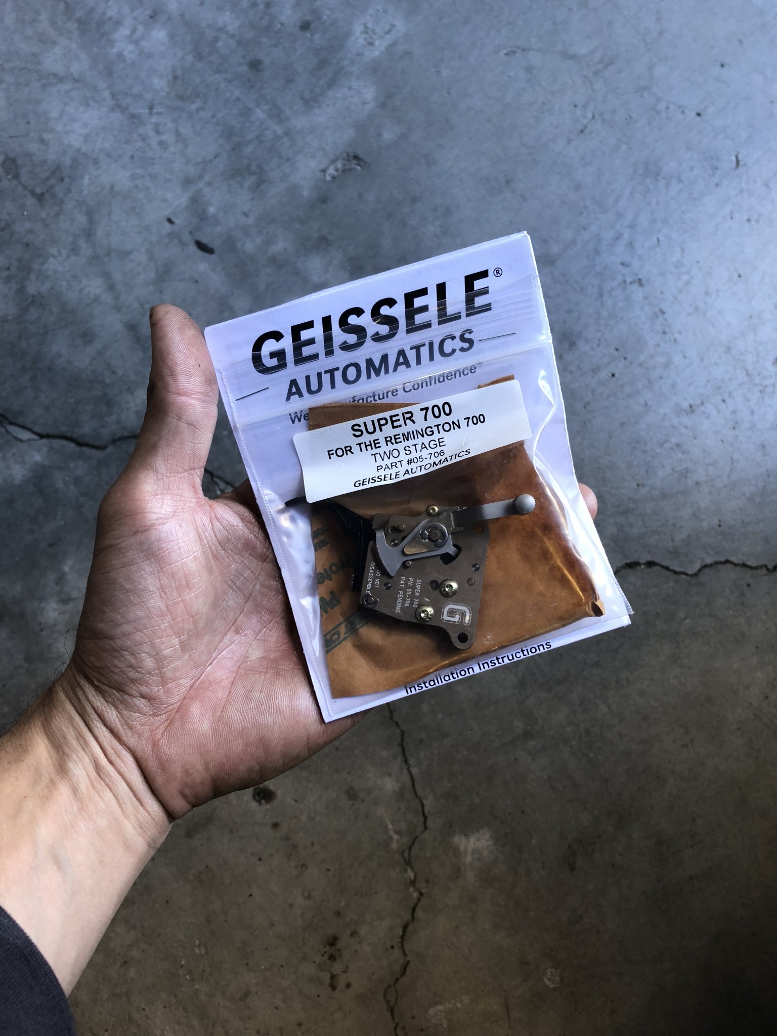

Showed up today.

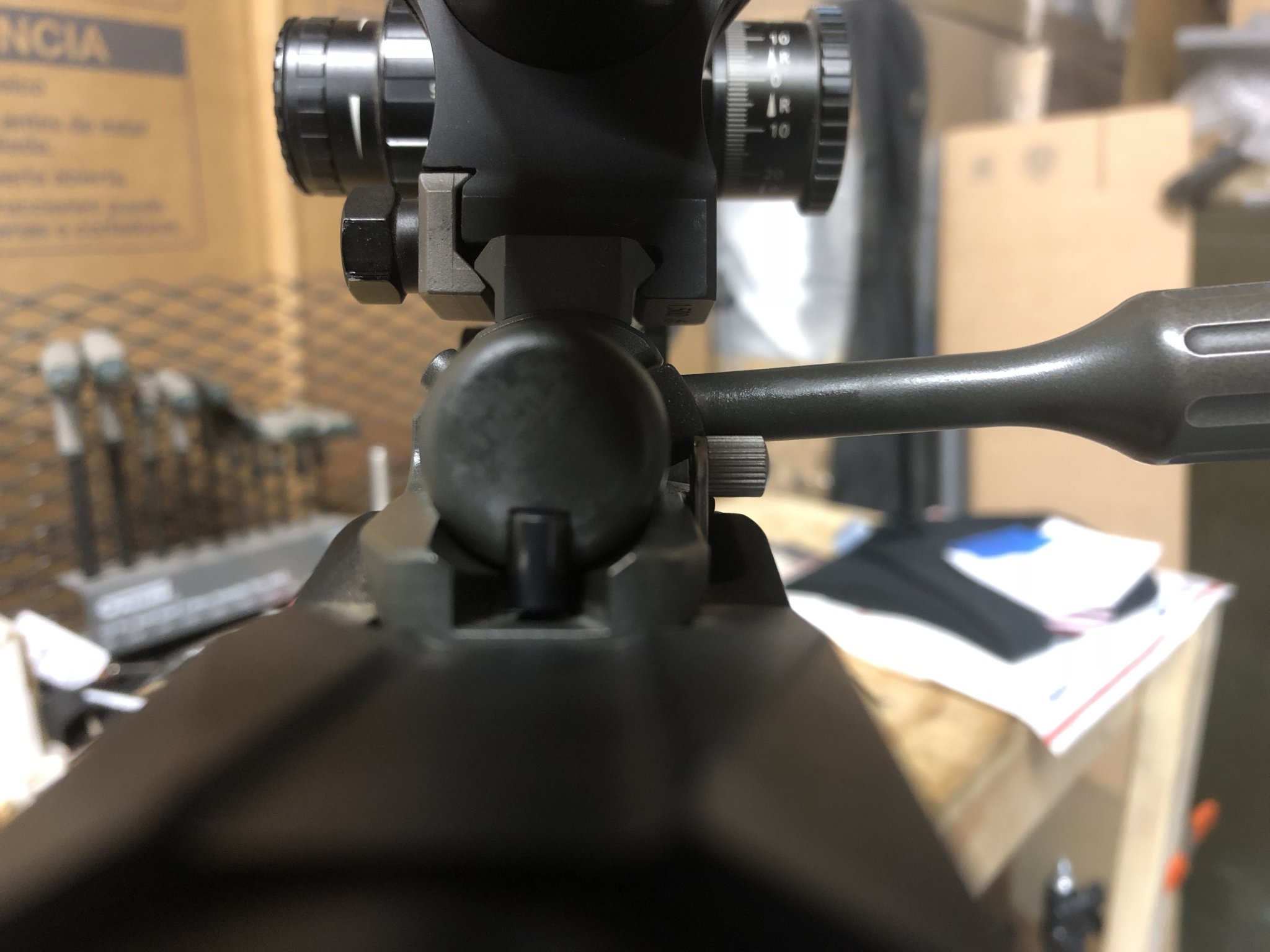

I had to grind down the safety to clear the bolt handle on my U300.

So other than this it's working? I have very little experience with the r700 clone actions out there, I know there are a LOT, but it's interesting to me the minor differences. craigos listed some actions including a Big Horn and Mausingfield this works in, you had to modify your safety lever, won't work at all on a Nucleus. Which leads me to the question is the reason it won't fit the nucleus a trigger issue or an action issue? I'm a ways from getting another rifle but am fairly sure I want to go with a custom action when I do so trying to figure out some nuances between them. Anyone try this on a Surgeon, Defiance, AI or Stiller?
Yes, it’s not pretty and not something I would do on a client rifle but I got the handle to clear the safety selector. I lightened the first stage a little and might head out tomorrow and shoot.
Cool, let us know how it goes. I got mine in my r700. Feels great but I might also lighten first stage a bit. Just dry fires so far.

Got mine from Brownells yesterday. Not going to work on BO M2013 w/o some work on safety lever or receiver. Certainly not going grind on receiver so haven't decided if I want to try to bend lever a bit for clearance or cut my losses and return.
Decided to try bending lever. Easy removal from trigger w/ one e-clip but much stronger/harder to bend than a Rem lever. Seems to work fine on the 2013 after getting safety clearance.
