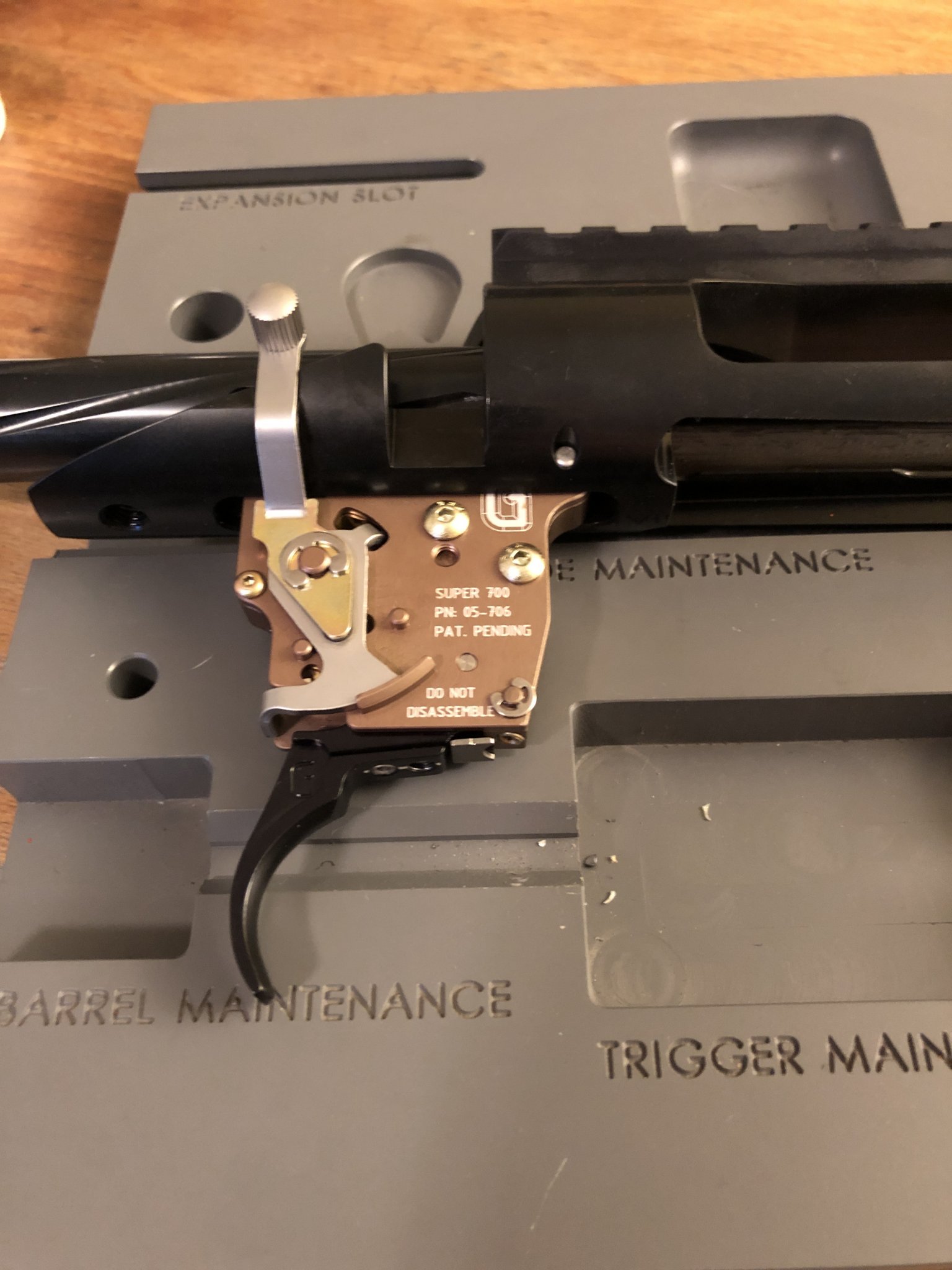

I just got my two stage from Brownells today.
Installed it in my spare Nucleus action.... Big no go... I can see trigger sear fully clearing the intermediate sear but the firing pin does not drop...

I just installed one in my Nucleus ordered around the same time. I thought the restock was suppose to have the fix too. Total bummer as it felt really, really good when I could get it to drop. Did you get any more info from Geissele?

I called Geissele, they were supposed to issue me an RMA to return it to be modified. I waited, I called, I waited, no RMA came. I returned it to Brownells.
I called yesterday and spoke to "Jay" who said to send an email to their sales@geissele email address. I got a response w/ an RMA form to send it in for a swap this morning.
I sent an email to Geiselle yesterday and received a reply today along with an RMA form to fill out and send with my trigger. I corresponded with Nick...He assured me they could 'fix' the trigger to work on the Nucleus action...Life is good!
I received my replacement two stage trigger this week. I used it a bit before sending it back because of the recall, the break on the second stage is really nice.. but I feel like the take up during the first stage is much too long before you hit the 2nd stage wall.

On another note, when clicking my trigger down to safe, the lever has a little resistance for the safety bar to ride over the trigger shoe. It's nothing substantial, just kinda prevents the safety from clicking down smooth. It is for sure not binding on anything and is purely within the trigger itself. Has anyone experienced this?
I 'communicated' directly to them via email... They replied via email which included a RMA # And form to fill out...My trigger is on the way to Geiselle...
Update: I rec'd the following emial from Geiselle Automatics:..."

Im going to be stepping in for Nick to help out while he is away at Shot Show. We did receive your 700 trigger and will be sending it back with the ARC conversion.
Please feel free to reach out towards the end of the week for an update on the conversion/shipping status as well as if you have any other questions.

Yeah I've been told twice now that they will send me a RMA.... Still no RMA. At this point I'm kinda sad I sold my huber trigger!

Well, that was fast! Just got an email from Geiselle stating my Super 2-stage was done, gave me a tracking number and would be on its way to me very soon...Great customer service!
My replacement is out for delivery! I like the trigger and am curious how the Trigger Tech 2 stage will compare.

The Geiselle Super 700 2-stage trigger is supposedly being modified for the Nucleus action... I won't know until my JHC rifle arrives... My experience is limited to my AR15 till now...Loved it. Very little experience in the PR arena...
Customer service? Geiselle has it...They sent my trigger back UPS 2 day air...Delivery scheduled tomorrow...Now, if I just had a Nucleus action to test it in...Lol
Has anyone had luck with the super 700 in a Surgeon? If yes, what did you do to make it work?
I just tried to drop one in a 1086 and nada. Tried to adjust sear engagement and didn't seem to make a difference either.

Recently received a Super 700 from Brownells during their last Geissele sale. No dice on my Nucleus action. Pull the trigger all you want, nothing’s happening.
