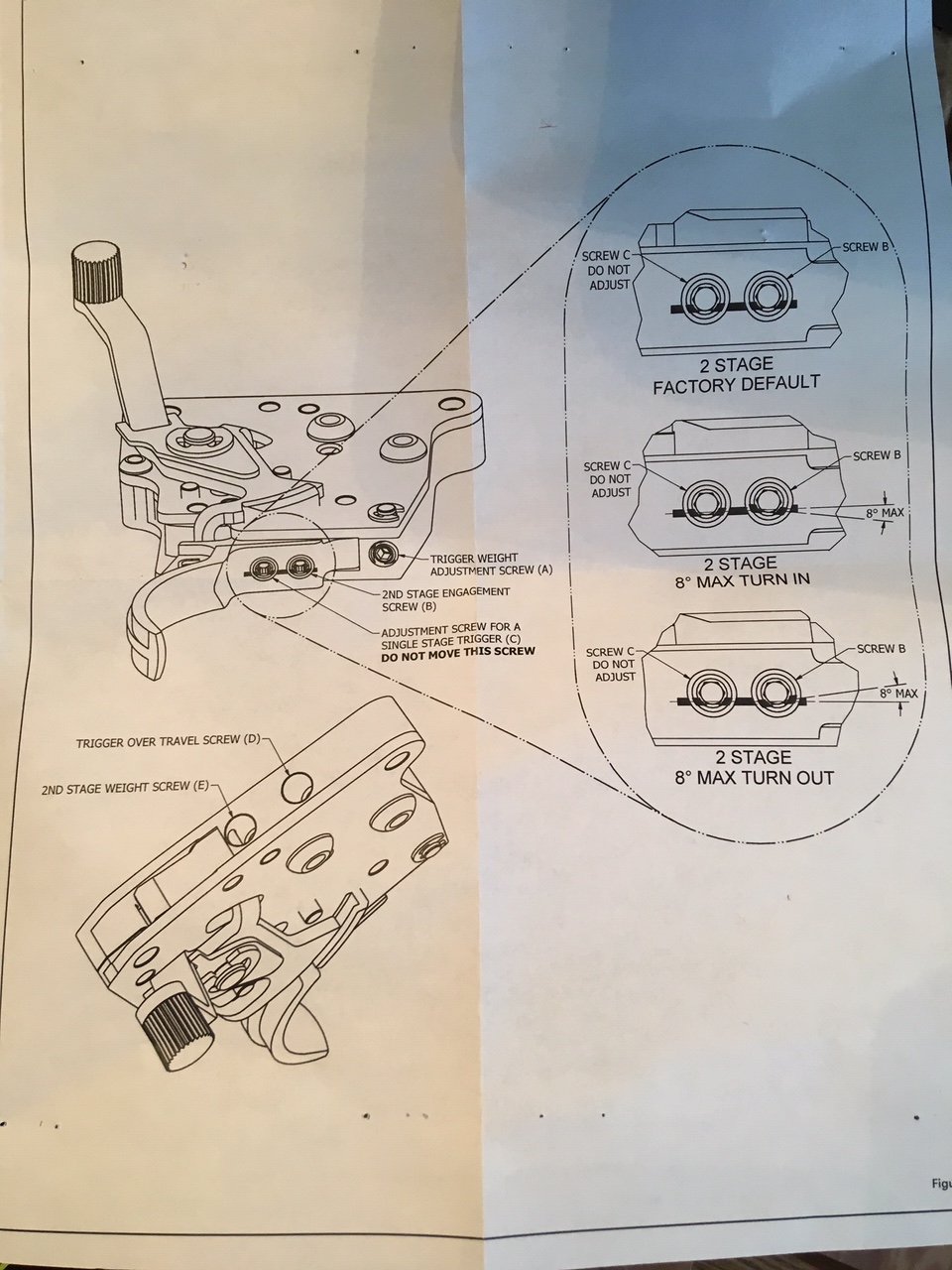

I installed mine last night and took pictures of the 2-stage adjustment instructions since they are not posted on the Geissele website and those conversion instructions are a hot mess:

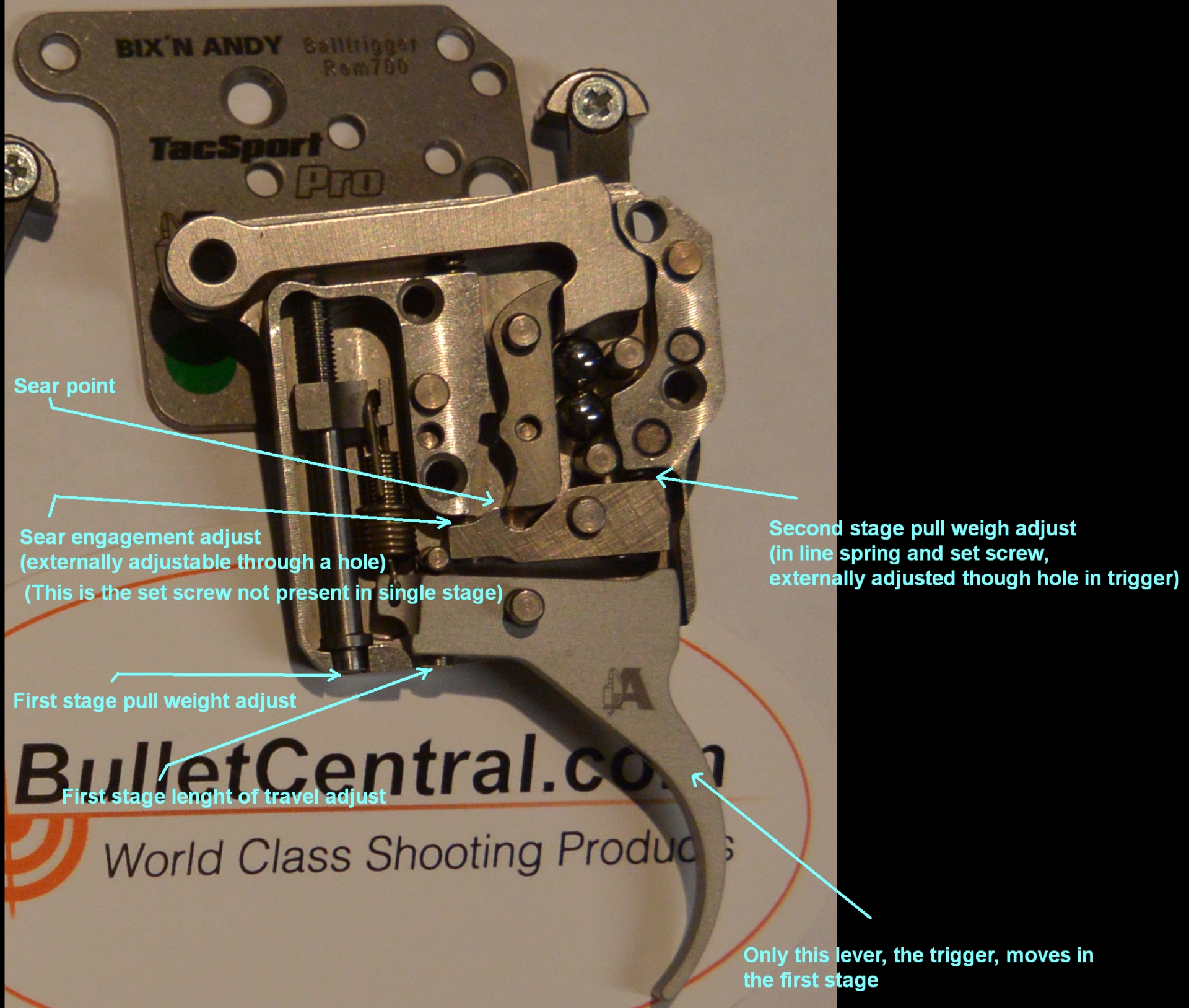

Though I caught a lot of the new triggers at ShotShow this year, I missed the Geissele and have not seen any diagrams of how it, or the other C.G. 22 based triggers such as the X-Treme 22 work. If anybody has a link to one of these with the case side off or a video with an acrylic side one being explained I would be interested. I am acquainted with principles behind the Jewel, Bix'n Andy, and TriggerTech designs but for all the bragging I have seen on the C.G.22 designs, their 4 levers, and true 2-stage designs, I have not seen anything on how they work.

Jim! Excited to talk to you as I actually read your review back when you first wrote it. Yeah that's what I'm talking about, the "less safe" state of the trigger you're describing. With the super 700 there is actually a little port you can watch what's happening with the sear movement. On the super 700 there is a lot of overlap between the re-cocking lever and sear lever and as you pull through the first stage the re-cocking lever moves down until you hit the "wall" where it is just barely holding the sear lever back, at which point you are very close to firing and a small amount of additional force allows the sear lever to move past the re-cocking lever which allows the transfer lever to fall and firing pin to spring forward. However if you release the trigger instead, the re-cocking lever moves all the way back up to it's original location to give a large amount of overlap with the sear lever again creating a very safe trigger. See attached a photo of the port where you can see the sear movement, shown in the bolt lifted state. When you close the bolt the sear lever moves back and down and comes in full contact with the re-cocking lever.
My understanding of a lot of the 2 stage triggers out there is that they don't actually move the levers at all during the first stage, you just pull against a spring until you get to the "wall" but the re-cocking and sear levers are sitting right on the razors edge of each other just like any single stage trigger would be from the moment the bolt is closed. So for those 2 stage triggers you don't get the safety advantage of a true 2-stage trigger and hence why they're not considered a "true" 2-stage. That was the root of my question about the tacsport. So my question is, looking at your photo of the tacsport again, does the 2 stage version create a lot of overlap between the two levers at the point you call "sear point" ? As I study the picture again it seems that is possible, but on the other hand, when I look at the picture where you show both versions, it seems the 2 stage might simply be a case where you pull against what looks like a slightly longer spring than the 1 stage creating a "2-stage" trigger but without giving any additional lever overlap. I'd love some confirmation and even a picture if you or anyone has one that shows the 2 stage trigger with the side off in the cocked state, just like you did on the single stage.

I'm not able to really visualize how the super 700 works from this description. I'm also not that familiar with the nomenclature of the different levers in a 4 lever trigger system. At some point I expect I will need to see one of these things with the side off and in a couple different states (cocked, ie. pressure on topsear and fired) in order to understand how it works.
As for the TacSport's two stage function. In the first stage you are just pulling against the main spring (the big one on the left in the photos.) The rest of the levers do not move at all in the first stage. They sit just as they would in a single stage trigger. It is no safer, or less safe, than a single stage trigger in this regard. Here is the two stage in cocked position labeled.

@BigJimFish thanks for the reply, that does confirm what I was wondering about on the TacSport.
Sorry I wasn't able to explain well the function of the super 700. I've never taken the cover off of mine and don't really plan to. I am very curious and would love to see a bit more of it myself, but I'm not willing to risk the $200+ investment at this time. :)
