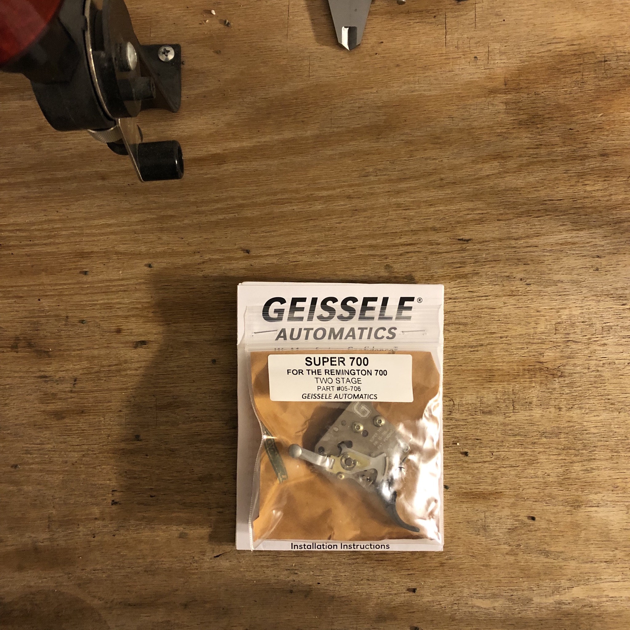

Geissele Super 700?
Recently received a Super 700 from Brownells during their last Geissele sale. No dice on my Nucleus action. Pull the trigger all you want, nothing’s happening.
I bought mine from Brownells also...I sent it to Geiselle for modification...Unfortunately, I won't have a Nucleus action for many months to see if it works...I am anxious for someone to test the modification and post about it...Seems to me you have two options. 1. Send it back to Brownells. or 2. Contact Geiselle and return it to them for modification. (I had better luck emailing Geiselle sales, rather than using their contact form on their web page. Although, I eventually did get a response after using both methods... I'm unable to use the telephone due to hearing loss.)
My replacement is in hand. The original trigger I had to modify so it work properly in the Ultimatum U300. The safety lever would contact the bolt handle. I figured they would replace the defective part and send it back, they sent a new one with unmolested safety lever!

I received my Super 700 yesterday and immediately threw it onto my Origin. I couldn't detect any problems other than a pretty heavy bolt in both directions. Trigger felt great like I expected, but I seriously need the single stage conversion instructions. I agree that the first stage is too long in stock form.
You and I are in the same boat with the same action and heavy lift in both directions. And I want the single stage conversation.
I have the same setup. After lubrication, 200 rounds, and 500ish dry fire practice; the trigger and action are smooth and easy to operate.
Hmm interesting I am about 310 in rounds and countless dry fire practice still feels the same. What lube are you using? And its heavy open and close but didn't really notice it during a local match this sunday.

Update...Got my super 700 trigger back , I installed it in my nucleus and no bang. I have another super 700 which I compared it to, I did not notice any geometrical differences, took out the calipers and took a few measurements no differences. Not sure what the deal is. Sending it back Monday, also noticed it had a lot of over travel and seemed misadjusted compared to my other one. If anyone has a modified super 700 please post any difference you noticed.

Hey guys if you happened to receive a trigger that wont work with your ARC Nucleus please let us know and we'll help sort that out.
Originally we made the triggers for the OEM Rem 700's and through feedback learned that folks really like that ARC action. Then we made sure to get the Super 700 trigger working with it and even have made all newer production runs compatible. Because of this there may still be some of the older style floating around out there. Again if you have one of those that wont work with your ARC please let us know and we'll work with you to get it converted and gtg.
If you got sent out one that was of the original set up and is not ARC compatible we will convert it for free, all we ask is that you contact us so we can set you up with the RMA info and you'll just cover shipping it in to us. We'll cover the modification, labor and return shipping.
If you had a replacement sent out to you that was supposed to be ARC compatible and is not working with your receiver please let us know and we'll get that sorted out ASAP. We apologize for the added inconvenience and we will make it right.
There are so many different actions based on the 700 out there and we want your feedback on them so we can continue to learn about them and improve fitment as needed in order to better serve you all.
-GACS

Well, mine is going back to Brownells after sending to back to Geissele on my dime, it came back working 80% of the time versus 5% on my Nucleus. Bolt lift was also noticeably heavier than with the Trigger Tech I had in there, which I have had zero issues with. Now the wait for the TriggerTech 2-stage begins.
Not good news...Sigh! Am I correct in reading you have another Geiselle super 700 trigger that DOES work in an ARC Nucleus Action...Curious. I'm sure ARC and Geiselle will sort this out eventually...Surely by the time I get my JHR...Lol
I have another super 700 that also does not work. I was using it for comparison to the upgraded trigger. I got my trigger back for the second time, this time it has a different angle where it engages the cocking piece and works like a charm.
